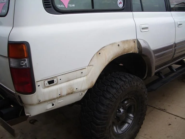

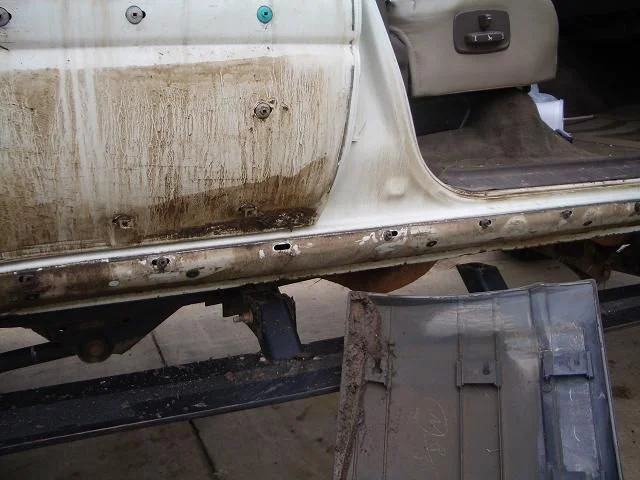

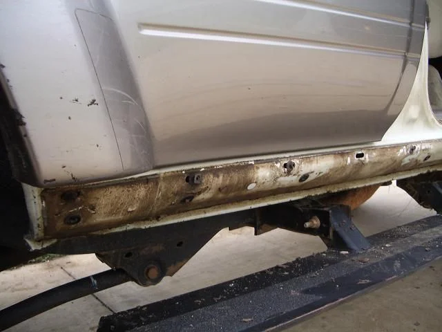

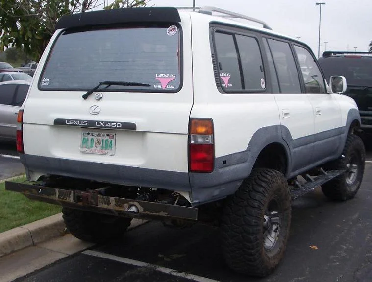

Ok, so I finally got around this weekend to covering up the baby poop bedliner color on The White Trash Lexus, and doing the passenger side. Used a whole gallon of durabak, and will probably come back with an extra quart I had on the dr. side, that baby poop color is hard to cover. Anyway, thought I'd share these pictures of after the flare removal - it's pretty obvious that these things are just mud collectors!

I'll get some full truck shots later today and post up - the Dark Grey actually turned out darker than it looked on the web site, which is a good thing, I wanted it more charcoal

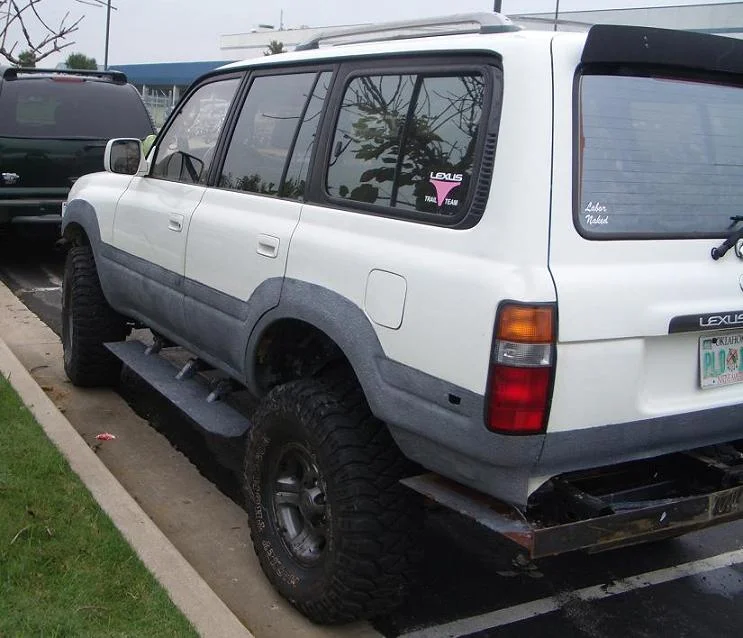

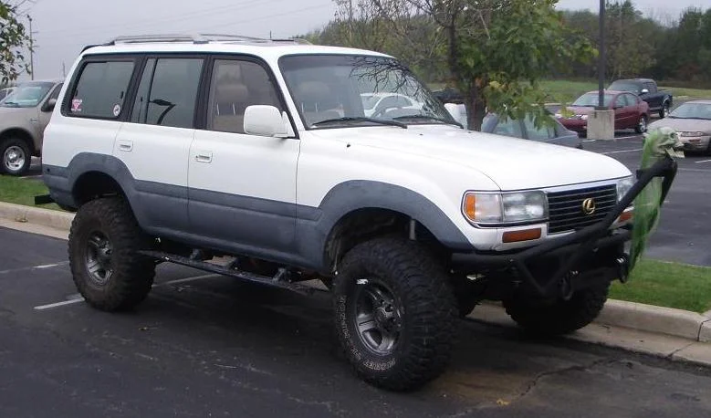

completed pictures - really want 1 more coat to even out the color. That baby poop color was just really hard to cover, and for some reason this Durabak seemed more difficult to work with, though I couldn't put a finger on why. It didn't seem as uniform I guess, though it was thougholy mixed. Since I've done a 40 twice with blue, one side of this with baby poop, and both with grey, plus the inside of a 40, I think I'm starting to become an expert ;)

It's Durabak. I used a full gallon. It would have covered better if I didn't already have baby poop colored duraback on the dr. side. It comes in a bunch of different colors.
You can order online here
http://www.durabakcompany.com/
or if you want quarts, www.newlinesafety.com One thing with new line, if you get Sand, make sure you call and confirm what sand color is. They messed up mine between new tan, old tan, sand, beige, and buterscotch - which is why I had to cover up the baby poop - was suposed to be sand, but they sent tan, which ened up lookiung butterscotch...
Make sure yuo get the UV stuff, make sure you wear gloves, and make sure you have Zylene for clean-up. Otherwise it's straight forward. I've sprayed, brushed and rolled different times, different things, rolling is by far the easiest.

It's darker than I thought it would too based on the online color chart and other posts of 80's with dark grey on different base colors. I'm happy about the darker finish though.
