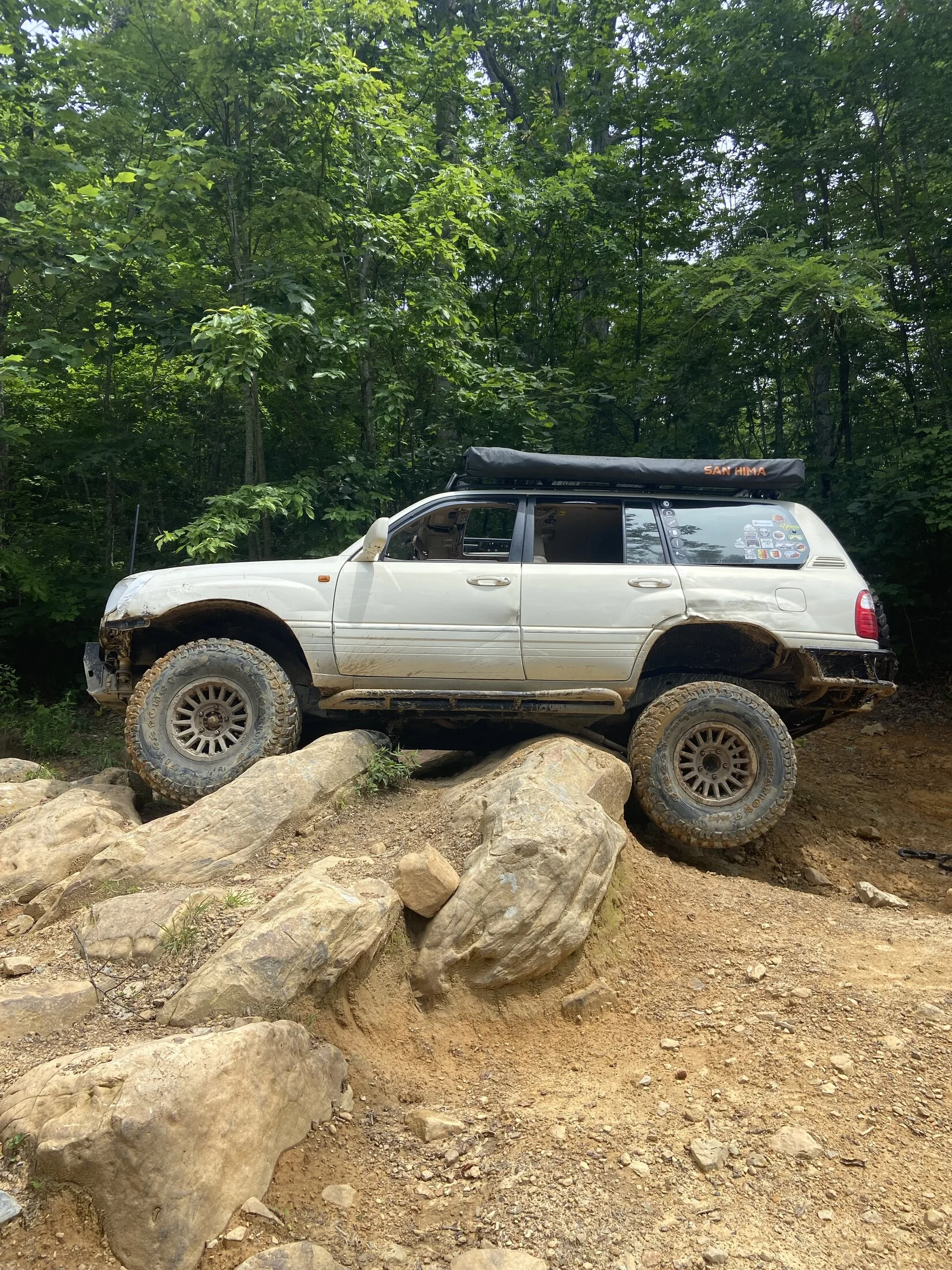

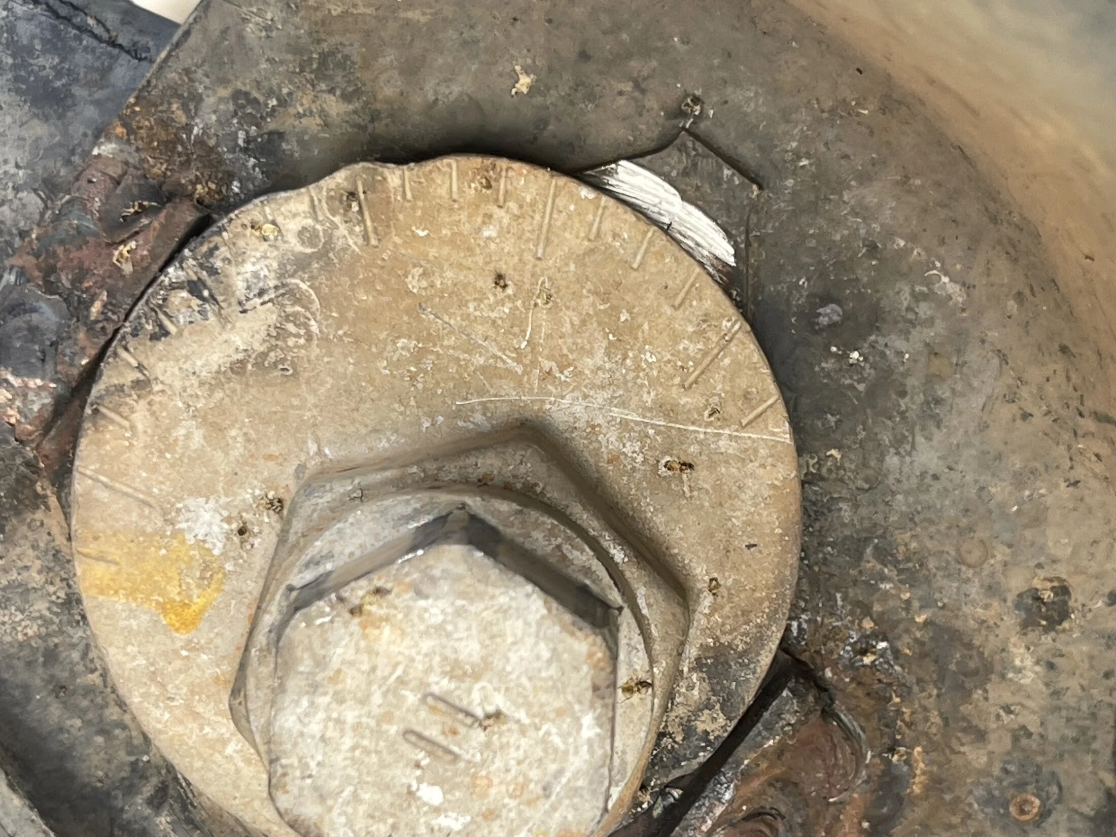

Here is the front eccentric on the offending side.
It’s entirely possible I have a issue elsewhere, I am also running SPC UCA’s and I am in Moab so there’s a bad history with those here in the last week.
I’ll add that the noise emanated from the floor board at my wife’s feet and almost went away after the second shop torqued it to spec.

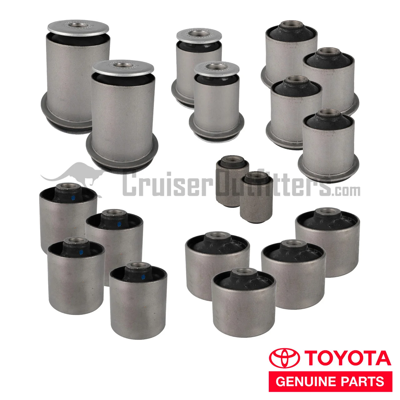

We also have every possible combination of OEM and/or aftermarket rubber bushings and all ball-joints for the uppers and lowers. We have 5? different upper control arms in stock too, OEM, jobber replacement, Dobinsons, SPC, OME and maybe another I'm not thinking of. Ball joints and bushings are sold as kits or individually as needed.

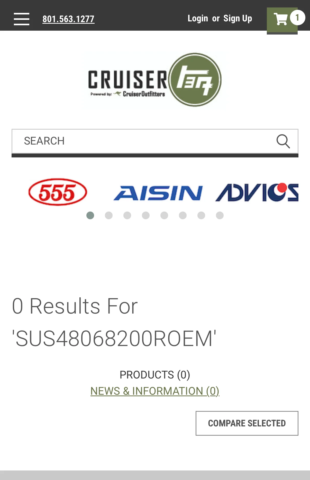

When searching those part numbers on your e-commerce site nothing comes up. I also couldn’t find them when browsing by series.
If you have direct URLs, I’m inclined to order them for an upcoming refresh on my 2016. Appreciate all you guys do for the community!
