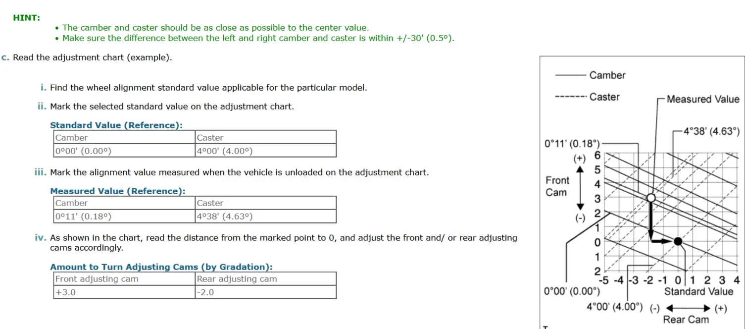

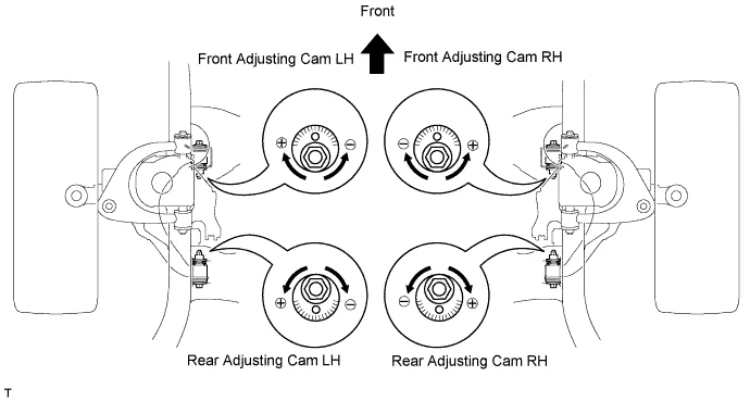

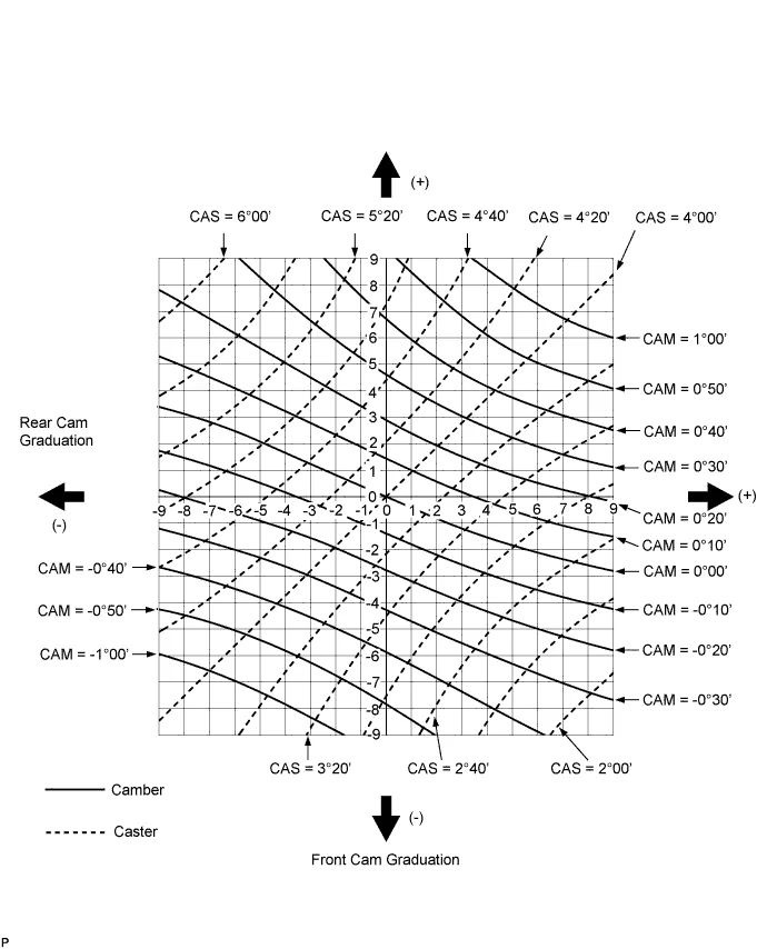

Are you able to keep caster high enough with the OEM uppers? This last trip to the hunter machine showed me how annoying dialing in our LCA’s can be regarding the cams and caster/camber. I thought those adjustments were a lot more straightforward but in my brief time by the rack it looked more like a sadistic juggling act. The added adjustment on the SPC upper makes sense on that regard.
If your tail is out by a degree it is ~1/16" out fore/aft? might be play in bushings or general wear. you can measure the link arms and try to find any noticeable/measurable difference from side to side / pin to pin. the popping could be poly bushings- I generally avoid poly and heim joints in daily drivers for noise and maintenance reasons
There are some toyota cheat sheets on adjusting the LCAs.
I don't think the alignment rack computers have this info-
