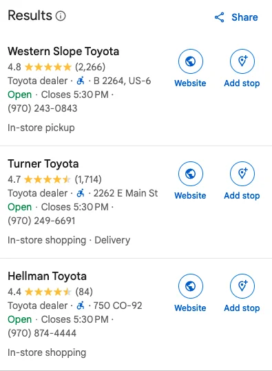

Looks like these three dealers are in between Moab and your next destination, maybe call them and order with those part numbers for pickup?
  • No. 1 LCA bushings (2x): 48654-60040
  • No. 2 LCA bushings (2x): 48655-60040

3-5 days out on those bushings. That just won’t fit the timeline I’m currently working with.
My recommendation would be call Western Slope in Grand Junction, or Turner in Montrose, and see how quickly they can get you the entire LCA assembly. You’re likely better off doing a complete RnR than trying to get someone to deal solely with the bushings. Labor will likely be the same regardless.
