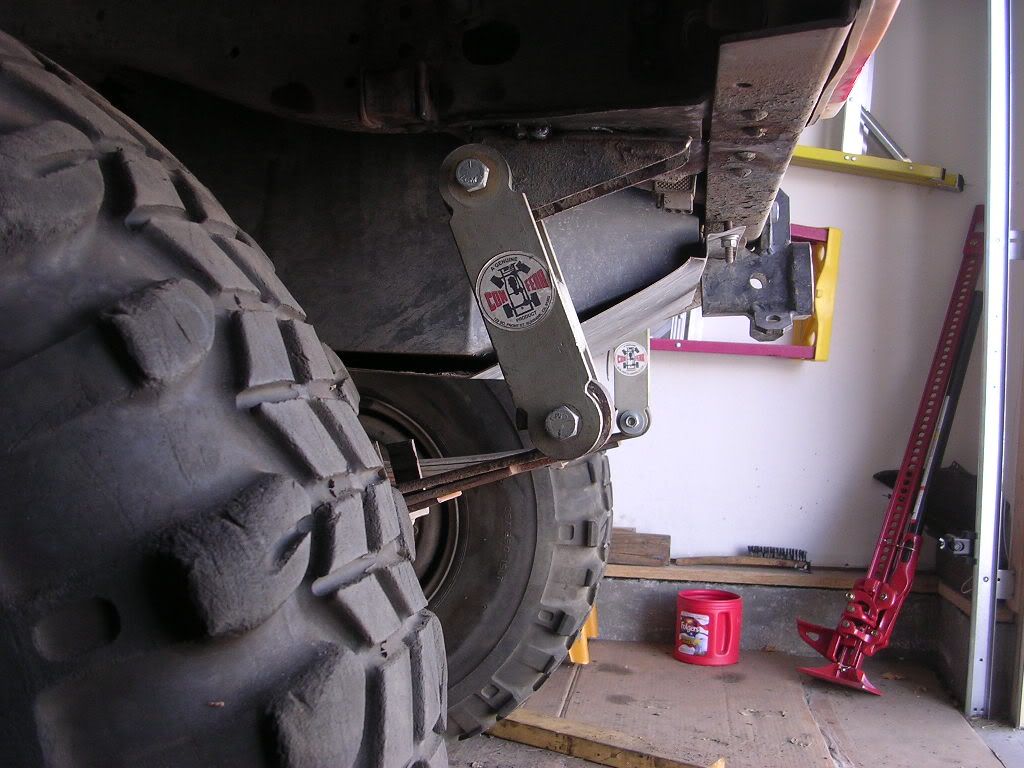

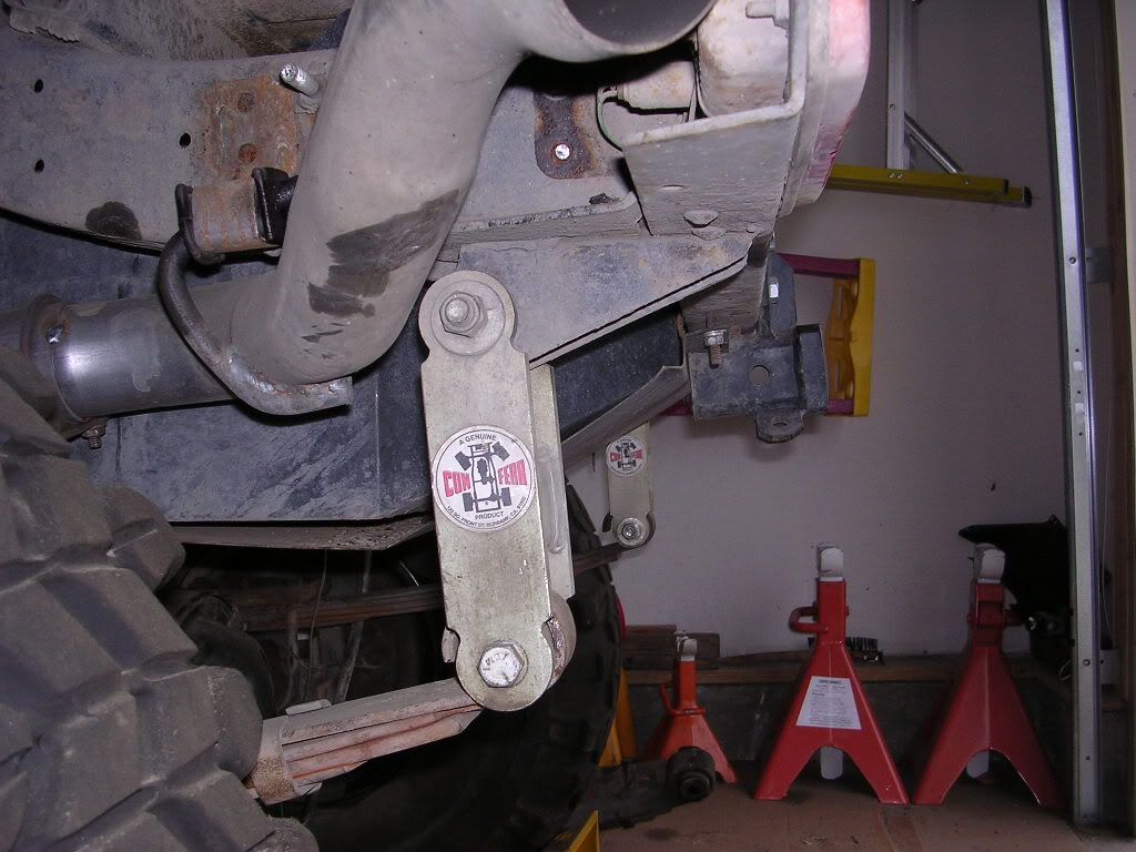

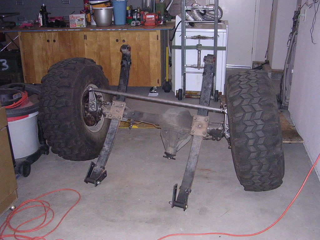

After a hell of a lot of work I have the rear end looking closer to what I want.
Since I don't have a torch I cut the shackle hangers off with a angle grinder/cutting wheel, a cold chisel, and a 3# sledge.
I played around with the spring packs for a couple of days trying different combinations. Just time consuming hard work for a desk jockey, spring on, spring off, spring on, spring off, etc....
I actually cut the hanger off again and moved it further back, also removed one more leaf. Then did the same to the other side. No picture as the light ran out by the time I finished.
On your rear end.
If you cant the shackle at a better angle (more like 45*) you will have a more comfy ride.
your truck will probably settle a bit as well after a week of driving or so . Keep that in mind when you choose the final height. I have found on stock springs the settling difference in height is usually about an inch.

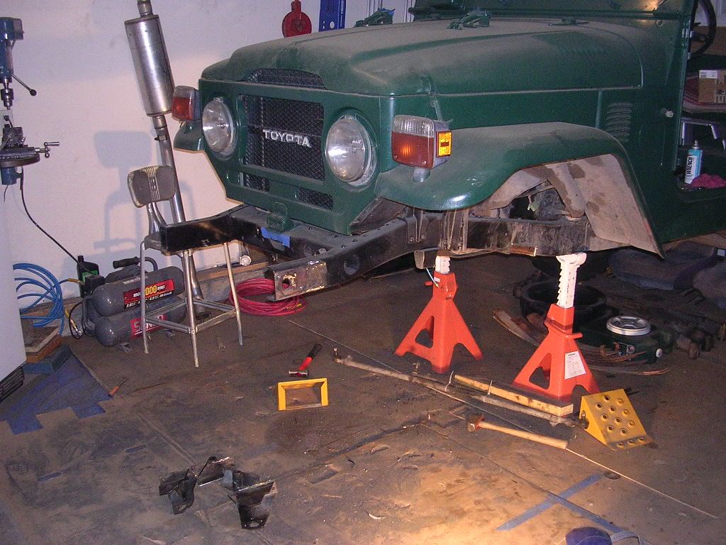

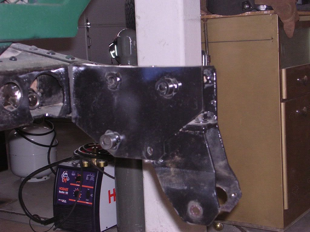

Made some progress today. Click image to see full size.

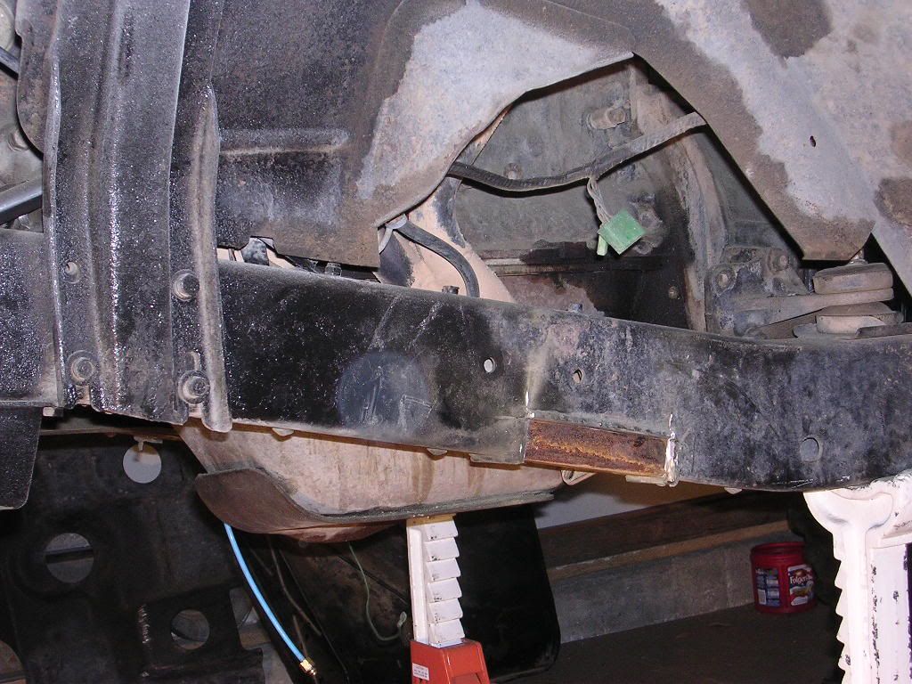

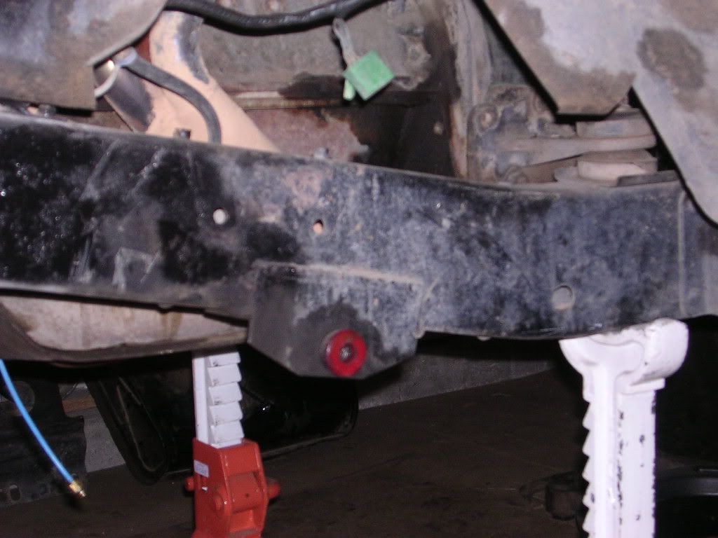

Finished off grinding and filling/grinding the places where I scored the frame while removing the old brackets this morning. Then cleaned everything up with 24 grit flap wheels. Spent a while cleaning up from the cutting grinding
Bird crap welding;
Marked out where to cut holes for the shackle hangers;

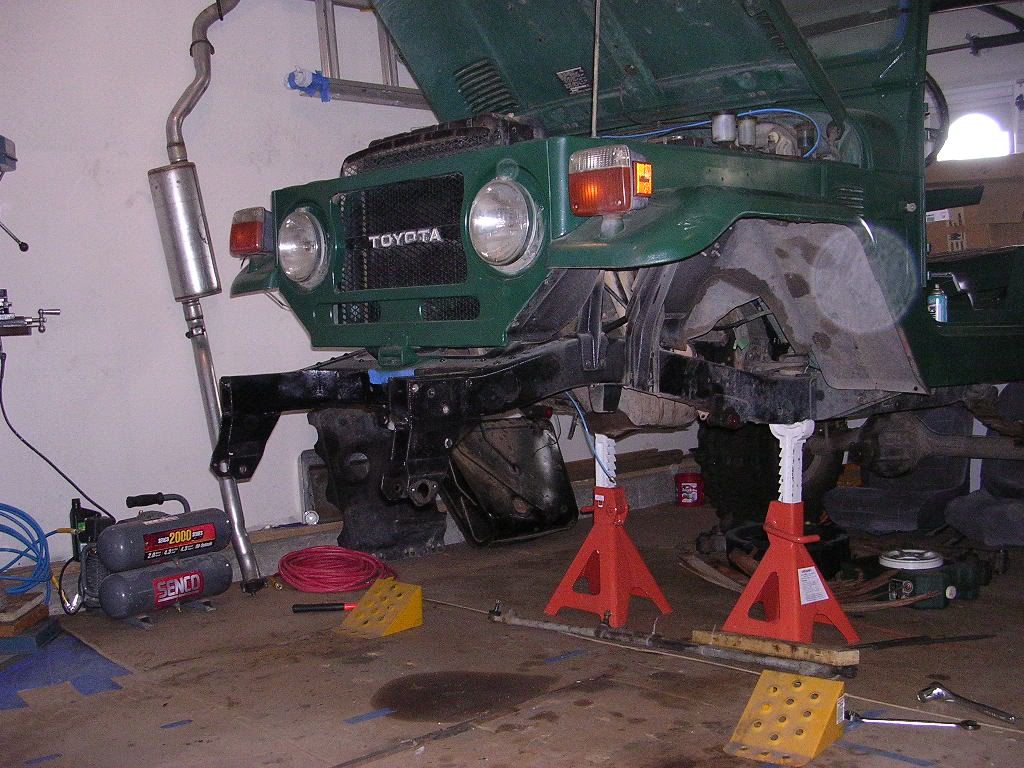

Spent some time finding 9/16 X4 1/2" bolts and a 1 1/2" inch hole saw.Tommorow I think I will get the PS gear box re-mounted just to make sure things are working out before I cut holes in the frame.
I learned a couple of things from this excersize so far.
1 - I have a lot more faith in my bird crap welds after cutting them off.
2 - The pretty welds I paid a lot for when I had the shackle reversal done didn't get as good of penetrating as my s*** looking welds.

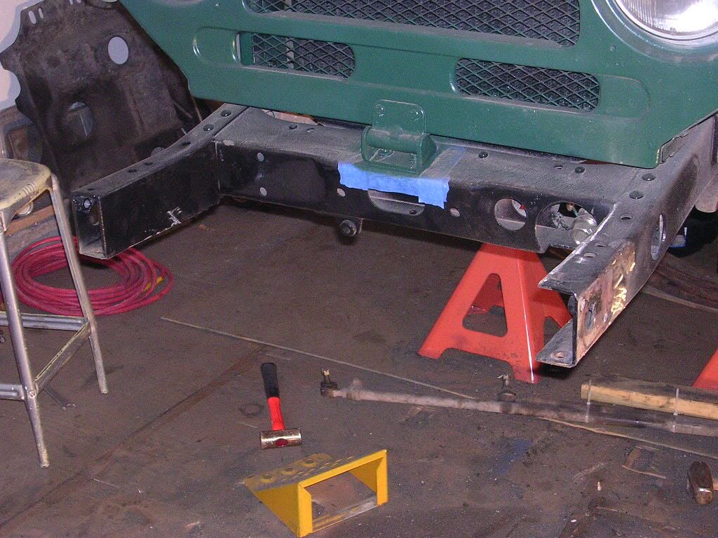

Well lacking anybody telling my I'm over engineering this thing I forged ahead today.
It's a tight fit between the winch and PS gear box
I added a piece in the angled area
And a piece underneath
Lifted the winch/bumper on and off the bumper brackets three or four times, heavy bastid my back is sore. I didn't show the grinding I had to do to relive the bumper brackets where they interfered with the new spring hangers.
