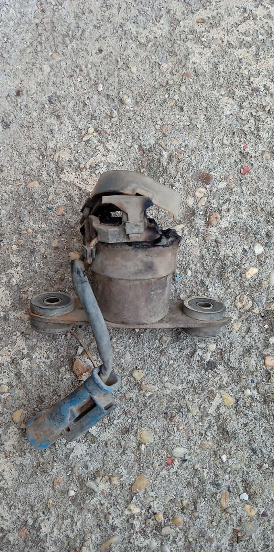

Just starting my PDI intercooler install today. I've already run into a little snag.
I have a 1HDFT and the glow screen relay assembly is mounted right where the intercooler piping needs to go on the driver's side (RHS)
So I have a few questions:
1. Has anyone relocated this relay?
2. Or should I just delete the glow screen heater? I'm in Utah and most winters are 10-30° F. The cruiser lives in a garage that stays in the 40s most of the winter.
I went with option 2 and haven't had any issues starting when in Western Colorado during the winter. However, I do have an inline coolant heater I plug in on the really cold nights if the 80 isn't in the garage.
