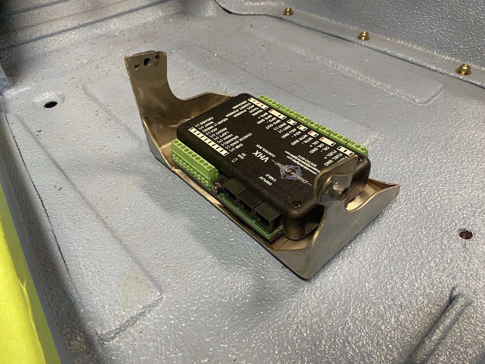

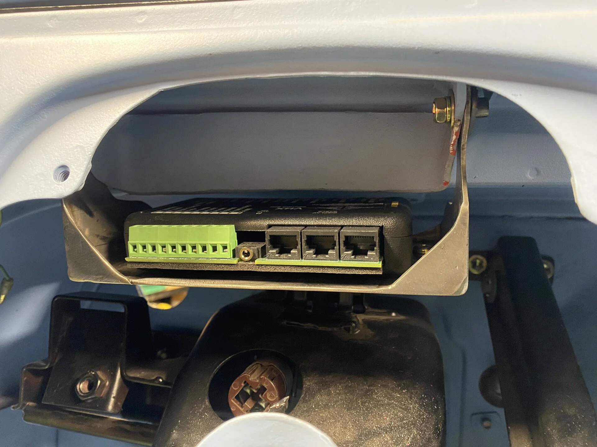

I have been getting lots of little things done such aa integrating the Vintage Air harness into the 80 harness, mounting the VA ecu, painted the seat frame and mounts. The most time consuming was building the cradle to hold the Dakota Digital ecu behind the cluster. It is made out of stainless steel except for the capture nuts I spot welded on. It has been test fit and everything clears just needs paint.

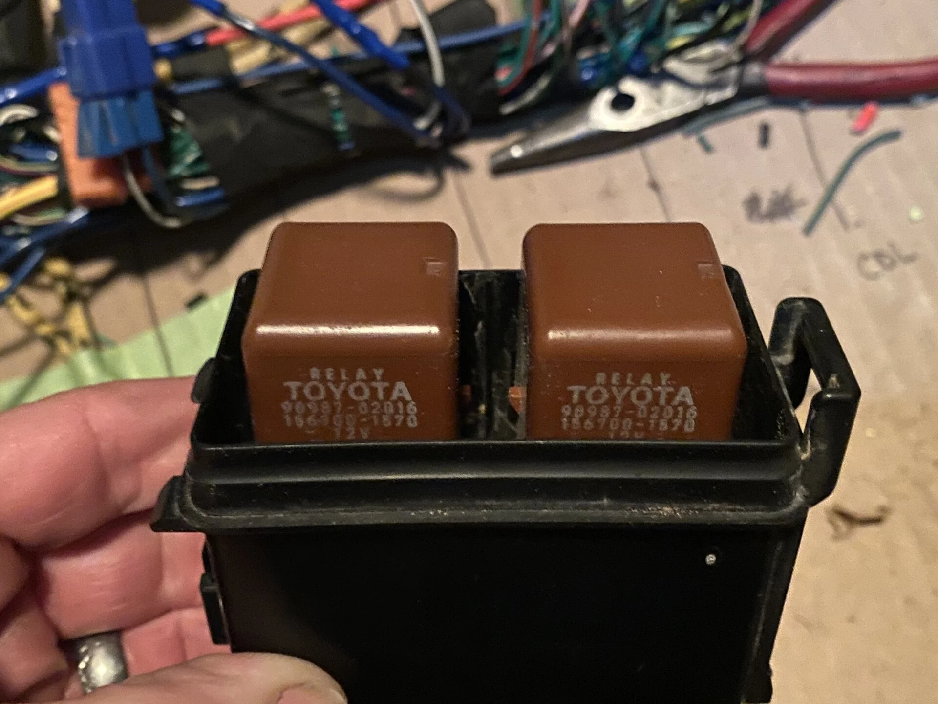

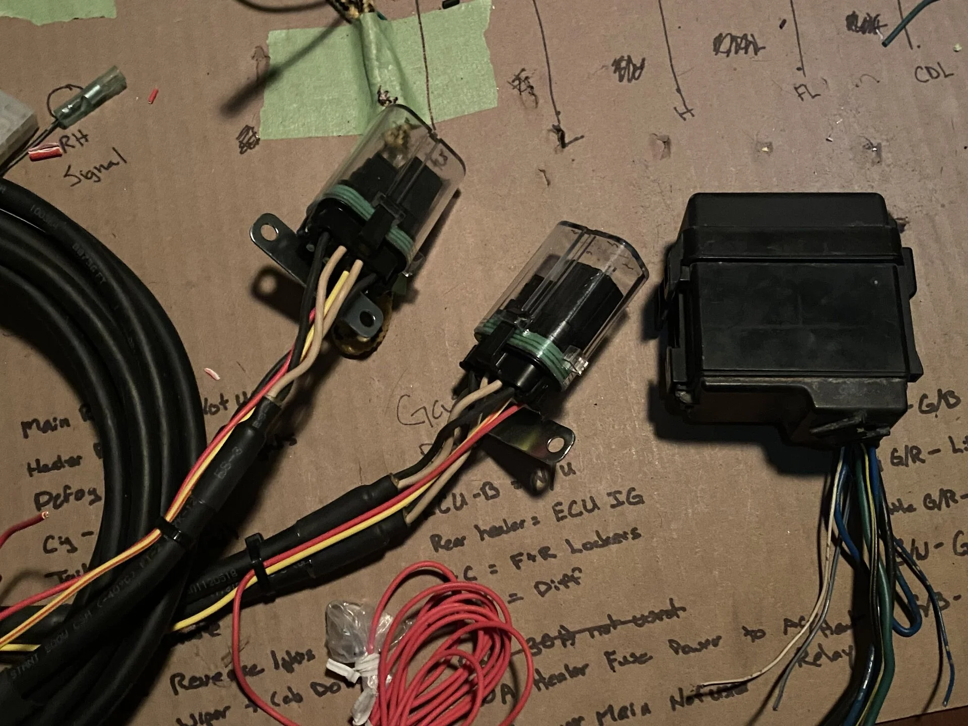

The wiring seems to never end and sometimes I make it harder on myself. I opted not to use the Harrop provided relay box and breaker it came with. I am sure the system they developed works fine but it looks out of place under the hood and takes up more room. Harrops set up.

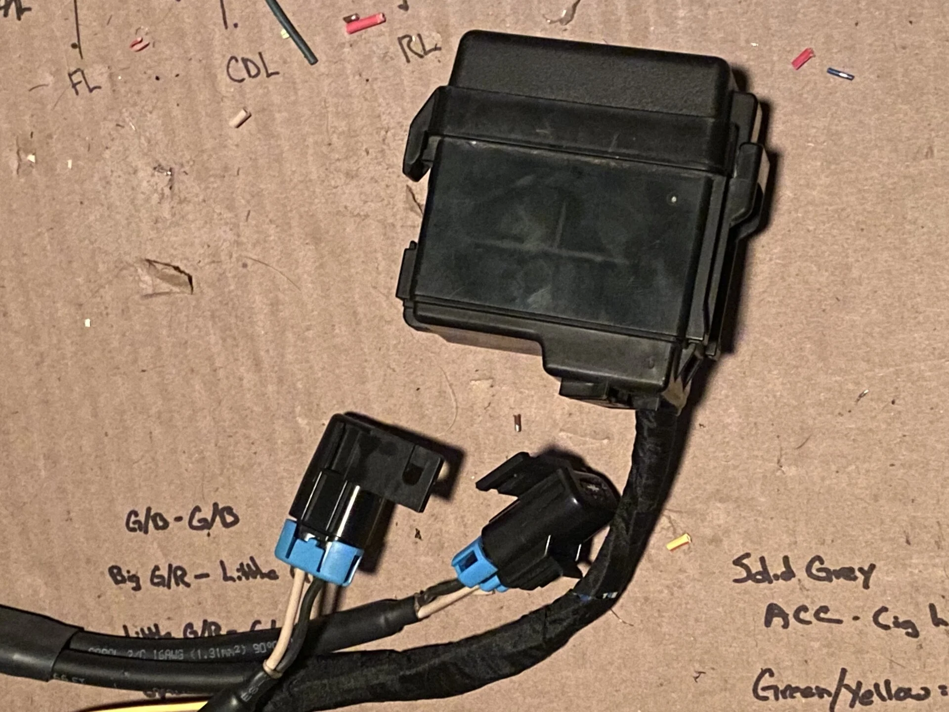

I am using a 30 amp dual relay box off of a gx470 to replace the clear relay boxes.
I eliminated the breakers that came with the Harrop harnes and am choosing to rely on the fusible link already in place. I will use two empty fuses in the engine bay relay box to run 12v to the relay.
Relay boxes are all wired up.

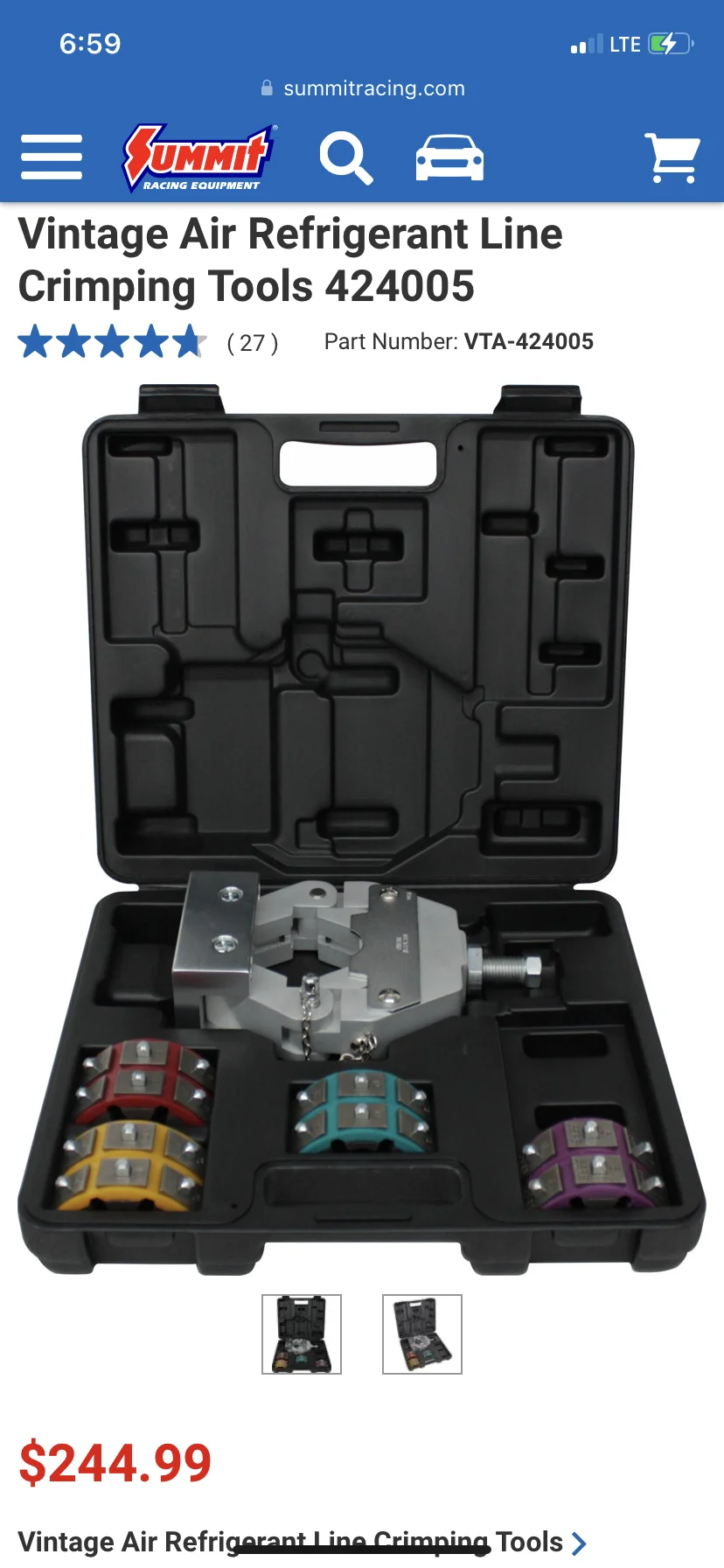

I need to buy a crimper to make my ac lines. I see tools with a wide range in price. Anyone have any experience or suggestions for what I should buy?
Best I can tell, the ones in the $120-$200 range are all basically the same. I have made several sets with the pictured tool with no complaints. It was a different brand and about $150. Nearing 100k mi on one set of lines I crimped.
Thanks for the response. After looking at a bunch of them that seemed to be made by the same company supporting multiple brand names I bought one of cheaper options but not the cheapest.
Love your cradle for your Dakota Digital ECU. Brilliant design and well executed!
The Vintage Air crimper is made by Mastercool and can be found about $70 cheaper. I use the Mastercool and it works great. Can't speak to the many knockoffs that are in the $120 range
I looked and that’s what mine is.

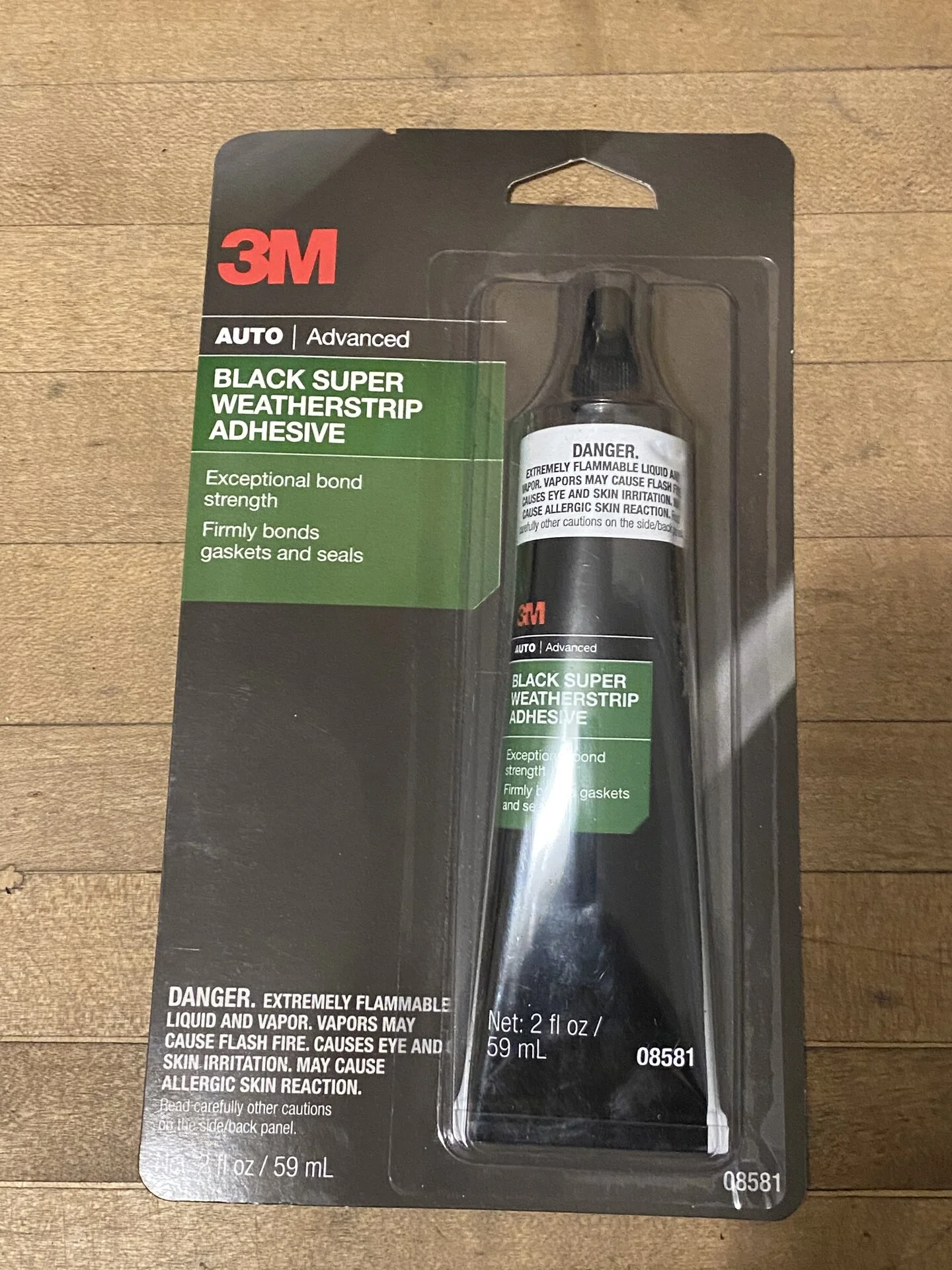

I am ready to install my windshield. I am using a cut to fit gasket I got from SOR. I have been trying to figure out what adhesive I should use to seal the seem. My searches have not turned up a definite answer. I bout the 3m adhesive pictured but I am not sure it is what I should use.
Can anyone confirm what I have will work or is there a better specialized product for sealing the windshield gasket joint?
@POTATO LAUNCHER in his past life did more than 1000 installs. Pinging him.
You will want to overlap the parallel cut at the bottom of the windshield center about 3/4"-1". This allows the stretch in the corners to occur without creating a gap once the glass is in place. Then a minimal amount of urethane can be smeared in the seam. What you have will suffice.
Awesome!! I appreciate all the advice. This will be the first windshield I’ve installed, so I will take all the help I can get.
