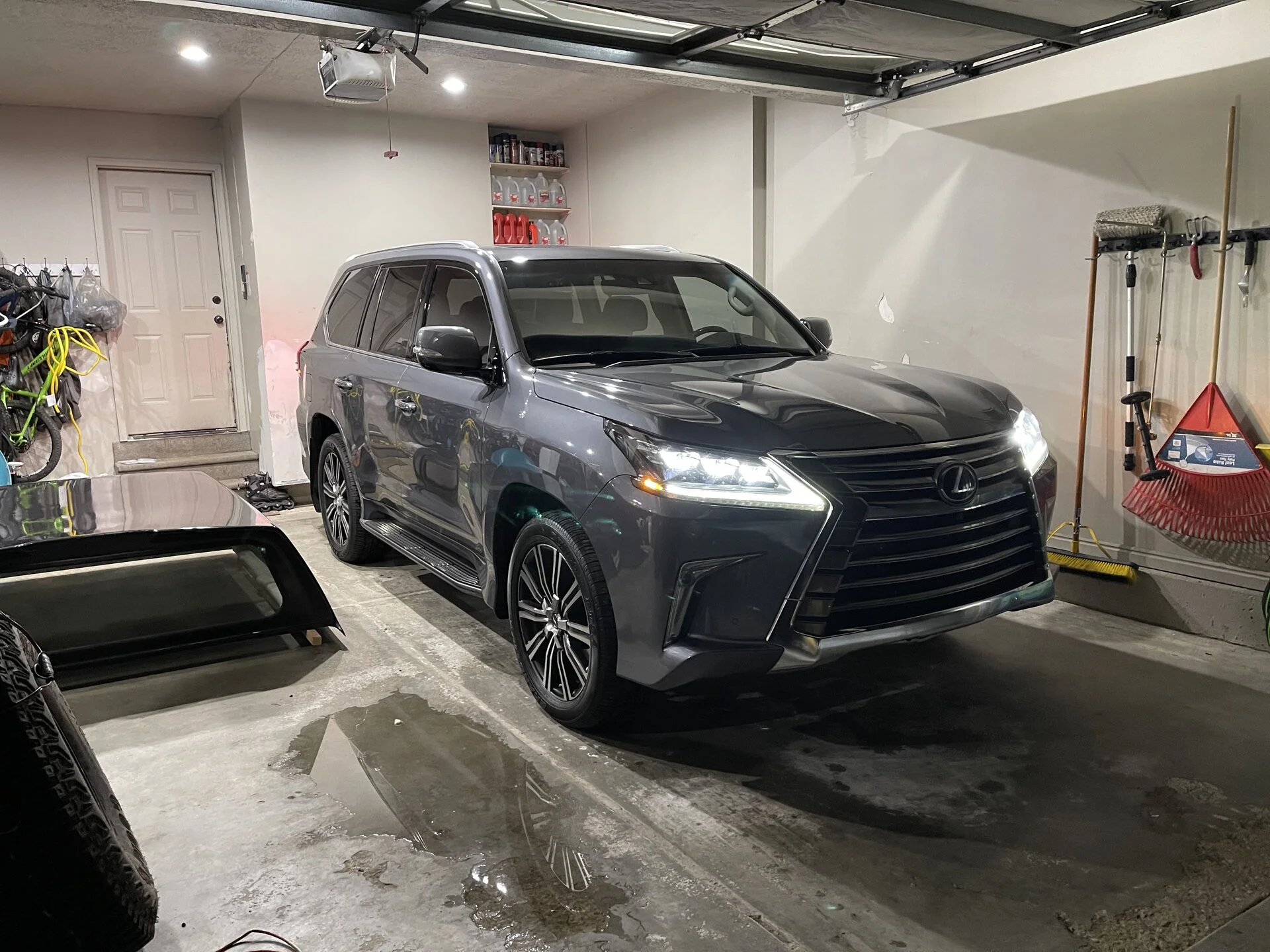

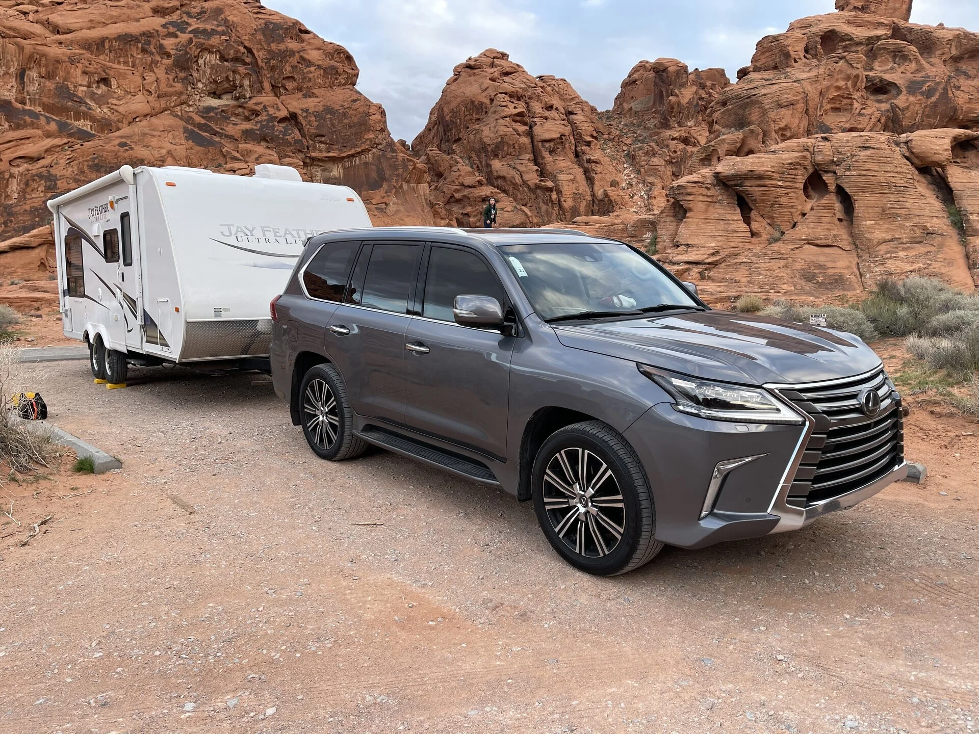

I figured I would start a build thread since I recently bought my 2018 LX570 and am starting to accumulate parts. The truck is Nebula Grey Pearl which is where the name Lead Sled comes from, in addition to it being a very dense vehicle being >6000 lbs in only a 112" wheelbase. The LX had ~50k miles on it when I picked it up and got it for around $51000 not including the trade in of my F150.
This will serve two primary roles for me:
  1. Tow rig for my Jayco JayFeather x213.
  2. Offroad rig. I am in Utah and its about 4 hours to Moab and a bunch of other good spots. We also spend a lot of weekends in the National Forest right by our house and, while the trails are fairly mellow, they can be pretty tight.

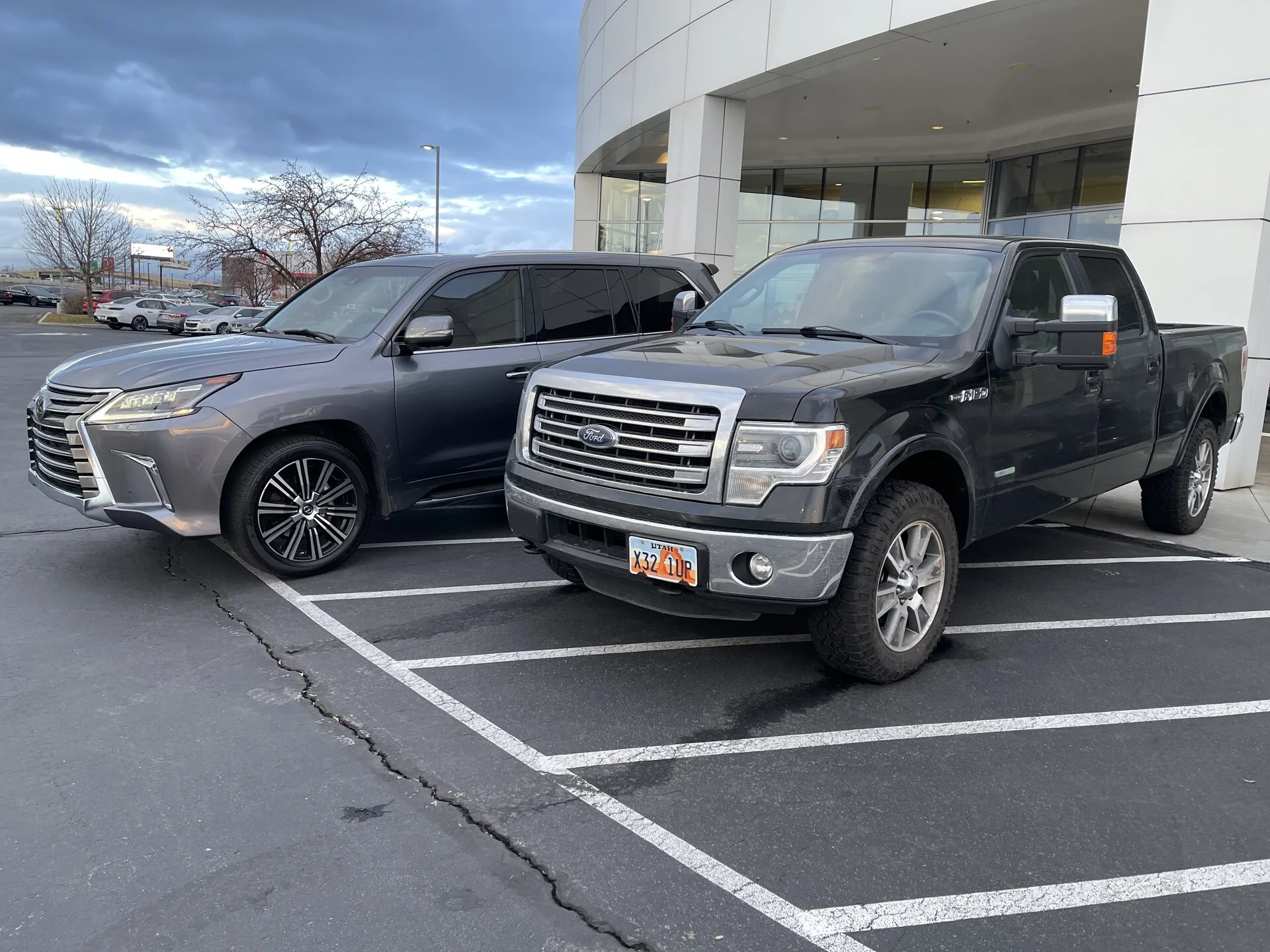

My F150 was my primary tow vehicle, but being a Supercrew 6.5' bed it was just two big to take offroad without hitting everything in sight. I had a GX460 as well that did good offroad but could not tow all that well.
Day I picked it up the LX and traded in my F150.
First camping trip, less than 2 weeks after purchase:

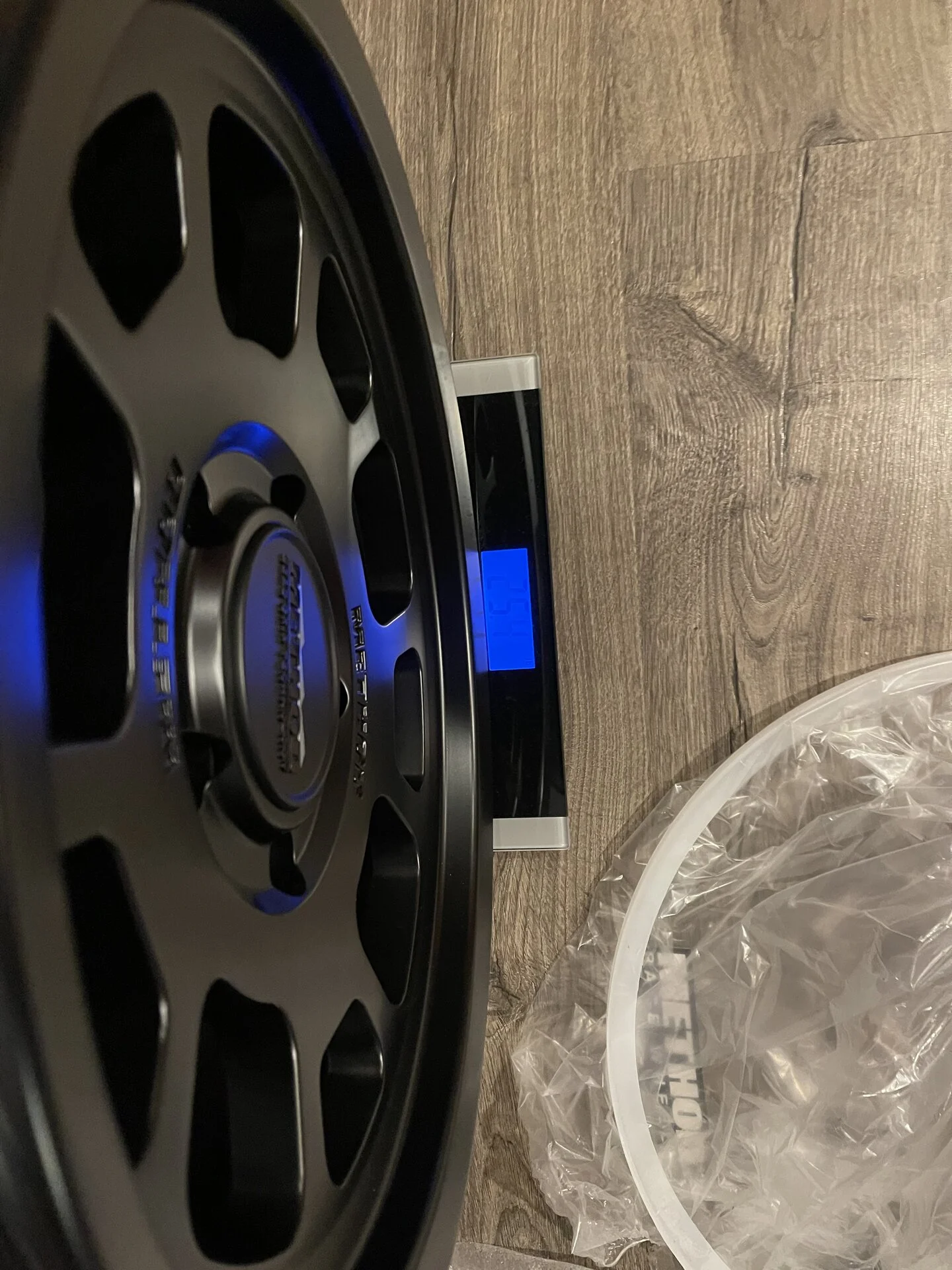

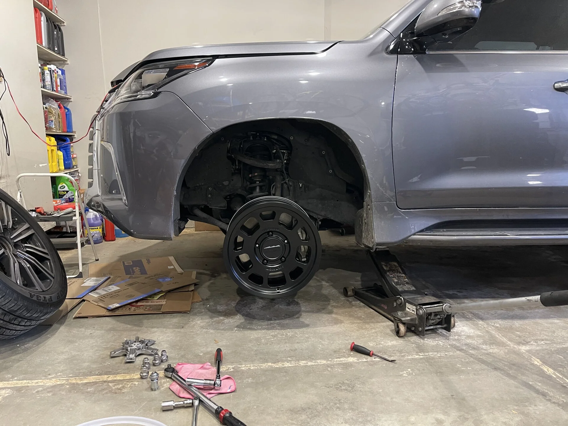

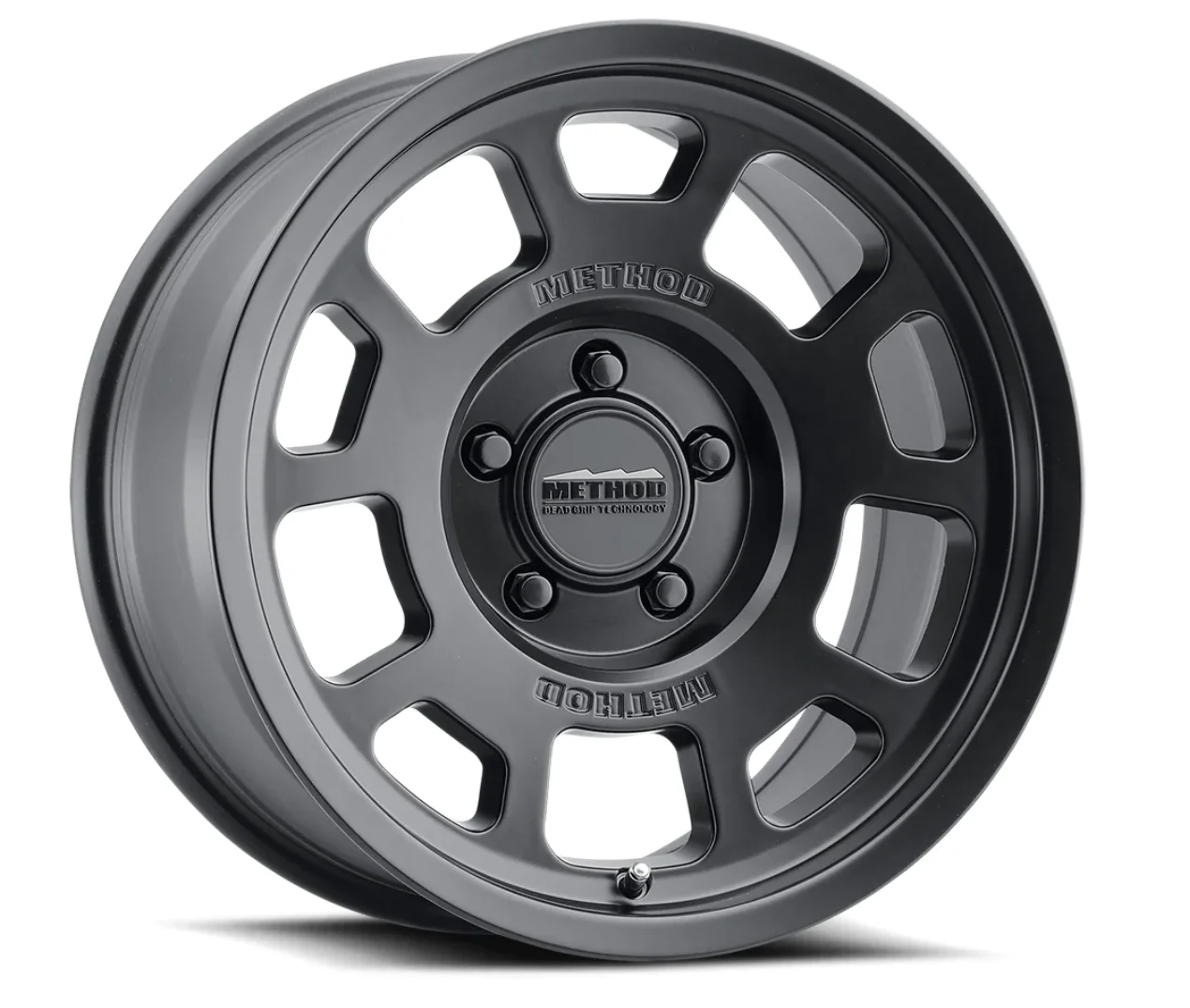

So the first major mod is wheels and tires. I picked up a set of Method MR705's in a 17" +35mm offset, they are still inbound.

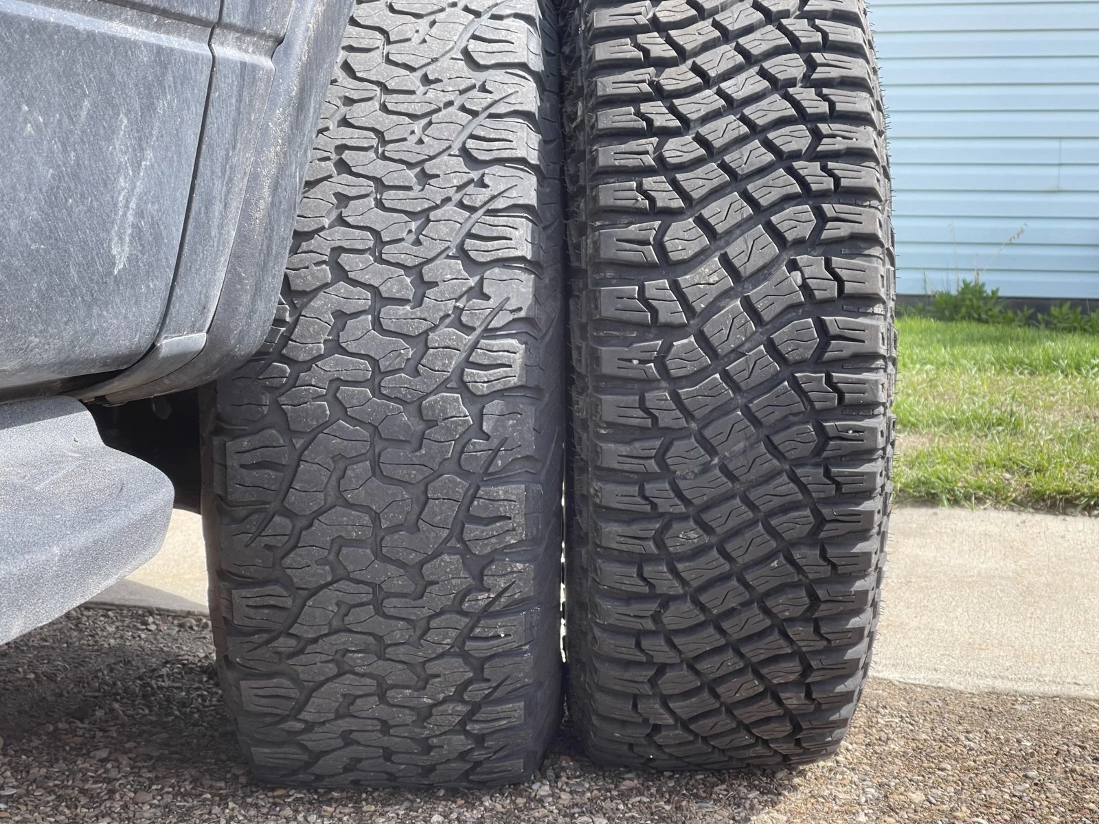

I was thinking about peeling the 315/70R17 Goodyear Territory MT's off of my F150 wheels, but last night I was poking around and found that Amazon had the same tires for $184 a piece, plus an additional 5% cashback from my Amazon card, put me at $874 for a set of 5 brand new "35's".

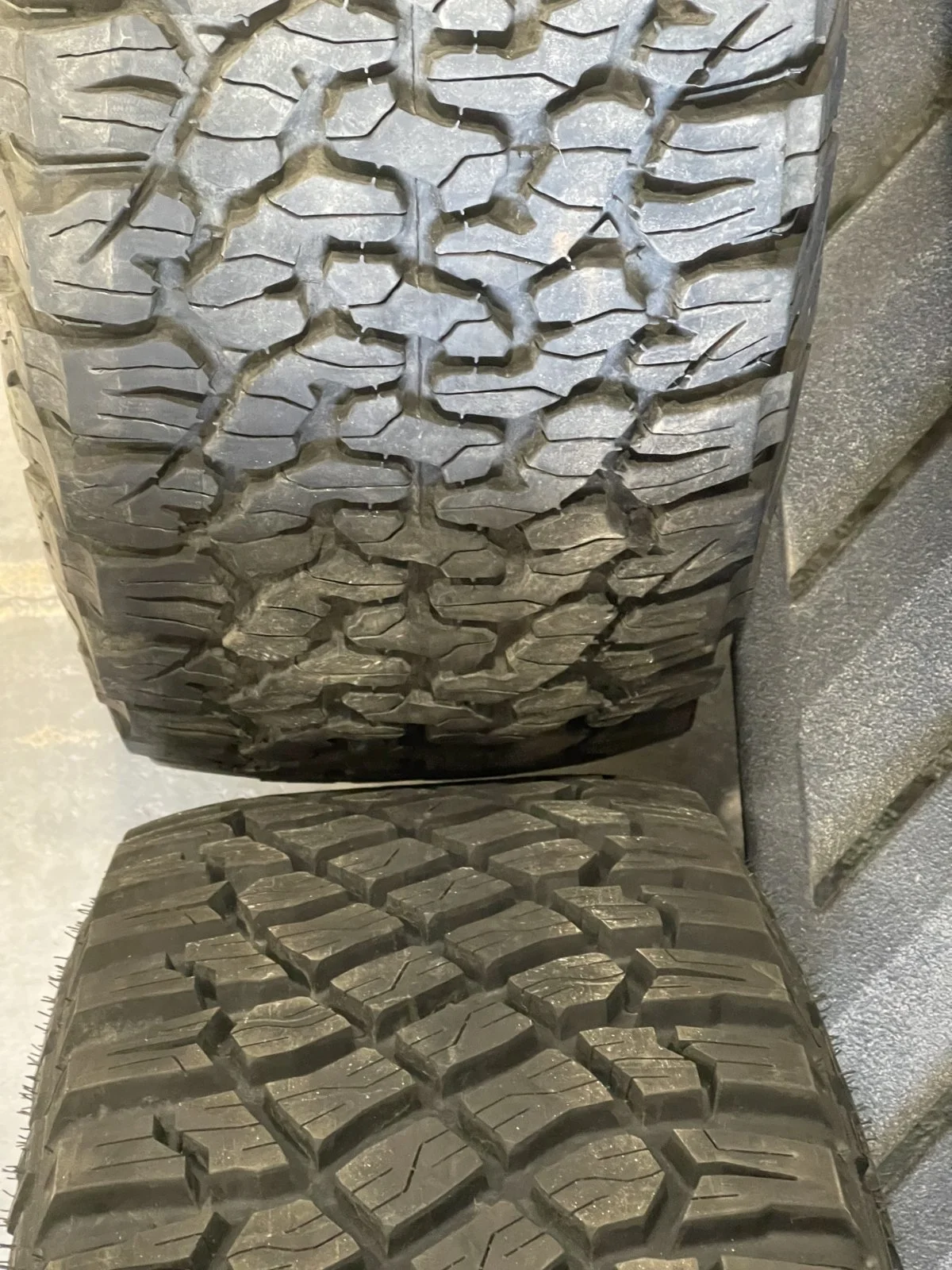

I ran these tires on my F150 for probably 5k miles and I actually really liked them. The main reason I bought them is that they are not a true 315/70R17, but instead run more like a 35x11.5 or a 285/80R17. This is them sitting next to my 315/70 KO2's I had on the truck prior, and then tread to tread with 285/70R17 KO2's from my GX460:

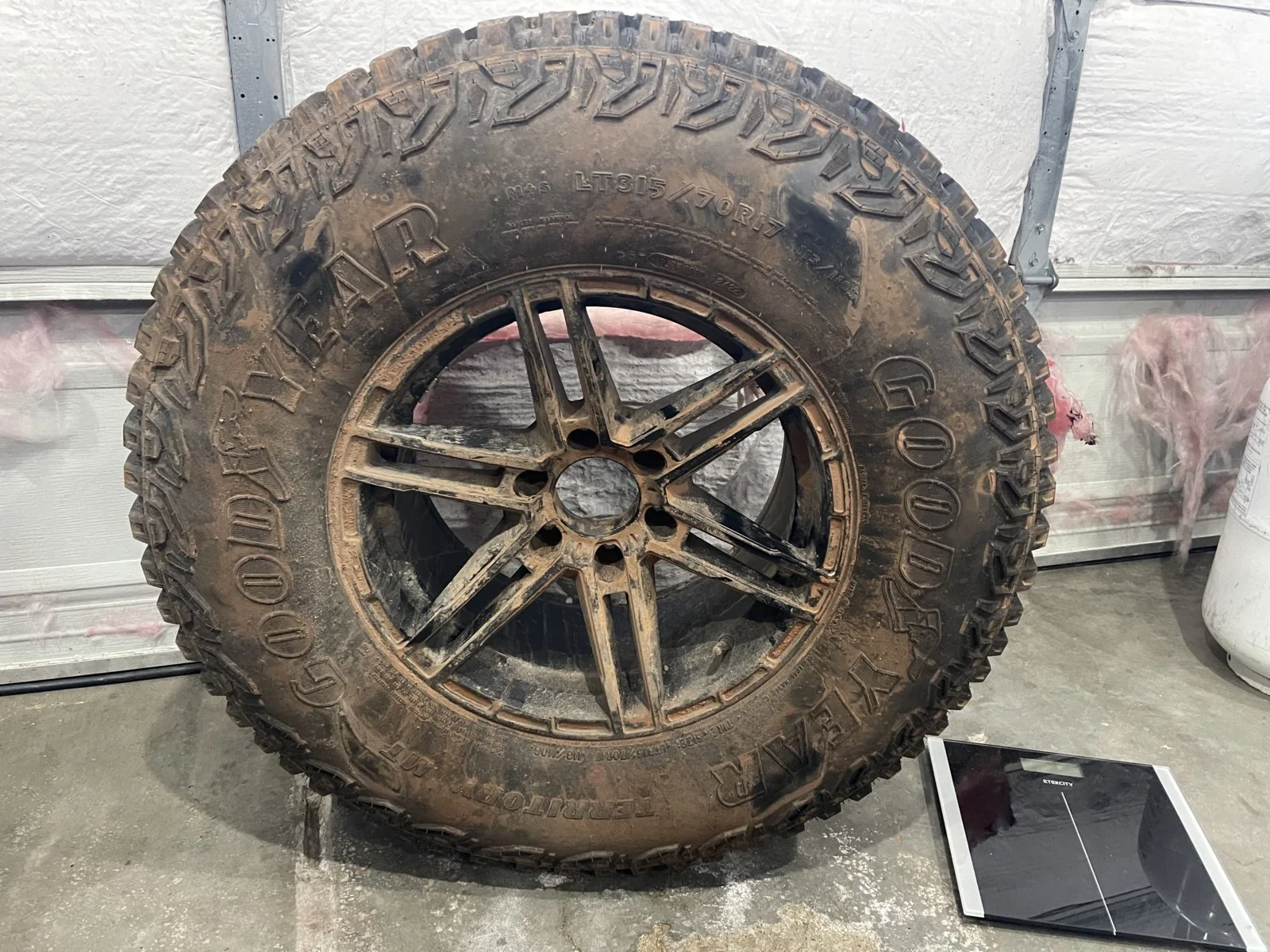

They are very light at only 53 or 54 lbs, the total tire and wheel weight on my F150 was only around 77 lbs. Even with this mud and dirt caked on.
So those should be in next week and hopefully the wheels will be as well. Allegedly the wheels are 25.6 lbs so I am hoping I end up around 77 lbs again.
These are probably not the stoutest tire ever but I think they are a good compromise for a truck that serves multiple purposes. My F150 picked up a considerable amount of spunk and probably 1.5 MPG by switching from my 315/70R17 C range KO2's to these. I am hoping these do not penalize the LX too much and am thinking they may actually be lighter than the factory 21" wheel and tires. And since they are about the same width, hopefully dont add a ton of rolling resistance.

MR705’s showed up yesterday and the one weighted in at 25.4 lbs. not bad. Not the best either but most 17” wheels seem to be in the high 20’s low 30’s.

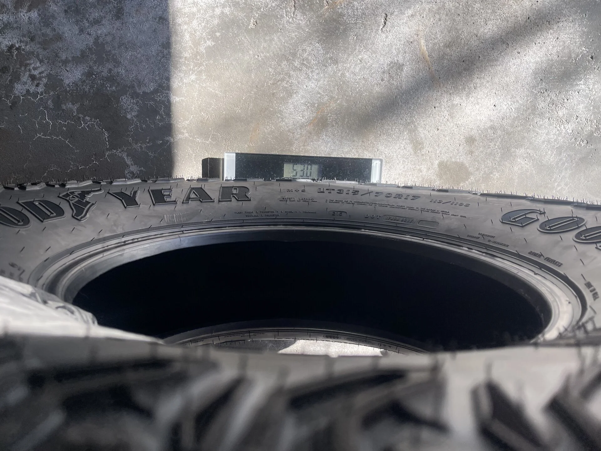

Tires came in this week. Weighed one and it was 53 lbs. so I figured mounted and balanced the tires and wheels should be right around 75 lbs.

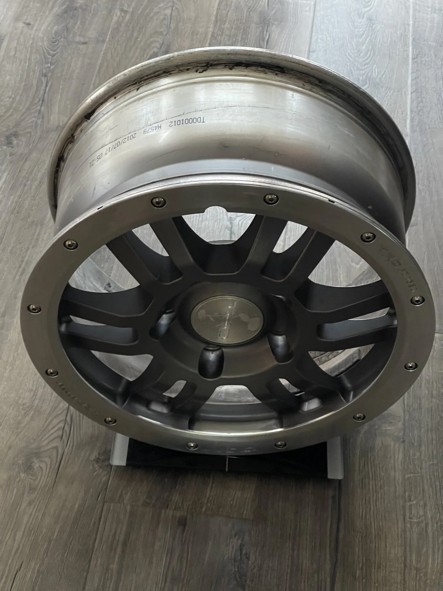

I picked up a decently clean set of some rock warriors i’m hoping that these will keep the tires inside the fenders with the tundra swap so that I don’t have to deal with any rubbing.

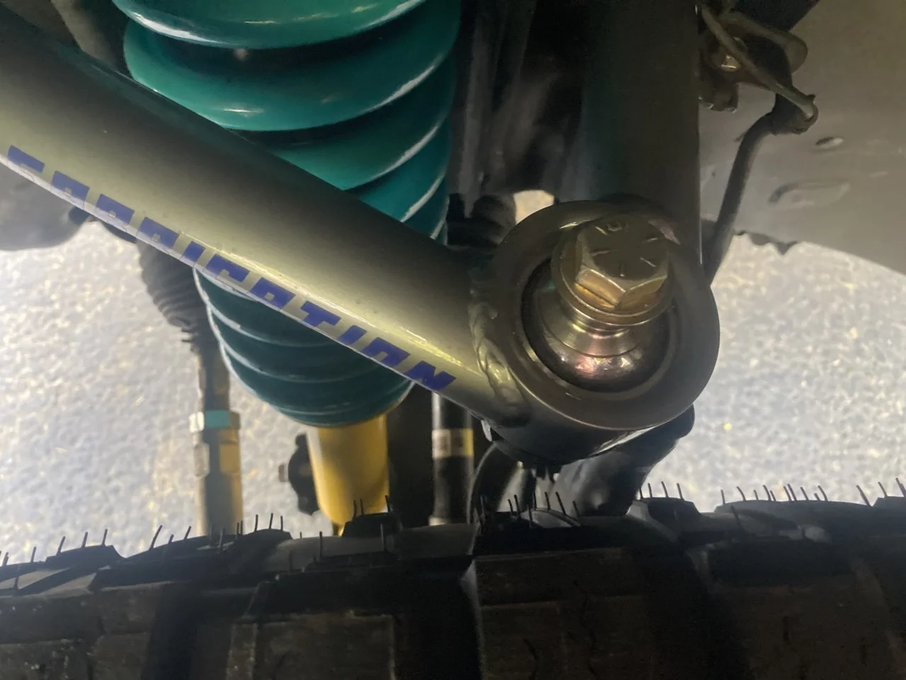

I think you'll find you may need more offset? Wide tires are great, but when combined with 34"+ tall tires, clearance against UCA can be an issue. Particularly with full lock in compression. I think this is also true for tundra arms. Something to watch, and there maybe aftermarket UCAs that provide enough clearance.

These particular tires run much narrower than a typical 315. They are more like a 285. Im hoping they will be ok, but I’ll guess we will see.

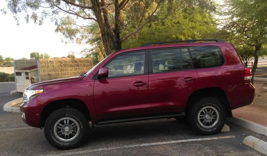

This is a pic I found of a 35x12.5 on a RockWarrior wheel on a Tundra. Its an aftermarket UCA but there is still a good amount of clearance there. So i think I should be ok with the narrower tire I am running.
I've the Camburg Kinetik Tundra UCA. They're billet and clear the ball joints fine. However, they're rubbing at full lock on the foward part of the arm. Total Chaos UCAs are in a box here at the house waiting to be installed.
