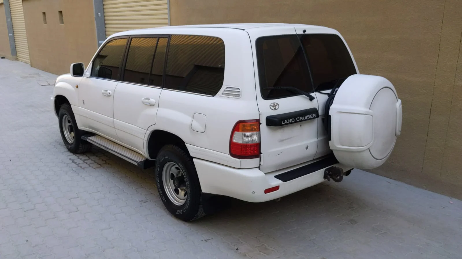

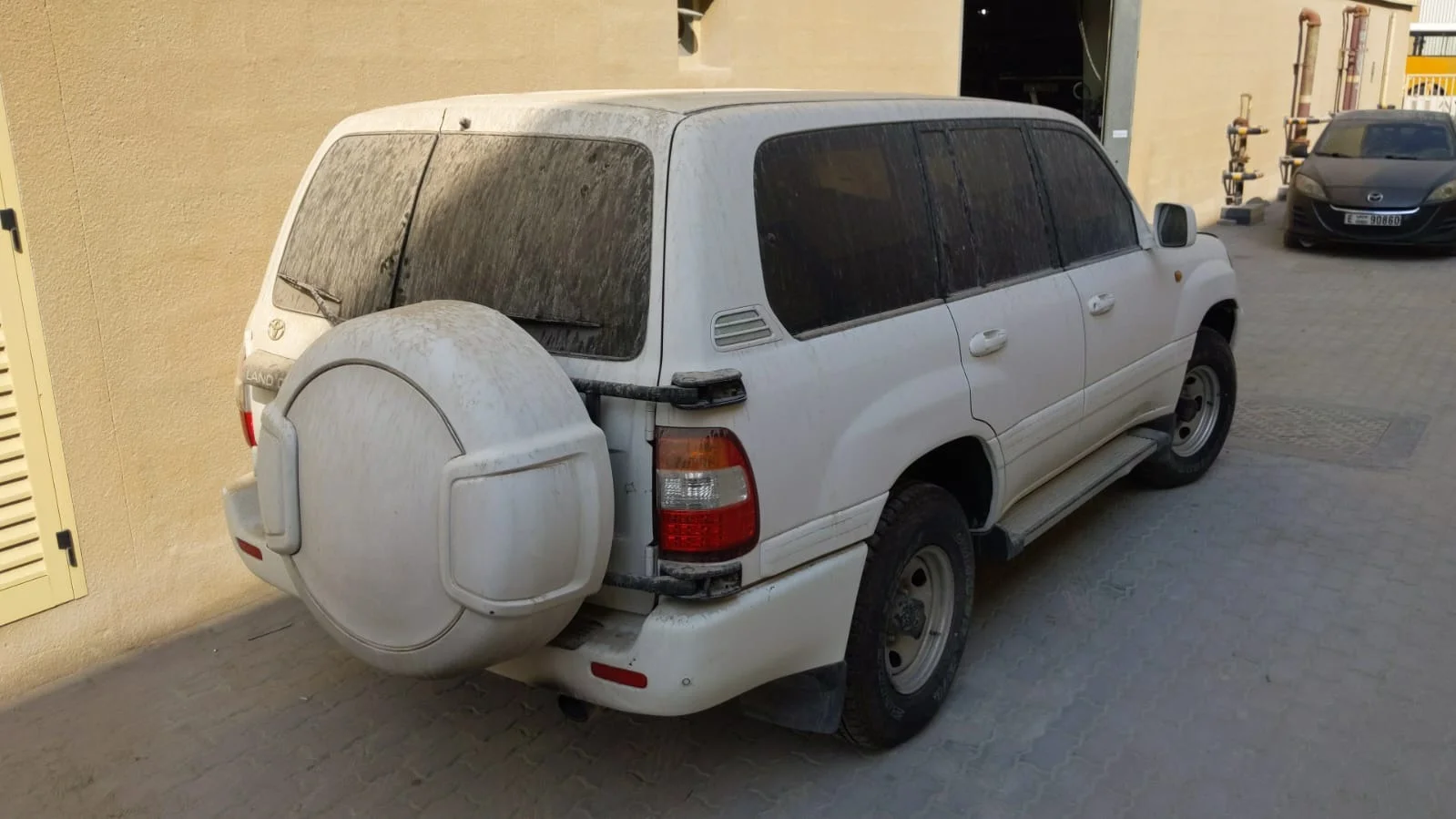

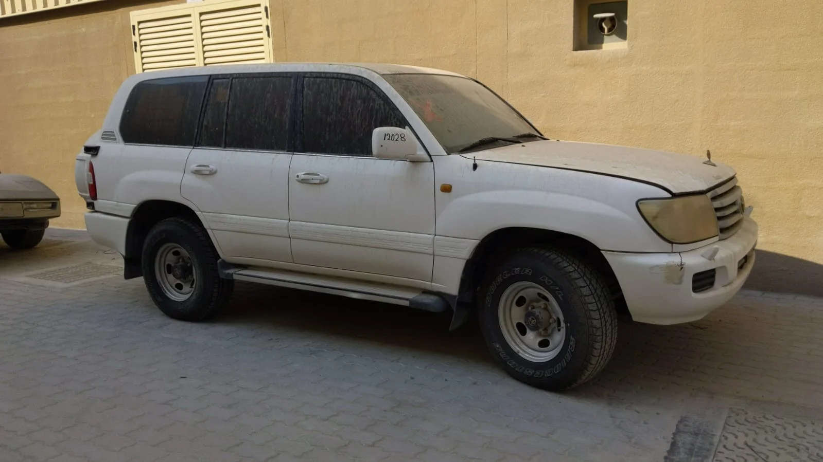

Today the flatbed came with the diesel 105 and I had my first real look at it.
I was nicely surprised to see that the tires were less than 3 years old.

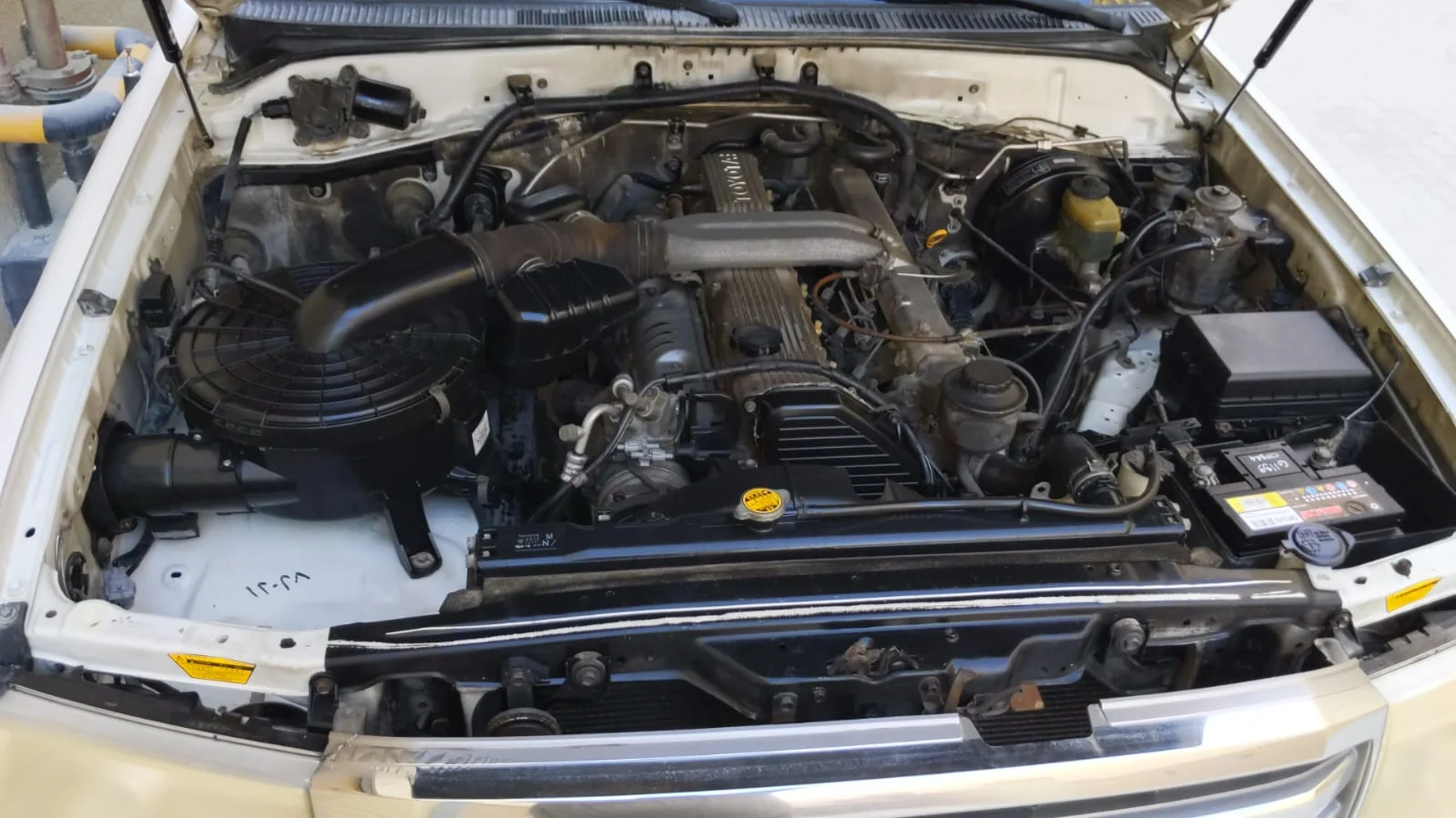

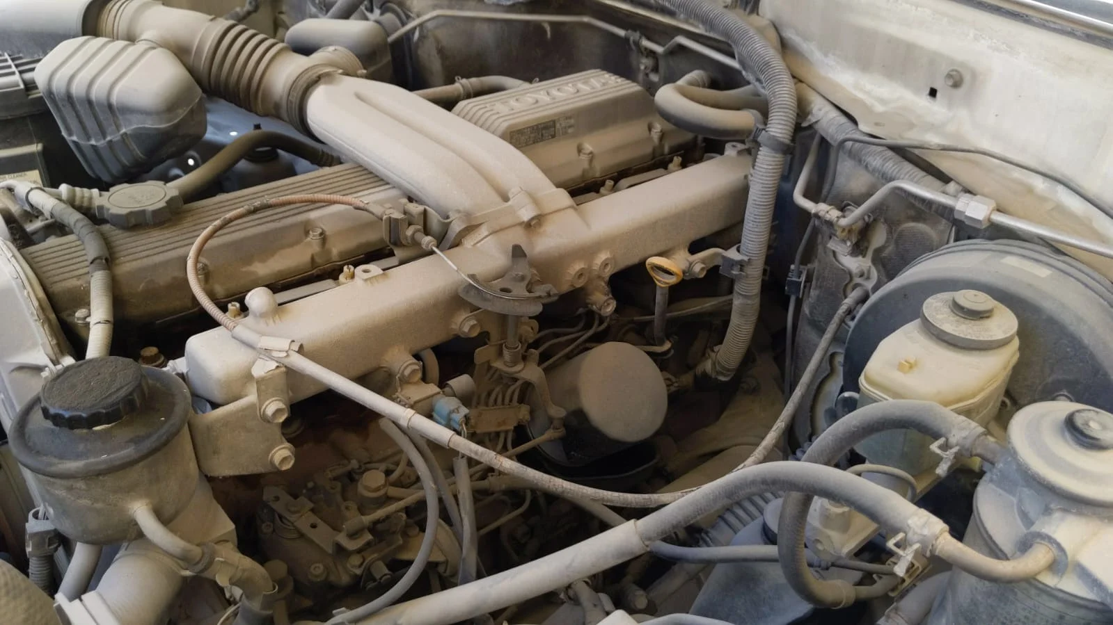

The engine looks very un-messed-with!
I don't think the AC ever has been touched--a rarity in the Middle East

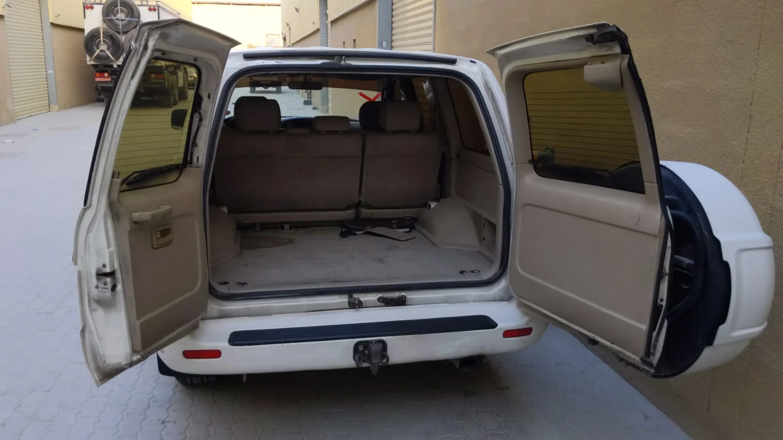

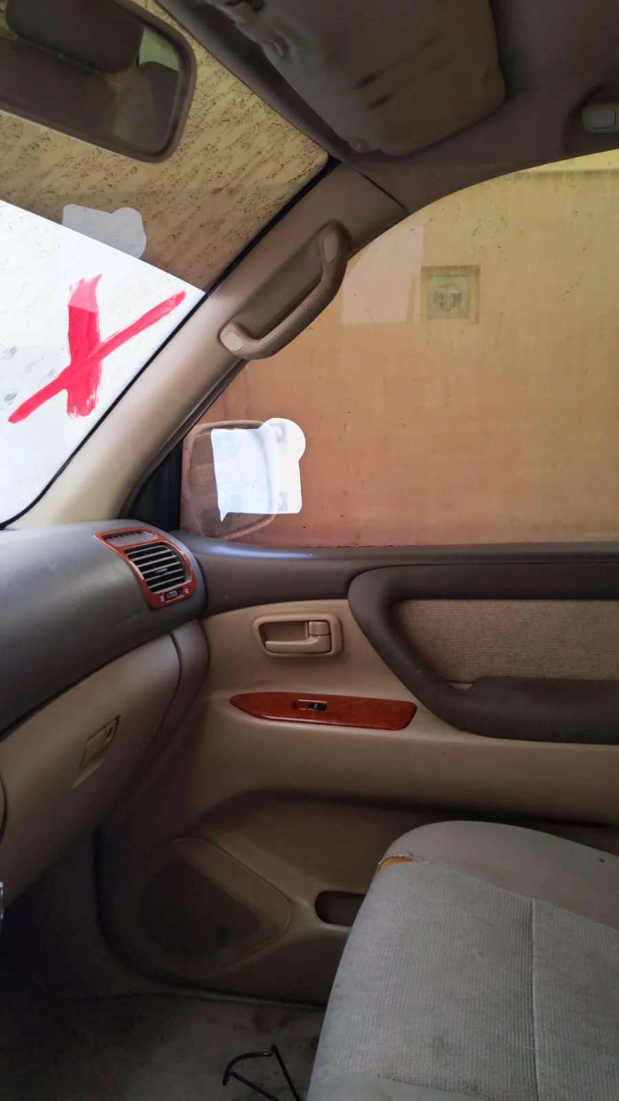

Inside is interesting. Looks pretty much like an ordinary sedan but it has a clip for a radio microphone and REALLY tinted windows. So tinted that someone actually cut out holes for the rear view mirrors.
Headlights need a bit of TLC

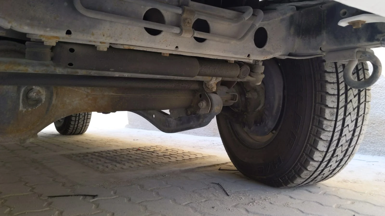

Birf balls look about the way they should.
And the barn doors look good.

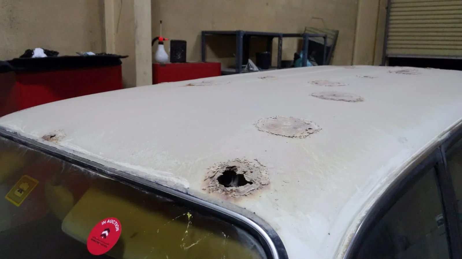

But I agree with you; it surprised me too that rust is a thing in the desert. Most of the 80s have rear window rust damage. Here's an extreme case that I don't like to talk about.
Looks nice, right?
Until you look at the roof
Strangely, the roof is about the only place that got this. Interior is very nice. I'm still trying to figure out how to approach this. The rear passenger door has a good sized dent in it but is a manual carburated late 80 with barn doors and I bought it at auction without being permitted to see it in person (they blame Covid for that), and I had no idea I would find this. Even the head liner is in good shape.
So, yeah, rust in the desert is a 'thing'.

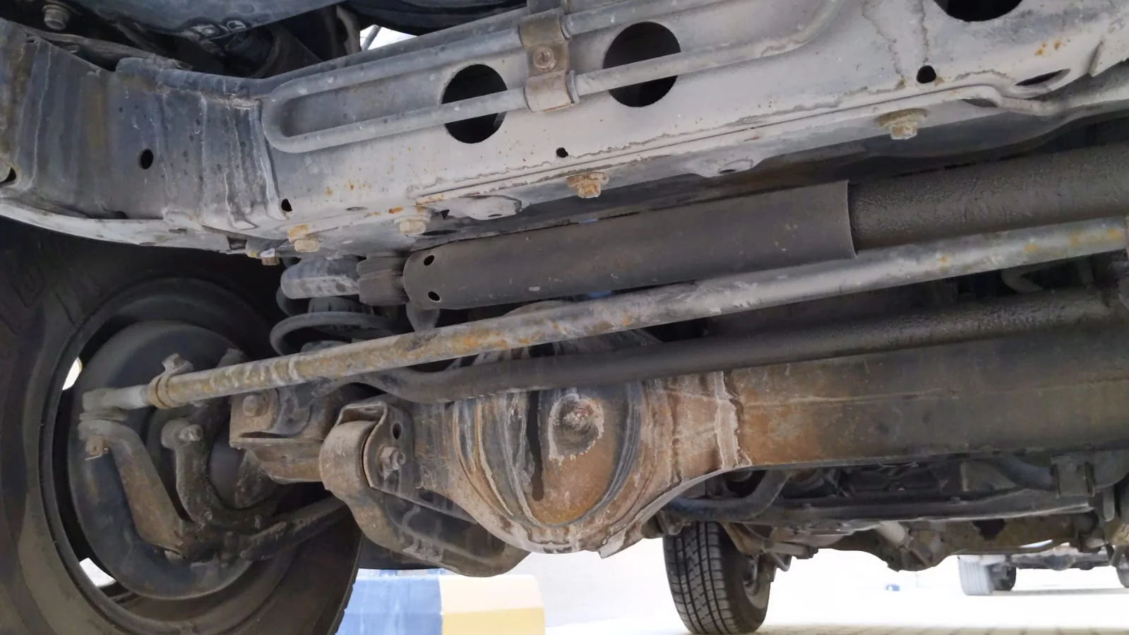

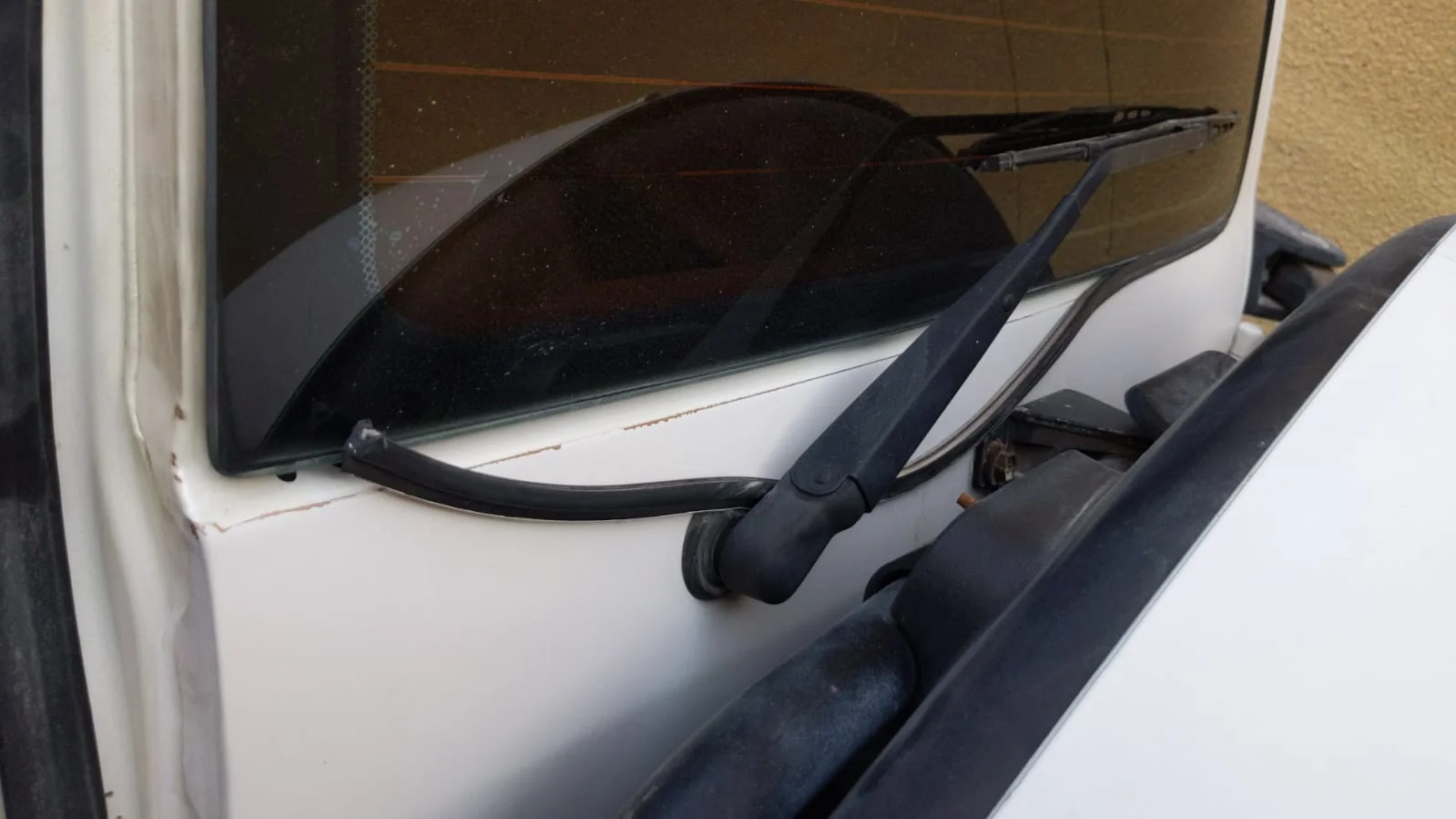

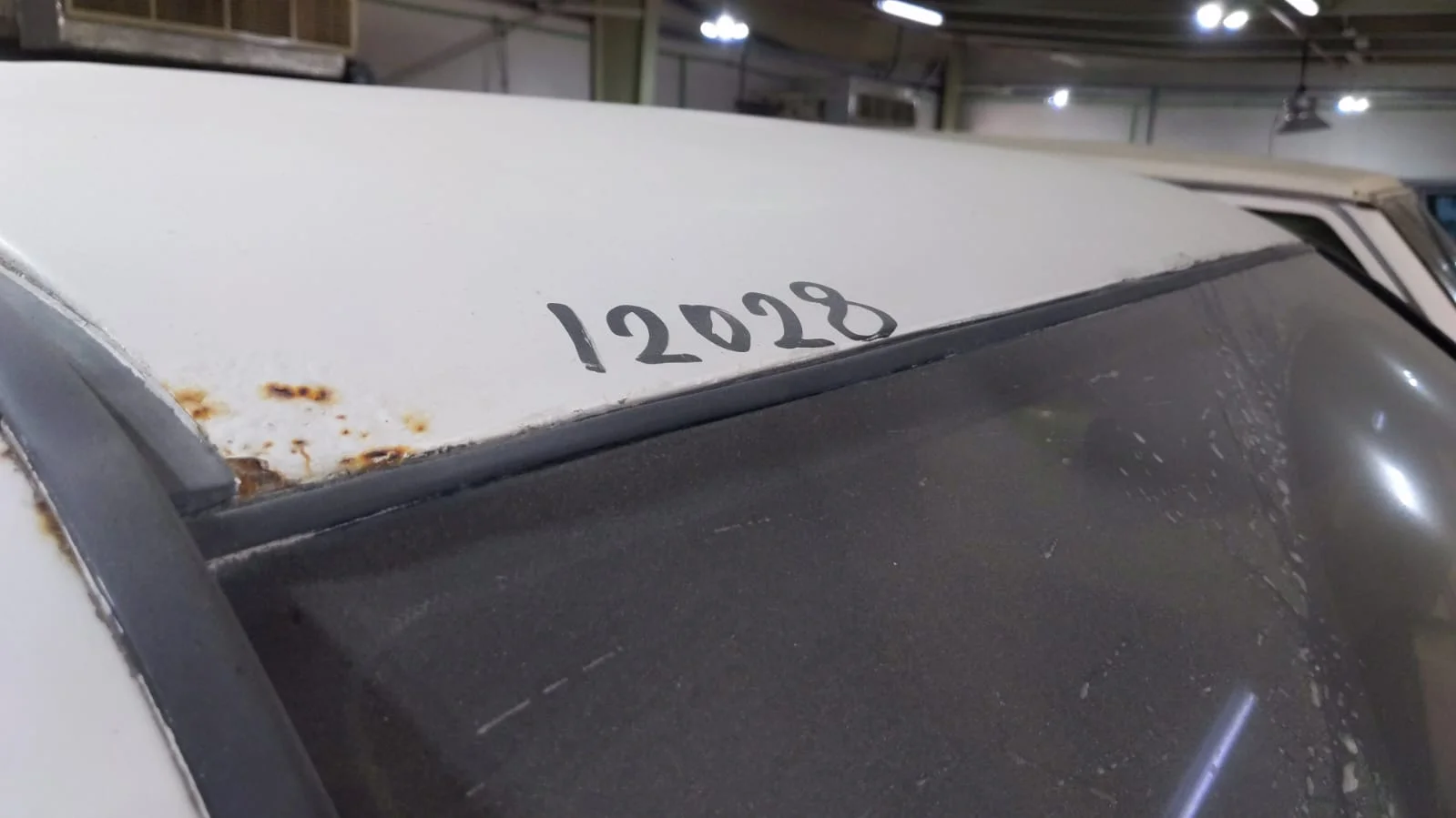

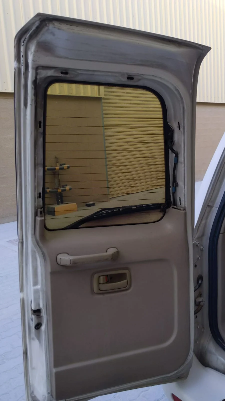

I hired a company for 55 USD to go and clean the truck up so that it is more pleasant to work on, and so I can see what I am dealing with. Then I went to see the results this afternoon.
There is some rust on the top of the windshield as well as a dent on the roof where someone must have stood on it.

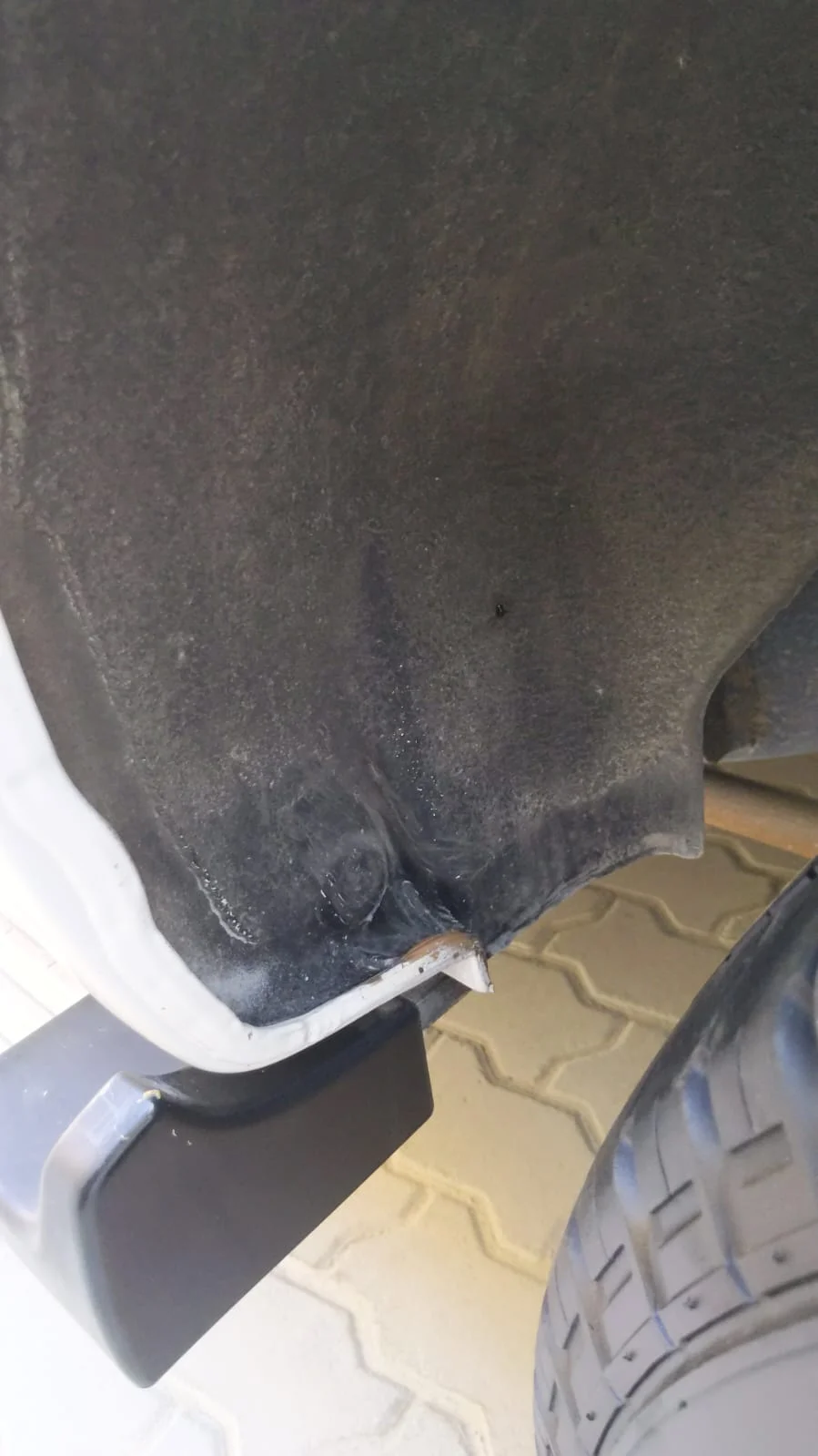

The leading edge of the rear wheel wells look excellent. I've seen a lot of rust in these areas on 100s.

Bits of trim are needed

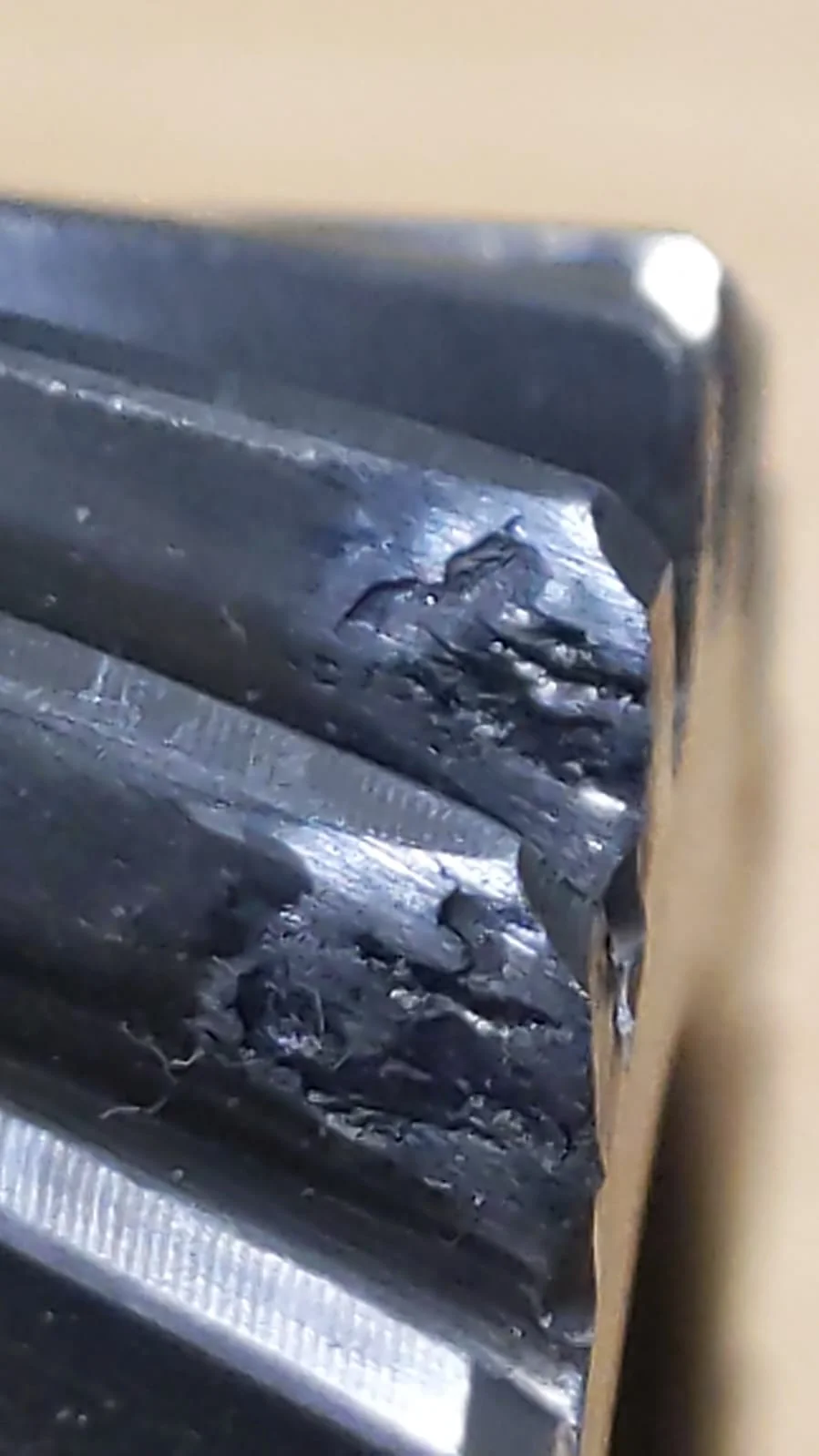

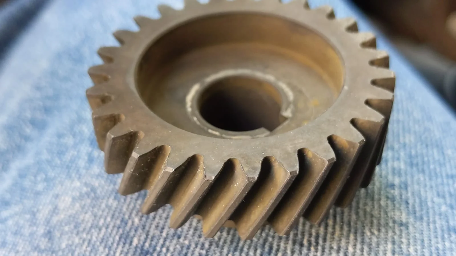

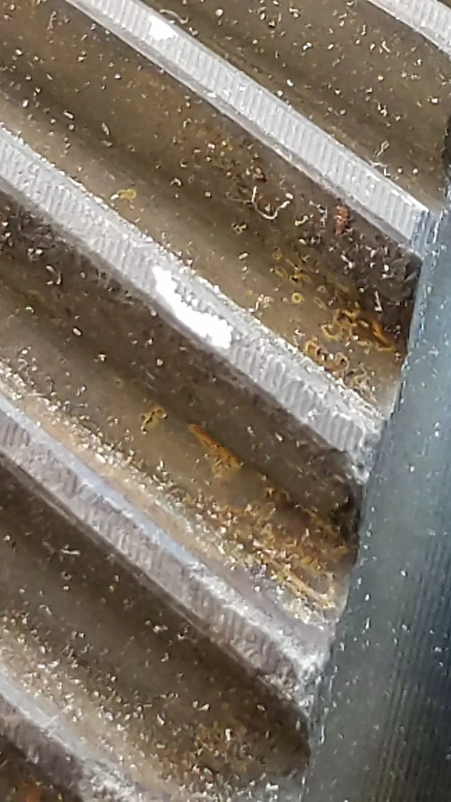

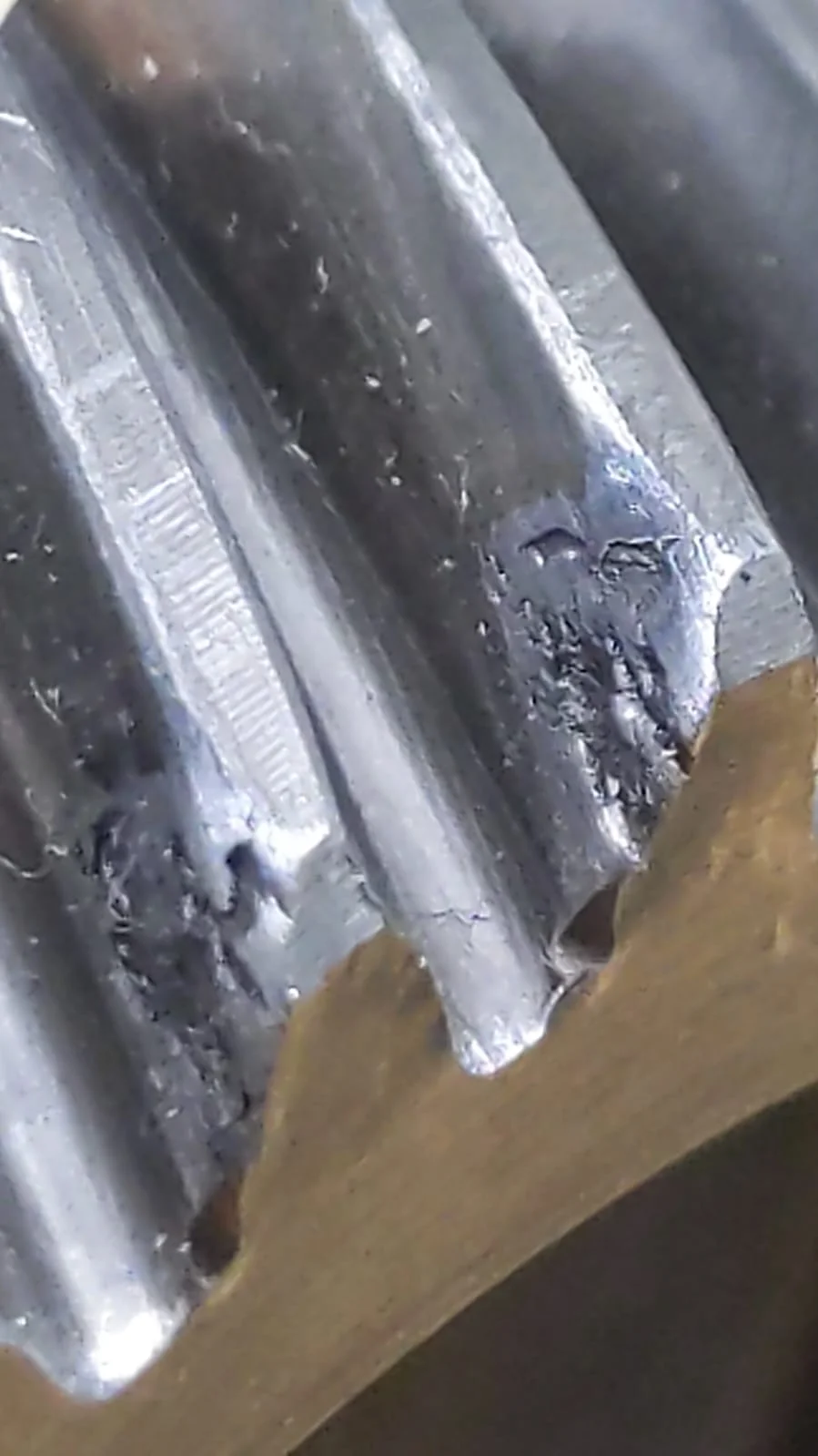

There has been progress. And a few more parts needed, including, interestingly, the drive gear for the power steering pump. I've never seen anything like it.
This looks to me like a bad batch of steel got used by the gear cutter back at the factory.

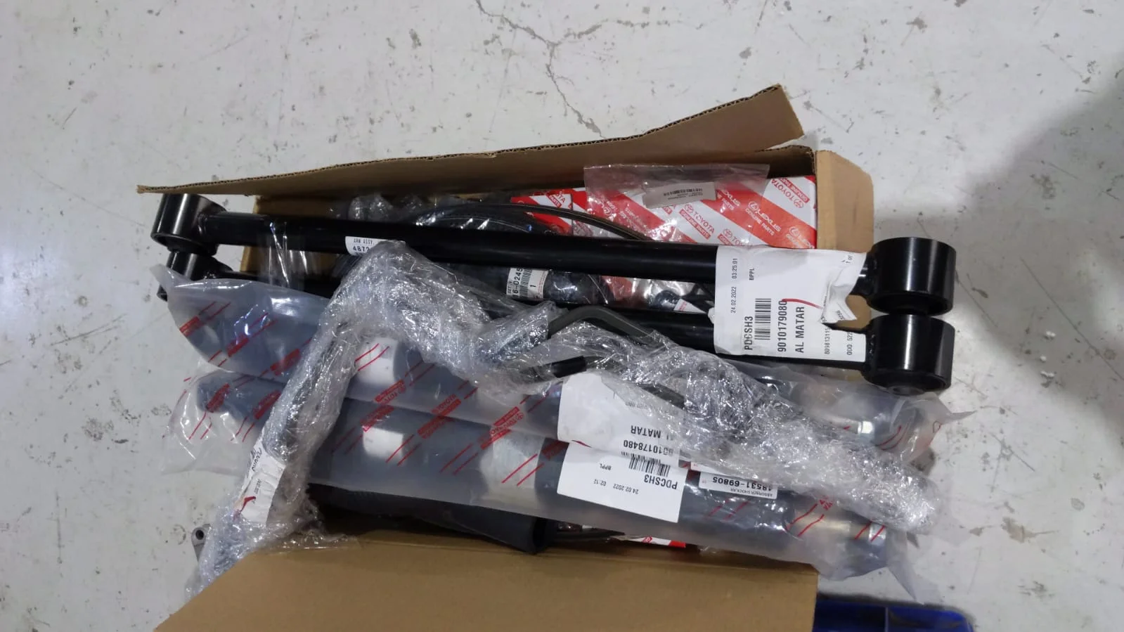

In any event this part was unobtainium. For this truck I'm trying to use all new, OEM parts. But I had to resort to going up to Sharjah and haggling with the parts guys up there. I was able to get a pretty good part for 125 AED or 35 USD.
The reason it is a little orange is that I pickled it in a little vinegar to get it really clean so I could take a close look. I'm going to get a new gear but put this one in and see how it goes after 6 months.

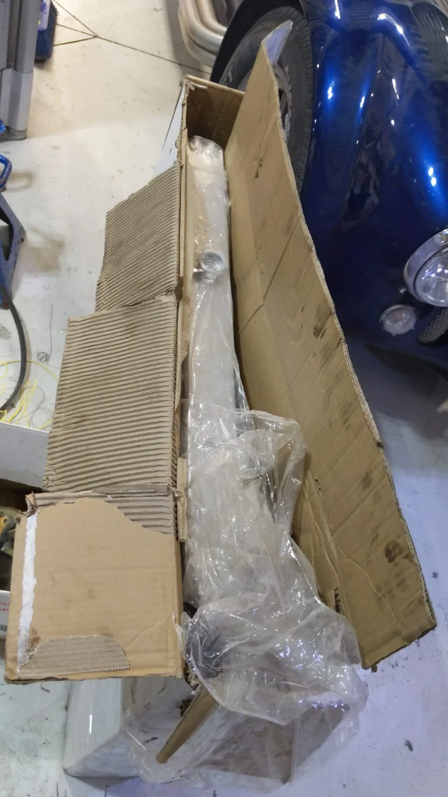

The new radiator is in, ready for installation
