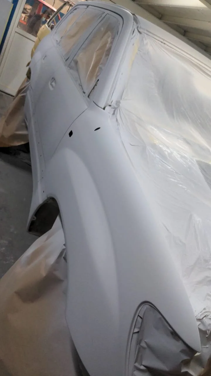

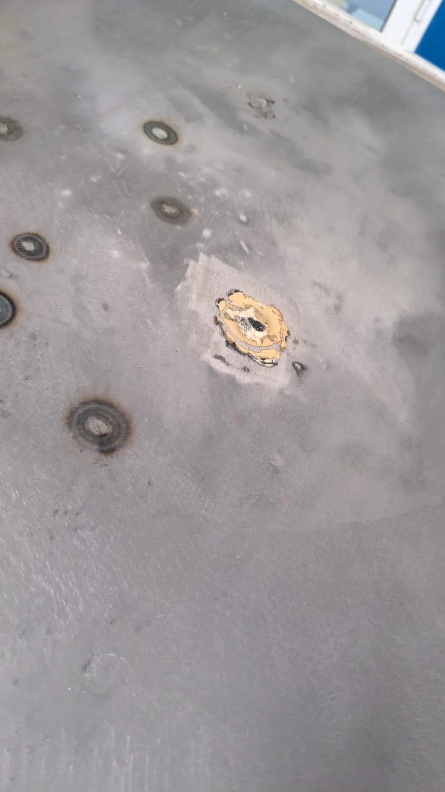

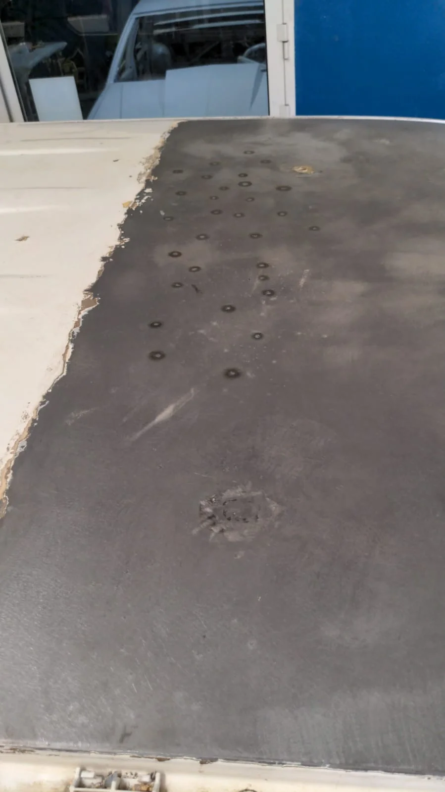

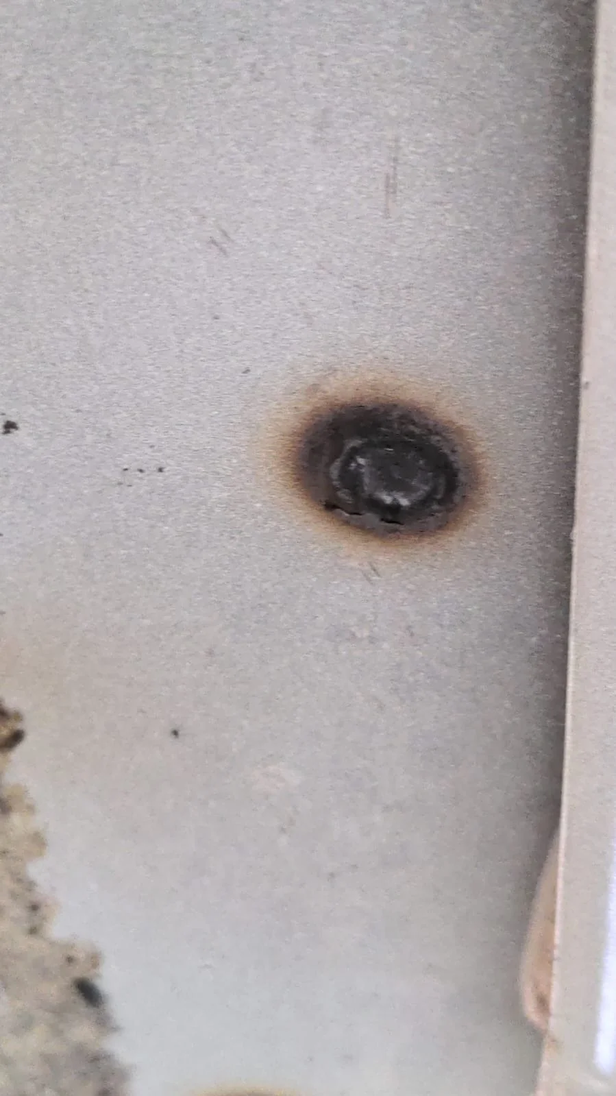

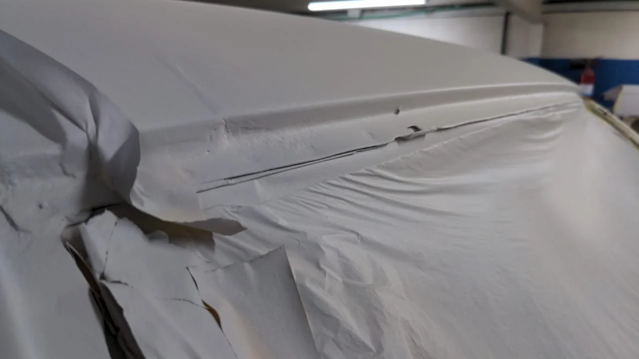

As they have peeled back the paint on the roof addressing a couple of minor dents and generally assessing, they have found a myriad of holes filled in with bondo! I mean a LOT of holes:
So in addition to the fairly professional braised in mounts for the bubble bar, they apparently were screwing down something with a bunch of self tapping screws.
The guys have already been welding up all the holes. Holes I did not even know were there but very likely would have been a real disaster in the long run. I am glad these guys are so thorough.

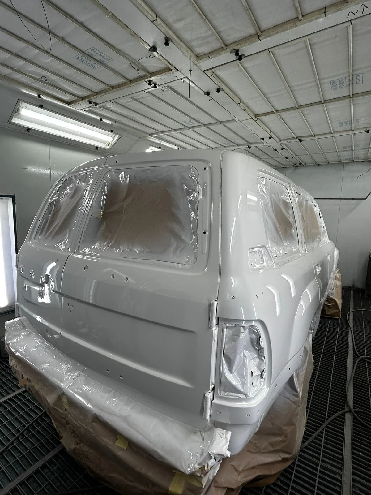

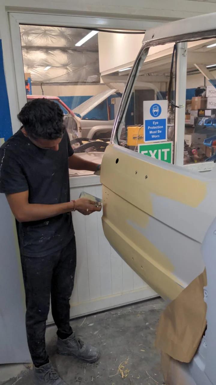

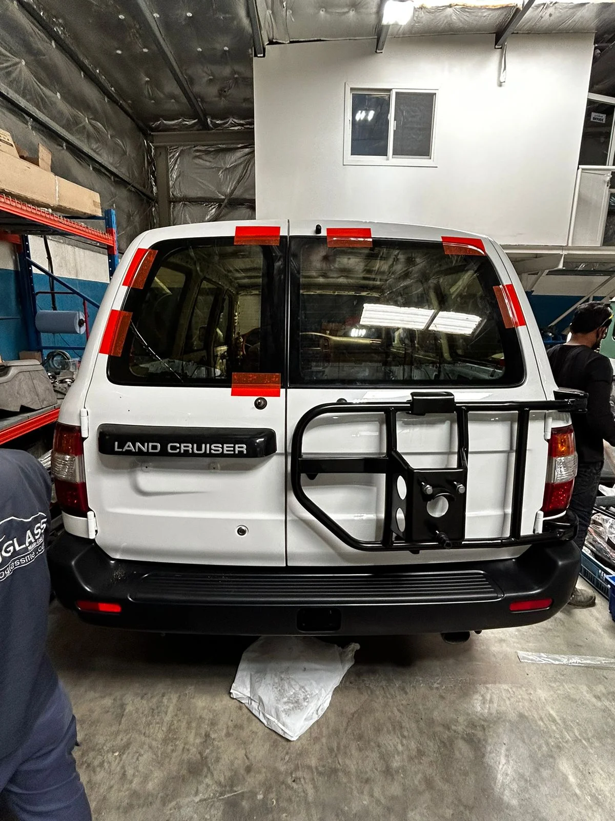

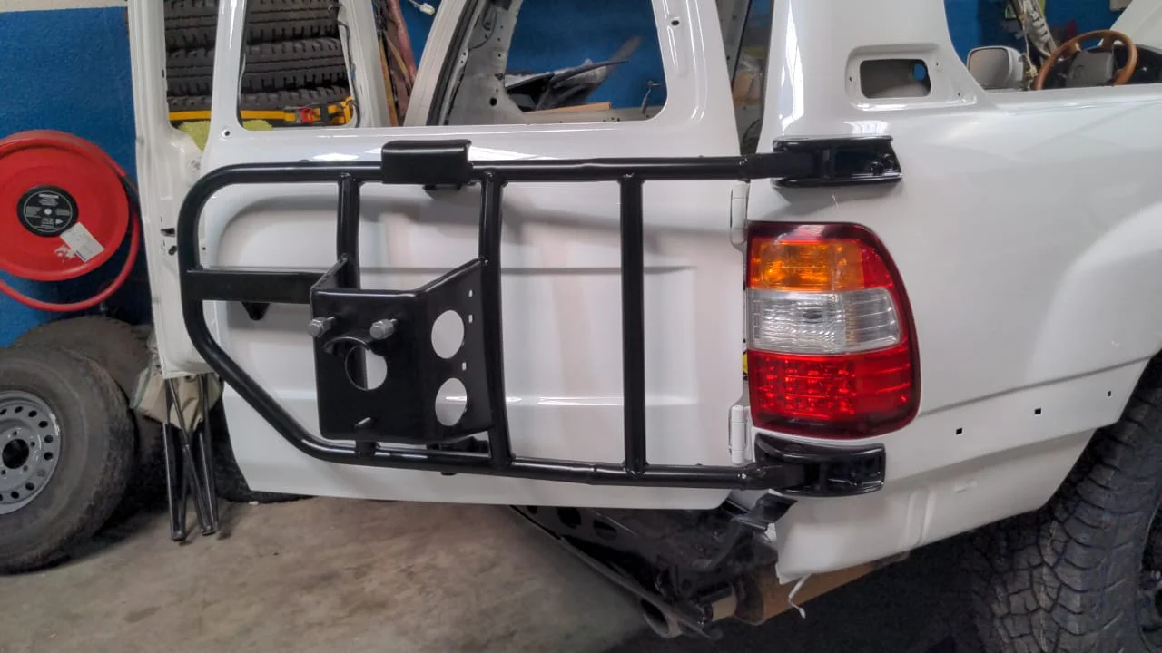

Here is another close up of the really great work on the right rear barn door:
There are still a few dents here and there:

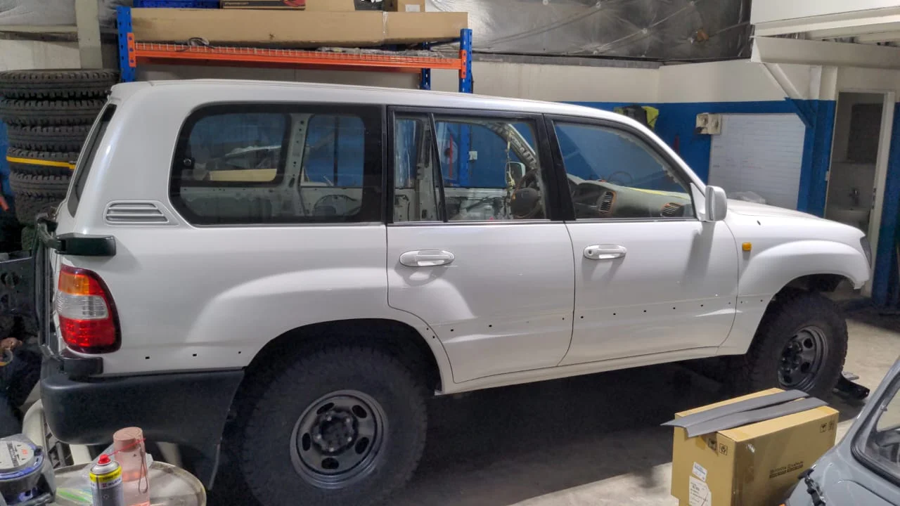

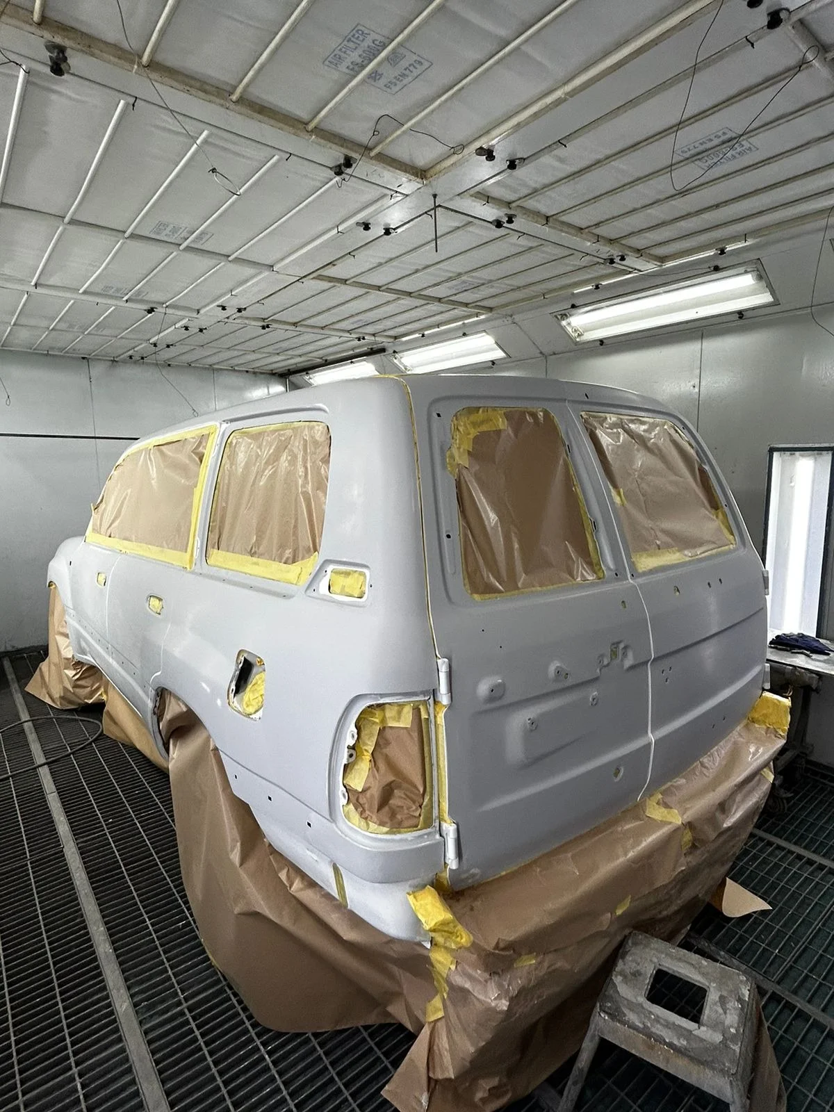

And just for fun, here is the truck next to my 105. And yes it is a Land Cruiser.
Progress continues apace.

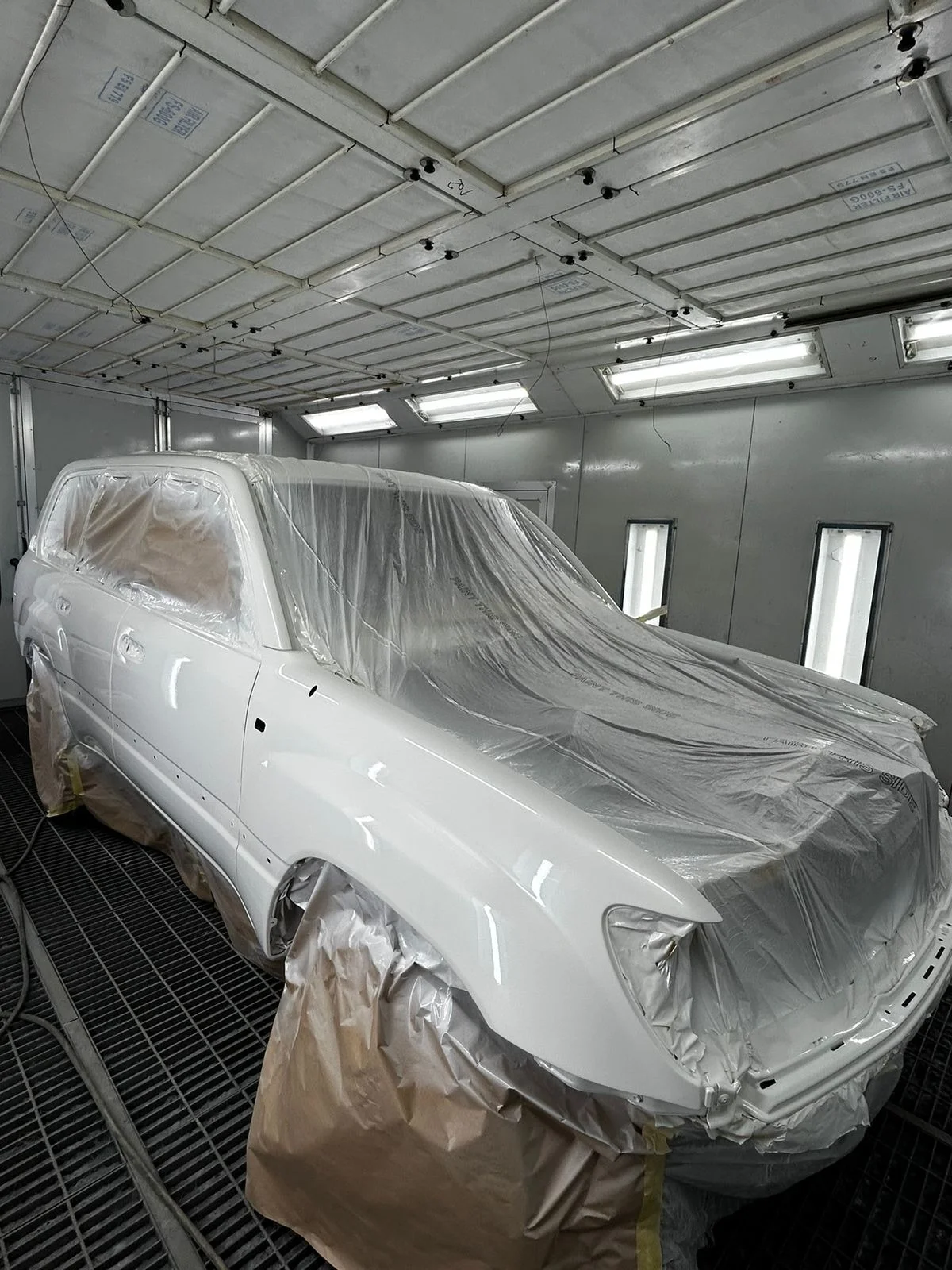

The color code on the dataplate is 062 which is White Pearl Crystal Tricoat. Looks like it was painted early on in a sort of metallic bronze. This is a color that you see here for presidental guard trucks, or trucks guarding embassies.
To keep things simple I probably will stay with the factory tricolor white. But what do you think?

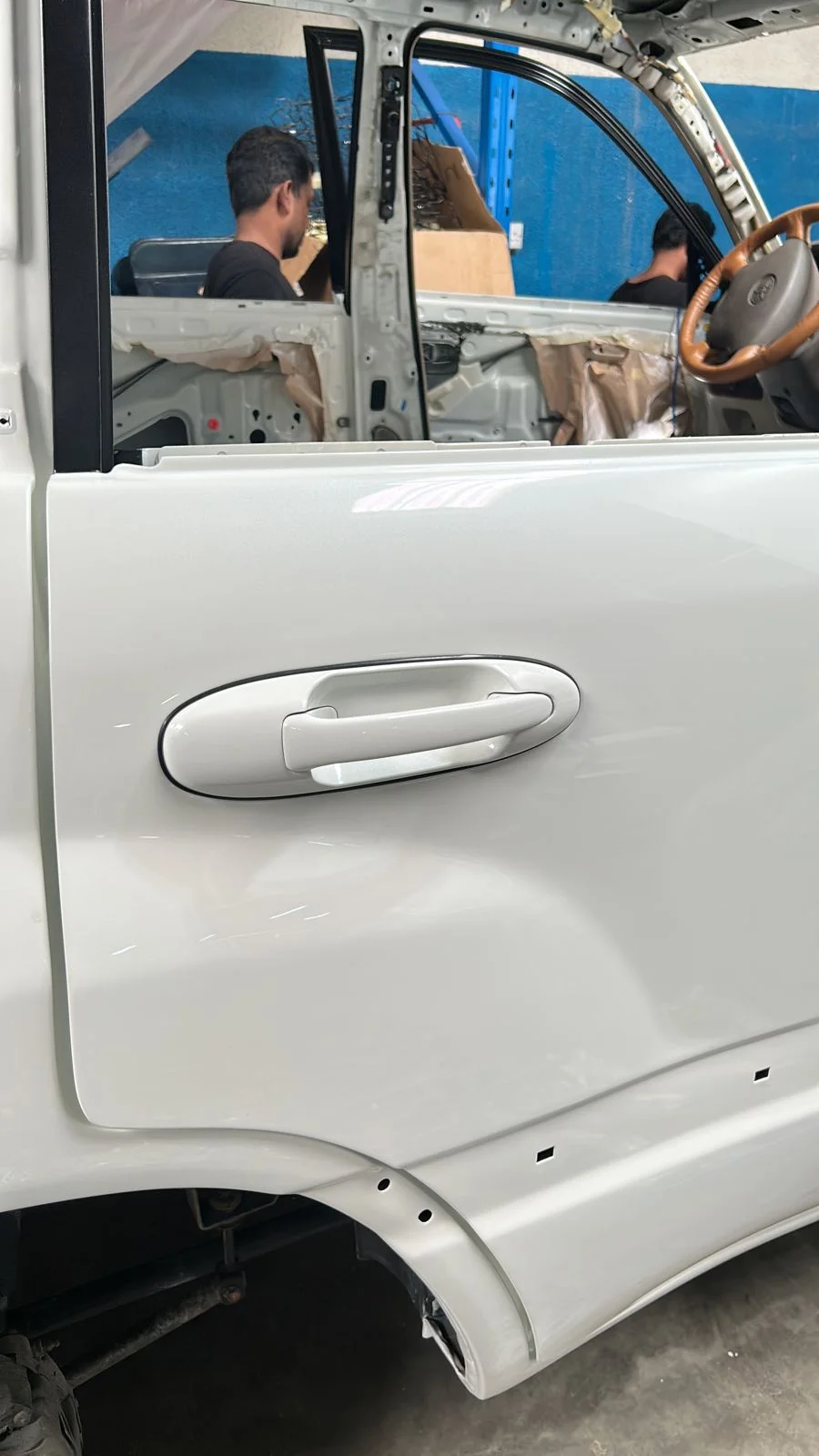

I dropped by the garage again to see how things were going.
Geez the thing looks brand new. Well done!
Thank you. It's actually been pretty interesting and quite a lengthy process.

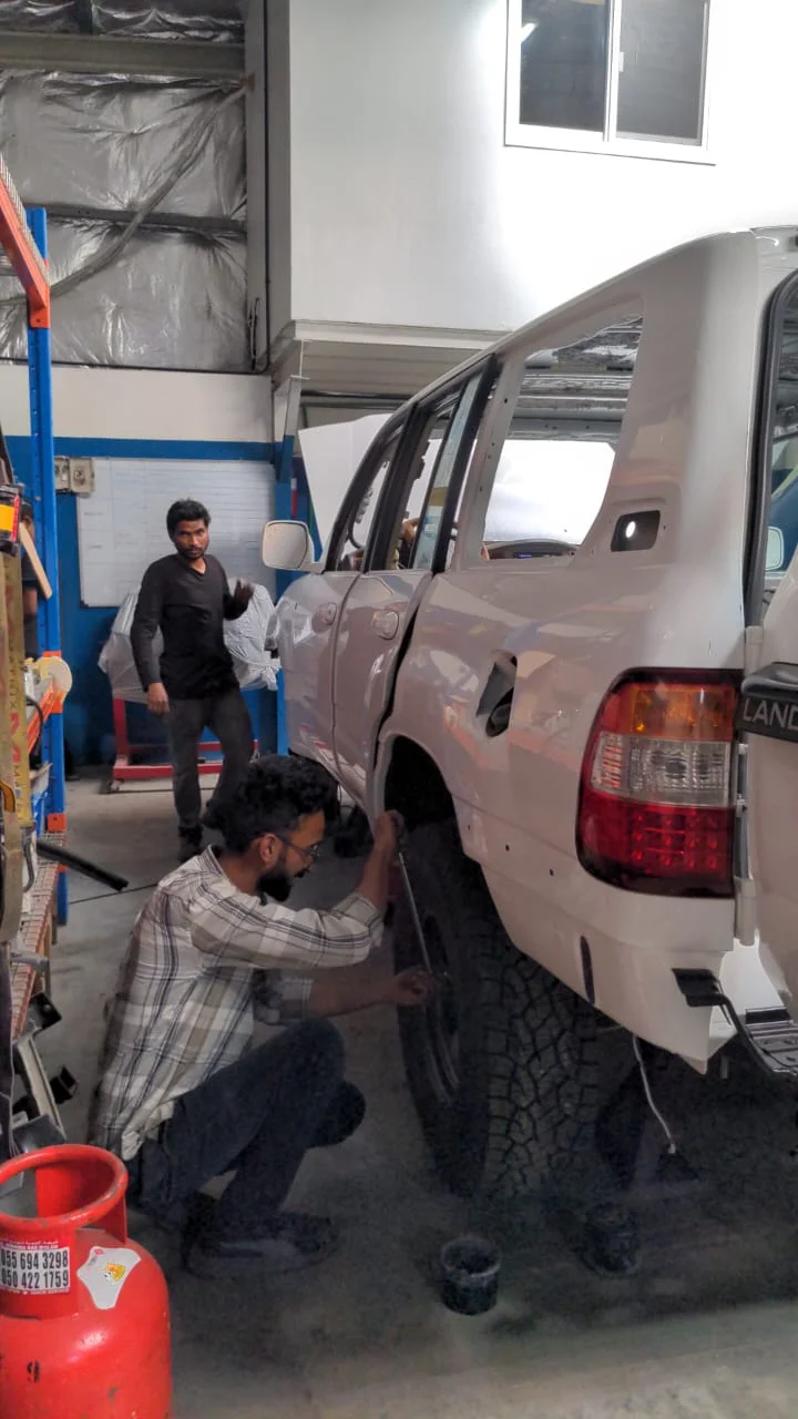

The first stage was to basically just get it running and driving and past registration inspection so that I could drive it around.
The next was to go through it mechanically quite thoroughly and replace all of the things that I didn't like, like the old radiator which had a small weep in it, and all the relevant hoses. And some really good engine mechanics looking at whether the engine had any issues even though it only has 200,000 km on it
We're now in the third stage which is where we're basically taking it all apart from a interior and exterior perspective but not the mechanicals. And I decided to really splash out on this one because it is such a unusual and special car. So I'm trying a place I haven't used before which is definitely higher up on the economic spectrum that I normally operate. But the outcome is really showing the value.

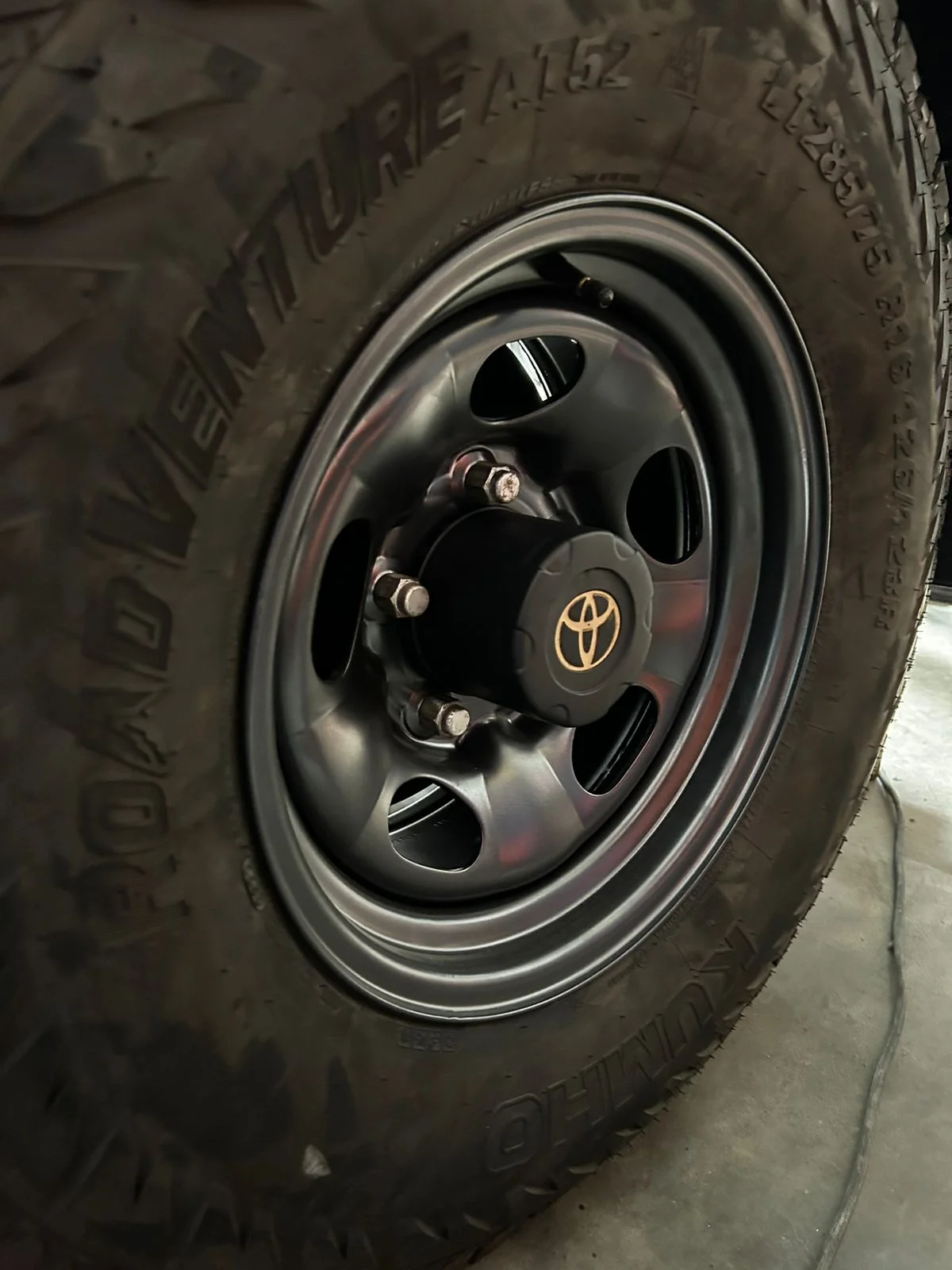

I'm so pleased I'm just going to post some photos.

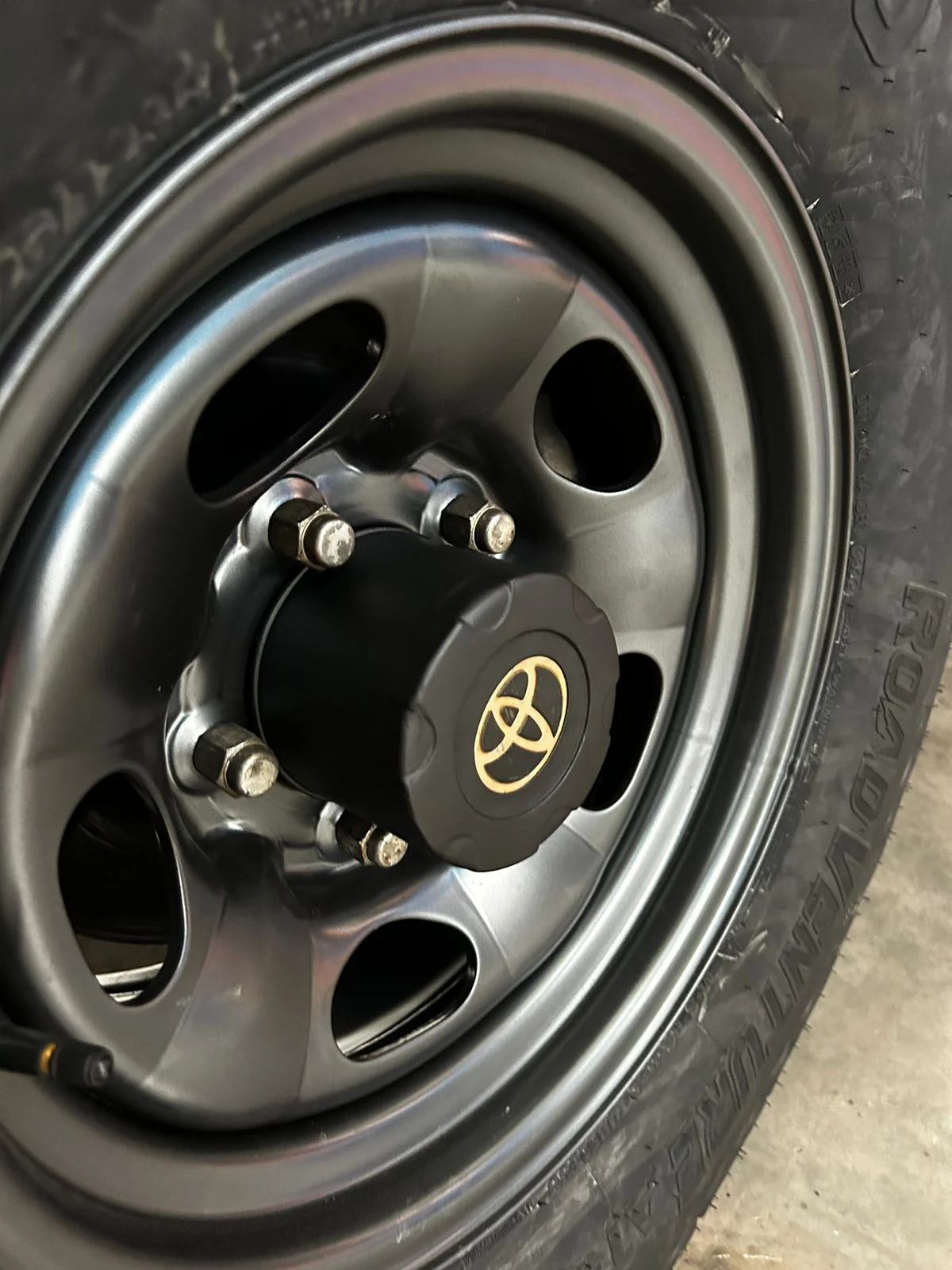

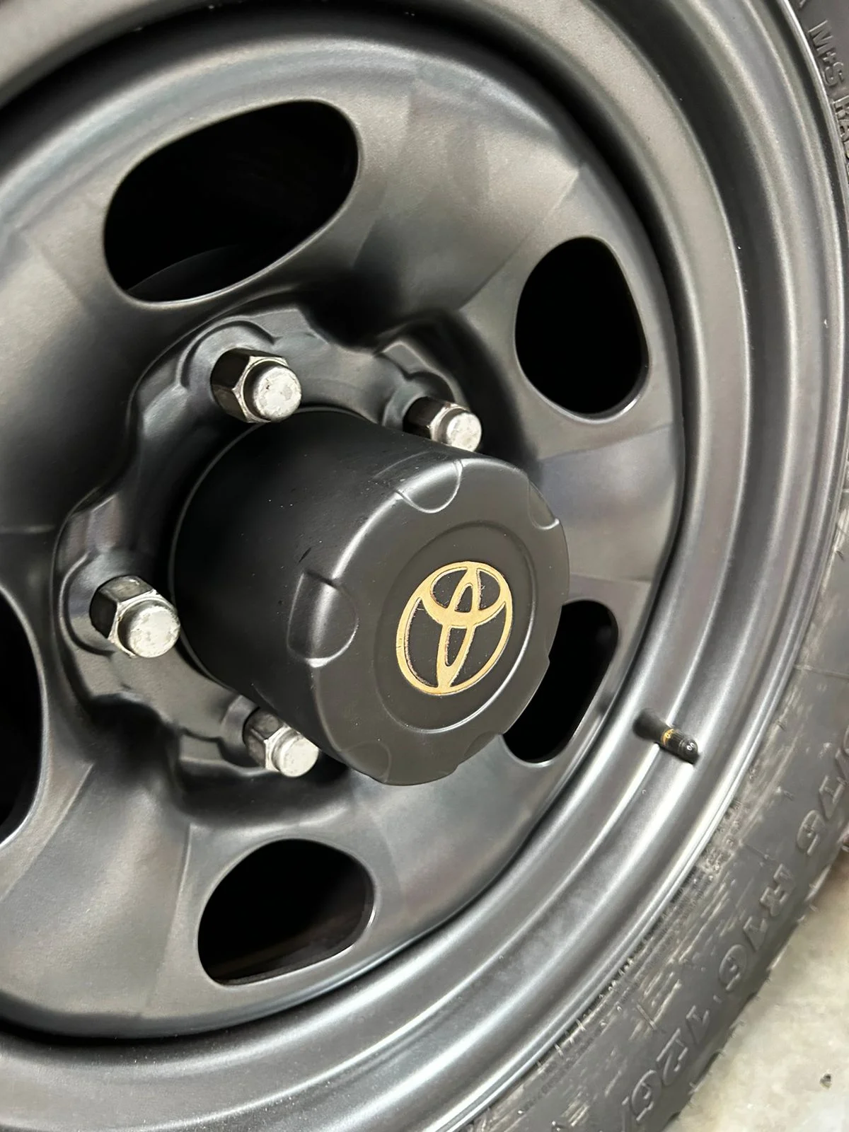

I'm actually amazed at how they were able to bring back the original hub covers. Here is a before photo:
Admittedly they were pretty good before.

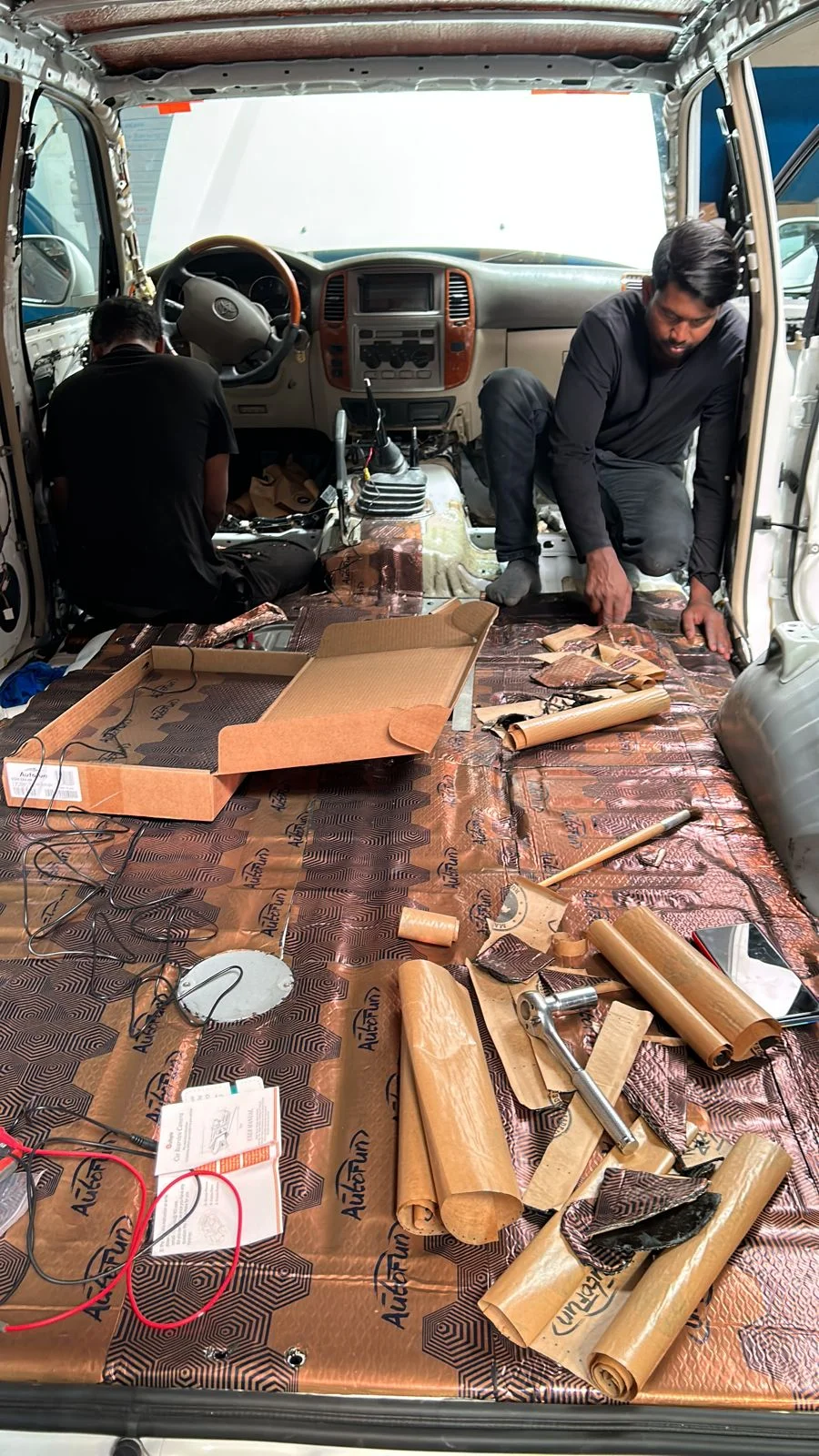

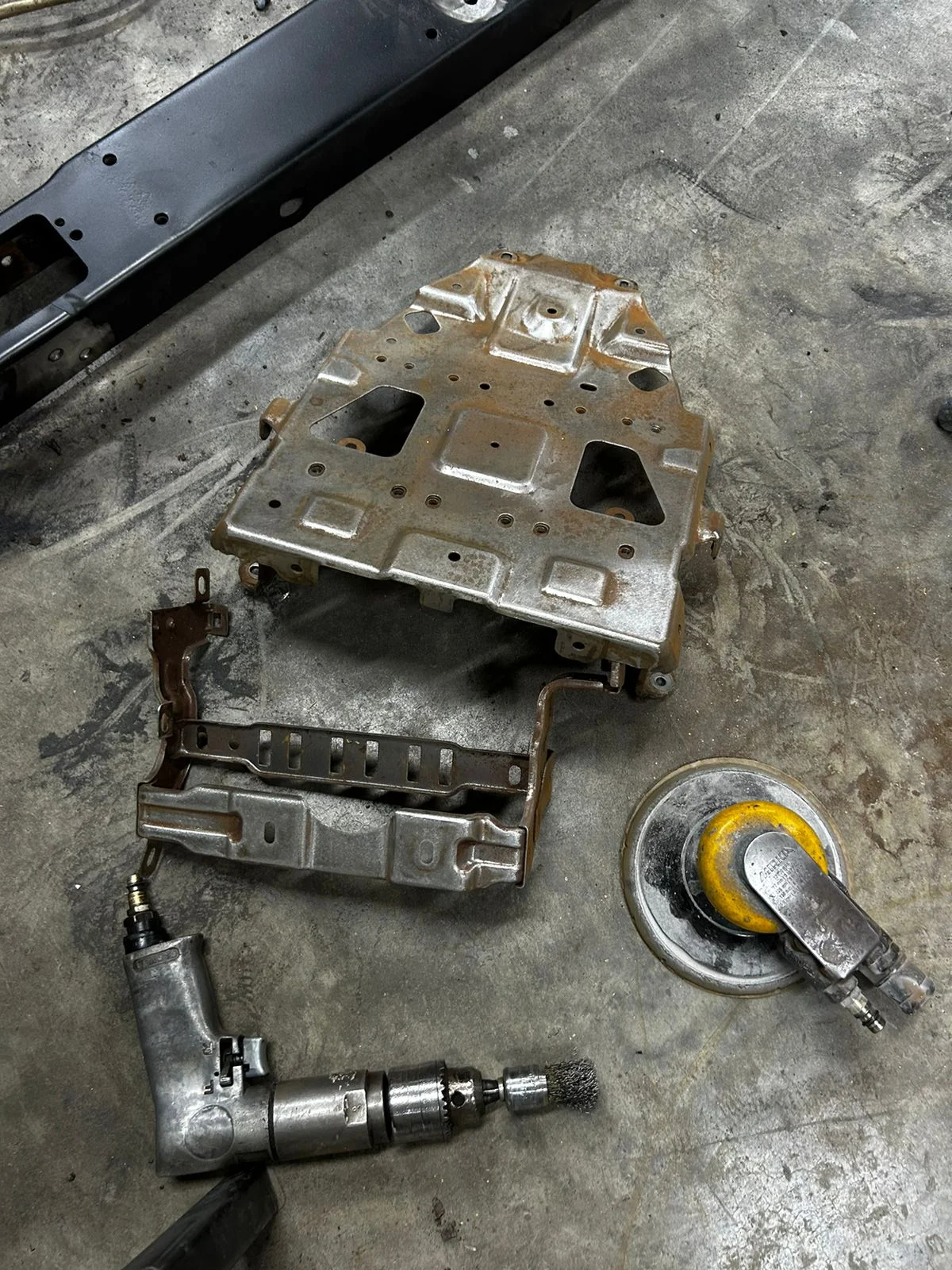

The unpainted sheet metal under the console had some pretty serious surface rust. I asked the guys to pull it and paint. The next person in there most likely will be me.
floor insulation is complete
Roof insulation is complete:
