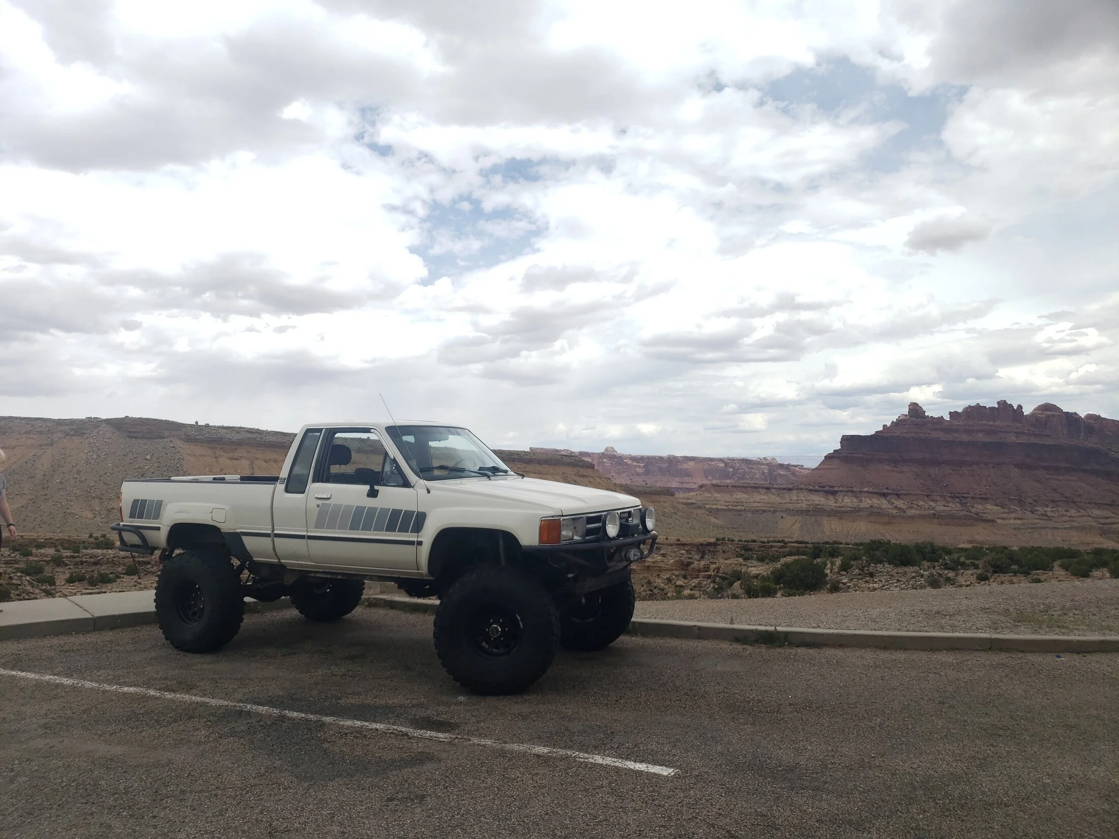

I've always been a Toyota guy. I got into Land Cruisers in August of 2020 after building an 85 Toyota pickup through most of my college years. That truck ended up with a 3RZ swap, an R151 swap, 2.28/4.7 dual cases, custom rear disc brakes, and twin locked with an E-locker retrofit in the rear. Here that is:

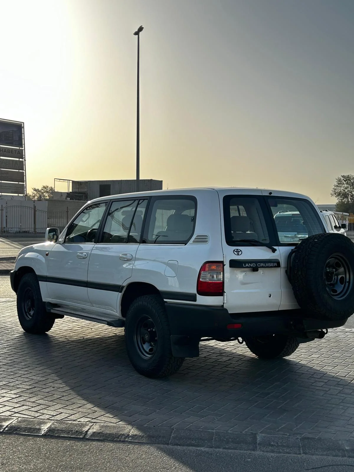

I want to do something a bit different on this 105. The Australians have some amazing takes on these trucks but due to their laws on modification I have yet to see one that is quite like many of the big 80s that we get here in the States. I am sure what I'm thinking exists, but I have not seen it. So that is my goal. I want this truck to have a 1HD-FT, an H152 swap, a 4" lift and ride on 37s. If possible I am toying with the idea of swapping in 80 series E-locker axle tubes and diffs so I can have the benefits that come with them.

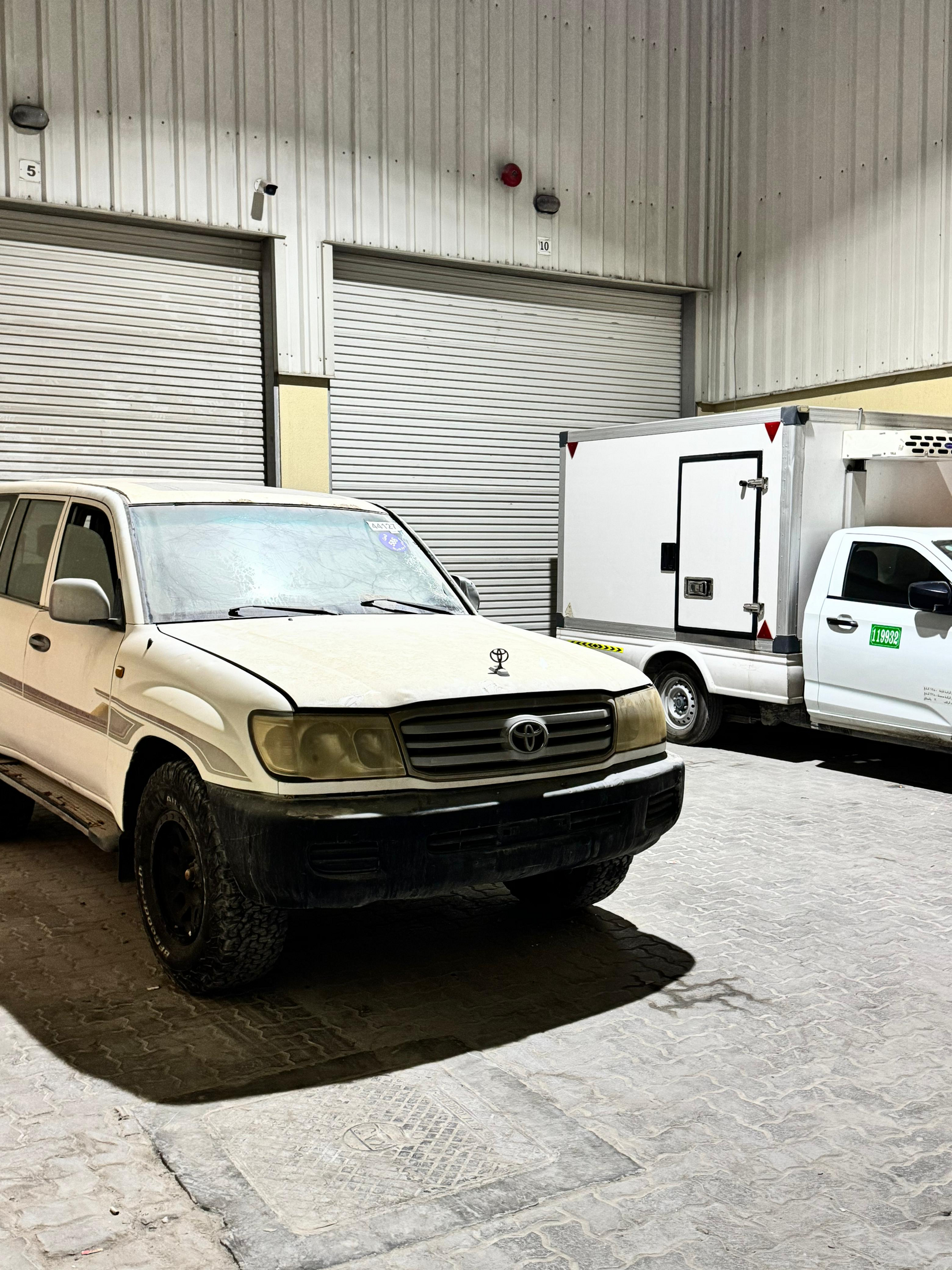

So here is the rig as it sits:
This is how the truck sat the day it was purchased. Now I know you're thinking this is a basket case. It is definitely that and I am here to tell you that it is actually substantially worse!
The hidden damage that can't be seen thus far includes a broken off key in the ignition, a main tank damaged by a forklift, a missing sub tank, and what can only be described as the worst hail damage I have ever seen on the roof.

This poor thing, an ex-UAE government truck, has been through the wars.

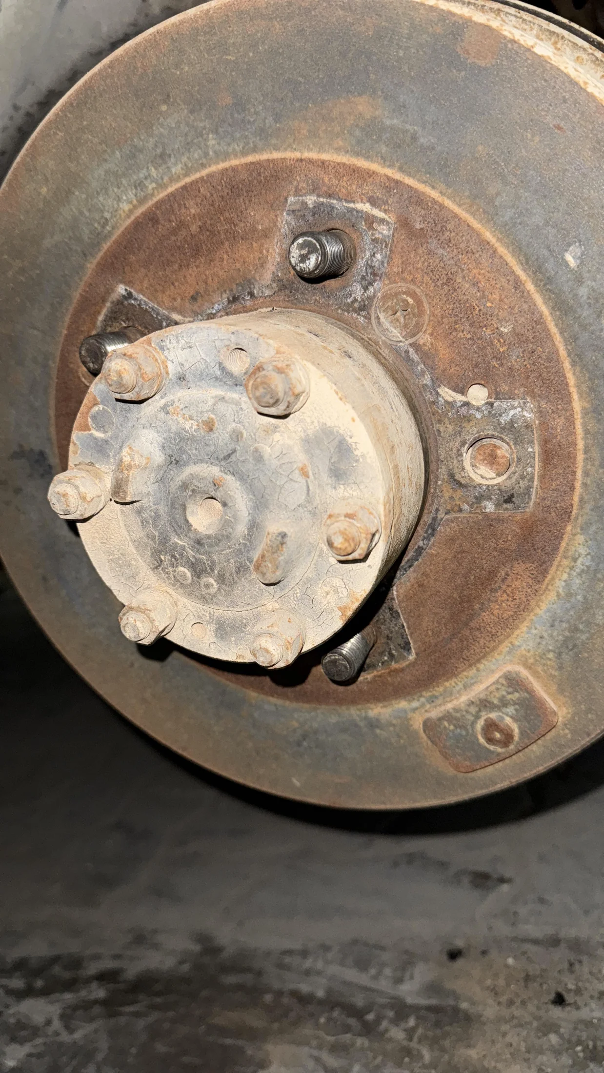

The issues range from regular stuff like missing wheel studs

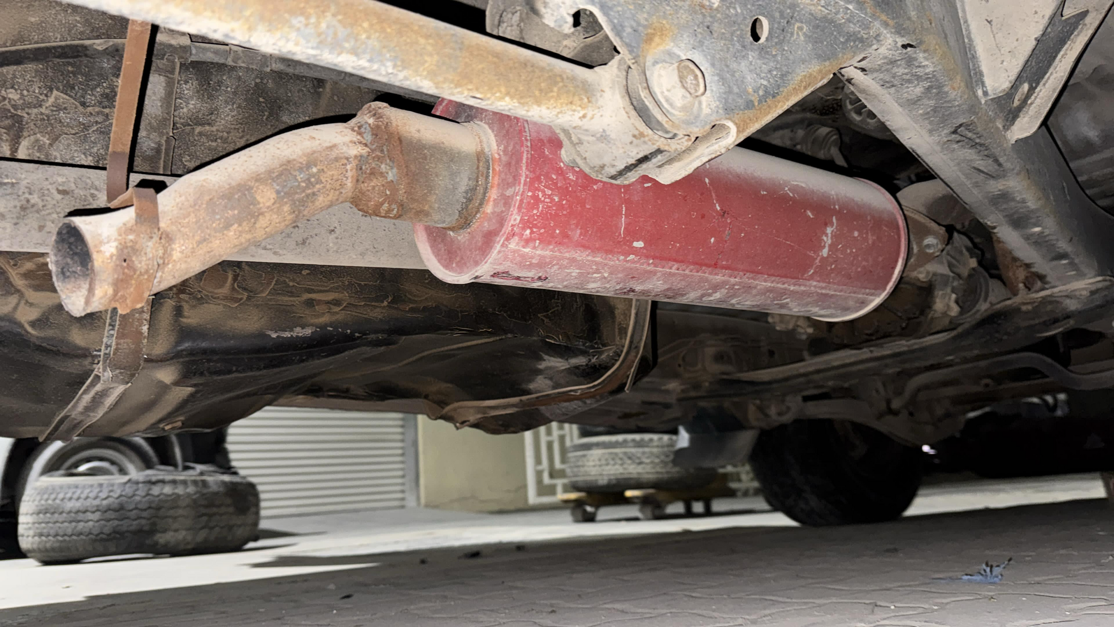

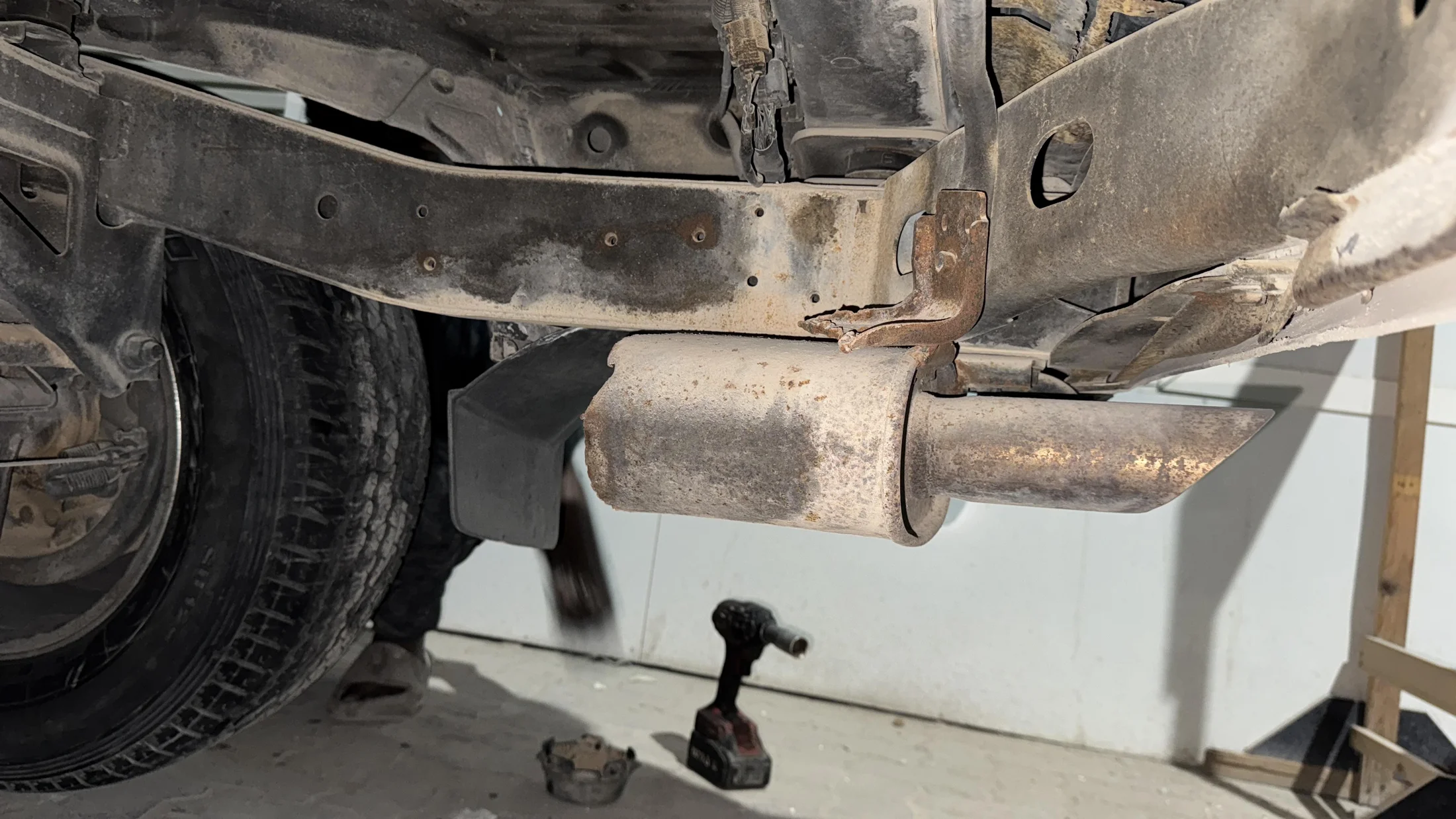

I would love to know the thought processes around curtting off only half of the exhaust resonator and then inserting this thing:
Exhaust just kinda comes out somewhere in the middle of the underside of the truck.

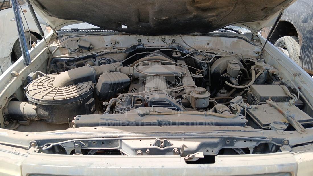

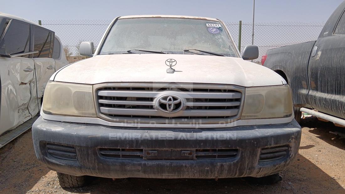

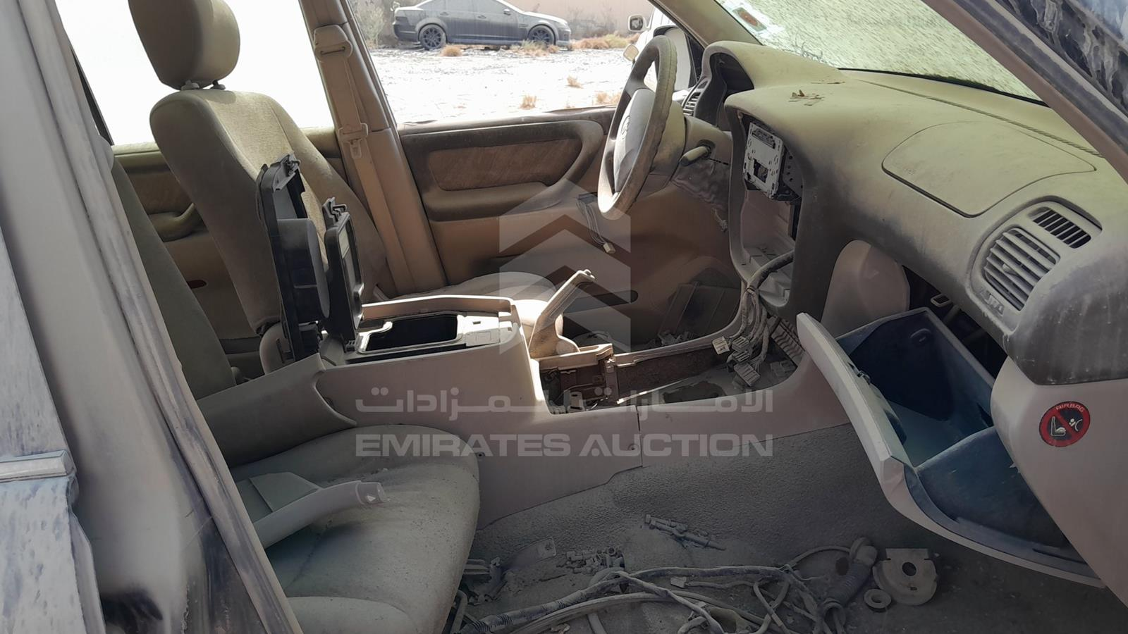

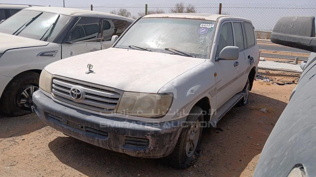

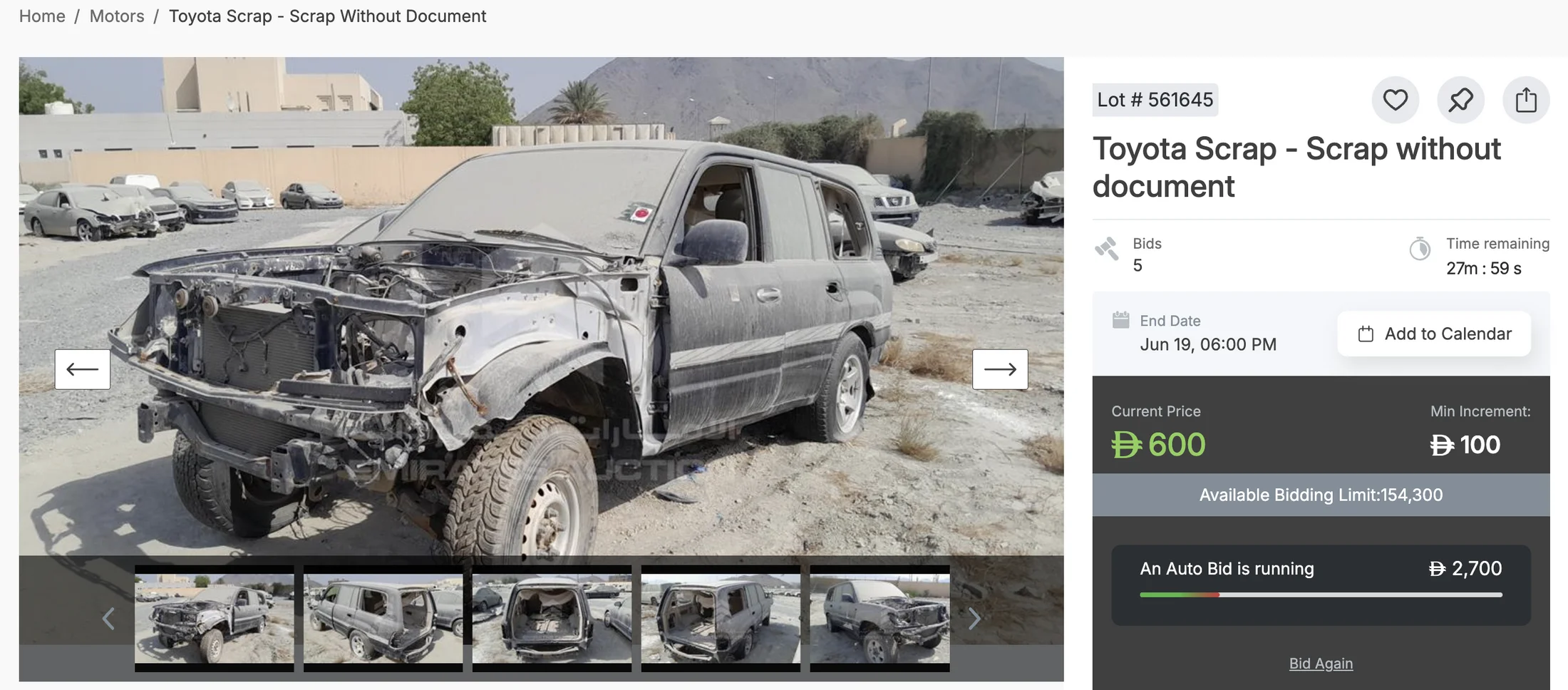

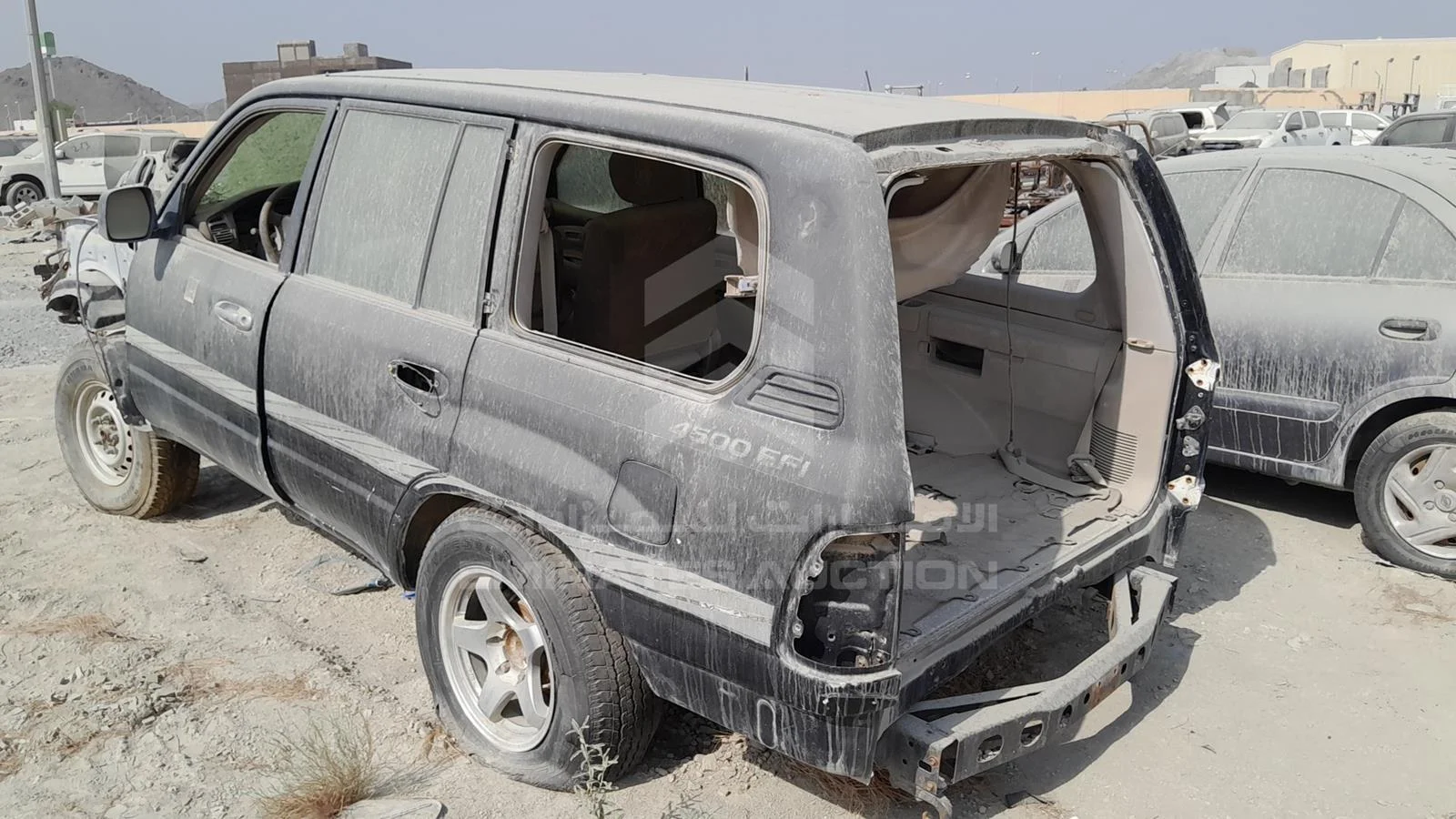

As I write this I am waiting for an auction to finish for a donor for T105. Here's the candidate:
I chose this even though it is missing front fenders and hood, the roof looks in decent shape and most importantly this truck is the barn door style so the trailing edge of the roof will be correct. Our plan is to do a roof transplant rather than trying to fix all the hail damage.
As a bonus likely both main and sub tank will be in this donor, although the plumbing will be a bit different. The dash looks like it might be useable. Also, the donor's doors look ok so we may use them and thus convert T105 to electric windows. I am claiming the center console fridge for Schrodinger.
The front seats look ok. I've been wanting a manual drivers seat to experiment on in terms of doing a 100% camel leather job on it.

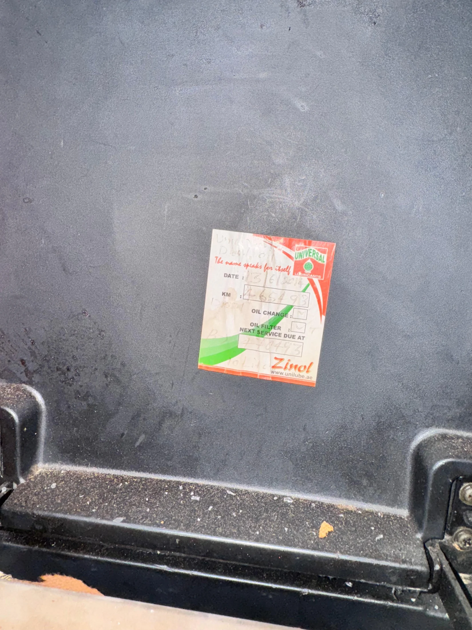

(We had opened the front cover on the 1HZ and checked that the timing belt still looked whole before cranking, but from a couple of trys the engine sounds pretty ok.)
I think the mileage of 488K km is pretty good news, especially given the oil change sticker. It means it got that last oil change and then basically just sat. I'm guardedly optimistic about the engine and driveline.
Meanwhile there is a half-hour to go on the donor.
That's about 175 USD currently. I have an auto-bid running going up to about 750 bucks. Transport will cost almost 200 USD, but this still makes sense for the roof and bits of interior trim.

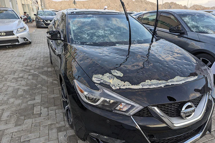

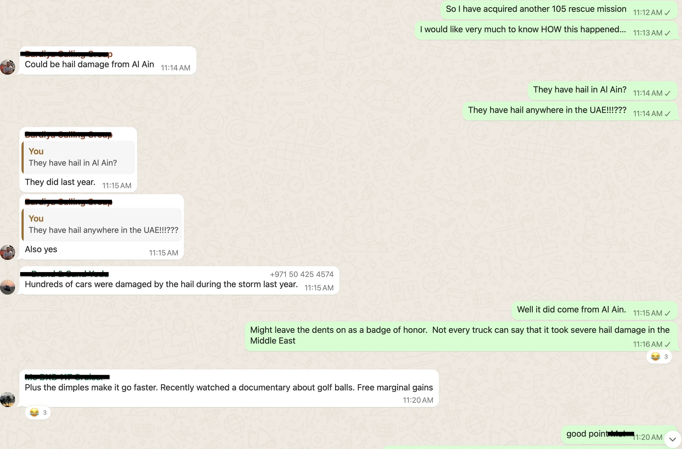

That’s not hail damage. That’s a caffeinated child with a pogo stick.
My first guess was kids with cricket bats, given the location, but friends in the region assured me this was hail:
Turns out this was a real thing in Al Ain (one of the 7 emirates making up the UAE, along with Dubai and Abu Dhabi) last year.

Hail damage on a 100? Hmmm they must use thinner sheet metal than an 80. My 80 went through killer hail that battered up my 2000 4-runner pretty good but never left a ding on the 80.

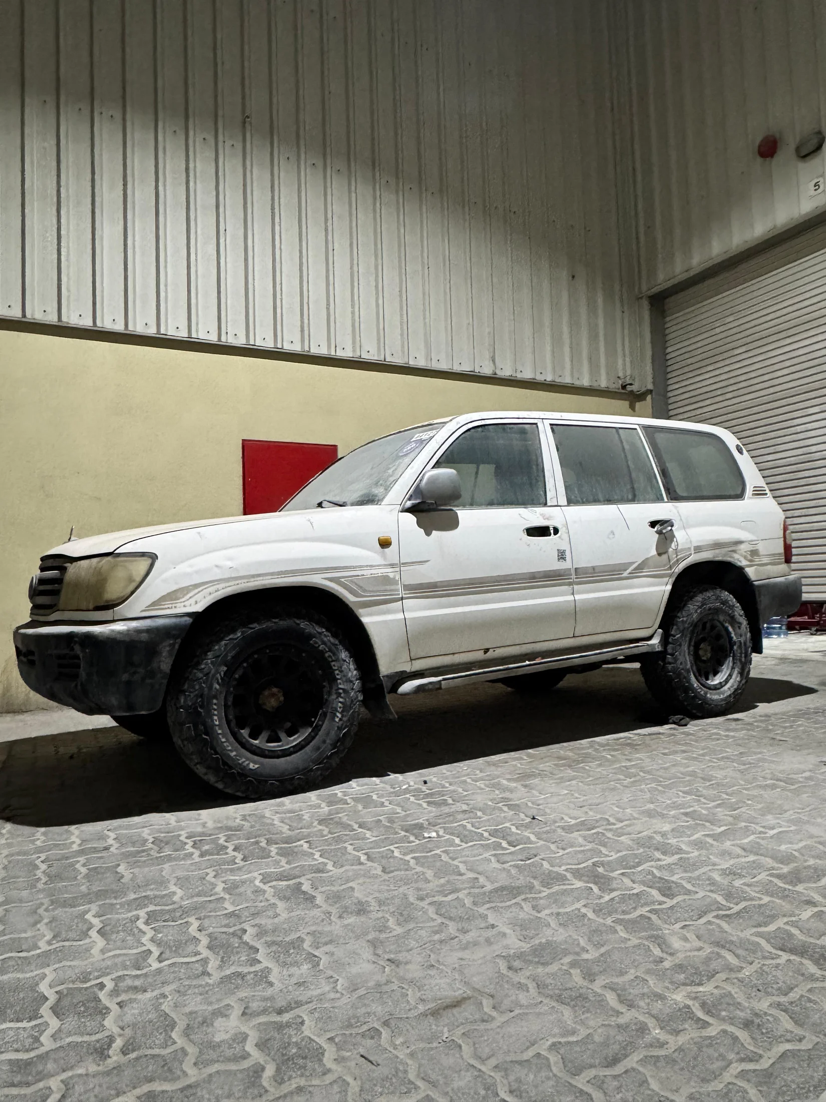

Got some BFG 285/75R17 and Method rims on the T105. Starting to look like a truck again
bead grip zero offsets

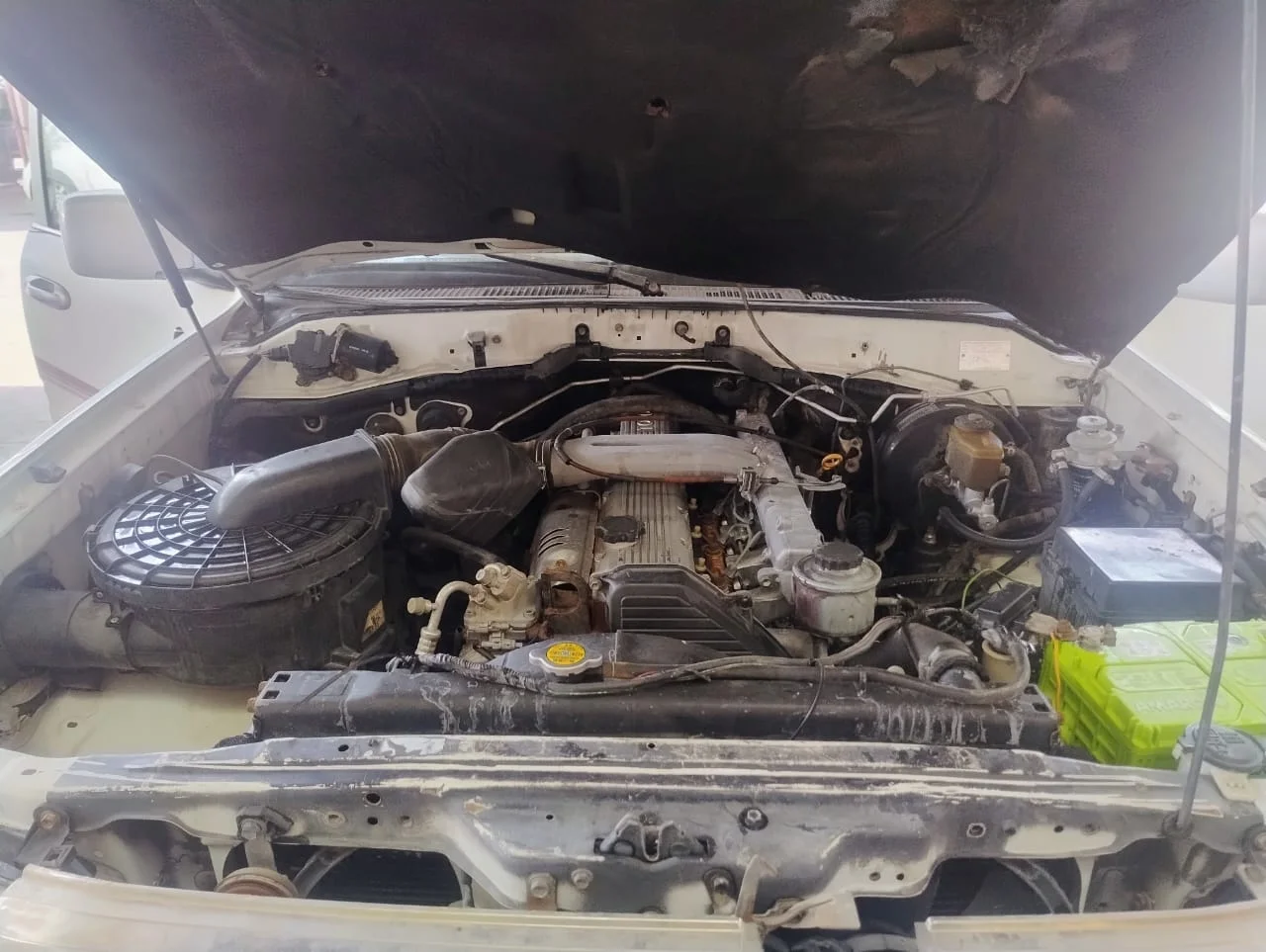

Progress has been made. The 1HZ is alive! It struggles to run currently because of air in the fuel but that will be sorted out with time. Between two new tanks, plumbing and new fuel filters, the fuel system will get looked over plenty. Here is a video:

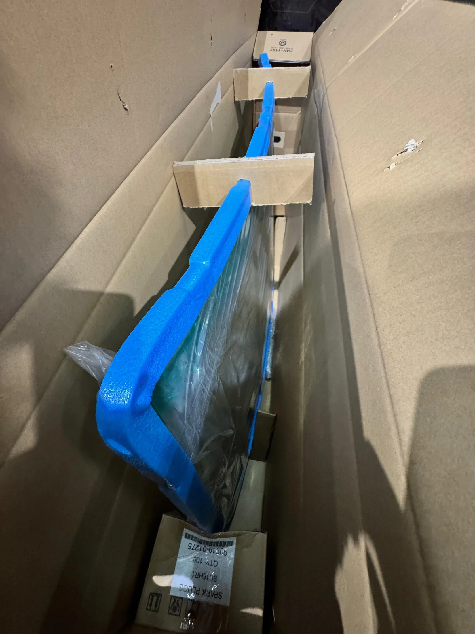

Parts have also started to arrive. A brand new windshield from Toyota appeared at the shop.

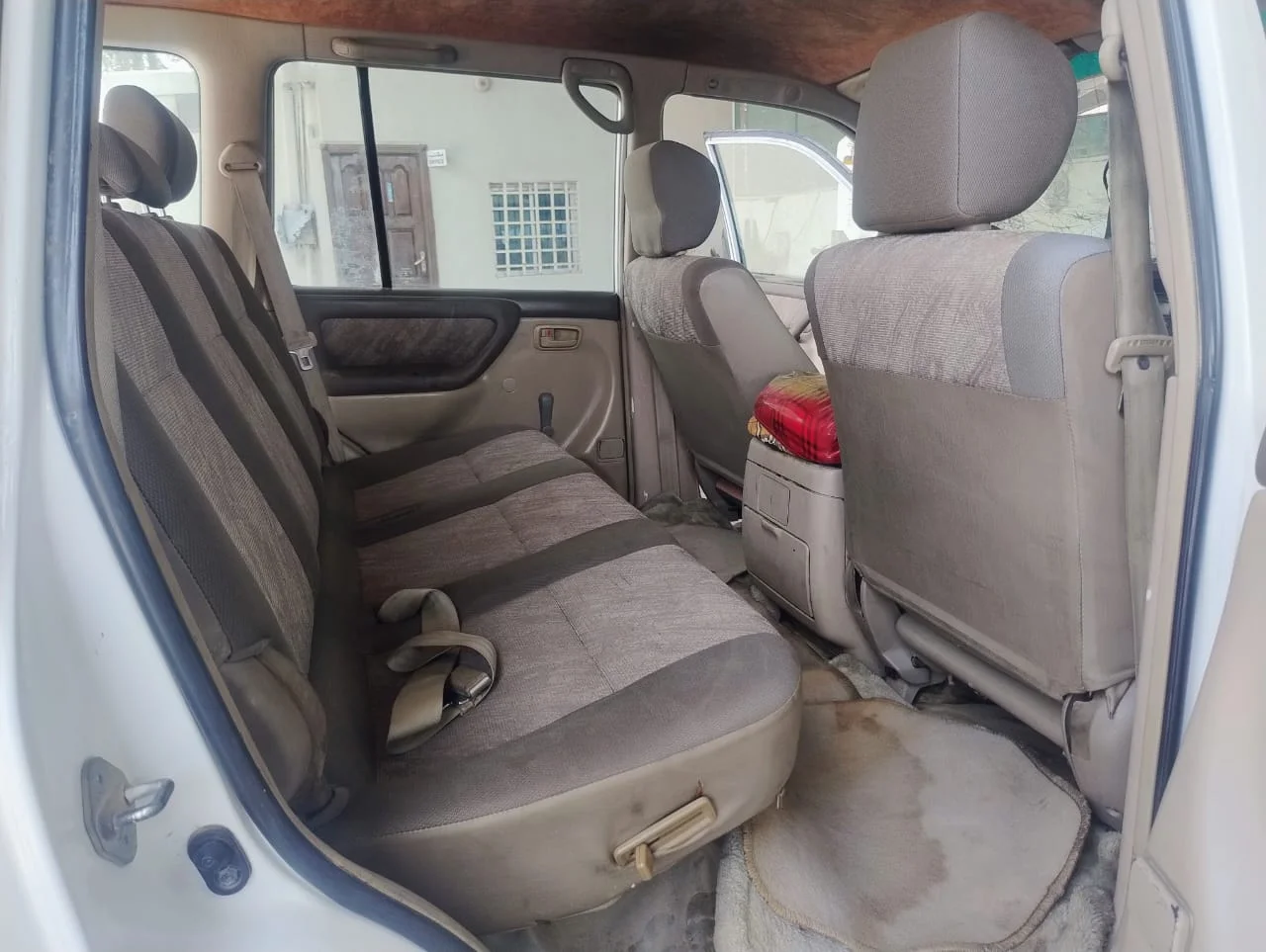

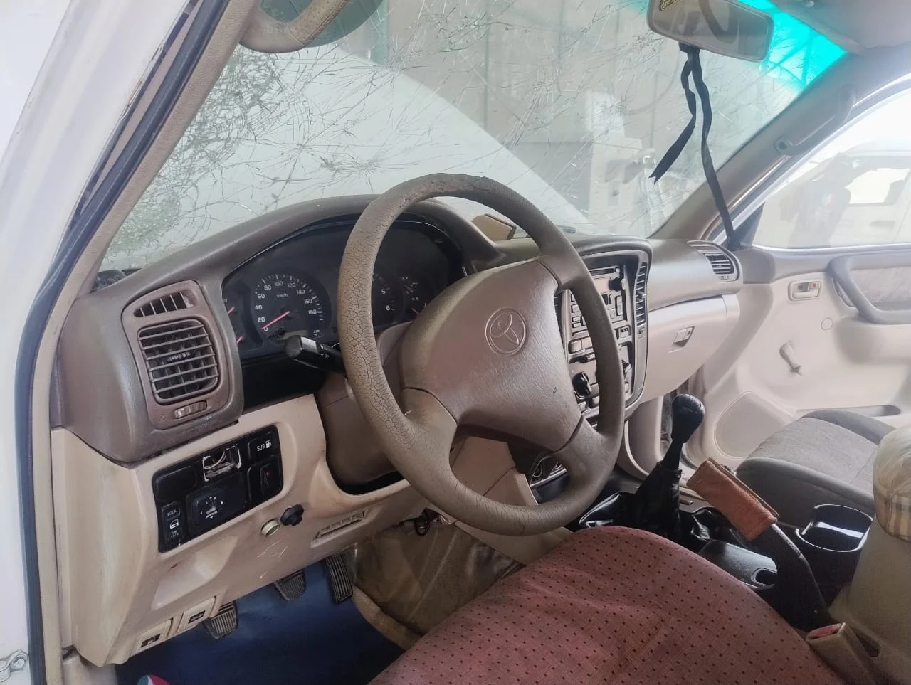

The truck was sent for cleaning and it turned out better than I thought it would. The previous owner left a ton of crap in the back and there were some completely disintegrated seat covers in the truck. Once all of that was gone it turns out that it is pretty workable. The very apparent issues that exist in the interior right now are:
- The seat foam is all but gone
- The driver side seat foam has collapsed like all of them do
- The headliner is the worlds worst alcantara and is sticky and indescribably gross
- There are some missing pieces in the rear
- The dash has some light cracking
- The steering wheel is beyond help
- There is a likely need for carpet

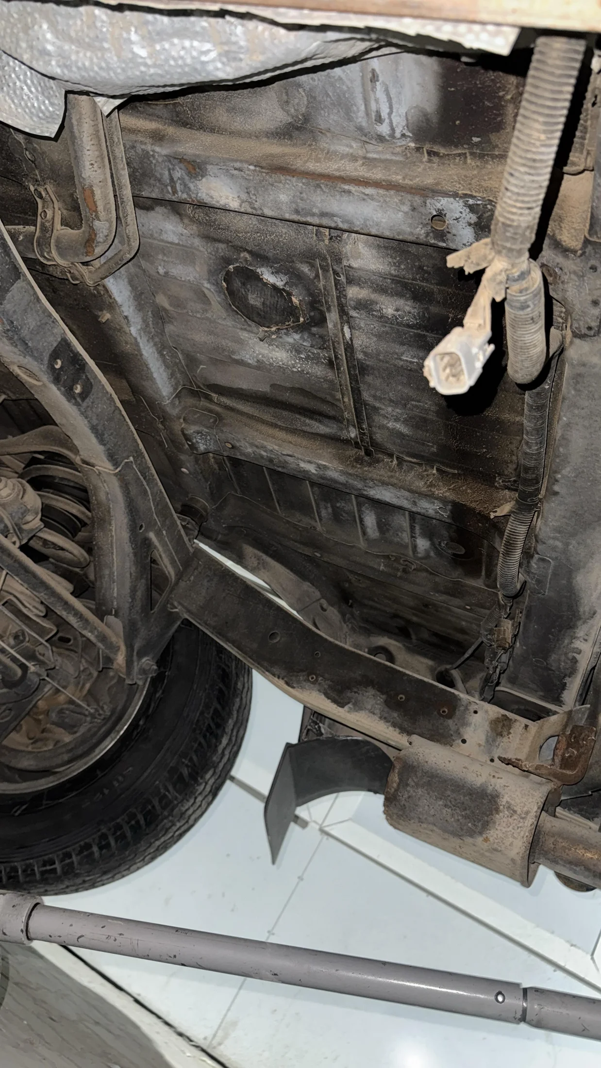

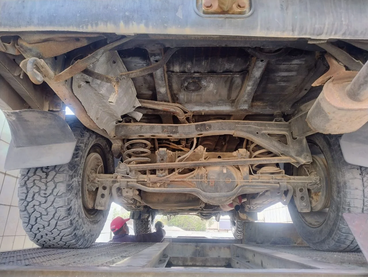

The underside of the truck is also in fairly good shape as well. There isn't anything immediately concerning with the axles or suspension. Don't pay attention to the cosmetic muffler hanging from the rear bumper. It's for style. :cool:

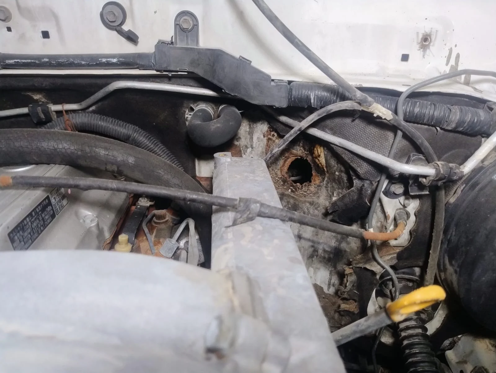

Despite the cleaning going well it also revealed some serious issues that need to be addressed. It would appear that at some point in this truck's life someone attempted an engine swap and then undid it. There is a gaping, rusty hole in the firewall, presumably from wiring. There is also an even more appalling hole in the floor that I do not have pictures of that was likely for the exhaust of said aborted swap. The theory is that perhaps the local registration authority refused to legalize the swap and the previous owner instead aborted the mission. The firewall hole:

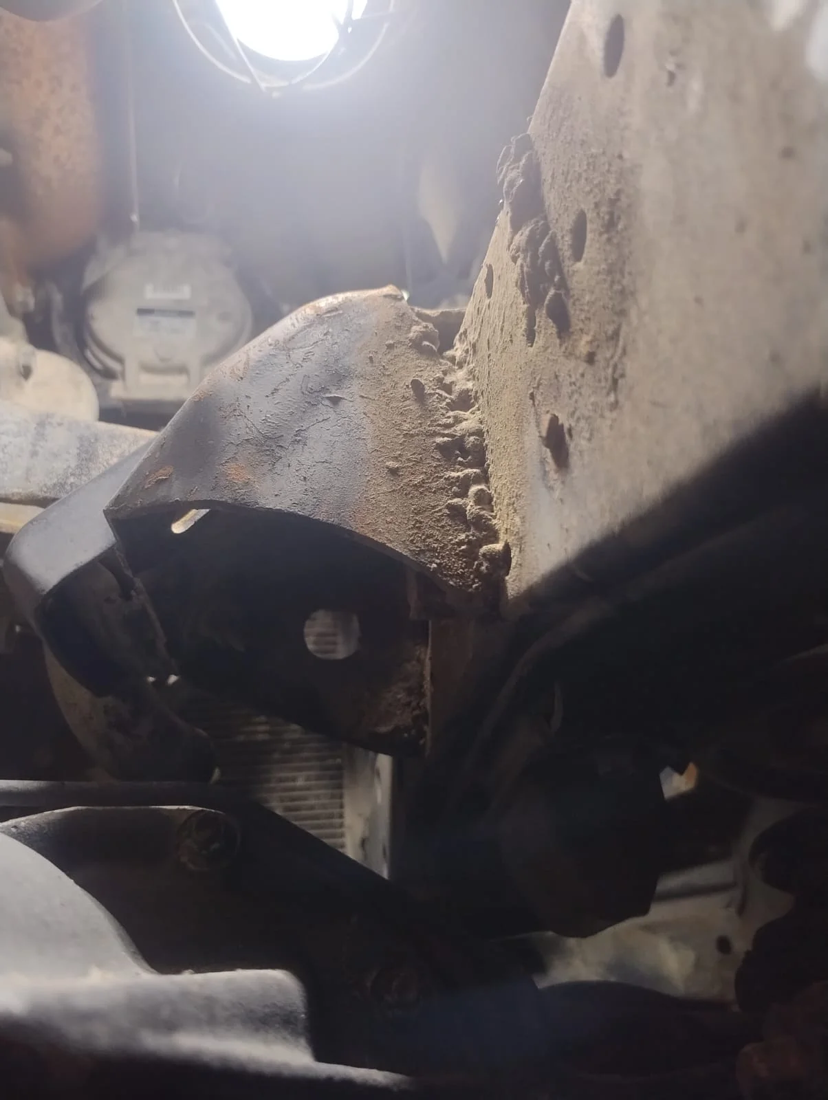

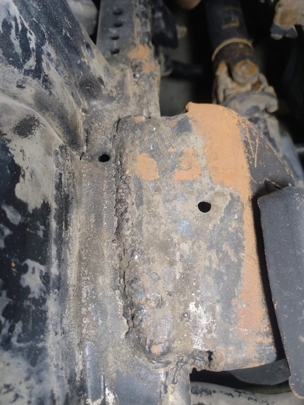

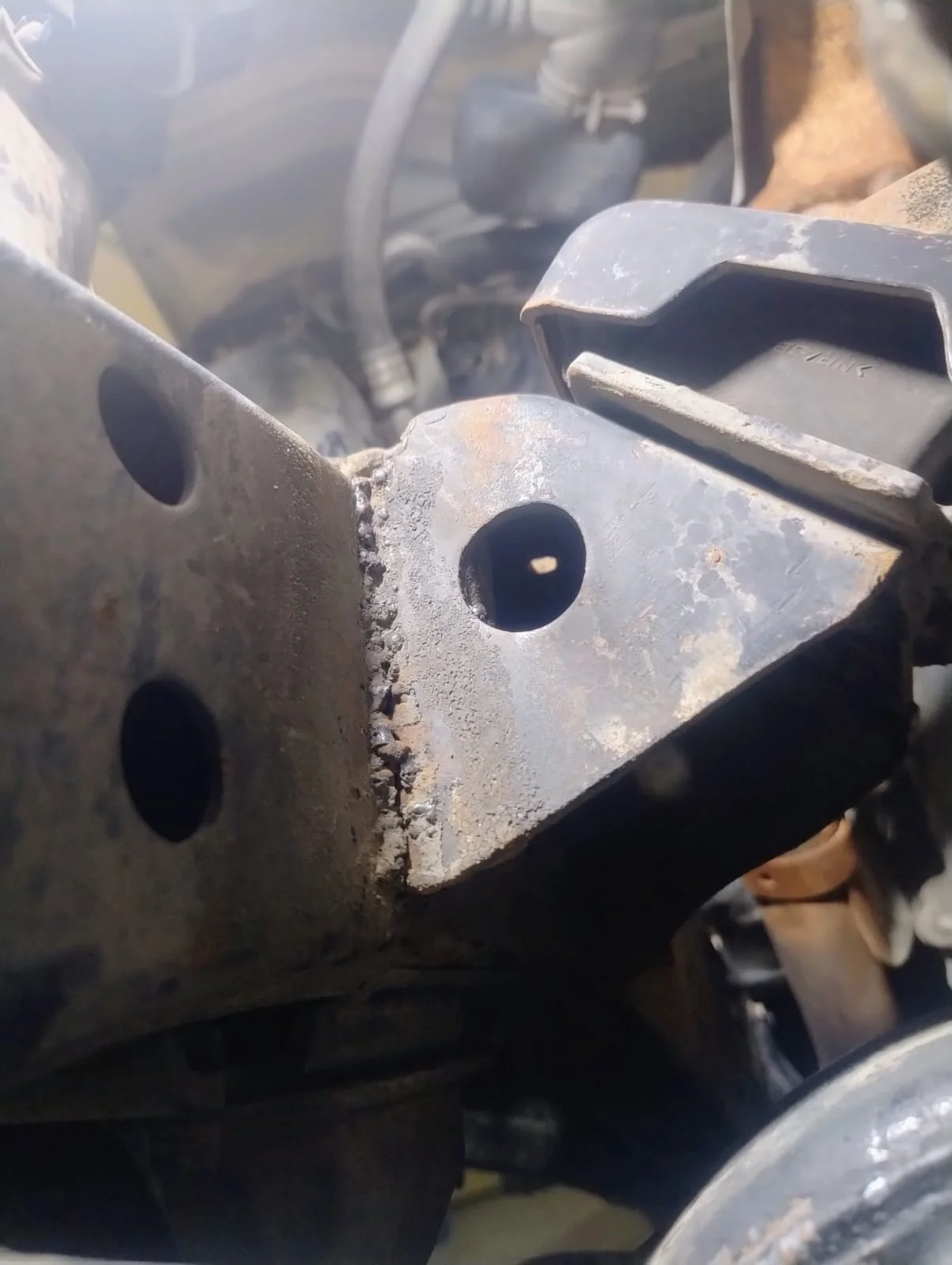

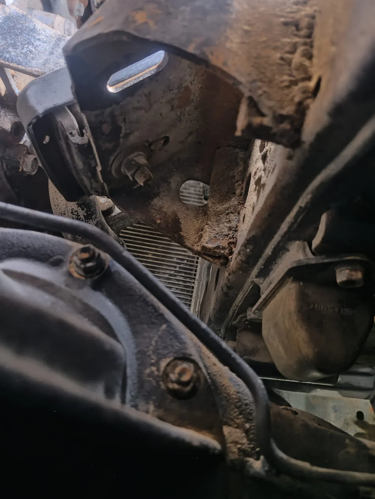

Someone got after the engine mounts with a welder and absolutely butchered the job. This is going to be rectified before the truck leaves the UAE. I have every intention of turning up the 1HD going in here, and then wheeling the hell out of the truck. The last thing I need is the engine falling out of the truck.
Due to the issues with the body that are pre-existing, the donor body picked up by John is the likely candidate for this. While nobody has seen it yet, it's almost certainly going to be better to just bodywork that and swap it rather than cut it up. The only major question is whether or not the donor was a GXL truck or not. This will determine whether it can accept an H152 readily.
