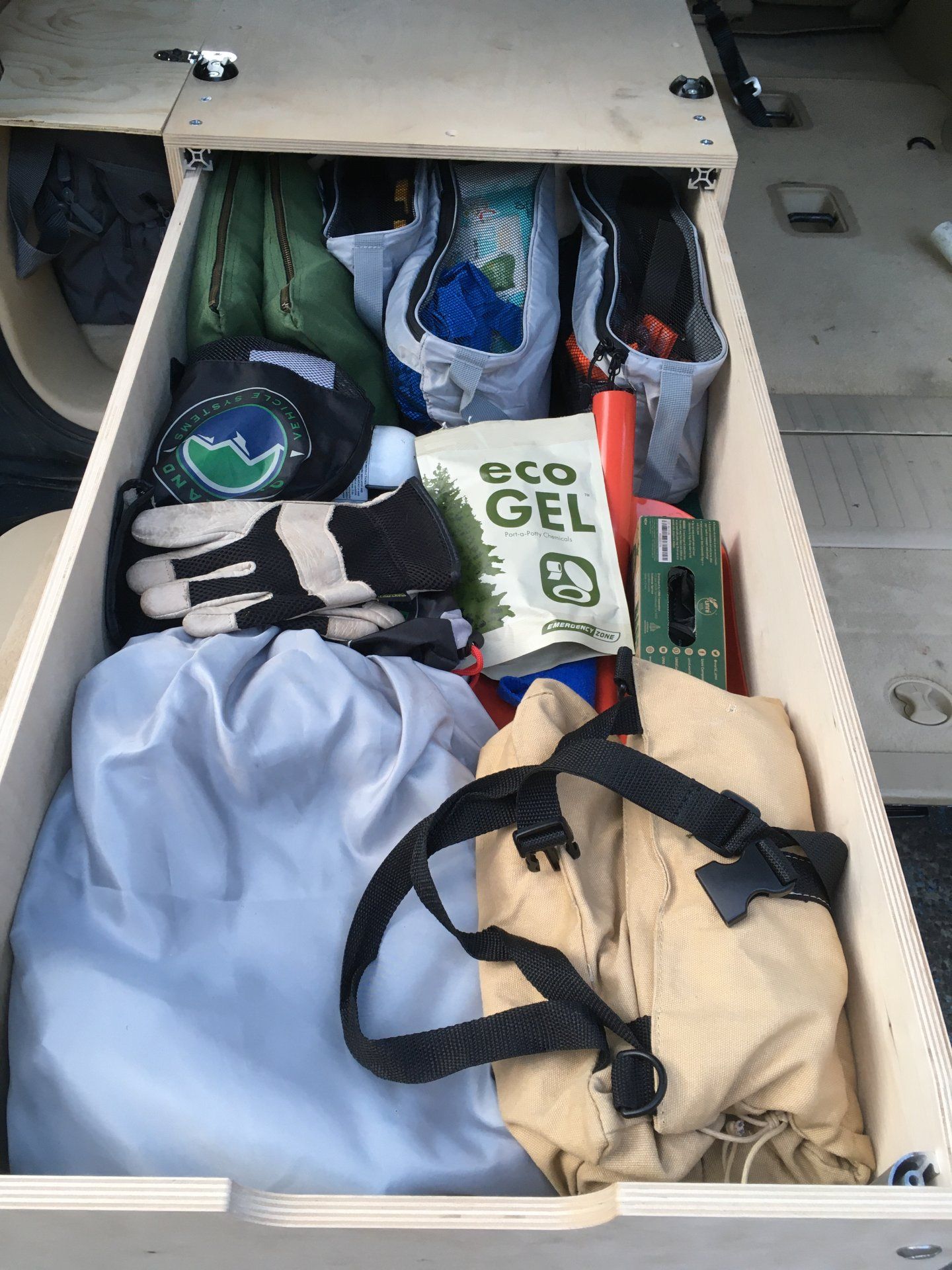

Oh new equipment run down.
no noise from rhino rack batwing awning.
4 rototrax no noise, and further reduced the snorkel noise.
also put a trasharoo on to hold the potty And be available for misc items, Worked good.

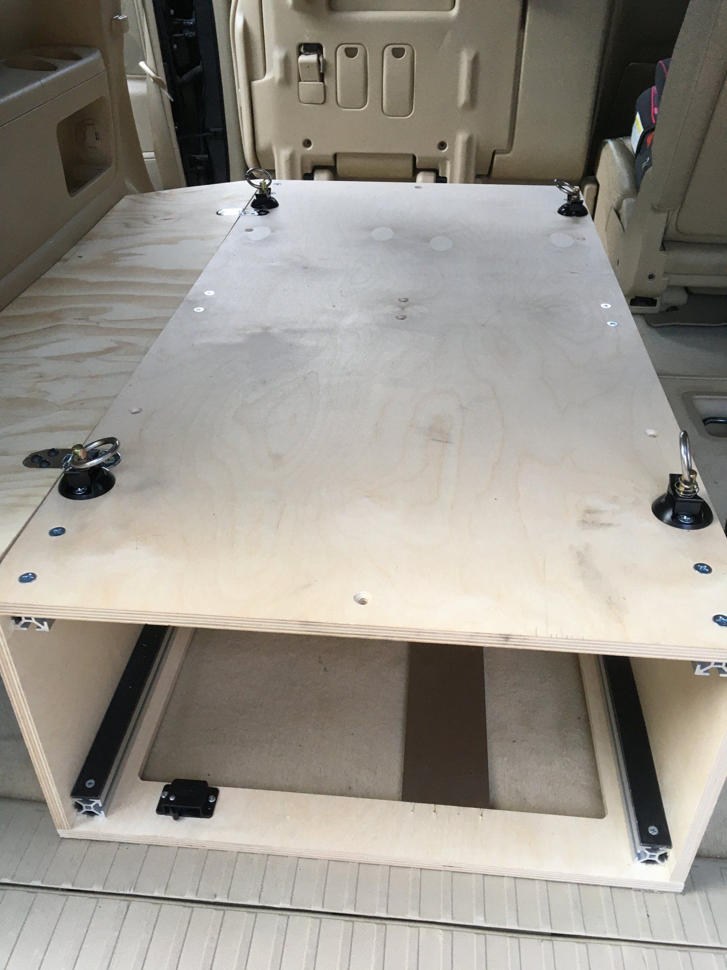

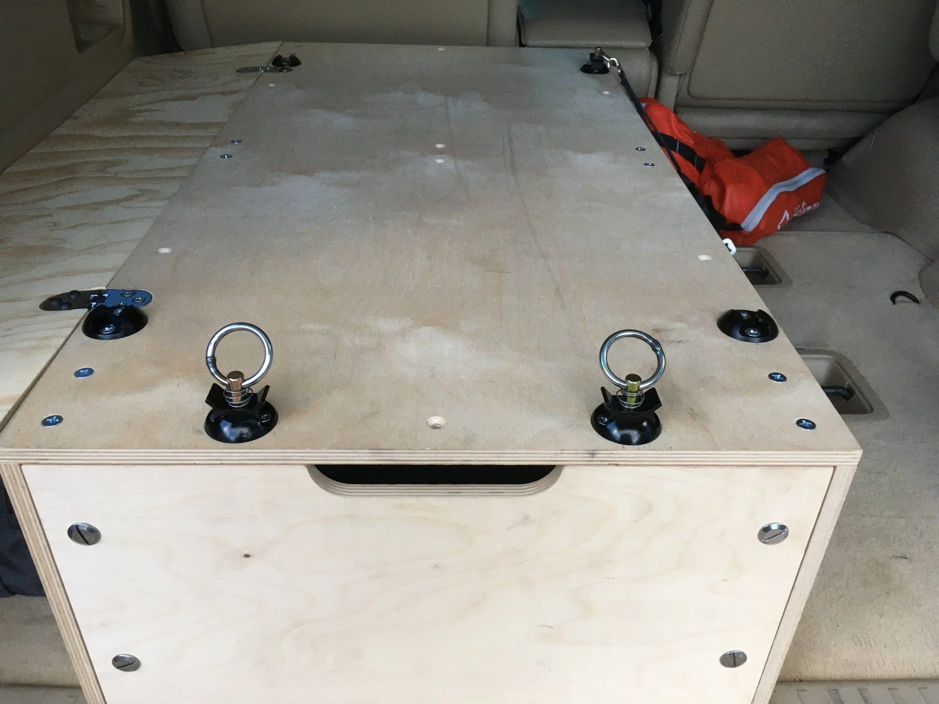

Continuing to chip away at the reef. Put on three more tie downs., have one in every corner now.
I think I'll put a couple more on each end and call it a day.

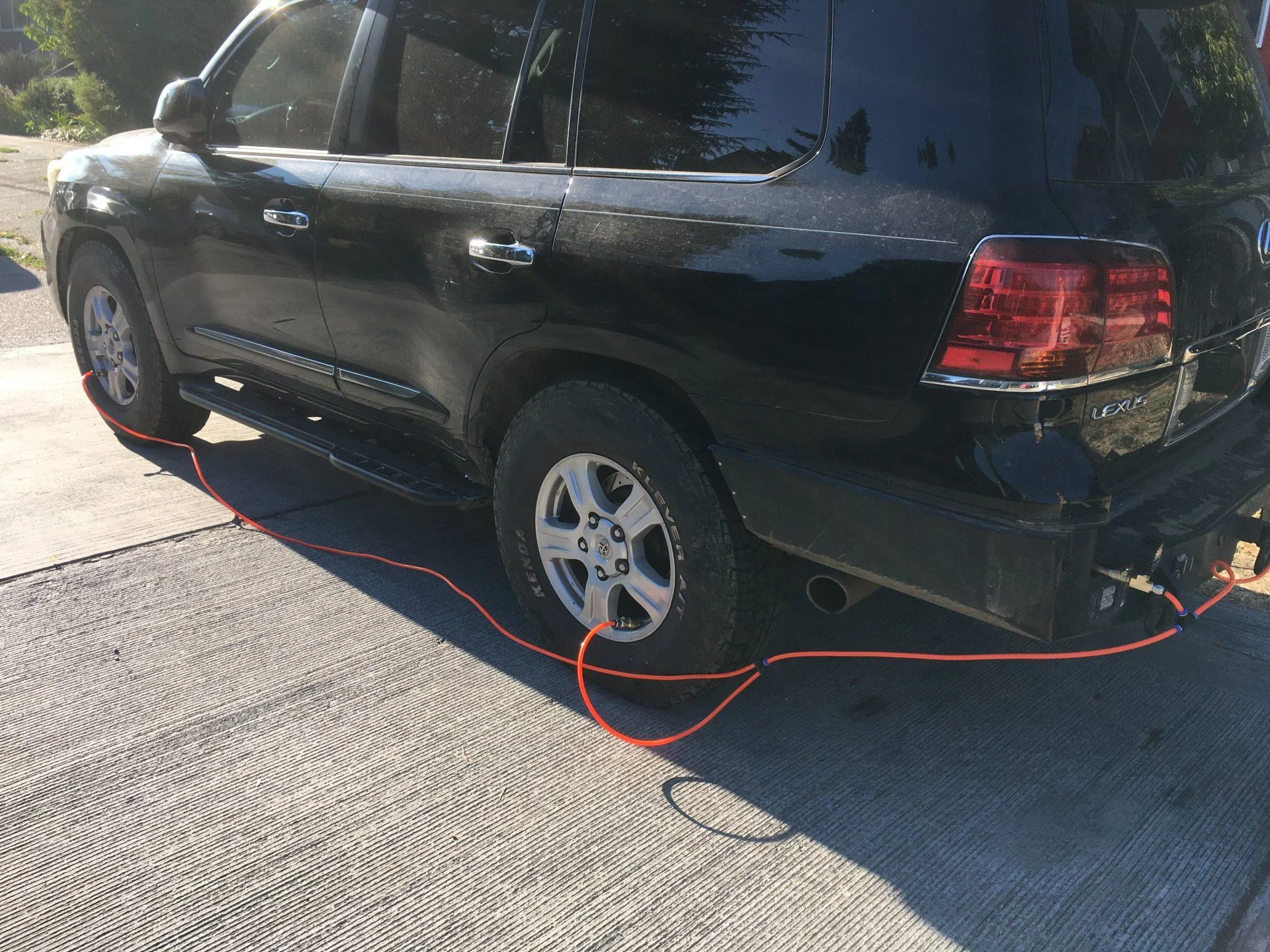

So last trip the air refill went poorly. I have a milton inflator, and it requires me to hold a lever. This requires much perseverance when under attack by an endless squadron of mosquitoes.
I was already eyeing a home built 4 tire inflation system, like the one @radman Put together. I couldn’t get my cart to $75 though, it was $83. I did get a digital gauge, a brass ball valve, and push to connect fittings. Should be a fun little assembly.
looking forward to relaxing four tire fills.

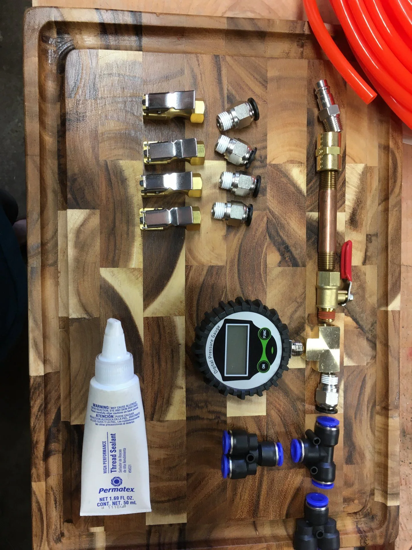

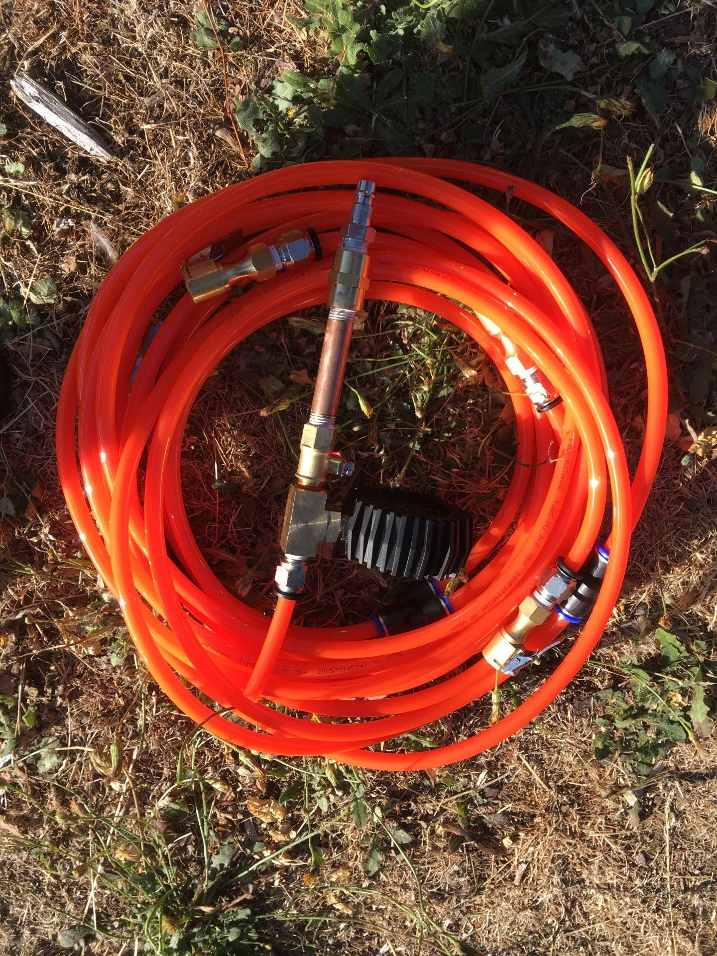

Worked on the 4 tire fillup assembly tonight. It's a nice tidy package, same size as my 20 foot 3/8" flexzilla hose and milton inflator. Is it fiddly? I didn't find it any more fiddly to setup than pulling my existing hose and inflator out, unkinking the hose, and attaching. It does take incrementally longer to plug in all four tires at once -- but no standing outside holding the inflator lever . . .
Assembly warning - you will need 15 meters of tubing (45 feet). 10 meters was 4 meters short! (My air location is rear left side at bumper). I thought 10 would be plenty!
BOM ($100) --
1/4" M/M high flow quick connect fitting in the manufacture of choice - I use flexzilla. I had a male on hand, so had to buy a 1/4" F/F to adapt
1/4" F/F (optional)
3" 1/4” M/M tube - to space the valve and the quick disconnect for ease of use (recommended, but strictly optional)
1/4" tee - F/F/F
1/4" digital gauge (m)
1/4" to 3/8" (M/F) OD PTC fitting - need five
3/8" OD PTC tubing used throughout - need 15 meters (I bought 2x packs 10m with fittings)
3/8" OD Ptc Tee (F/F/F) - need one
3/8" od ptc Y (F/F/F) - need two
1/4" F “closed" schrader adapters - need four
Permatex goop or yellow pipe tape
Assemble your control and gauge and Schrader adapters
Walk to car
Cut hoses to length and assemble your distribution system
Test
Profit
Why I chose PTC fittings? because they can be easily replaced. Because they are inexpensive (came packaged for free with the tubing). Because they are easy to dissemble (can change hose lengths easy, for example).
Time - 30 minutes, and that was with my 11 year old doing all the assembly
Thanks for the inspiration @radman
you so fancy!
Looks great! How flexible is that tubing? I would have thought it would be a little too stiff based on my limited prior use, but it looks plenty flexible in the pictures.
I went with the PU tubing vs. nylon. The PU tubing is quite soft and flexible. I'm sure it's not as durable, but I wouldn't call this a hard use case. I have one of the extra fittings (a F/F PTC) in my drawers now, so if I need to I can 'cut' a hole out (I doubt this will ever happen).
