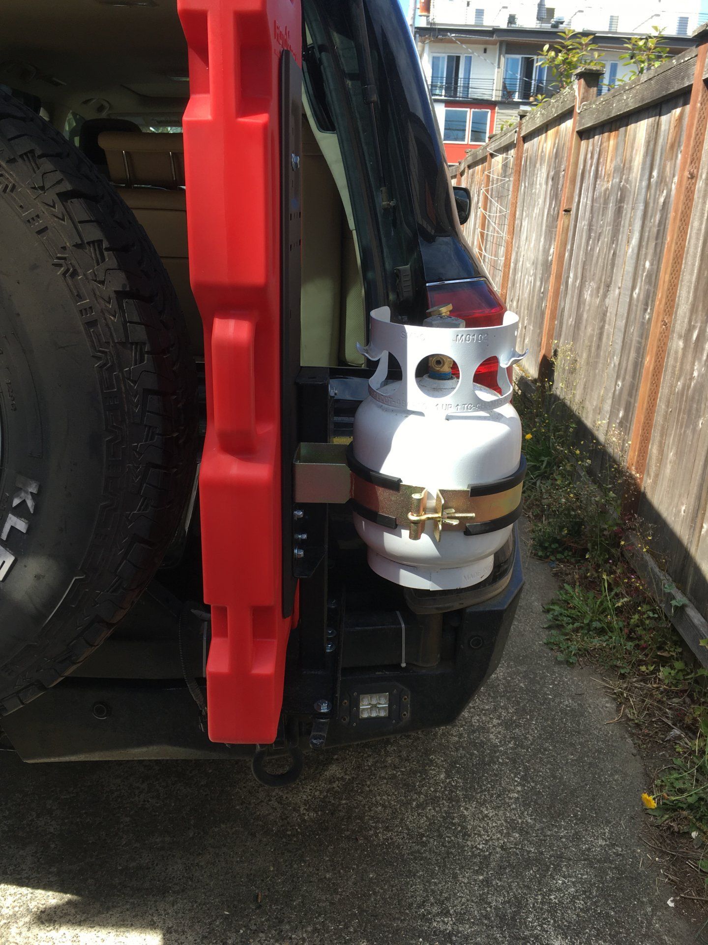

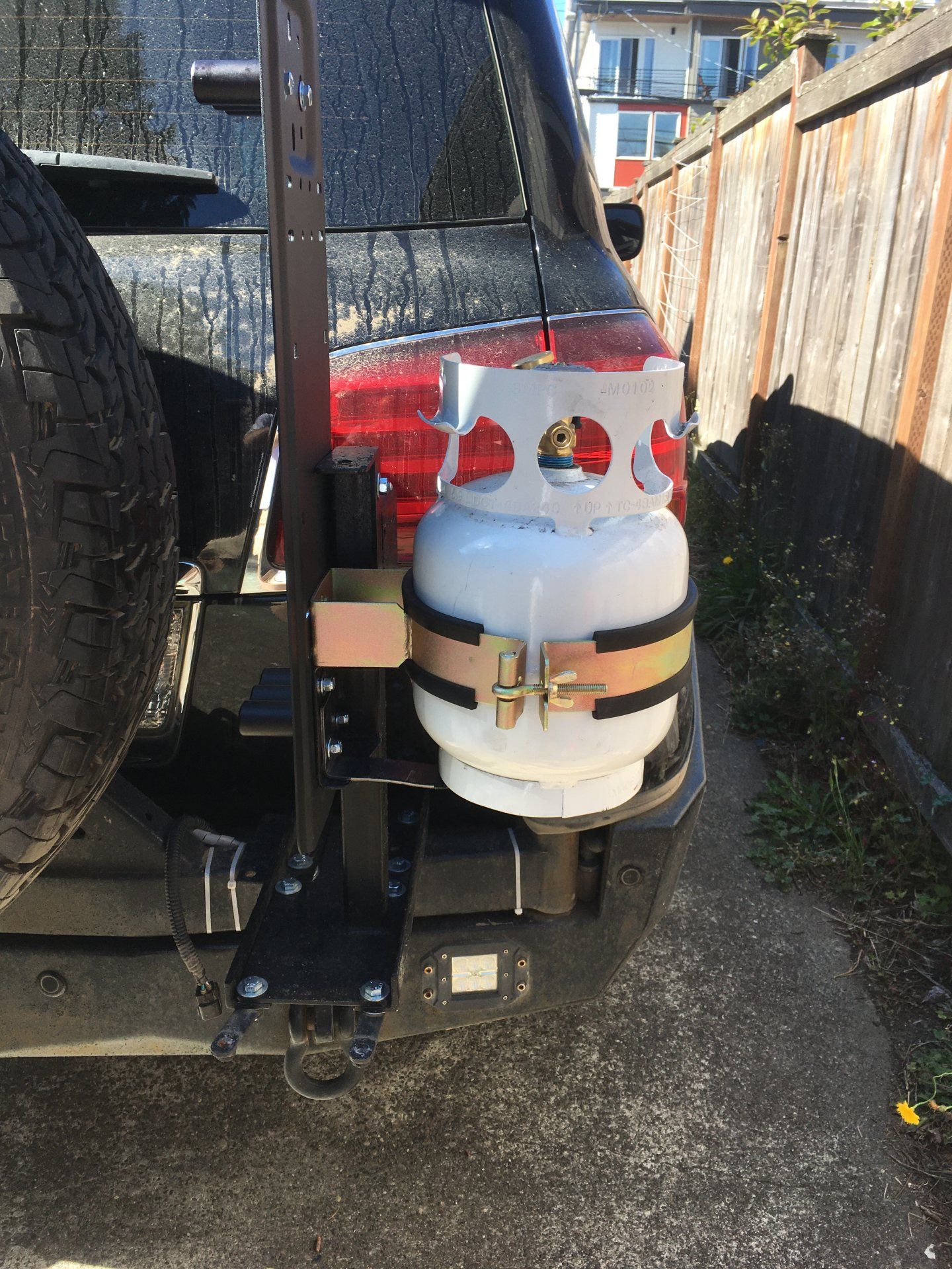

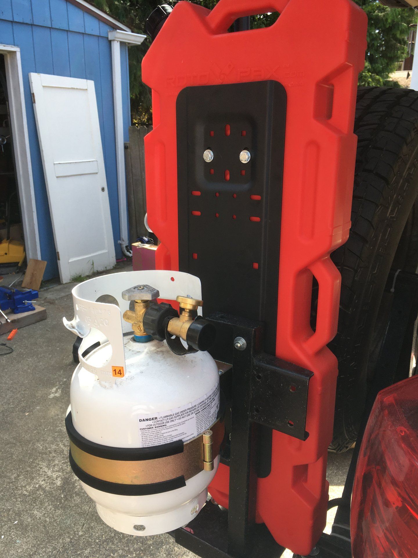

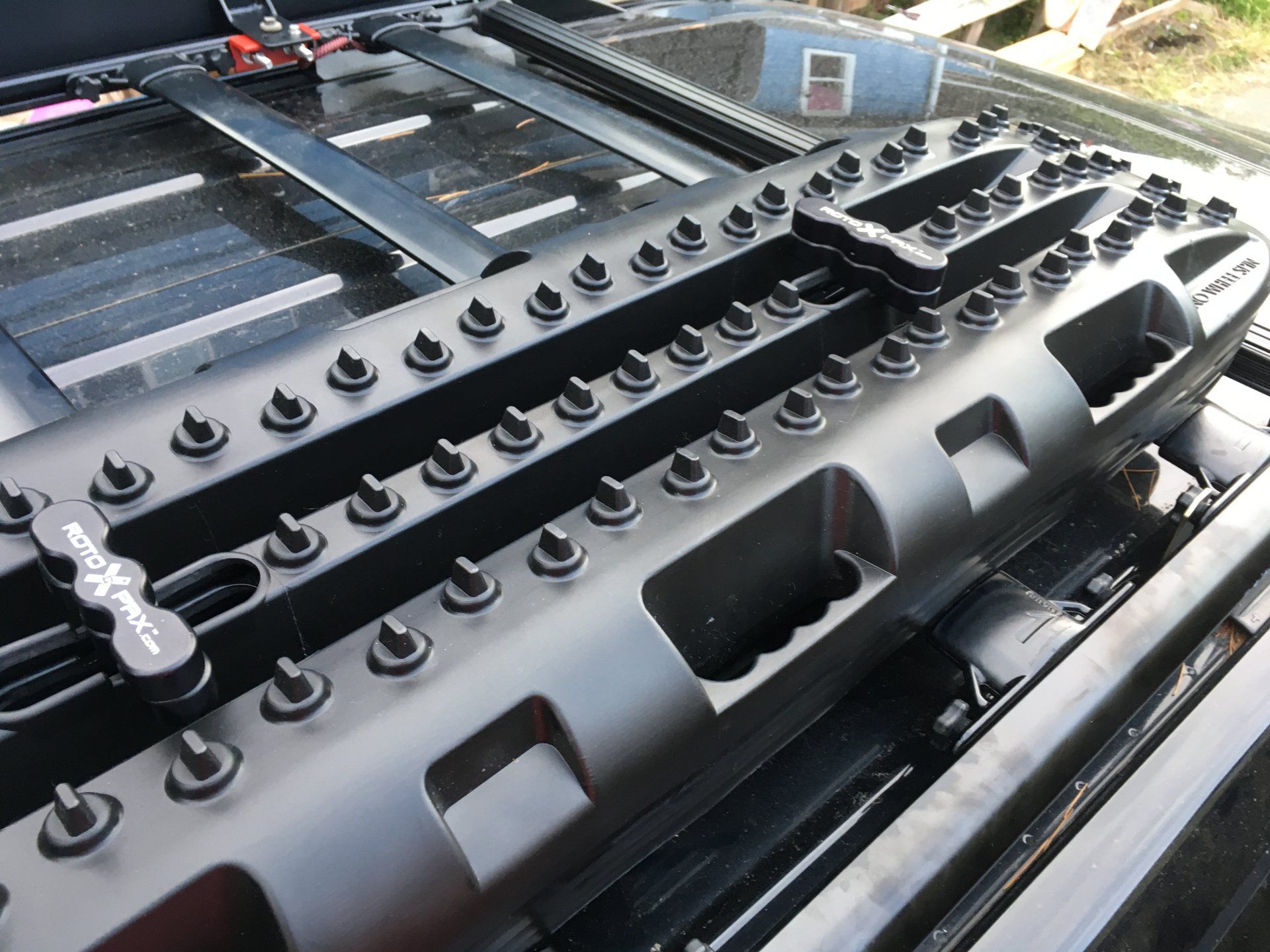

Fiddling with rotopax and a 5lb propane tank mount. I built a pax and Trax mount a while back, but never ended up using it as it wasnt quite right. I think this version, with the large pax plate, is more viable. I had to rotate 180" to use the other side of the post post for propane, so can only mount 1 pax. Trax are headed to roof.

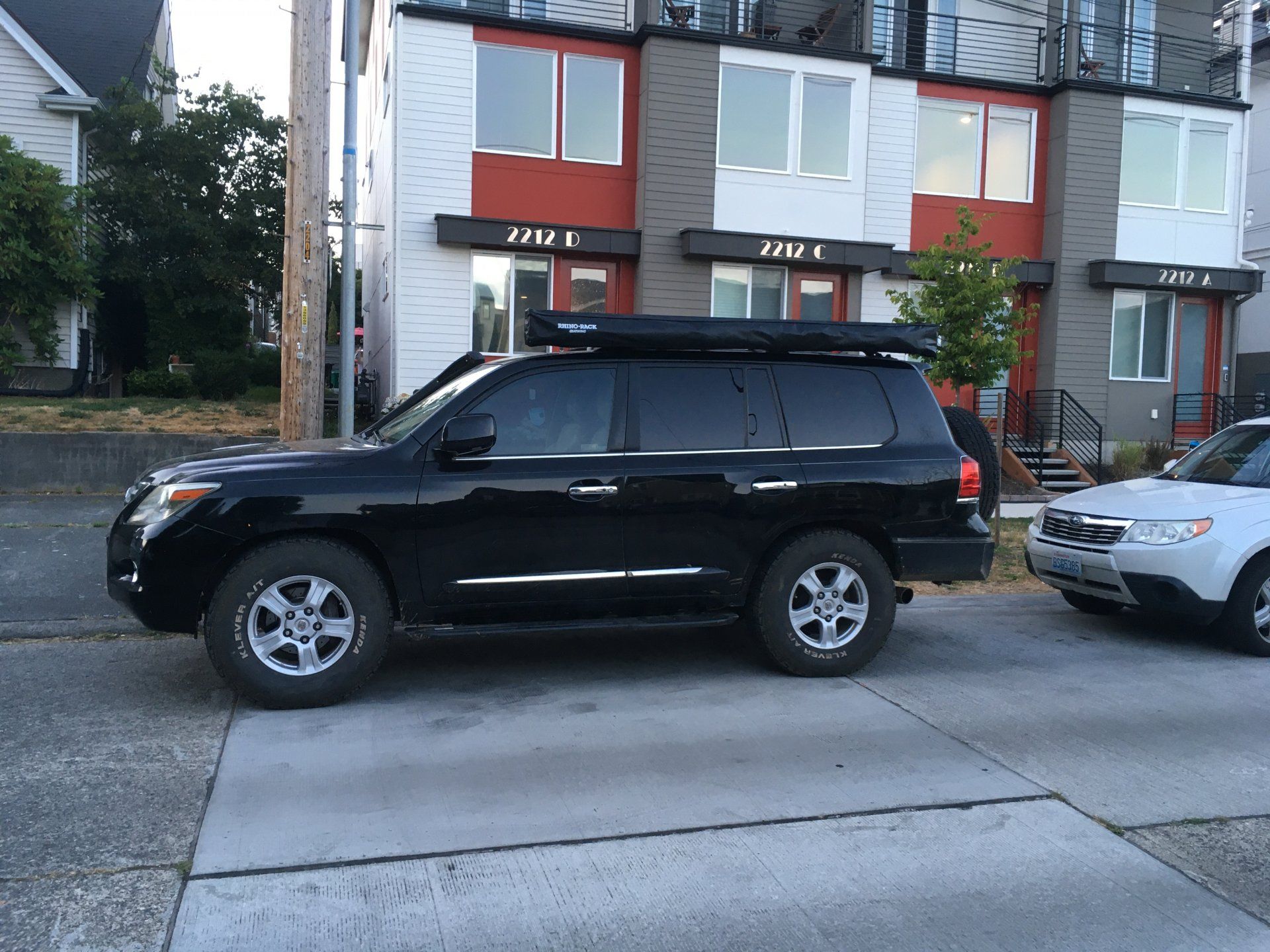

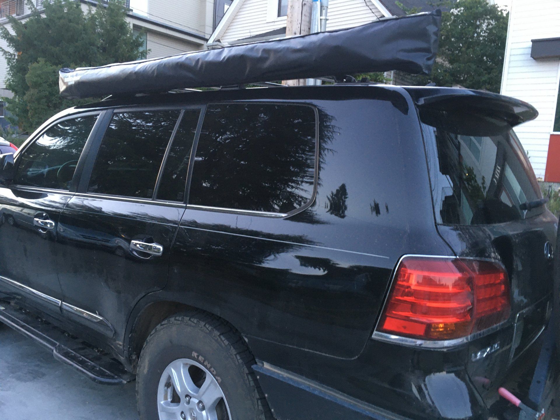

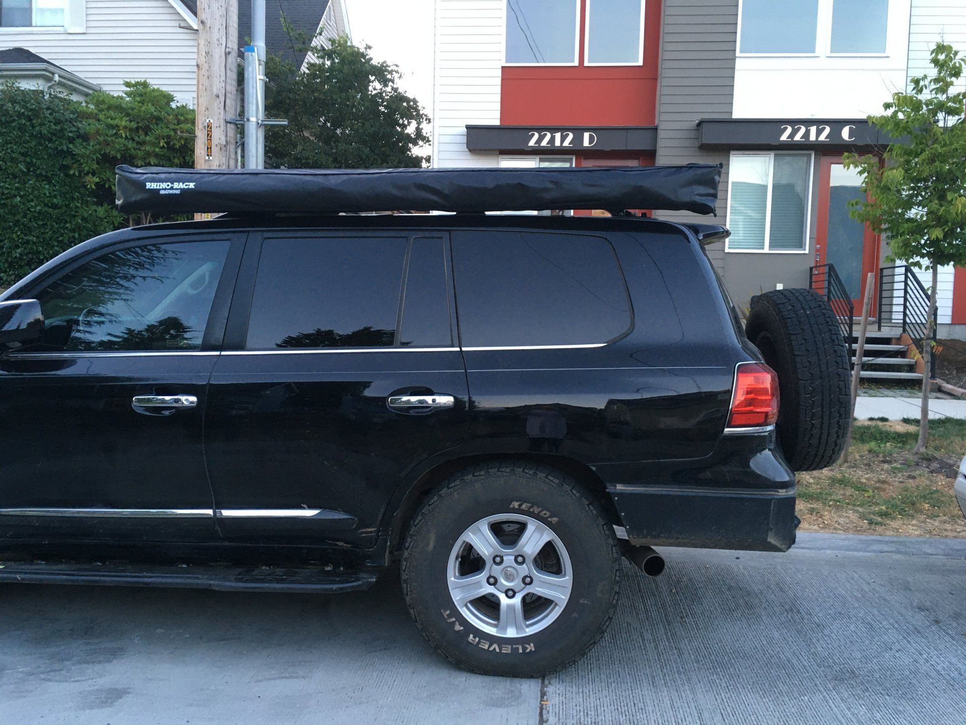

Found a rhino rack batwing at Amazon warehouse. Rated as acceptable. Took a chance. Box was truly wrecked, awning appears to be unopened or used. Haven't unfurled yet and hoping no surprises.

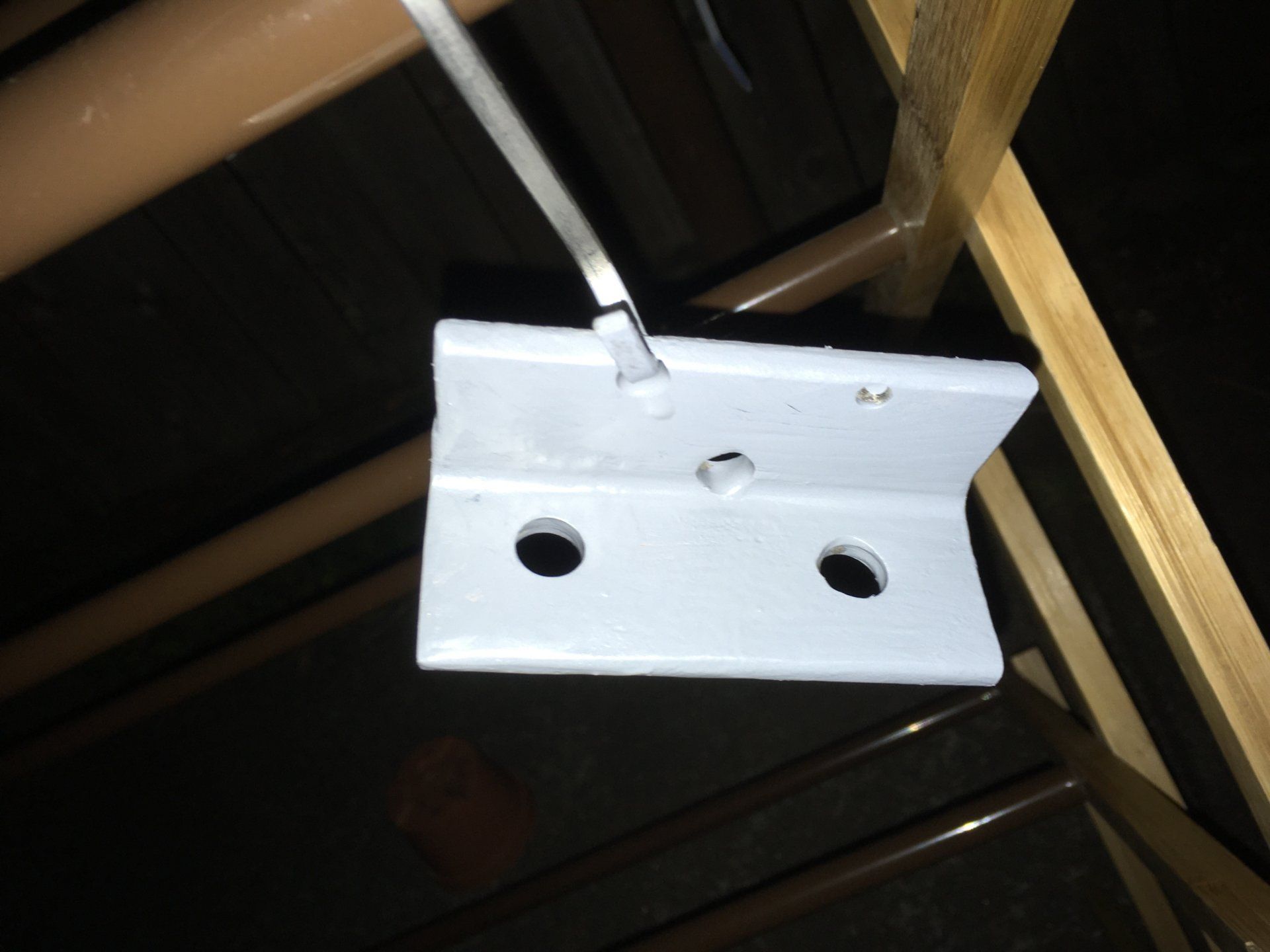

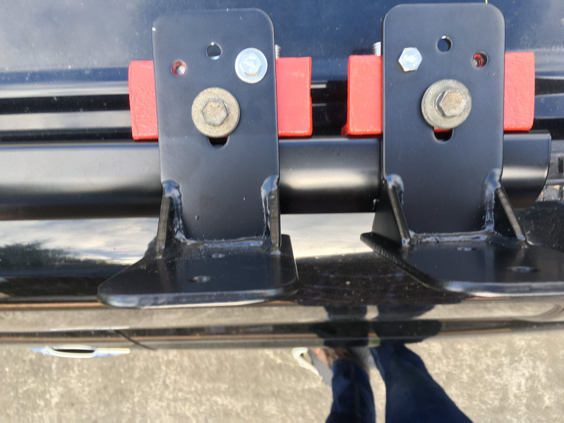

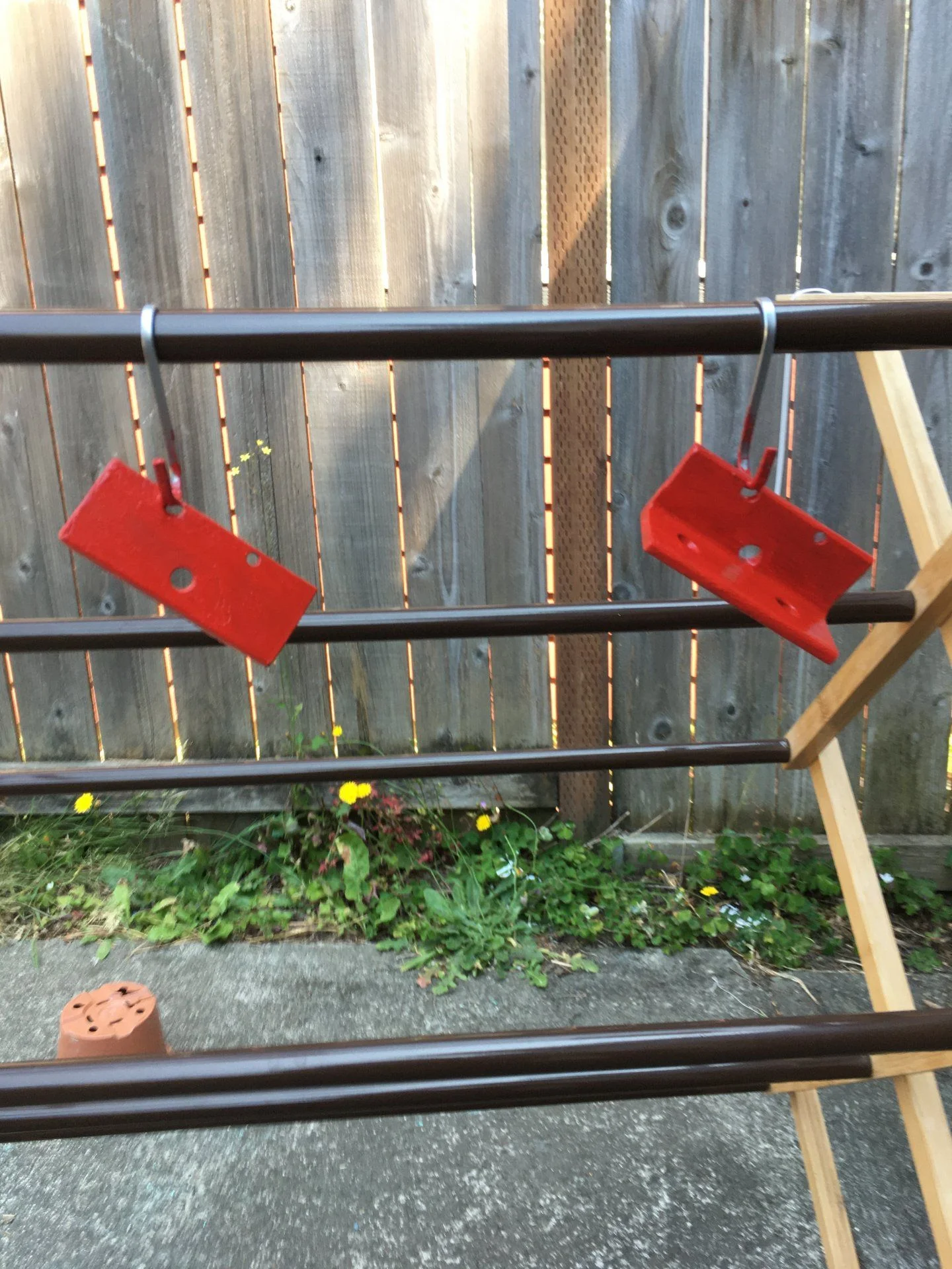

Made some Brackets for the stock rack from scrap 1 1/2 3/16 angle to adapt to the stock batwimg brackets.
Just angle iron, a drill press and an angle grinder.

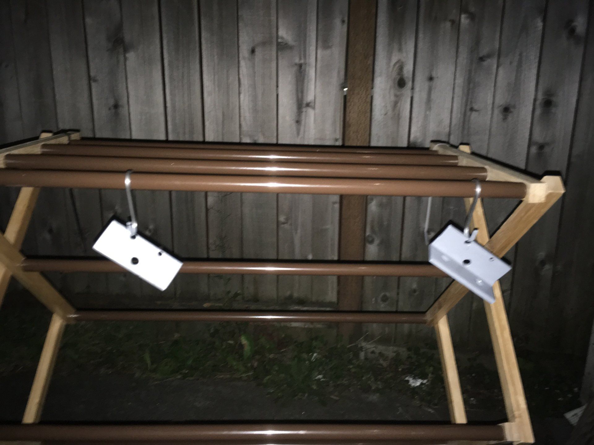

Learned on last brackets to do all fab and then cut apart, much easier to work on a 7" piece than 3.5.
Here with the etch coat. Red goes on tomorrow.
Nice! Where did you buy the mount for the 5lb propane tank?

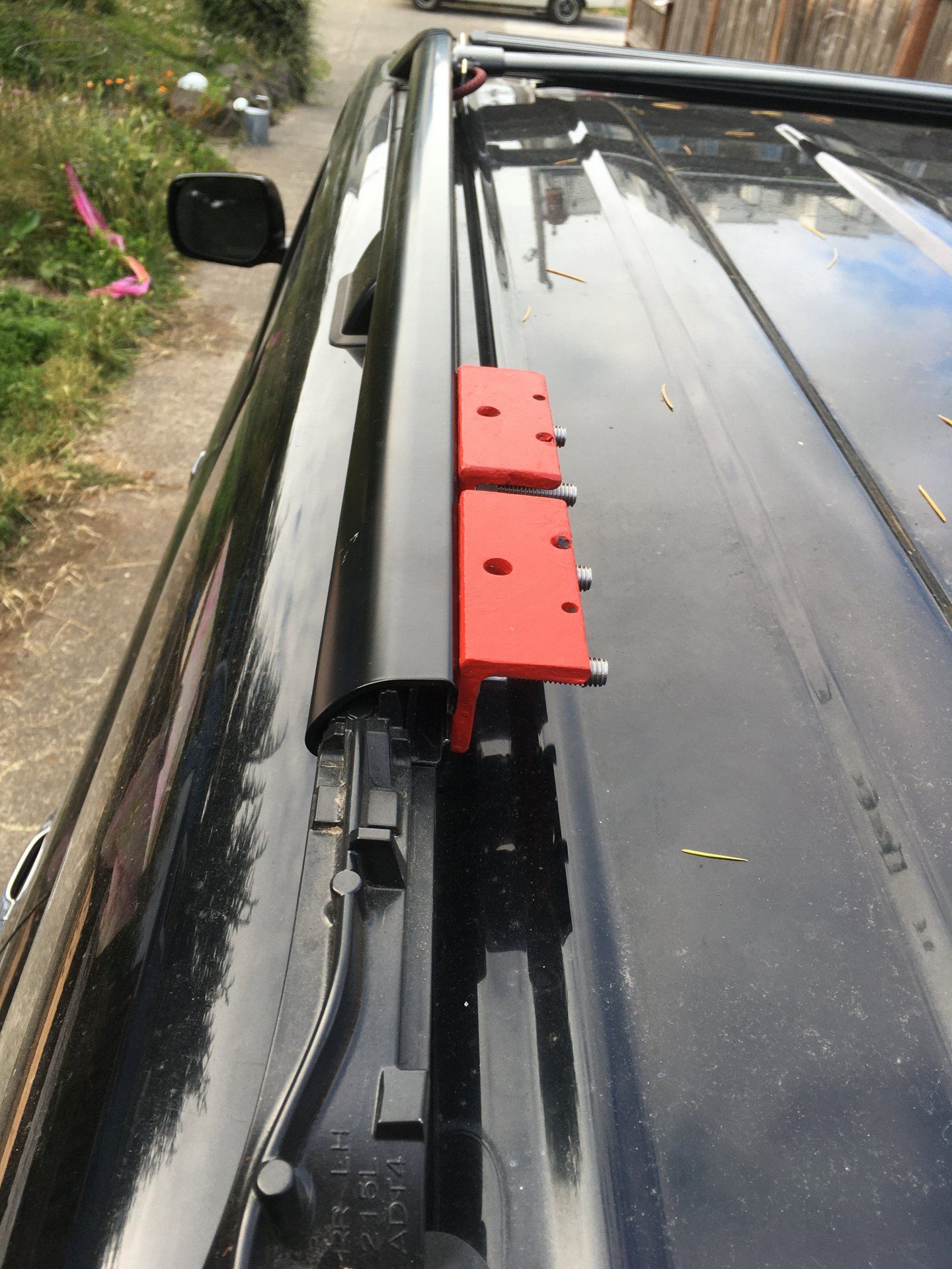

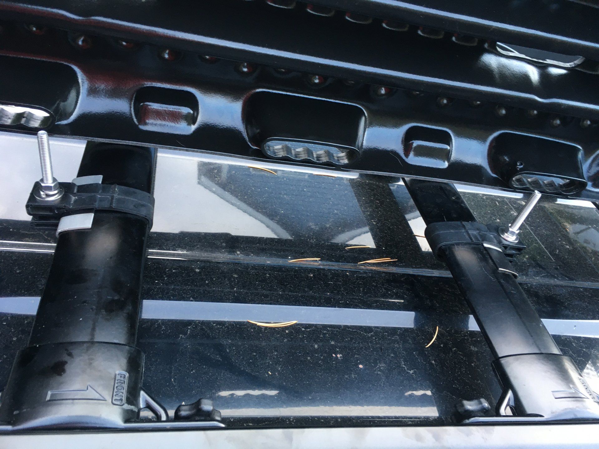

The reddening is complete. Assuming the carriage bolts get here soon, should have it mounted tonight. My youngest likes to paint in red it turns out.
Had to drill out my bracket holes a bit more to fit the 3/8” carriage bolts. Was able to get an 8mm and 6mm on the rhino rack bracket. Good enough.
Mounting pretty straight forward, fits good, not a lot of latitude where you put the brackets, minimum distance is 27” apart, I got them about 29”.
2” angle would be a better fit for sure.

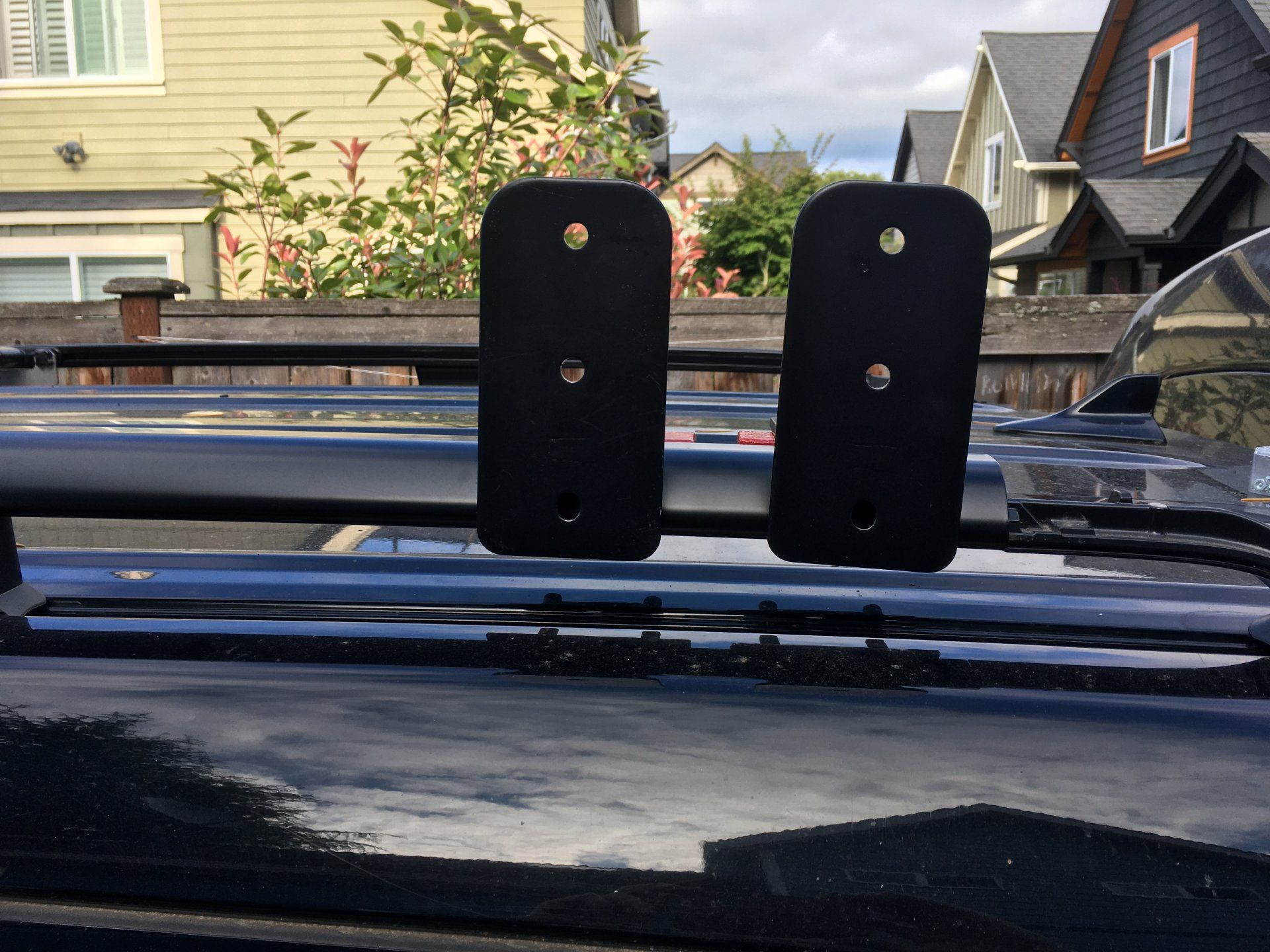

Pics of test fit.

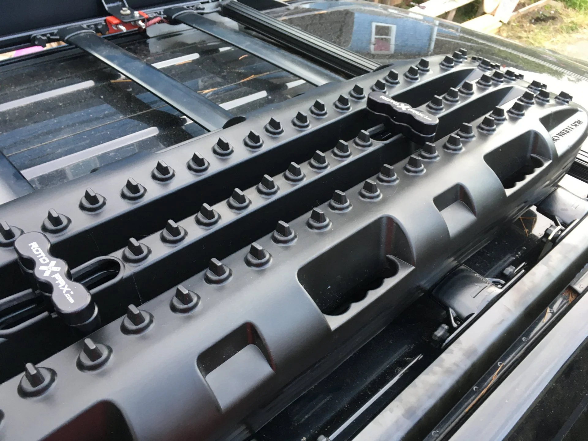

One big difference for rototrax from the other trax I have is the mounts are 17.5” apart, instead of around 30”. More roof rack flexibility for sure. Dlx handles make very secure mounts. Easy to tension.
^That's exactly what I want to do. Thanks for showing us the way!
I’m hopeful it’ll work well. No need for the mount, in this application, handle works great paired with the aero bar mount.
