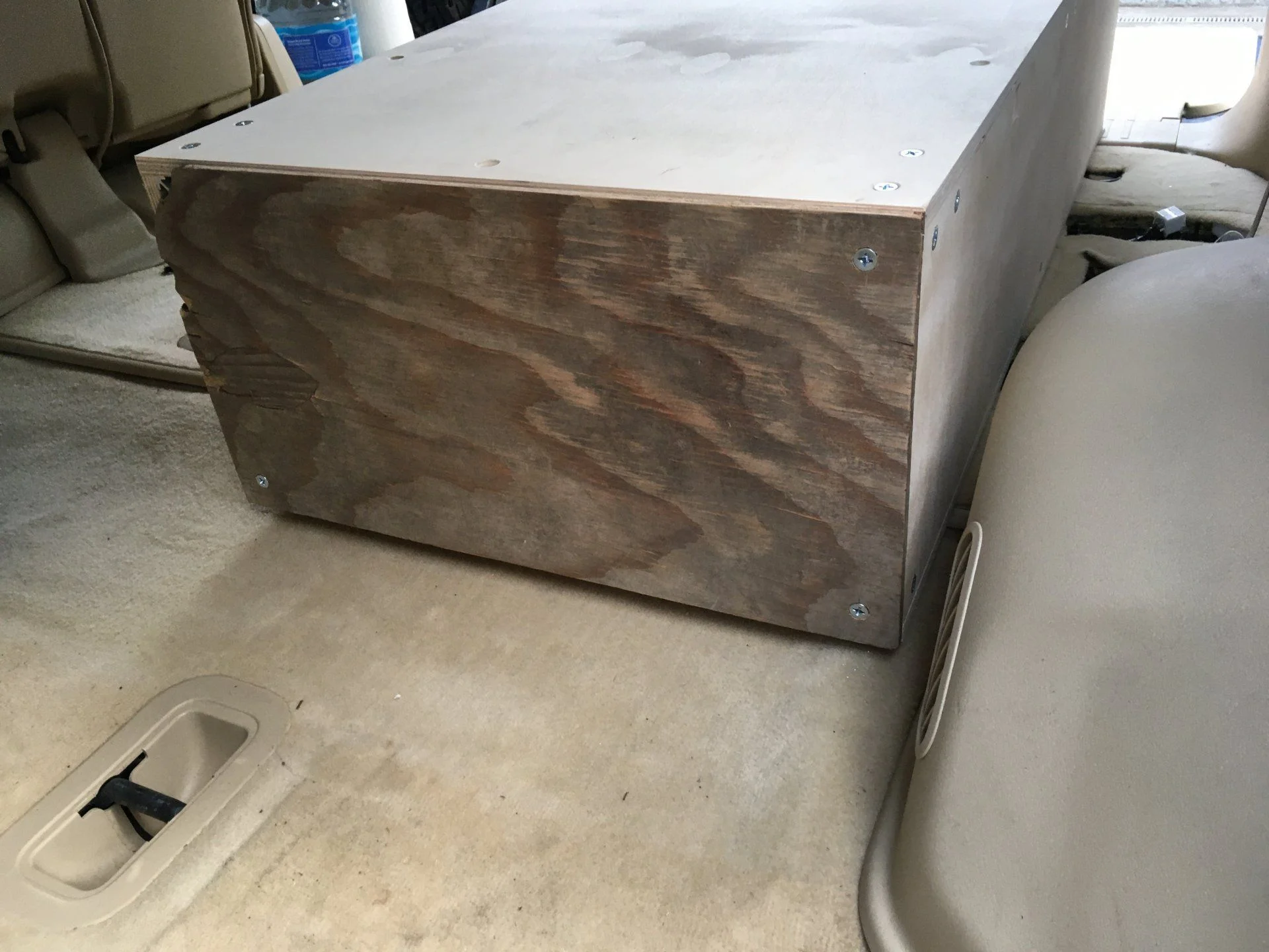

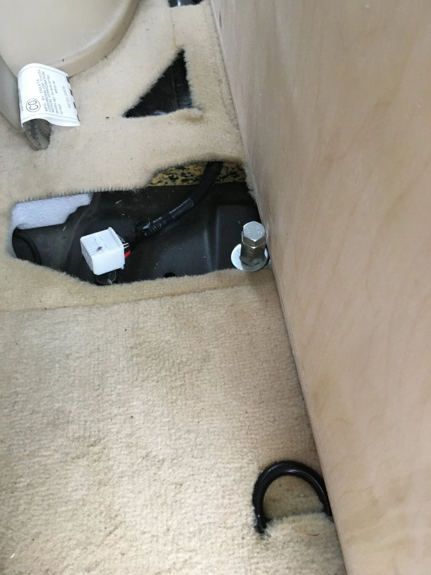

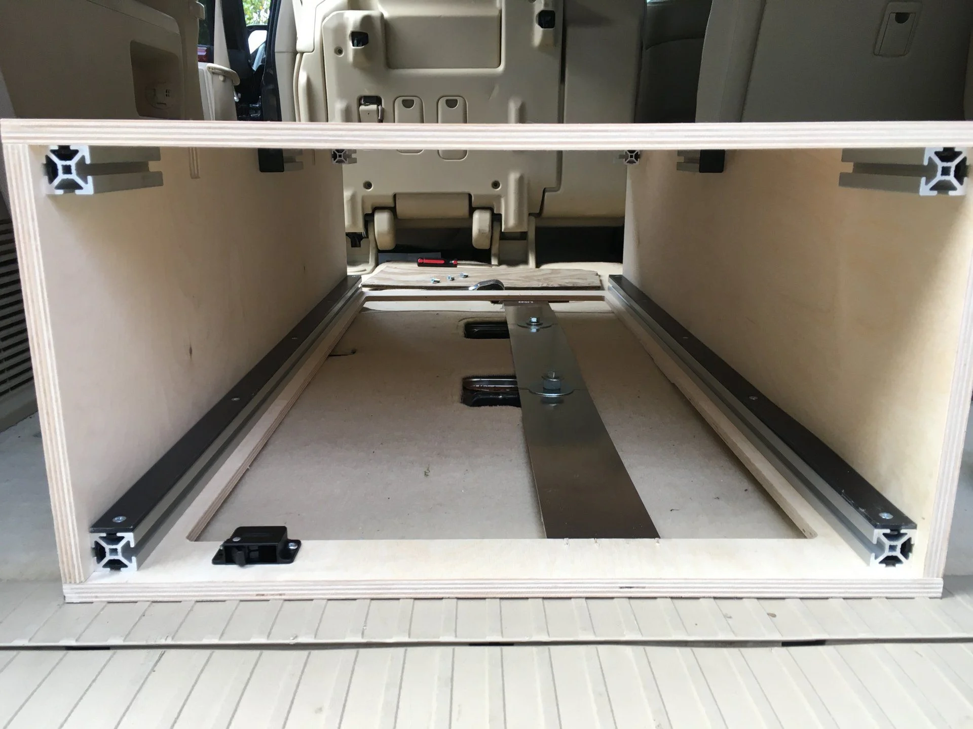

Installed and 3 of four anchors Completed. Not sure where I’ll put the center Front anchor, maybe just have to get the second drawer. Maybe off the seat bracket for the other side with a hook.

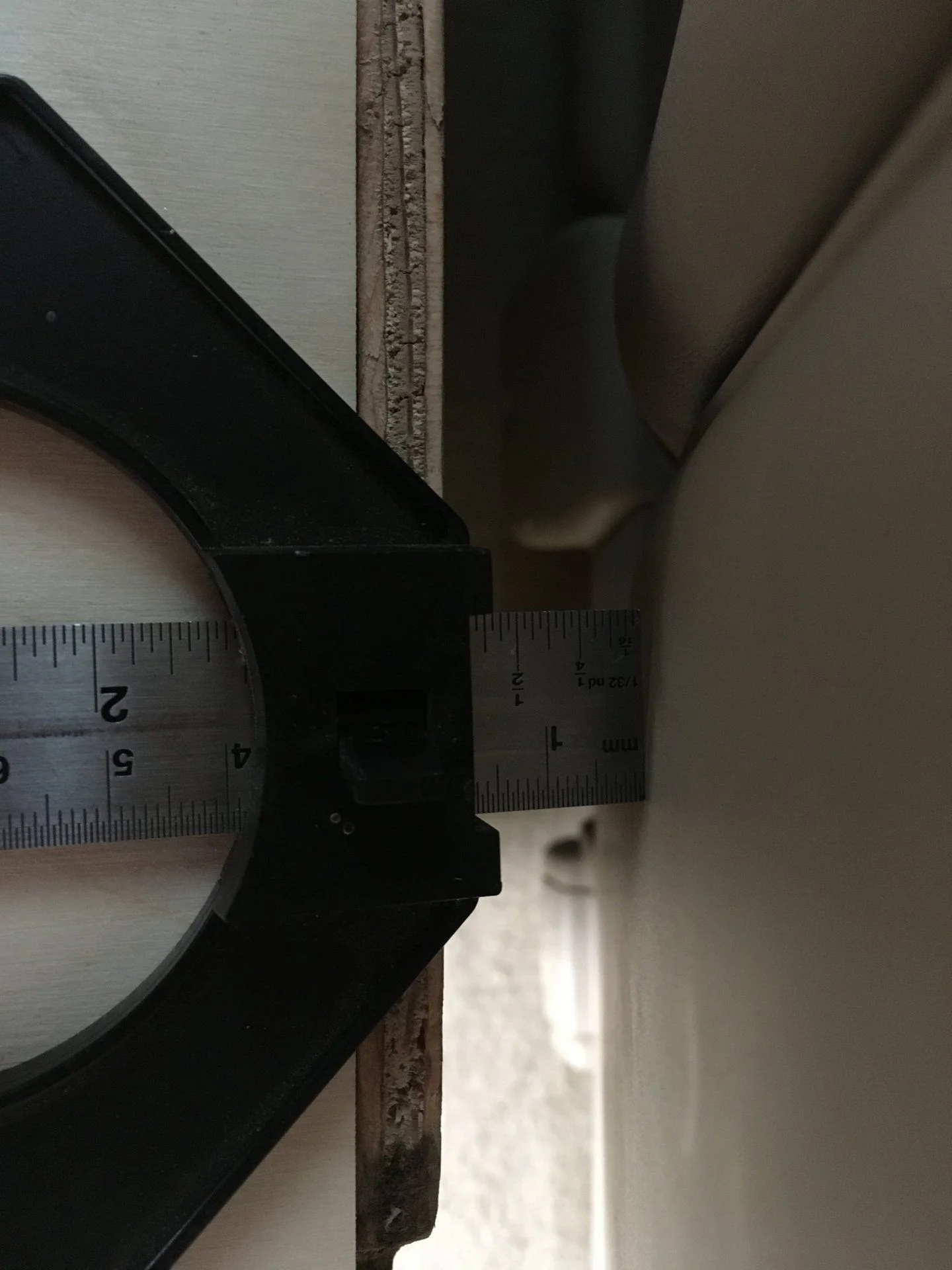

main anchor aluminum bar fit first try, didn’t even have to redrill. Was astonished! Needed 1/8“ shim to clear the tailgate, I have tilted my tailgate up with shorter cables to clear rear bumper.

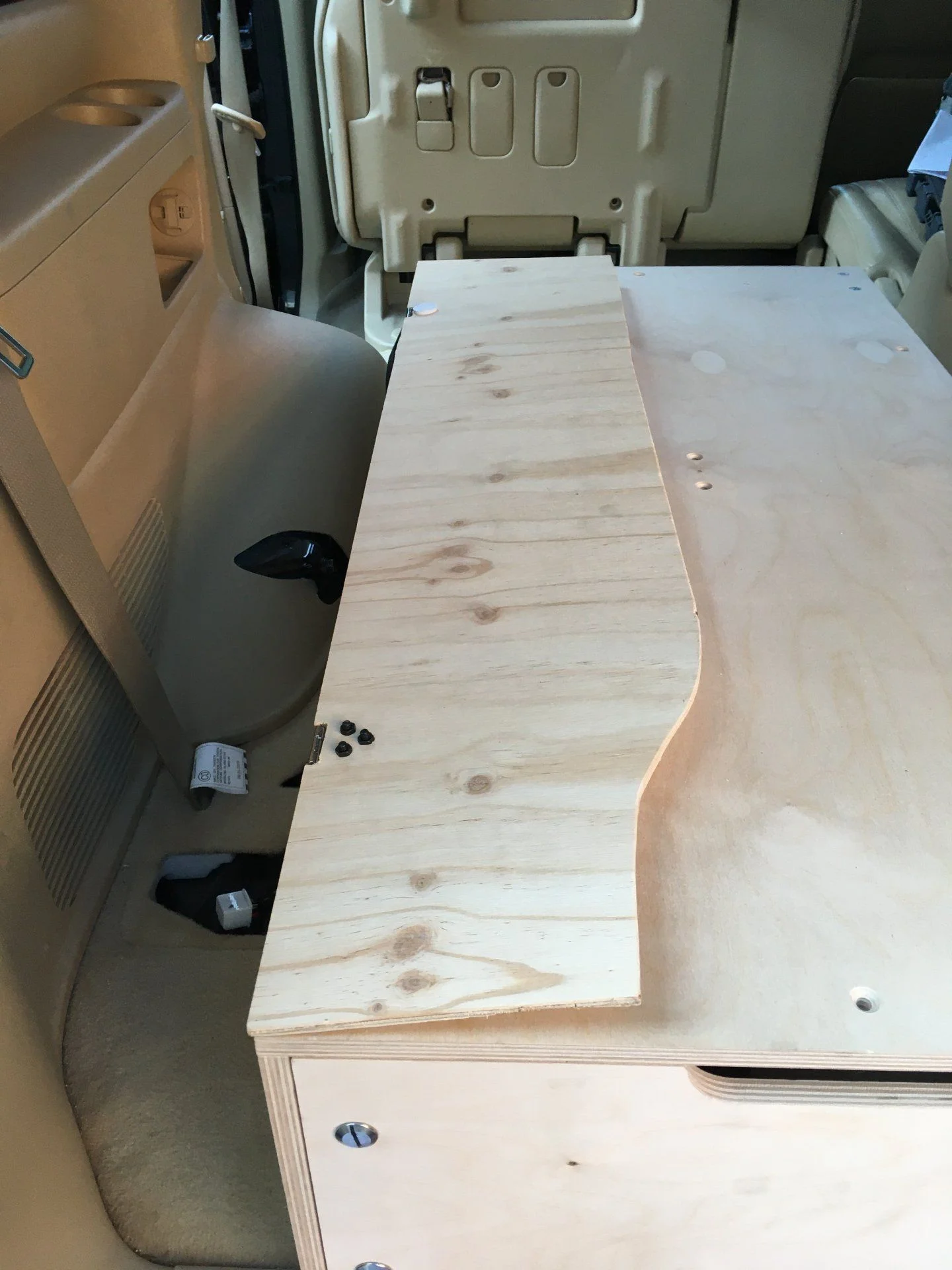

found a plywood scrap That was nearly big enough For the box rear cover. The jump seat comes down too On passenger side if needed. About 3/4” to middle seat all The way back and reclined how it is normally.
will work on the L track and wing tomorrow.
so far 60 mm bolts have worked as anchors, but actual Sizes unshimmed are 60mm, 50mm, 40mm. was almost able to reuse the 25mm on the side but just a bit too short to catch threads.

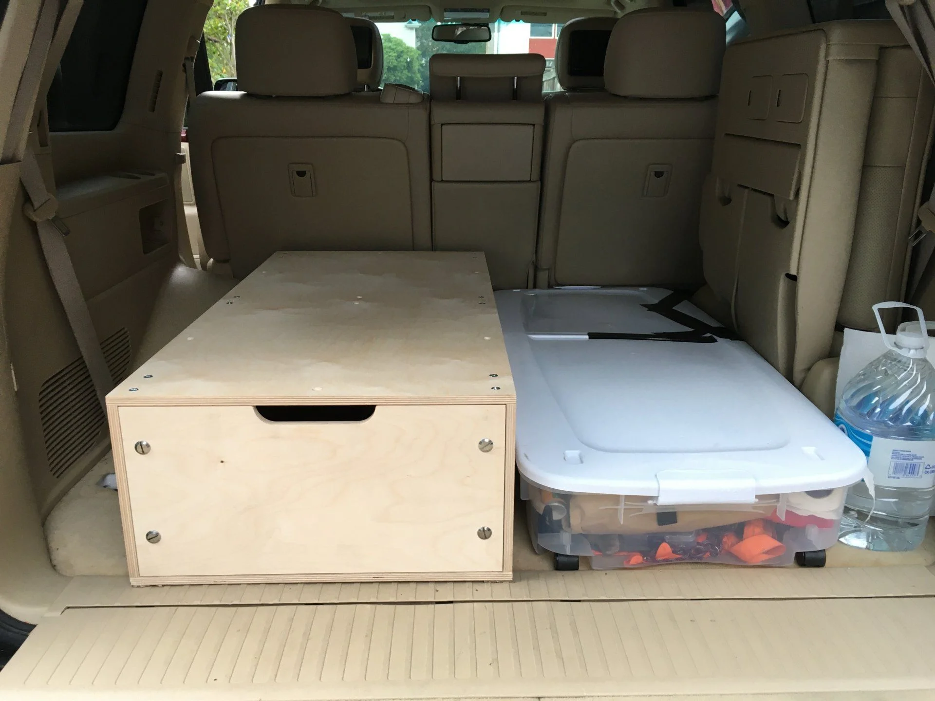

Have you considered the stackable reef?
Yeah, had it in my cart too last week. The incremental savings for shipping wasn't that much, and the tall side was $50 more, so I decided to get one only and see how that worked out. If I end up constrained to just the one side, I think I'd rather have a pull-out platform for the second level; I may also build a 'camp kitchen' type box at some point, which wouldn't fit in a 3 high stack.
I'm not at all convinced that I need the other 3rd row seat; it has been several months since anyone sat back there (of course, Covid), but the kids seem to strongly prefer the 2nd row 'crowded' vs 3rd row stretched out. So it's more likely a horizontal solution will be the final configuration.
I may just build the 2nd drawer or a cubby for the other side. The Reef was half curiosity/learning on how it was put together, half trying to save time, half trying to be reasonable on cost, and definitely low weight compared to the metal based options played a large role. I could cobble together a 2x2 and plywood similar drawer and case pretty quickly to complement.

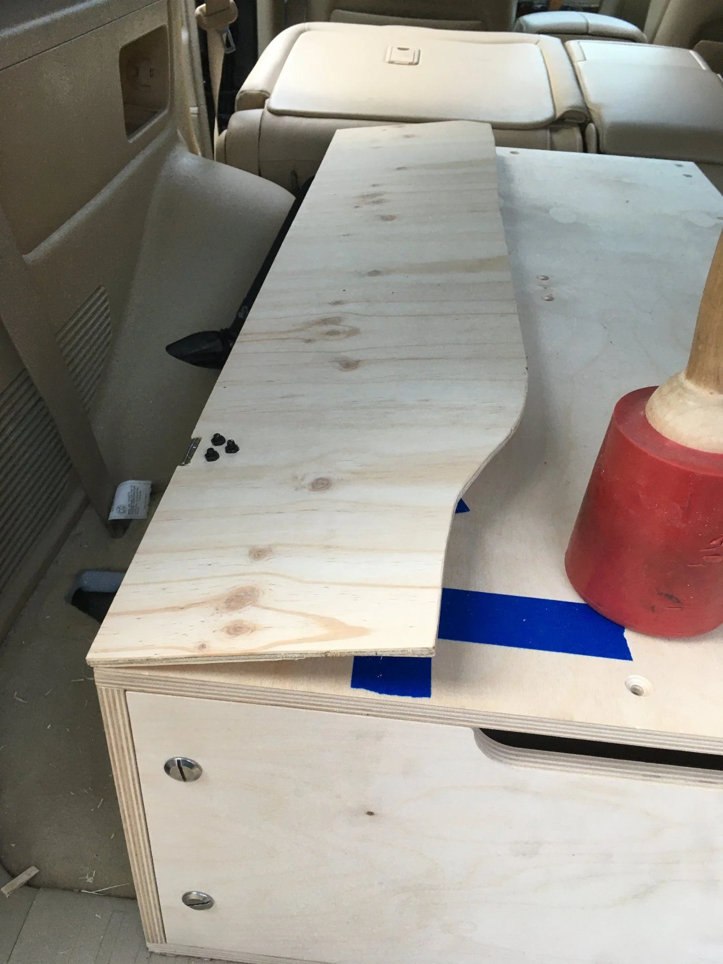

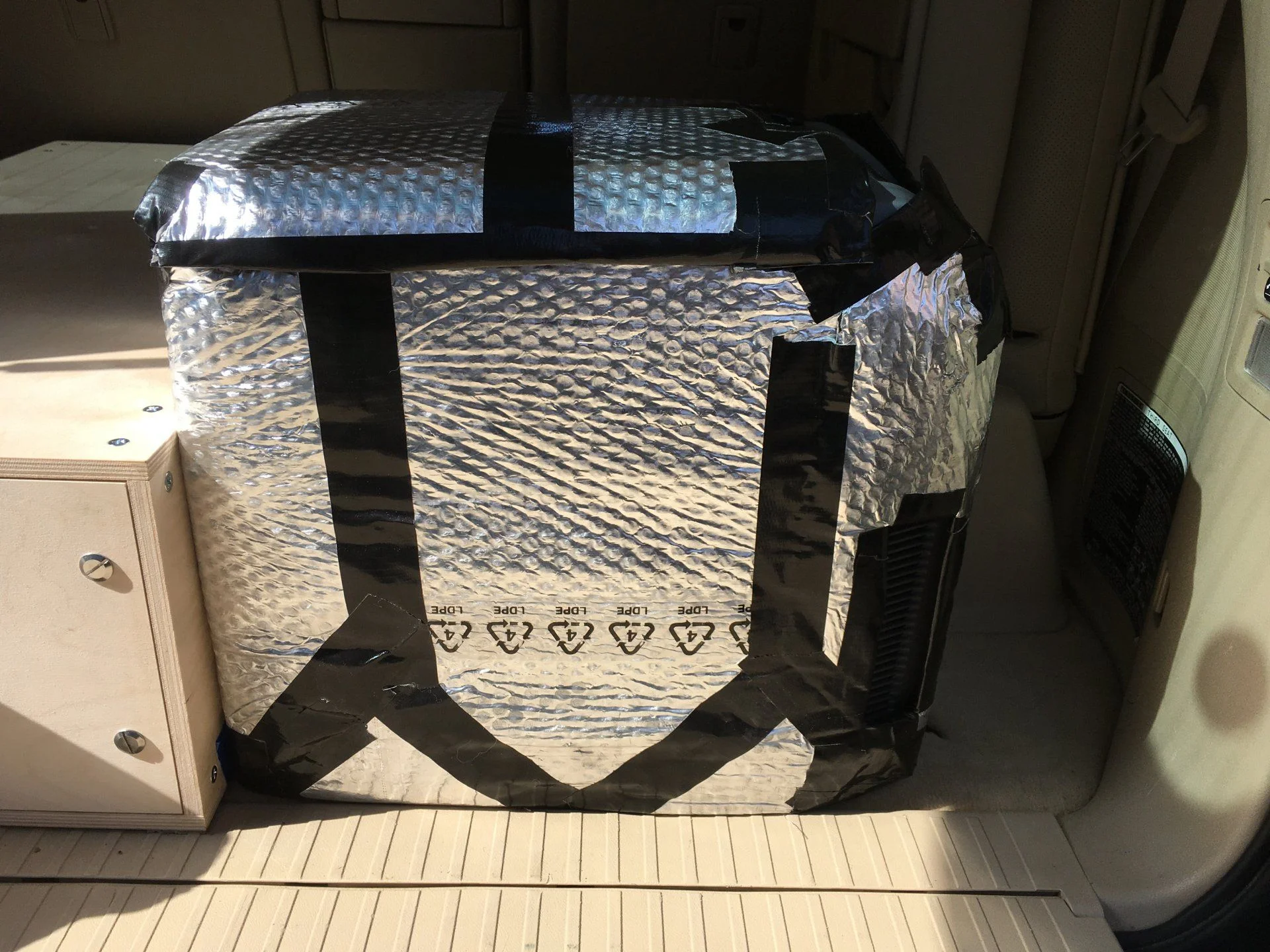

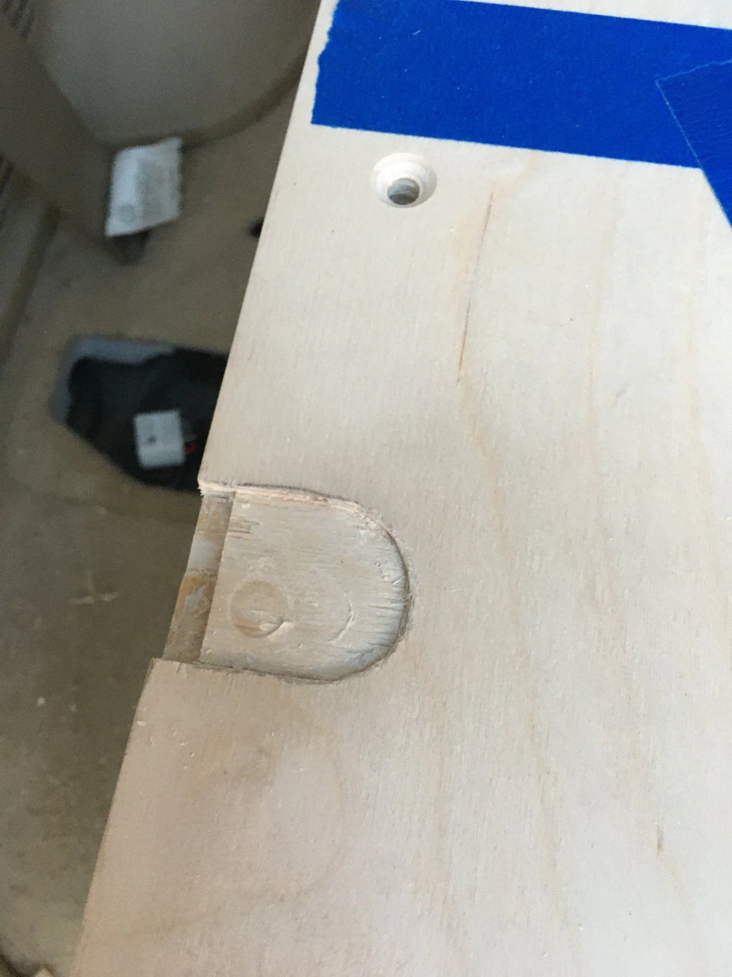

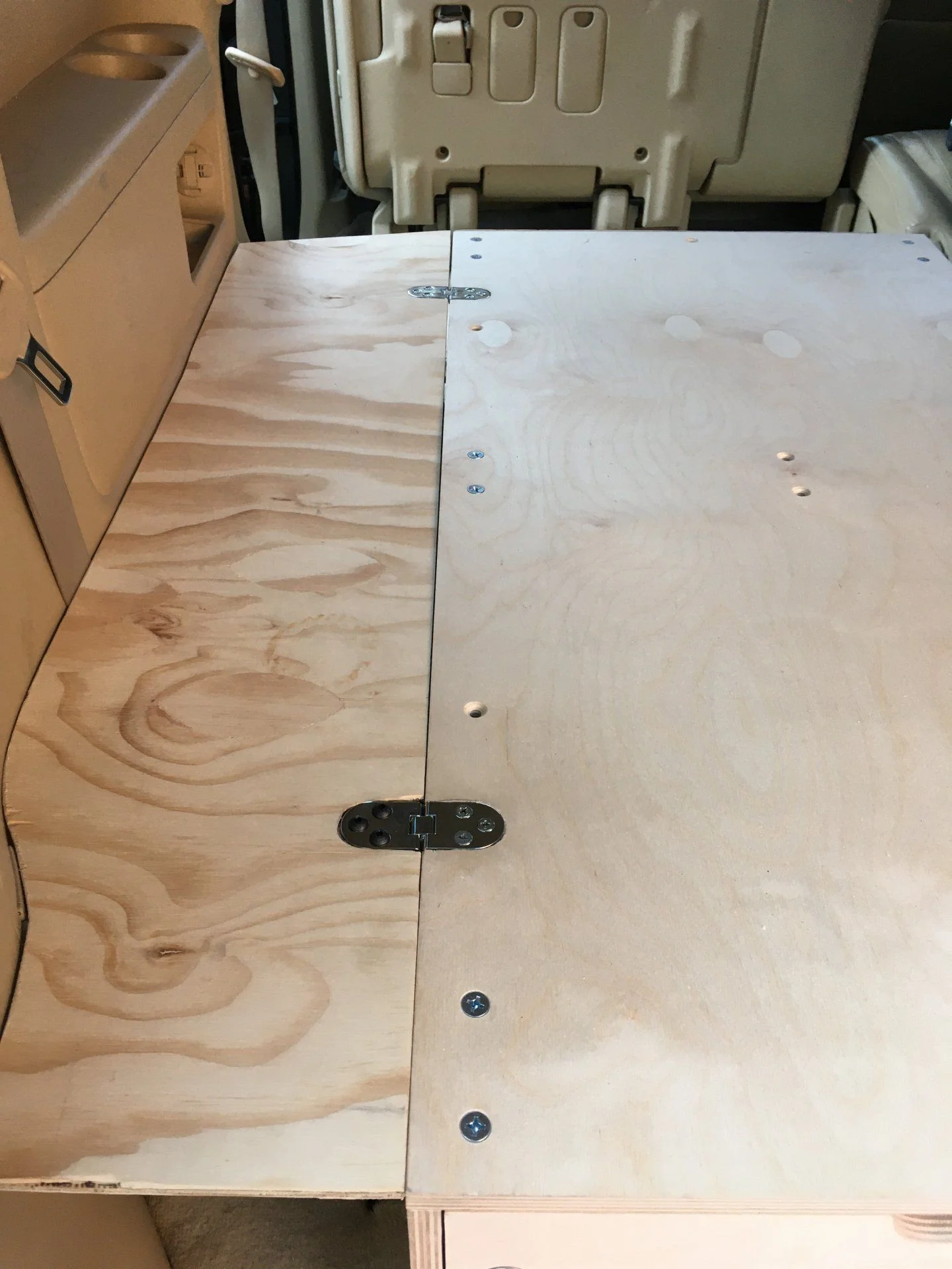

Templated the wing. Also forgot to check if the fridge was going to fit. Yep. Deciding if I want to pull out the router for two little hinge cutouts or not. . . .

Hadn't used my router in a bit. Kids don't like the loud power tools. I have a hand router but recently redid some storage and misplaced the cutter. Took a bit to get back in the groove, but got one hinge done.

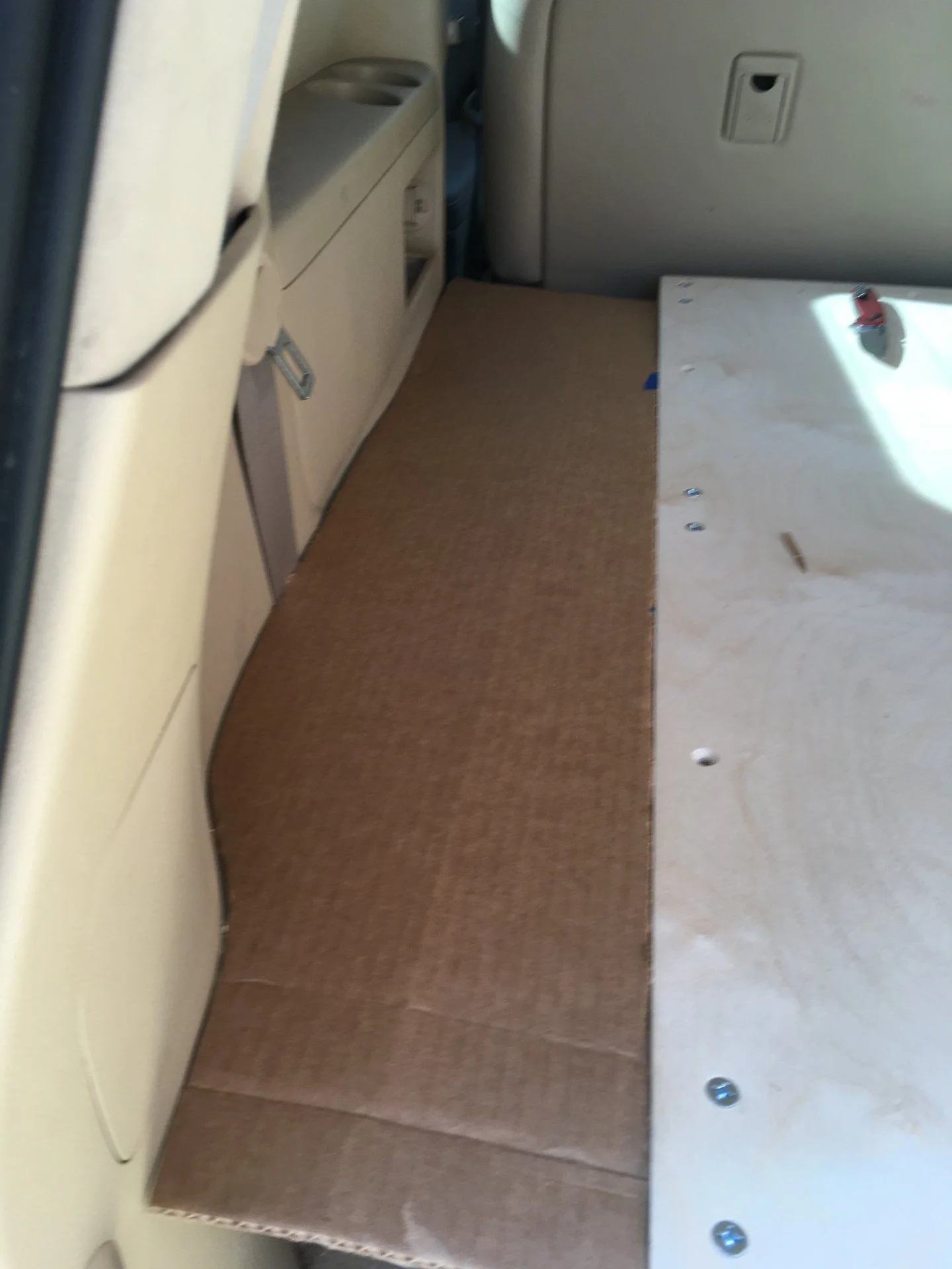

Winged up. Working on the front cover sometime soon, using cardboard for now. Not for a couple days. Have some rotopax stuff to go with for version 2, might have to get the toaster welder out.

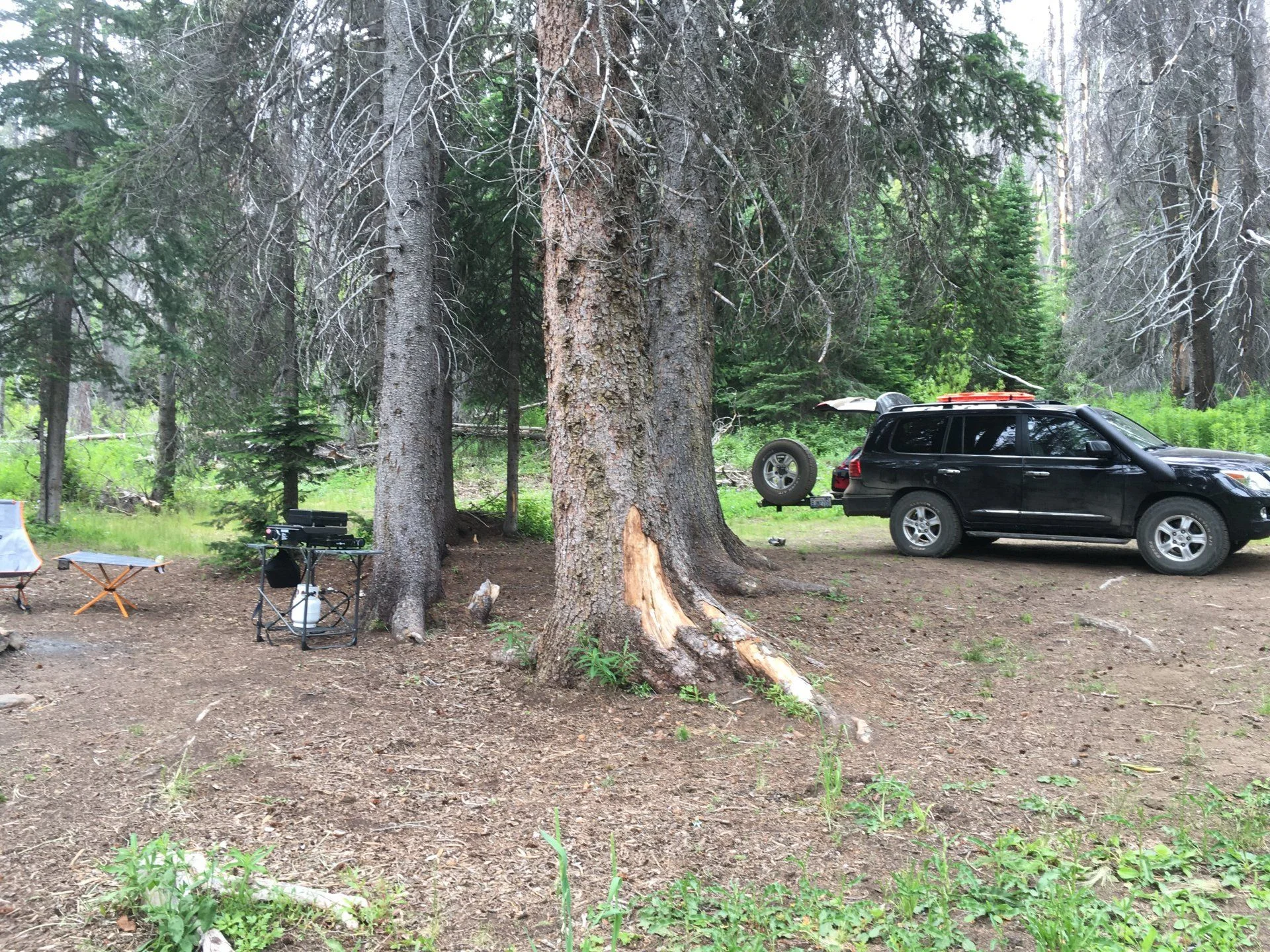

Succeeded in finding a campsite between Ellensburg and Wenatchee which is on a creek. Mosquito pressure low. Nice secluded site 75 feet below the road. The site is in the burned forest we visted a couple weeks ago, so lots of dead trees around, and lots of available firewood. There is a joining of two water systems nearby so, lots of creeks to play in, if you can get thru the deadfalls and nettle. Kids report water cold.
Lat 47.275972 Lon -120.546026
