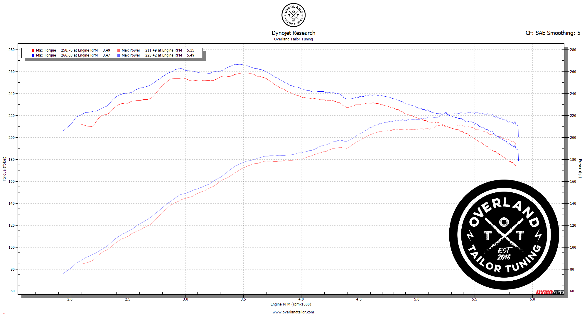

Okay, considering he's local to me, at the end, how much was the whole shabang? Parts, labor.
$550 and 15 minutes of your time. No parts. Just hooks up to your ECU through the OBD port to reprogram it.
If you want we could meet up sometime and you can test out my rig, but if I'm reading it right, you've already re-geared.
Does it need to be "unhooked" every 2 years for CA's smog test? Or is your rig new enough to not need smog yet.
Does not need to be unhooked. I'm uncertain whether it's CARB certified but it doesn't affect any emissions parameters and it was tested using a 5-gas monitor. Based on the sheer number of Toyota and Lexus vehicles running around with this tune, I think we'd hear about it on the forums if it were causing cars to fail emissions. Additionally, they will remove it for free in event that you think it causes your vehicle to fail emissions.

  1. The GX is now running 4.56 gearing! - I got a few quotes and ended up getting it done at Premiere Gears West, using Revolution Gears 4.56's. It was a one day install and they installed REM polished gears which means you avoid the 500 mile break in period. They said you don't even need to change the fluid, however I just may.
    I currently have about 900 miles on the new gears and the combination of the OTT Tune + 4.56's makes this car feel....stock again. Asides from the additional heft, the engine is right where it it wants to be in the power band. I chose 4.56's for the following reasons.
    • The OEM tire size is 265/60/R18, which equates to a 30.5" tire. The current tires are 33" in diameter, which means I have tires which have a diameter that is 8.2% larger than stock which means I have a 8.2% decrease in effective acceleration and torque (assuming same tire weight)
    • Taking the gearing from 3.91 > 4.56 gives me back about 16.6% more torque in every gear. This is twice the theoretical lost torque, however, the new tires are significantly heavier, along with all the added weight that the GX has on board...
    • Thus, the difference between the 8.2% power loss and the 16.6% torque increase to the tires is what I figured would help fight the added weight of everything on the rig and for the most part, this is perfect. The rig is still heavy and I still live in a hilly area, but it does MUCH better now. I could've gone 4.88's, however I still daily drive this on the freeway to work so I didn't want gears that short.
    • Total MPG loss with the new gear setup is about 1.5 mpg, a bigger hit than I estimated, however it could be me just having a bit of a lead foot now that the rig CAN ACCELERATE again...
    • I have access to a stock 2017 GX that I ride in once per week so I do my best to compare power between the two, and the stock GX is still lighter on it's feet and quicker off the line presumably due to being lighter.
