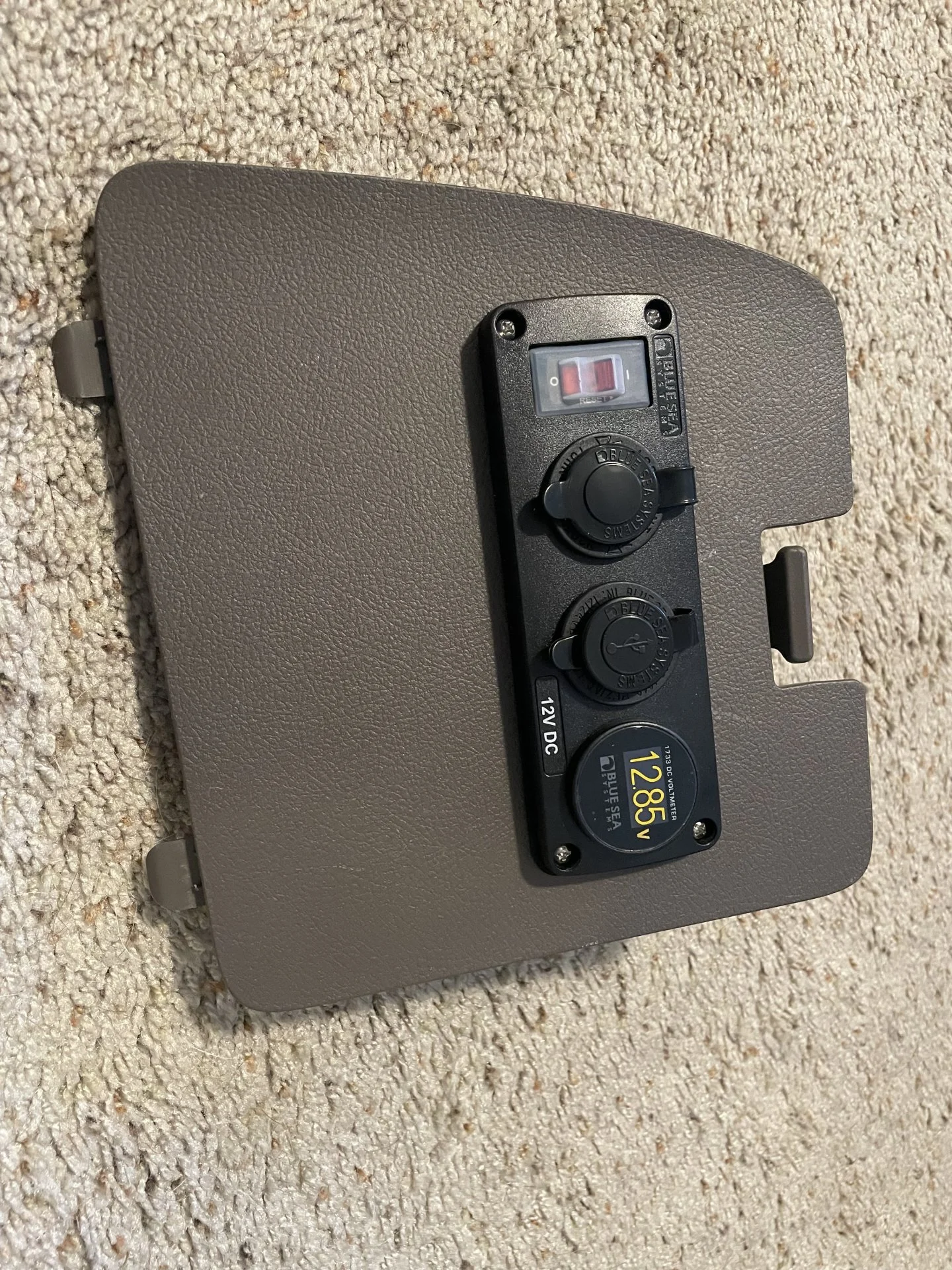

I stumbled on @THEOZMAN 's third row power tap harness, and wanted to implement this with a Blue Sea Power panel, as the combination would easily bring yet another +12V source to the rear of the vehicle (we all know that these are hugely lacking...)
I went with the Blue Sea 4366 power panel, as it would provide 2x USB ports, a 12V cigarette lighter, as well as a battery voltmeter, all of which were linked to an in-line circuit breaker. I liked the idea of the voltmeter, as tapping into the third row seat power is a constant power source (i.e. this is not switched to the ignition). Therefore, the in-line voltmeter would help ensure that I never draw my (starting) battery down too low.

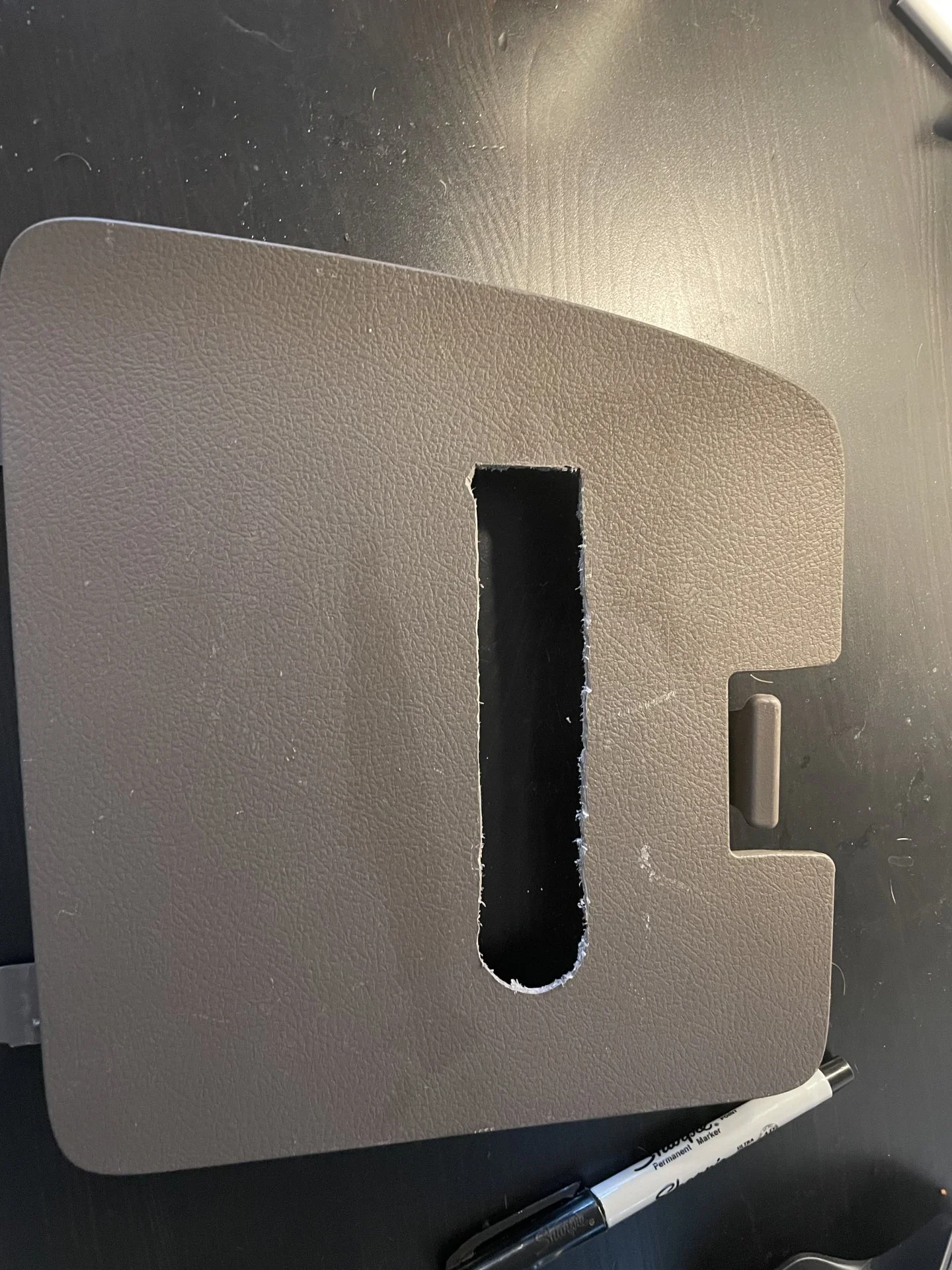

Like most of my other mods, I tried to mount the Blue Sea panel on a removable piece of trim (for ease of installation & ease of "restore to factory" if I ever wanted). The Blue Sea Panel came with a foam gasket that I traced onto the trim piece. After a few holes and some filing, I could fit the Blue Sea panel into the trim piece:

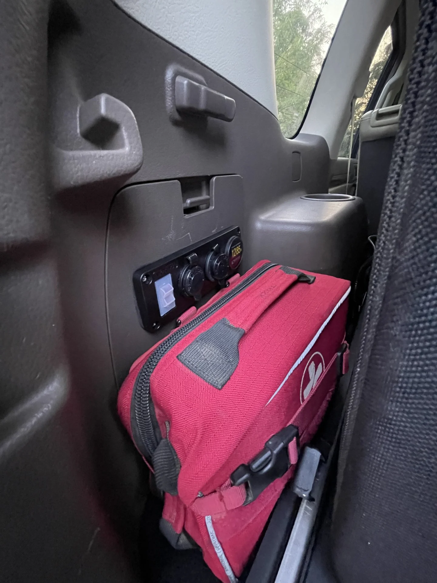

With the Blue Sea Panel now mounted onto the trim piece, it was as simple as plug n' play: I simply interfaces the 3rd Row Power Tap harness with the (+) and (-) terminals on the Blue Sea Panel, and viola.
This was a super simple, yet highly effective mod. On my last outing, I was charging my cell phone and my portable battery all from this panel, and boy am I glad I did this mod. For reference, the @THEOZMAN also sells a "Splitter" style power tap, that doesn't require the removal of the third row seats / connectors.

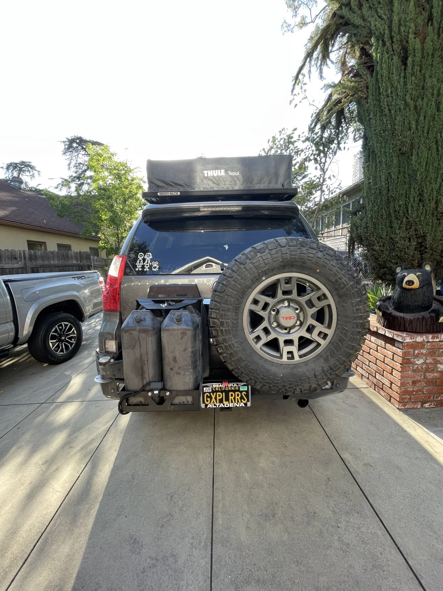

As I mentioned in the above posts, I wanted to relocate the relocation of my backup camera. I initially followed the Victory 4x4 Relocation instructions, but after that was said and done, I wanted something that was a little less intrusive, and something that would allow me to run a rear tire trash bag. I finally had some time to mess around with this, and my results are below.

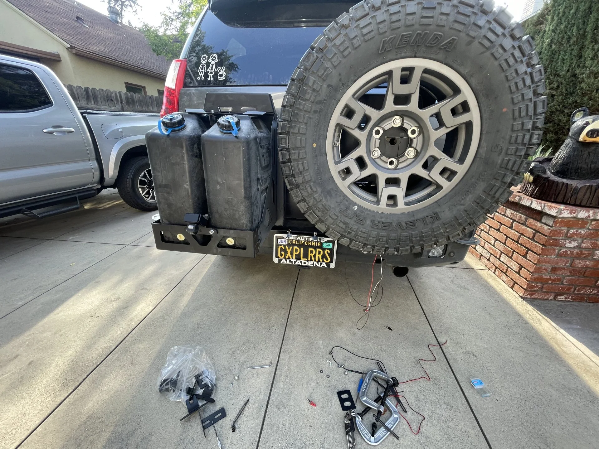

Using the Victory 4x4 supplied parts (in ways other than they were intended), I was able to drill 2x holes in my Dual Jerry Can Holder, and mount the camera brackets directly to the Jerry Can Mount. I used the supplied button head fasteners to do this, and I was careful to put the button head side near the jerry can, so I wasn't scraping the water cans against the threaded portion of the bolt (there is only a hair of room to work with here). The below photo is deceiving, as I spent probably 2-3 hours playing around with different camera locations, to check the field of view (hence the C-Clamps pin the ground). After testing probably half a dozen locations,. this one was seemingly the best.
With the camera now mounted, I wired it using the same techniques described in the Victory 4x4 video, but I pinned everything to a 6-pin DT style connector, that would allow me to unplug the assembly if I ever wanted to (without having to unplug at the camera directly). I will add that adding this additional connection may have dropped the camera resolution a tad, but it's hardly noticeable.

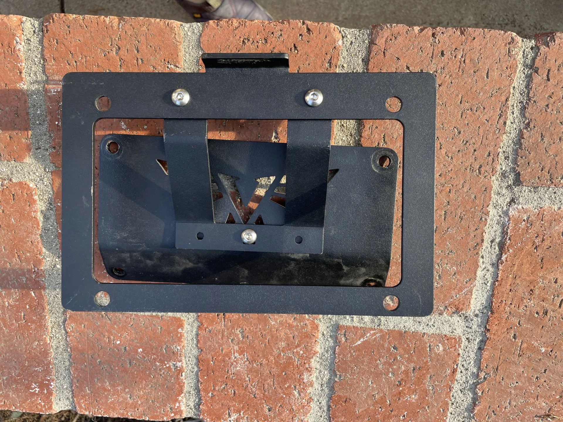

With the camera mounted, it was on to the license plate mount. I ended up drilling a few holes in the "bumper cover plate" on the strike rear bumper, and using one of the Victory 4x4 mounts in this location. The below photo shows me using the center bolt in the bracket to keep things positioned, before I drilled the two additional holes on the left and the right (ultimately these two holes would be the ones used). After this point, it was basically just gluing the license plate LED onto it's little "lip" above the license plate holder, bolting everything down, and wiring it all up.
With everything buttoned up, I was pretty happy with this installation. I feel like it makes the vehicle look a bit cleaner, and most important, it will allow me to run a spare tire trash bag...(Note the little pink binder clip below was used to hold the LED in place, while the gorilla glue dried).
