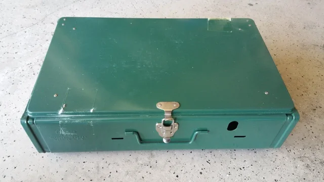

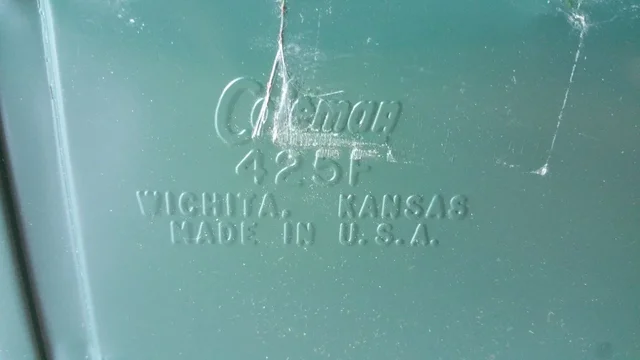

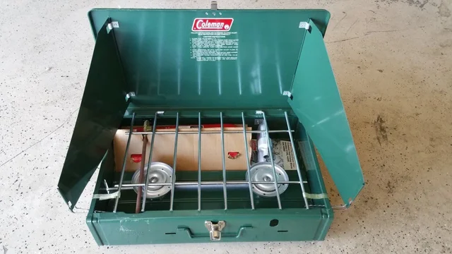

Found a new 425F on CL and grab it as soon as possible,it was 10 min. away from where i work. This is in better shape than the 426D i bought a few months back. This perfect for solo road trips.20150802_112921.webp20150802_112752.webp20150802_112620.webp20150802_112632.webp
The Tab? Bah..
