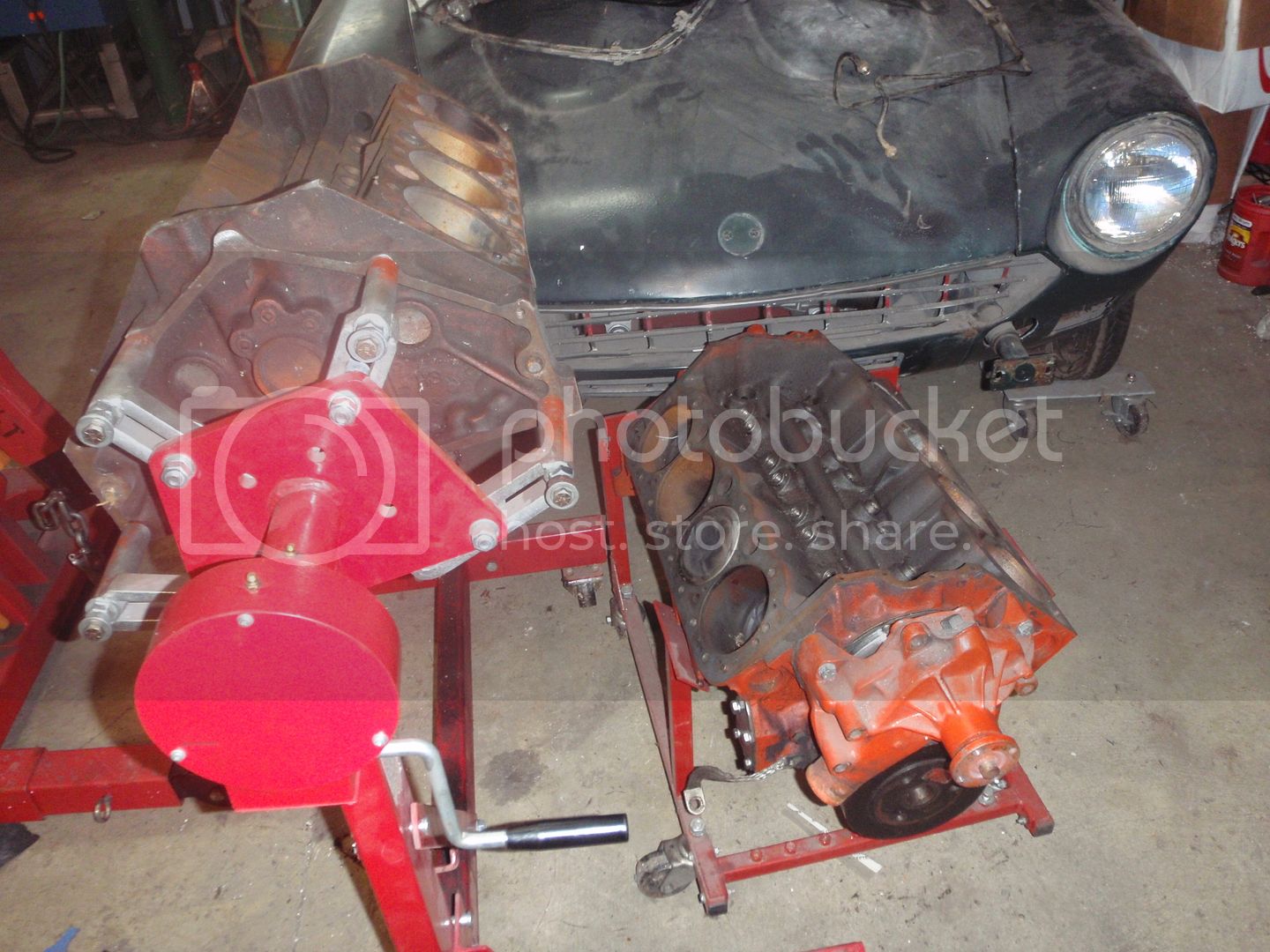

Most of the older engines we removed that short front bolt and temporarily replace it with a longer one . Holding the rod in the retracted position you can snug the long bolt to hold it there , then install your pump . Remove long bolt , re-install short one and it's done .
Sarge
What you say here may be what I did. I know I was working by myself, so I was questioning my memory after what I wrote in my post. I know I don't have the needed third hand to have held the rod in place and also bolt on the pump. Or do I? I don't know now. It's not fun to get old as your memory is the first thing to go, or at least I think that's my problem.
Don
the motor pictured is a 400 (the orange one), but you can see the two bolts on the passenger side, just above the oil rail, on the front of the motor
the upper bolt is the one you remove and put a longer bolt in. Don't lose the short bolt, and don't leave the long bolt in when you fire it up unless you like selling cars to me with a flat pump lobe at bargain prices.
Also, don't be ham-fisted, finger tight will generally be more than enough to keep the pump rod up in place...
