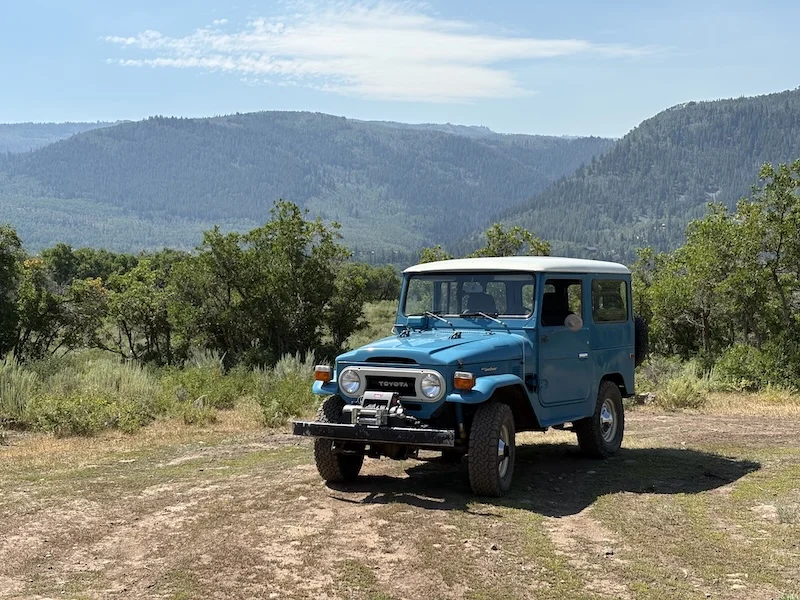

This will be the build thread/documentation (not sure how I get the “Builds” tag) for my new-to-me 1976 FJ40 named Otis. The truck was named by the previous to the previous owner, and it fits so the name happily will stay. I bought Otis from fellow IH8Mud member @Phrog in late July of 2025.
My history with Land Cruisers and journey to purchase Otis can be found here:
Third time's the charm? - hunting another FJ40
TLDR: This is my 3rd FJ40 since 1995, all have unintentionally been 1976 models. Tan then red now blue.
While I never say never, the intention is that I'm in for long term ownership. What's different this time is that I now have tools, dedicated shop space at home, and no need for this to be a daily driver. Don't have huge amounts of time, but I've found that vehicles are patient.
For a sense of my plans I'll answer @cruisermatt's frequent question: what are your long term goals with this? I want to continue to keep Otis on the road and reliable so I can enjoy the driving. I live up in the Utah mountains with lots of great dirt roads to explore, and I want to get up there to camp and hike, and just have fun driving him around. Want to be able to cruise at 60mph for a long stretch if needed. I tend towards originality, but do enjoy practical upgrades where they make sense. Otis is largely stock, and is plenty capable enough to do what I want to do. Rough road driving is fun for me, but rock crawling is not really my cuppa. So a lift is unlikely, but the DUI ignition update the PO did is nice. Wouldn't swap in a V8, but fuel injection wouldn't be out of the question at some point. Want to keep Otis on the road and drivable, and limit larger projects to winter months and only as needed.
Otis is a solid truck, that has been maintained and repaired over the years. There is some rust (front floors the worst) but nothing fatal. Engine runs well, and most everything works. As I've driven him over the last little while I've developed a list divided into 3 parts: Critical to address soon, Repair to get to some day, and Upgrade for that maybe-someday list. Very little on the critical list, so we'll start there and enjoy the driving.

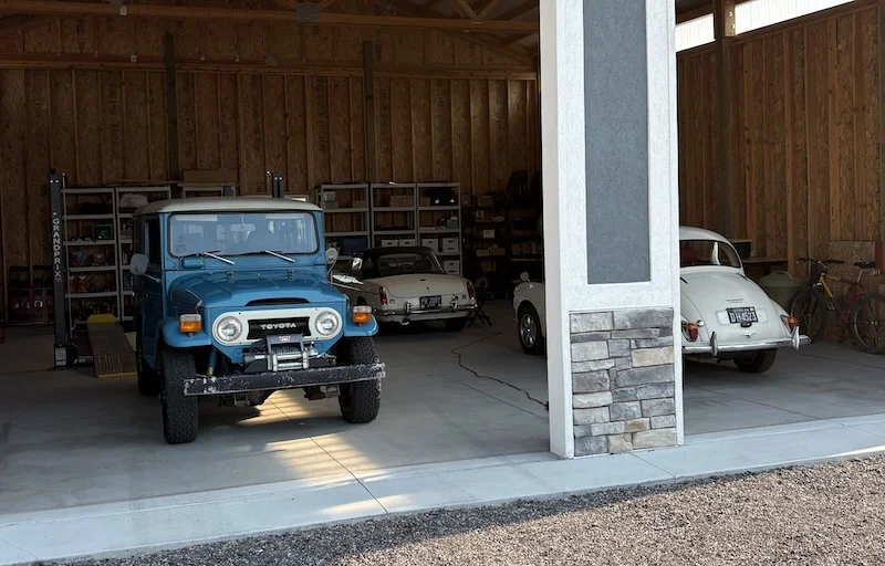

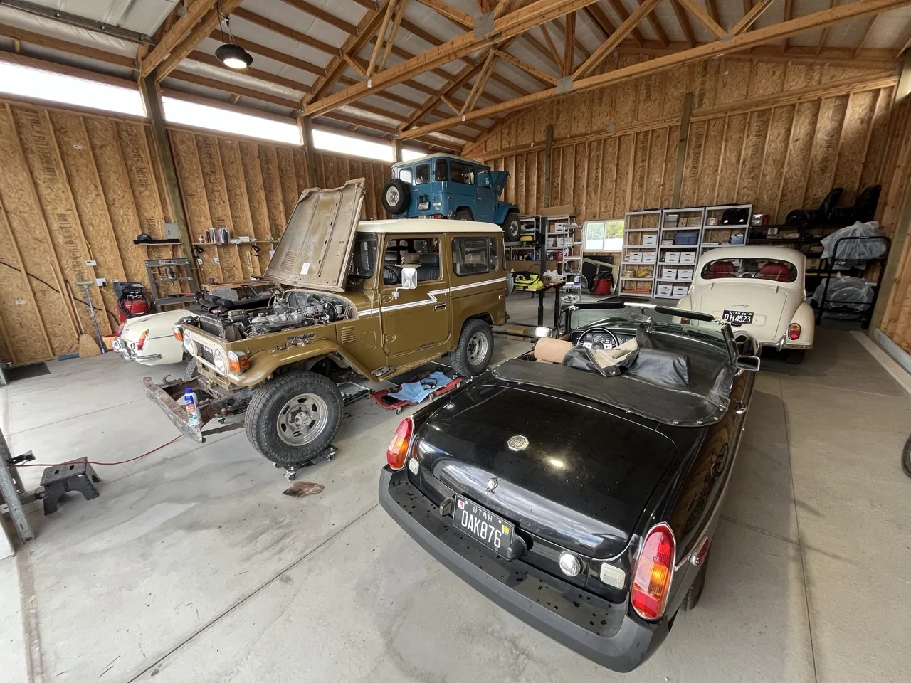

Lastly, here’s Otis getting to know the rest of my little rag-tag fleet:

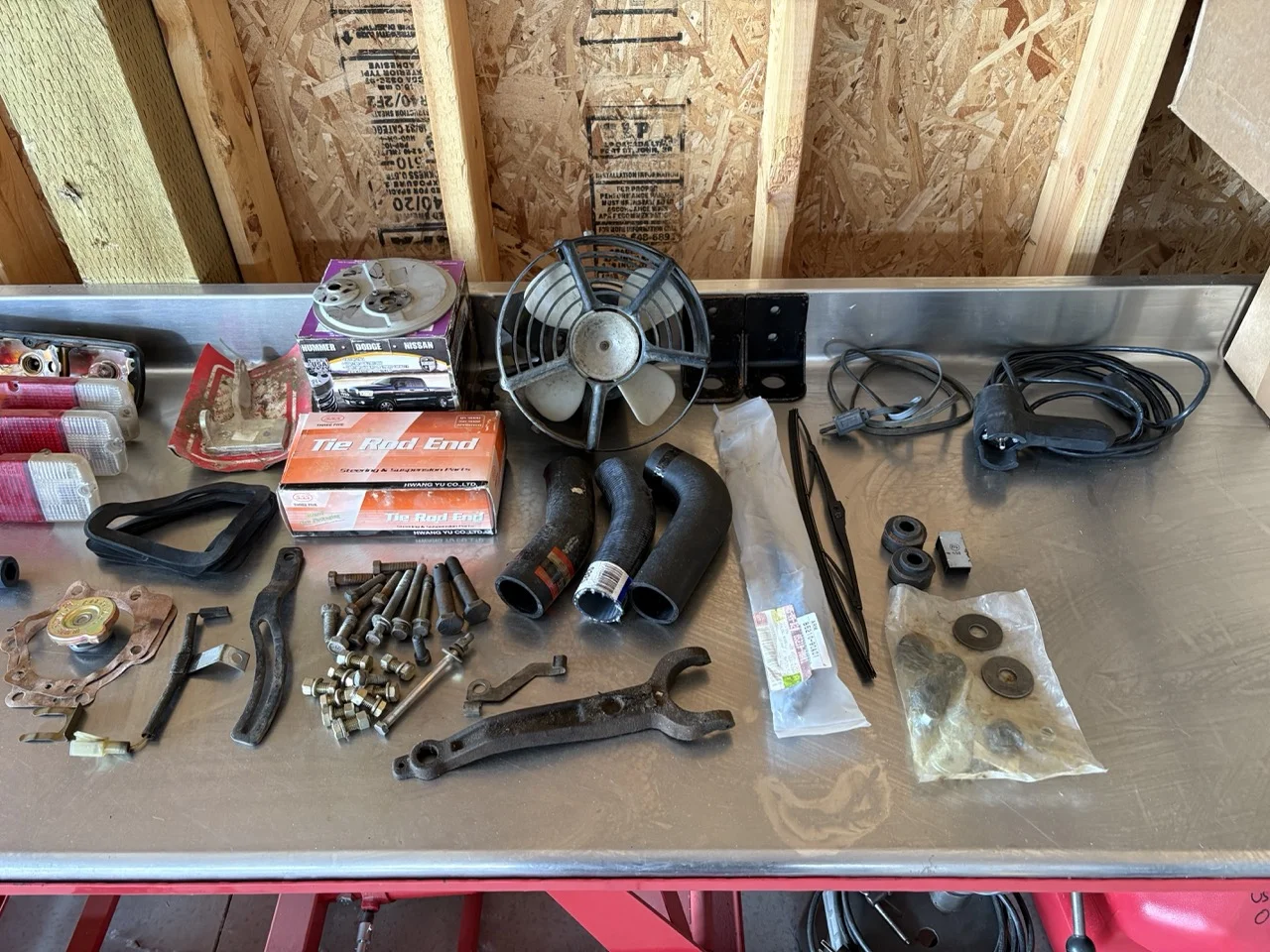

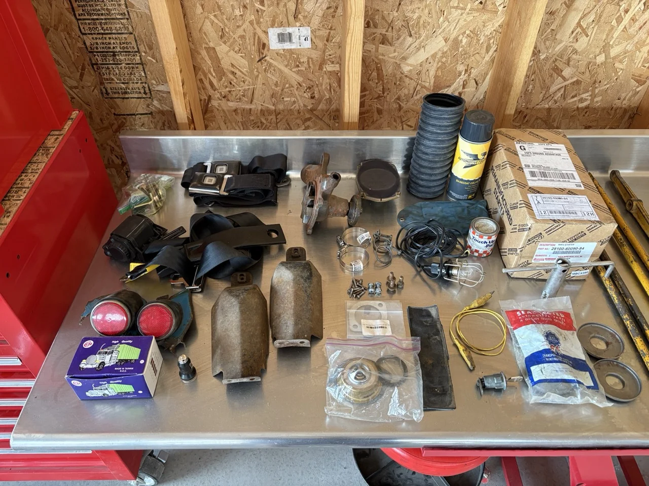

Otis came with a few boxes of random parts. Some cool stuff including:
  • rebuilt starter
  • trouble light and the little blue vinyl bag
  • original touchup paint
  • original style jack (unfortunately not working)
  • extra set of the long jack handles
  • carb fan, condition unknown
  • new tie rod ends
  • new body mounts
  • kick vent gaskets (I almost ordered a set before I found that a stash came with the truck)

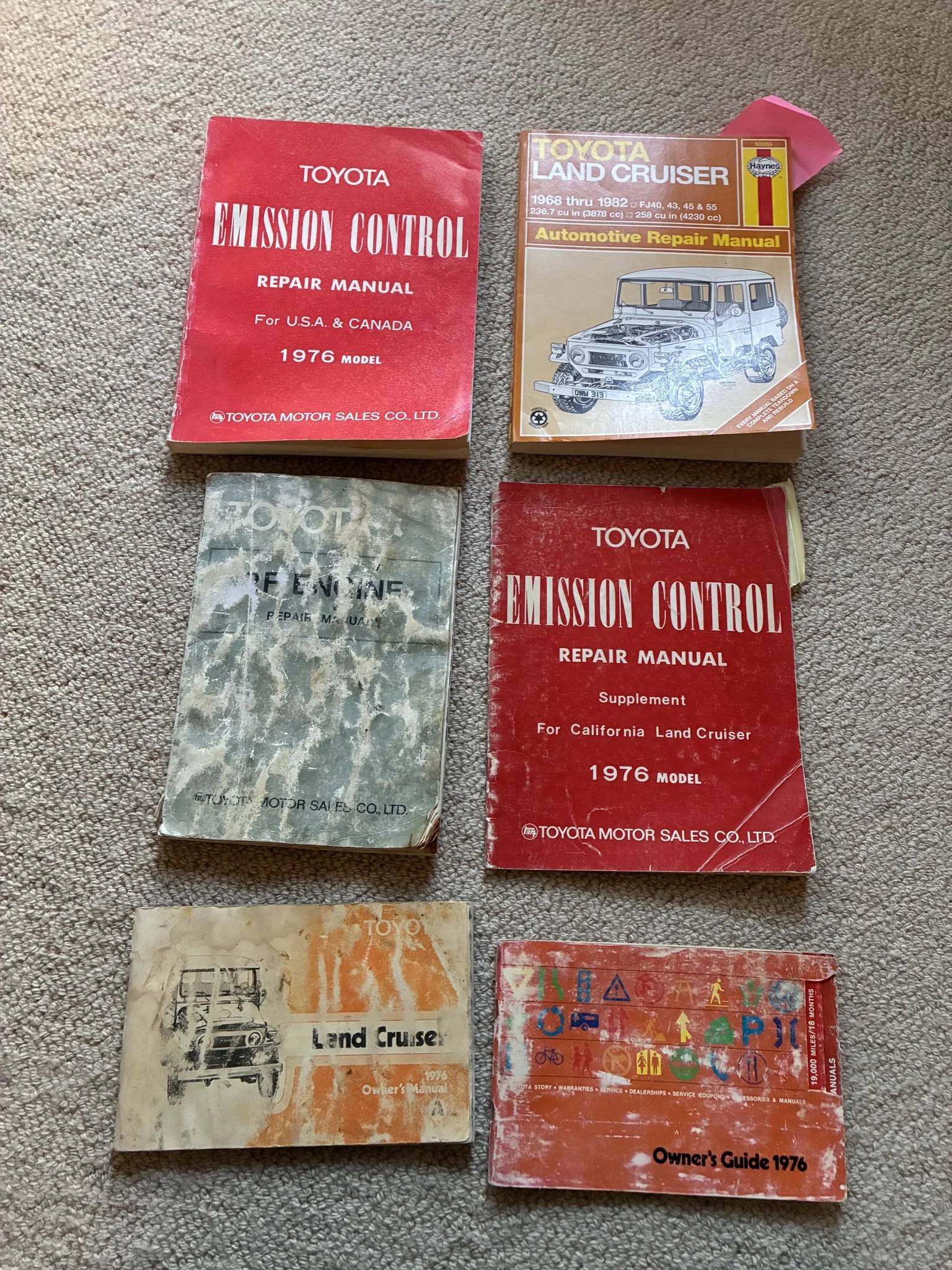

  • original owner’s manual, Toyota brochure, and a few of the factory shop manuals
All good stuff, but as of yesterday I need to get more active in my search for the other factory manuals and get a parts order in place, as my little drive up into the mountains proved to be more of an adventure than I had expected! More to come.

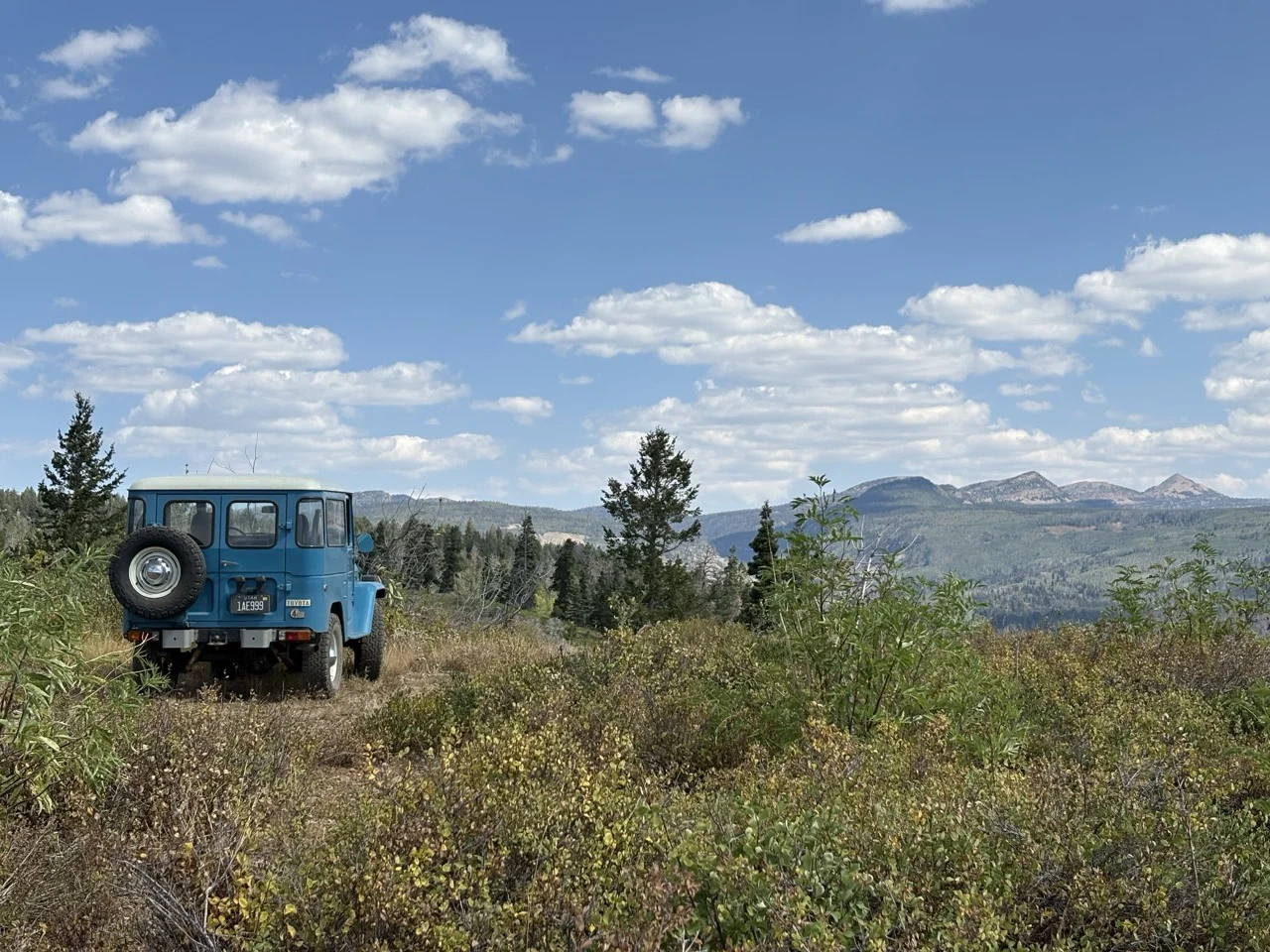

I had yesterday (Labor Day here in the USA) off, and decided it was time to get outside for a while. Fired up Otis and headed to a trailhead near my house. Took a nice 6 mile hike with good views of some of the early changing colors here. I still had some time left when I got back to the trailhead, so I pointed Otis up the dirt road and went exploring. I’ve hiked and biked these roads a bunch, and knew they were rough but should be easily passible. Sure enough, Otis and I meandered up to a nice lookout point with minimal fuss, low range 1st gear used just to keep things slow and steady. I’ve only put about 350 miles on Otis since the purchase, so I’ve been staying fairly close to home while we get to know each other.
Turns out that was a good idea. <insert dark, foreboding music here>
