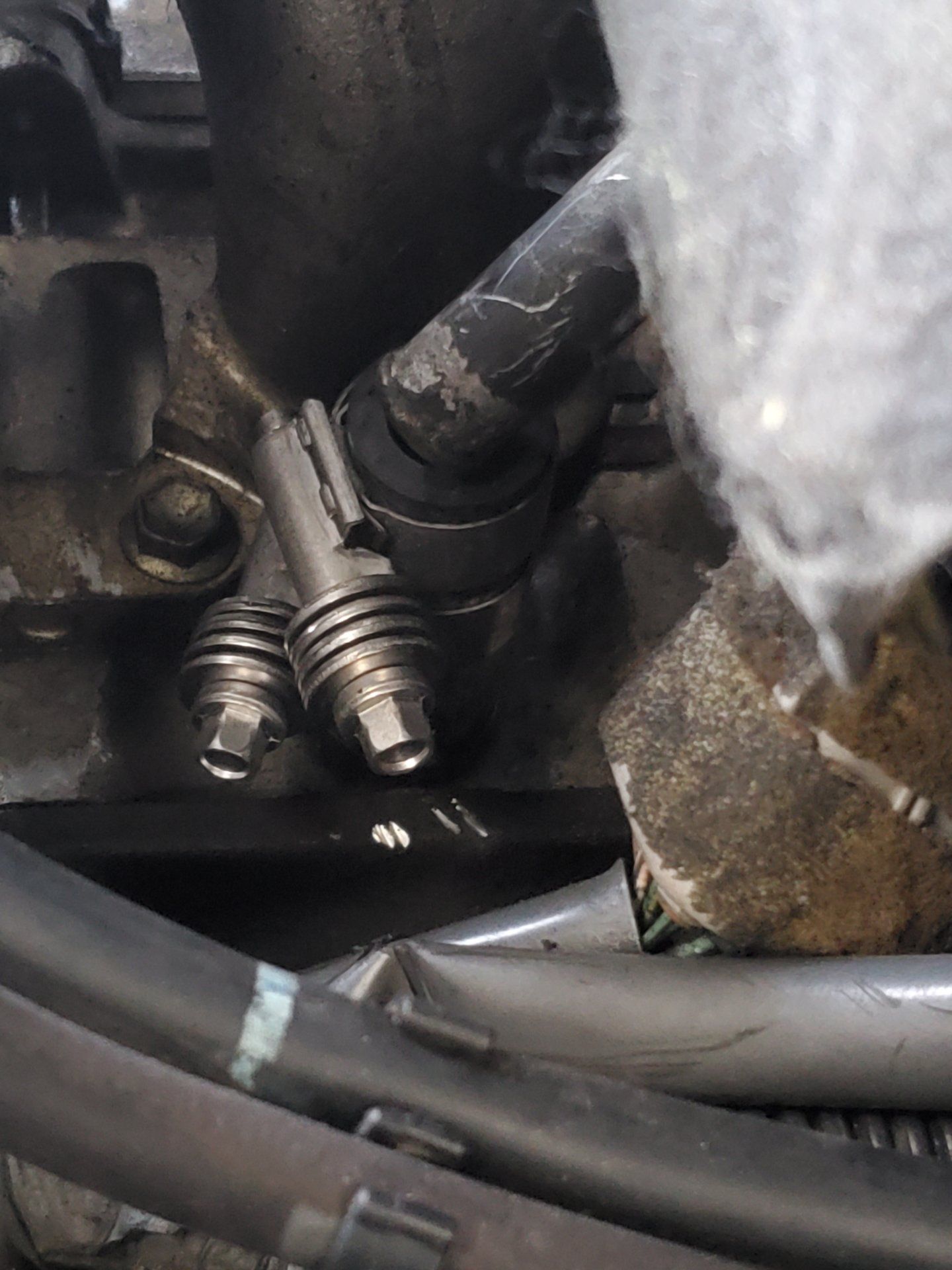

Got started on the PHH today.
Looked a tiny bit wet on the block side?
Spent a lot of time fighting, took about an hour to get it out. The block side clamp was oriented in such a way that it was impossible to get anything grabby on it. Wound up attacking with a box cutter and dremel then was able to get it twisted enough to put pliers on it and get the old hose out
Aaaand now I'm stuck on reinstalling the new one.
Should I have put it on the metal tube first?
I ran out of daylight, I'll pick up where I left off this weekend. With nowhere to be and good weather for the Miata, I'm not too worried about having the rig out of commission for a few days.

I think you need to attach one end of the hose before putting it back there.

PHH got finished that same weekend, same for the O-Rings. I've put 200 miles on since doing the repairs and no signs of coolant leakage!

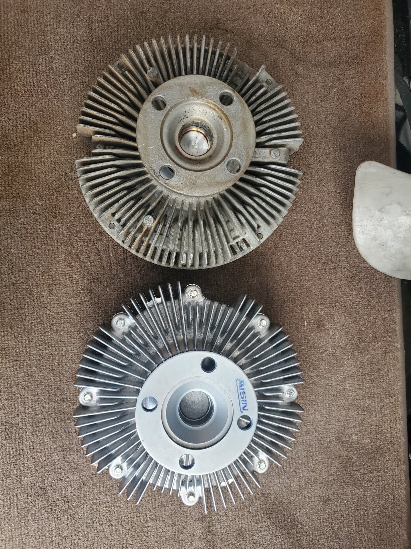

Ordered some 555 Tie Rod ends from Marlin and a spare tire lift and modified blue fan clutch from Wits End. I've got a torn tie rod boot so I figured I'd replace them all. The fan clutch is preemptive, I haven't had any overheating issues and I'd like to keep it that

Your old fan clutch looks like an Eaton clutch. I believe they were an OEM supplier for the Land Cruiser. They are good clutches, and some may argue better than an un-modified Aisin clutch - defintely hold on to it as a spare.
