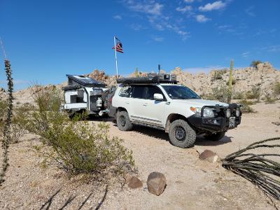

Great build thread . Surprising, I am done with my 2013 200 series. 33K of travel in two years with lots of off road travel .
Feel free to pick my brain.
Done as in done with the build or done with the vehicle and now you plan to sell and move on? I've read some of your posts, good stuff.
Done with the build . I'm expecting this truck to last the rest of my life. I kept my last Land Cruiser(FJ60) for 22 years . Thanks . I also write magazine articles about trips.
