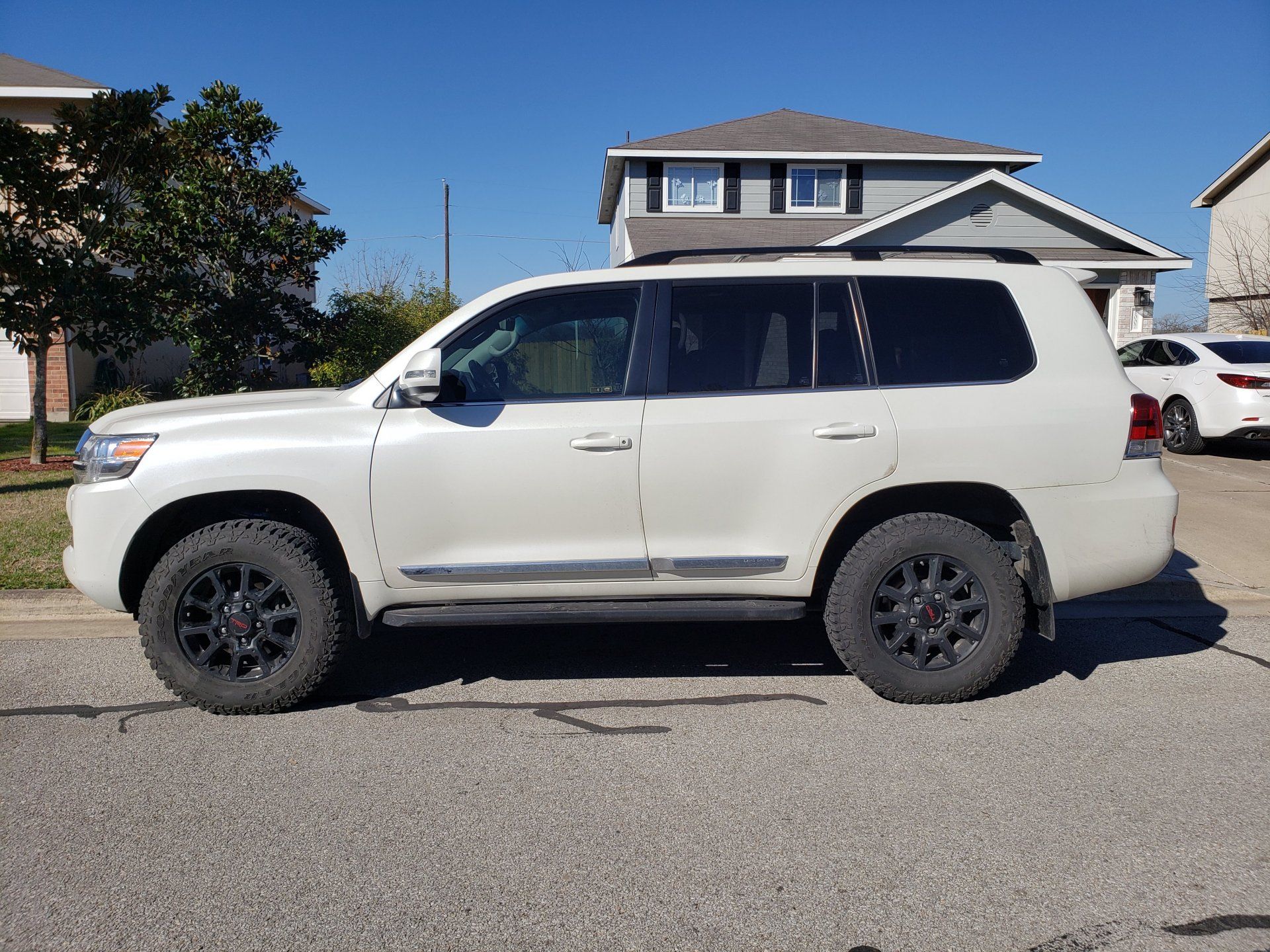

Rear Spidertrax 1.25" wheel spacers are on, the stance is so much better looking IMHO. I am still waiting on the second set to arrive for the fronts, not sure why the shipment go split up but when it comes to USPS I am never surprised lol. I removed the small front/front mud flaps in anticipation of the tire rubbing on them once the wheel spacers are installed, I guess I'll have to wait and see if there's contact anywhere else once they go on.

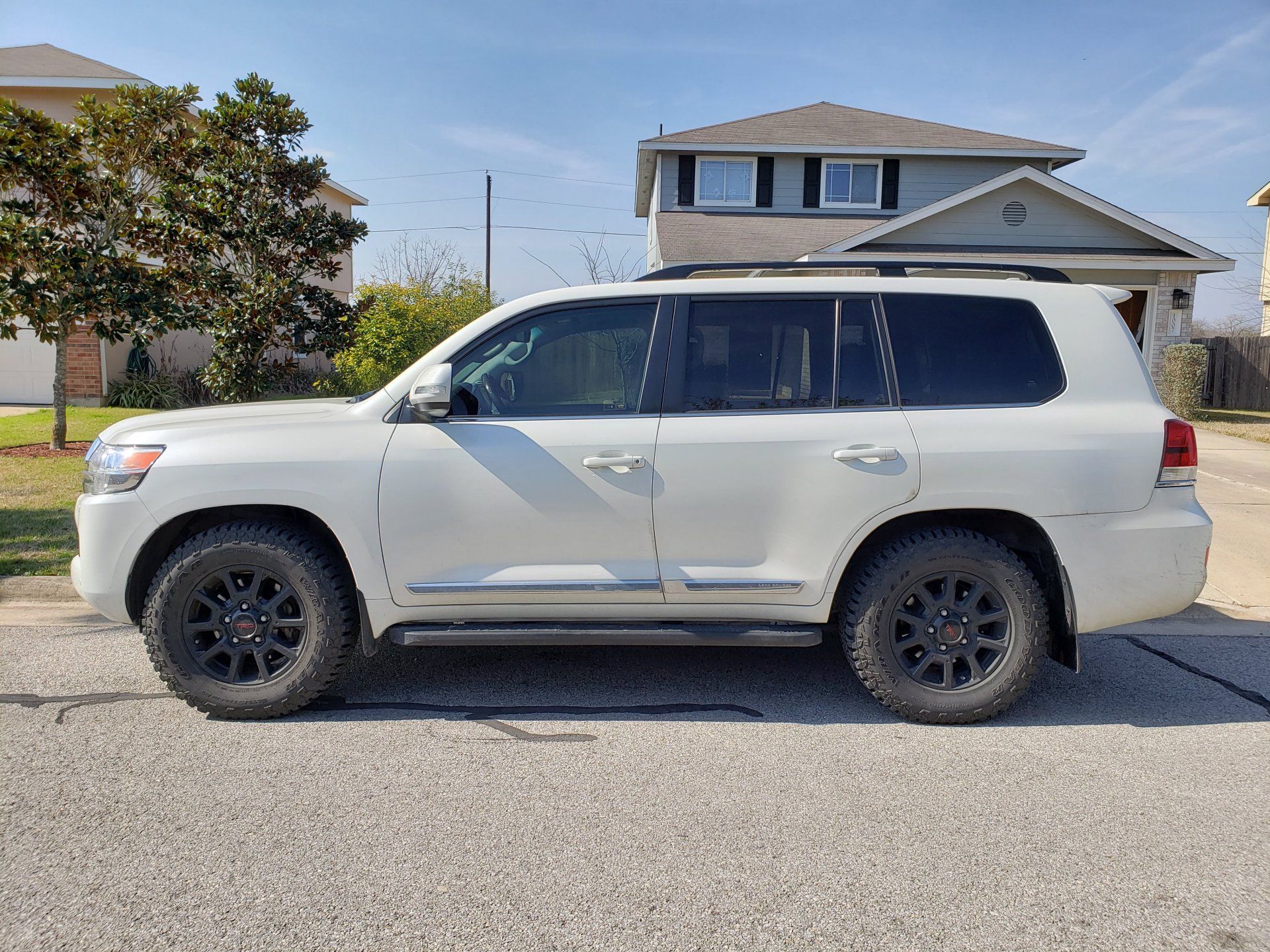

Before
After
You have the lugnuts on backwards. Spidertrax Install Instructions

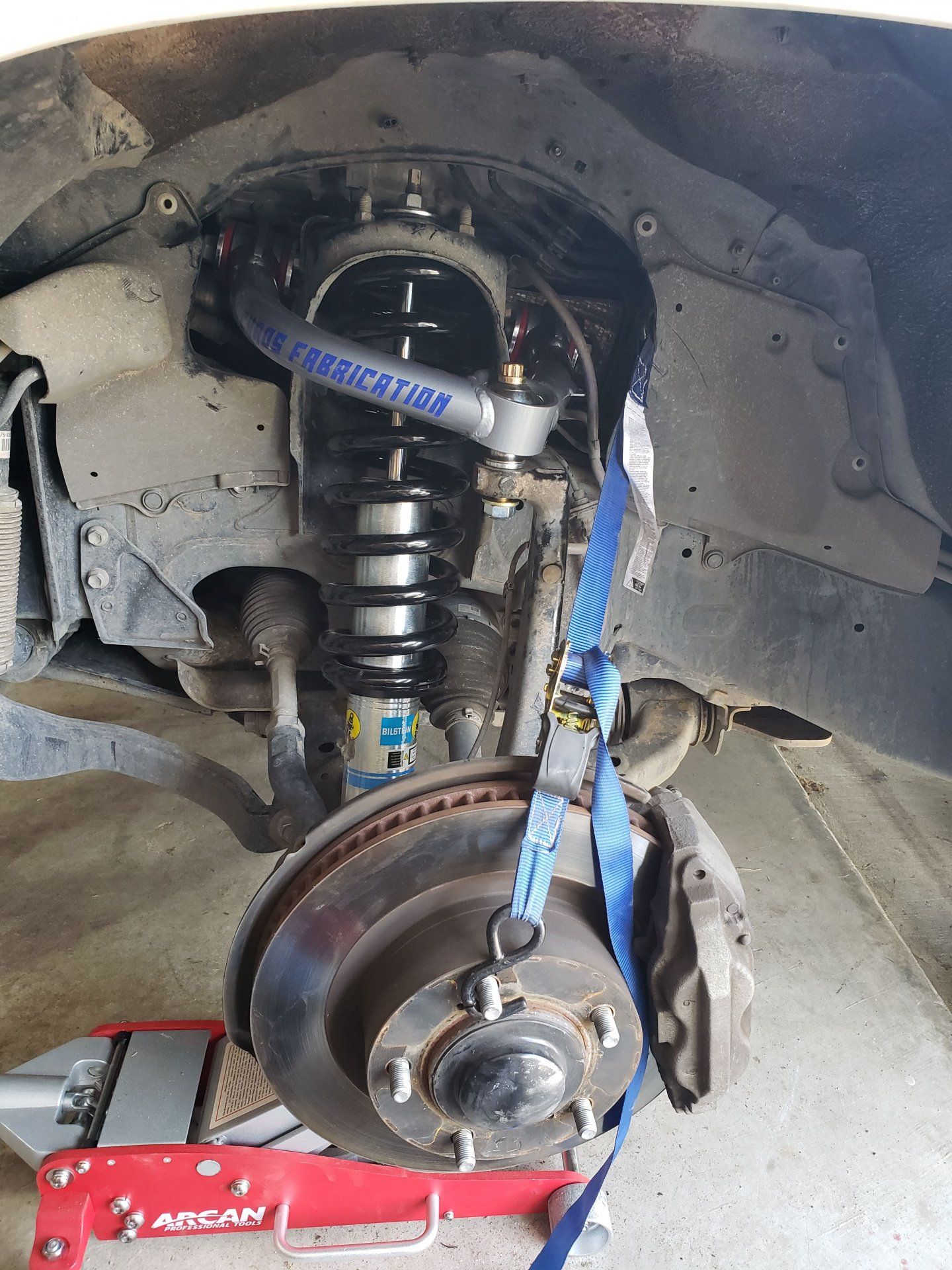

Installed Bilstein 6112/5160 suspension (front and rear) for a 2" lift, along with Total Chaos UCAs.

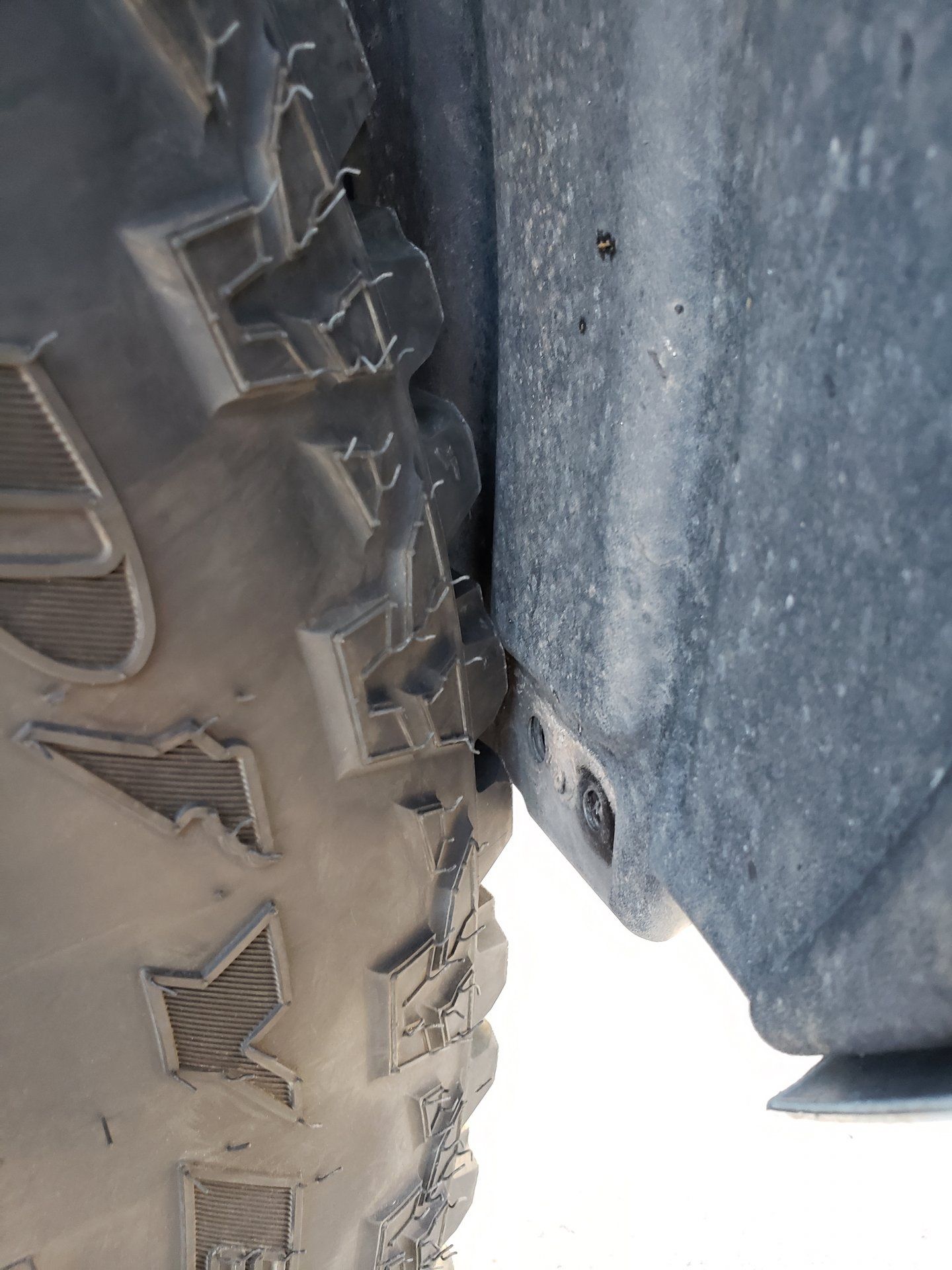

Rubbing is on the front liner. I removed the small plastic piece that hangs down (what is that even for? Is it a scrape indicator that matches the frame height?) Tire now rubs the liner just above that piece, on the ribbed portions of the liner that protrude toward the tire.
I'm going to wait to heat-gun and shape the liner until after I get my alignment done, since that could change how it rubs.

no need for heat gun, just move the whole liner forward (easier than heating) using @TeCKis300’s 35 thread.

Good deal! That's an easy fix with the liner mod. Thanks for sharing.

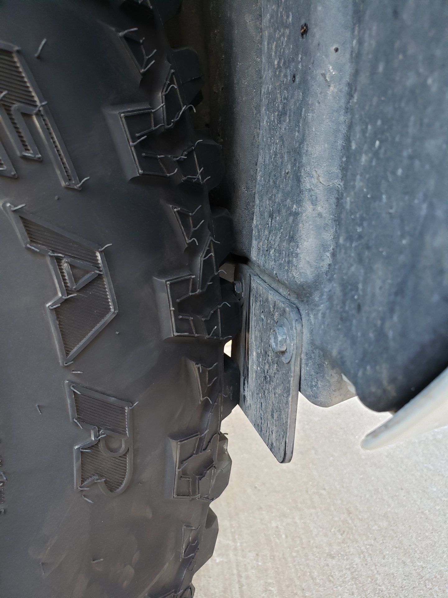

Got the 305/55/20 Falken Wildpeak A/T3's tires mounted today and loving them. Trailing edge was fine as I took off the mudflap for now. But of course, had to do some minor clearancing on the leading edge. Went a different approach than cutting that was easy peasy.
The liner folds under the front bumper like and "L". There 3 screws underneath that secure the bottom part of the L to the bumper. I basically pulled the L forward, taking the whole arched liner with it. Drilled a few new holes to secure it in the forward position adding about .5" of clearance. No cutting or anything, and a 5 minute operation.
Note the 3 bolts that you'll redo in the pic. The trick is all in the bolt circled in red. Drill a new hole forward of the original (that you can see below it), where risen corner is. Then screw the bolt into the new hole, and into the under layered piece that has a white plastic nut. This now locates the whole "L" forward. At the other two bolt holes, drill through the stacked layer at the original external location and secure.
