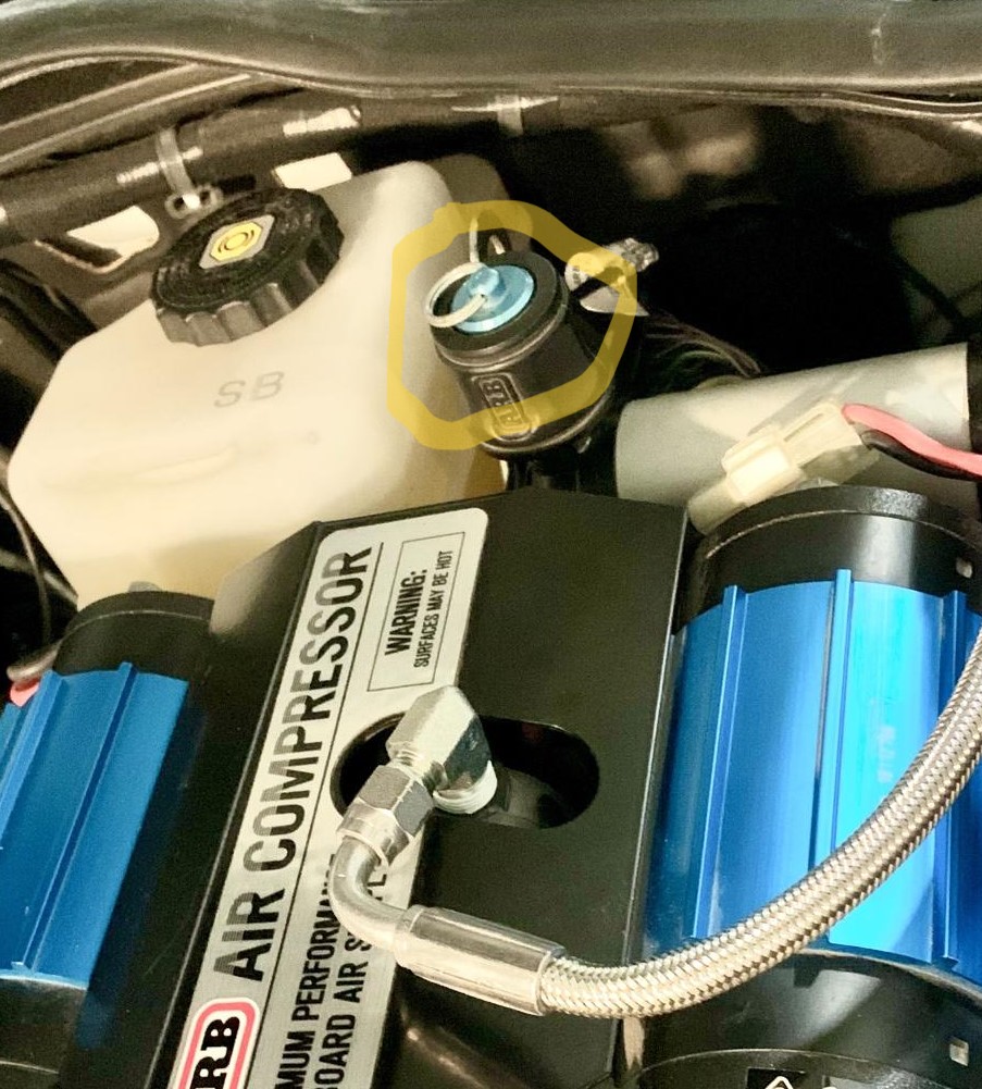

Where would one find the metal insert you have for your compressor? Way better solution than my plastic cap.
