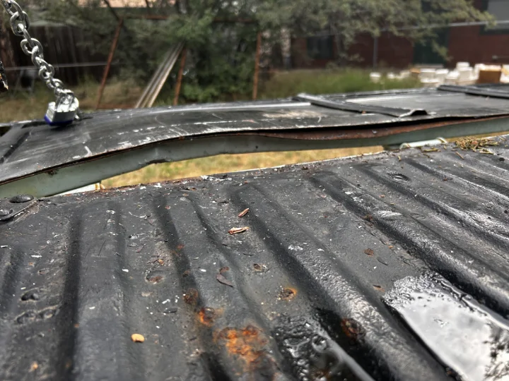

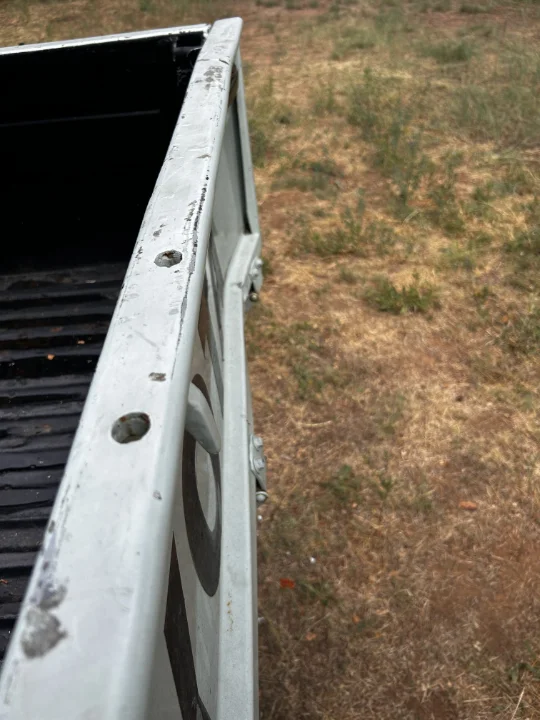

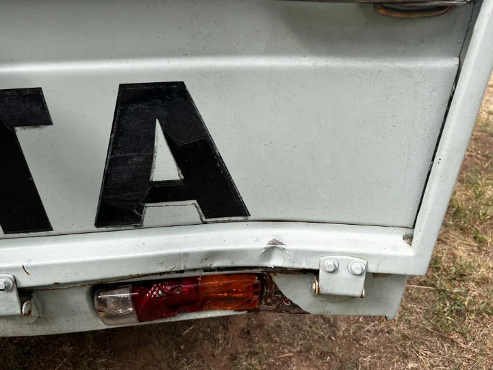

Yesterday I was backing up my HJ45 in the yard, got distracted, and hit a tree! Did a good number to the tailgate.
Any ideas/suggestions on fixing it?
The body below the tailgate I can fix with a heavy hammer, but the tailgate worries me.
You can see the panels separated a bit and there's surface rust inside.
top of the tailgate stayed straight, but the bottom took a good hit.

may i suggest a channel on the outside, heavy wall tube on the inside. nest the exterior profile in the channel n use clamps to draw it flat. i think that would get very close. pounding will just p!$$ you off

I will look into your suggestion. If I can, I may gently separate the skin since it already started, and then restore the tailgate. I'll see which one works.

@Joe45 , i'd say if you can get that skin off completely, the frame could be judiciously seduced back into shape. i've found if you try to sneak up on the original shape the final product is much closer than going viking on it. just don't make the mistake of hammering on a steel table with just a hammer. solid wood backing the piece with hardwood blocking between the panel n hammer. oh, yeah, if you can find a copy of HIGH PERFORMANCE WELDING AND FABRICATING by michel fornier from hp books, do so. it's really assisted me with sheet metal repairs n redneckeneering. good luck man
