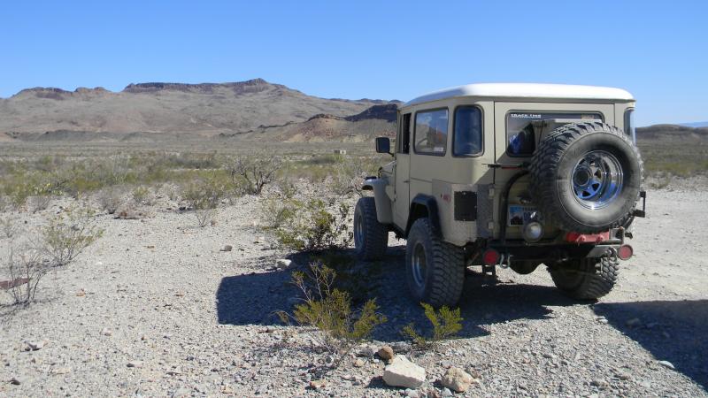

my truck will get an OEM one-piece tailgate which will interfere with the existing tail lights - the current configuration is shown on the pic below
I am looking for suggestions and pics of what others have done
thanks in advance, Claudia
might be doable with a custom bracket :hhmm:
anybody else have ideas ?

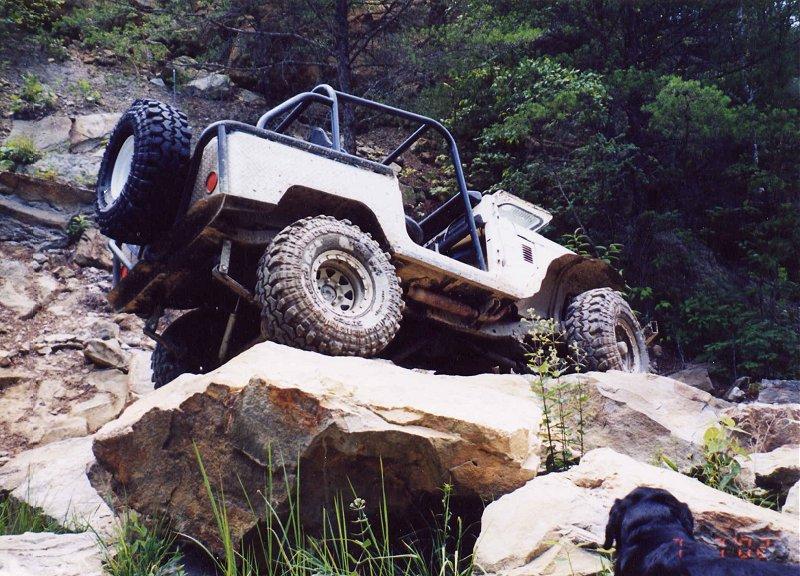

I don't know if this is your cup of tea or not. I did this cause I was tired of replacing lenses & light bulbs when they were in the stk crossmember location. They are not LED's.
I know you said you don't like the ovals.... but there should be other universal options.
On the vehicle I'm building.... I'm using LED ovals just due to ease & accessibility.... but... the same principle could be applied if your rear bumper isn't an air bumper.
I cut the oval holes into my rear bumperettes (that's what I'm calling them... it's really 2' section of 4" round rectangle 1/4" thick tubing on each side)... they stick out about even with the fender so if I go backwards against a tree it won't take out the quarter panel.... but the lights will be recessed inside the bumper for their own protection.
