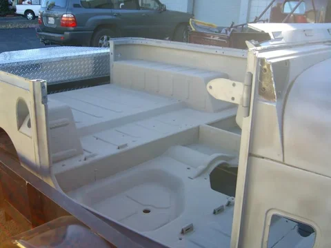

so again whats the color. My 69 is in the paint shop getting its Coranado biege painting. Looks pretty close to yours. Very nice. I hope my turns out as good.
Not sure what the color is. I wish I knew.
Great truck. Colour looks like beige 416! Same as mine!
My armacoat liner sprayed on undercoat & tub
Here is my udercoat and tub. It was sprayed with armacoat. Color was/is coranado beige. Looks like a match. When I get it Painted, I will know. 69 LC undercoat (4).webp
