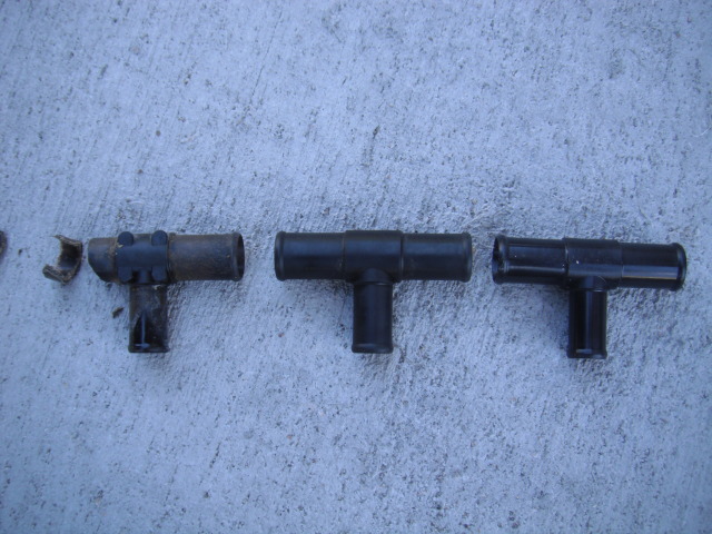

I found this to be interesting.
The tee fitting shown above in my hands was totally disintegrated. When I replaced it, I went ahead and replaced the one next to it. That one was just fine. Strangely in much better shape. I'm keeping it for a spare.
Here's a picture of the three both old ones and one new one. You can't hardly tell between two of them.

If one is the input and the other the output to the heater core, that would explain the temperature difference.
