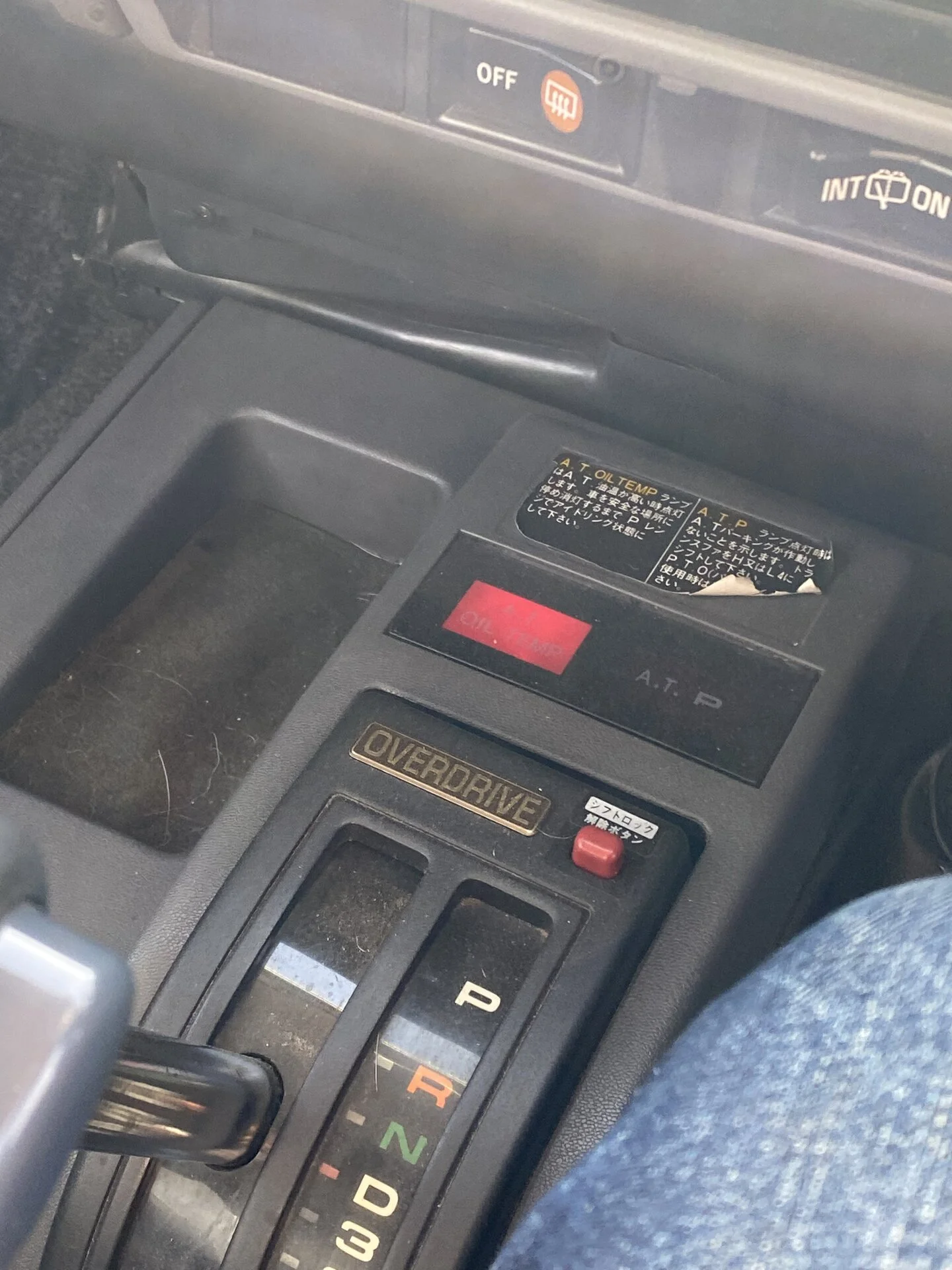

T-Belt, Alternator, Fuel Filter, A/T Transmission lights came on, whats the issue?
May 22, 2020
24
119
Ventura, California
Website
ardnez.com
I had reset the T-Belt light before doing the timing belt and once i buttoned everything up after driving for about 5 miles, all these lights appeared, hit the reset button for the T-Belt once again and shut off car and lights went away, drove another 2 miles and lights havent appeared but what was the issue?

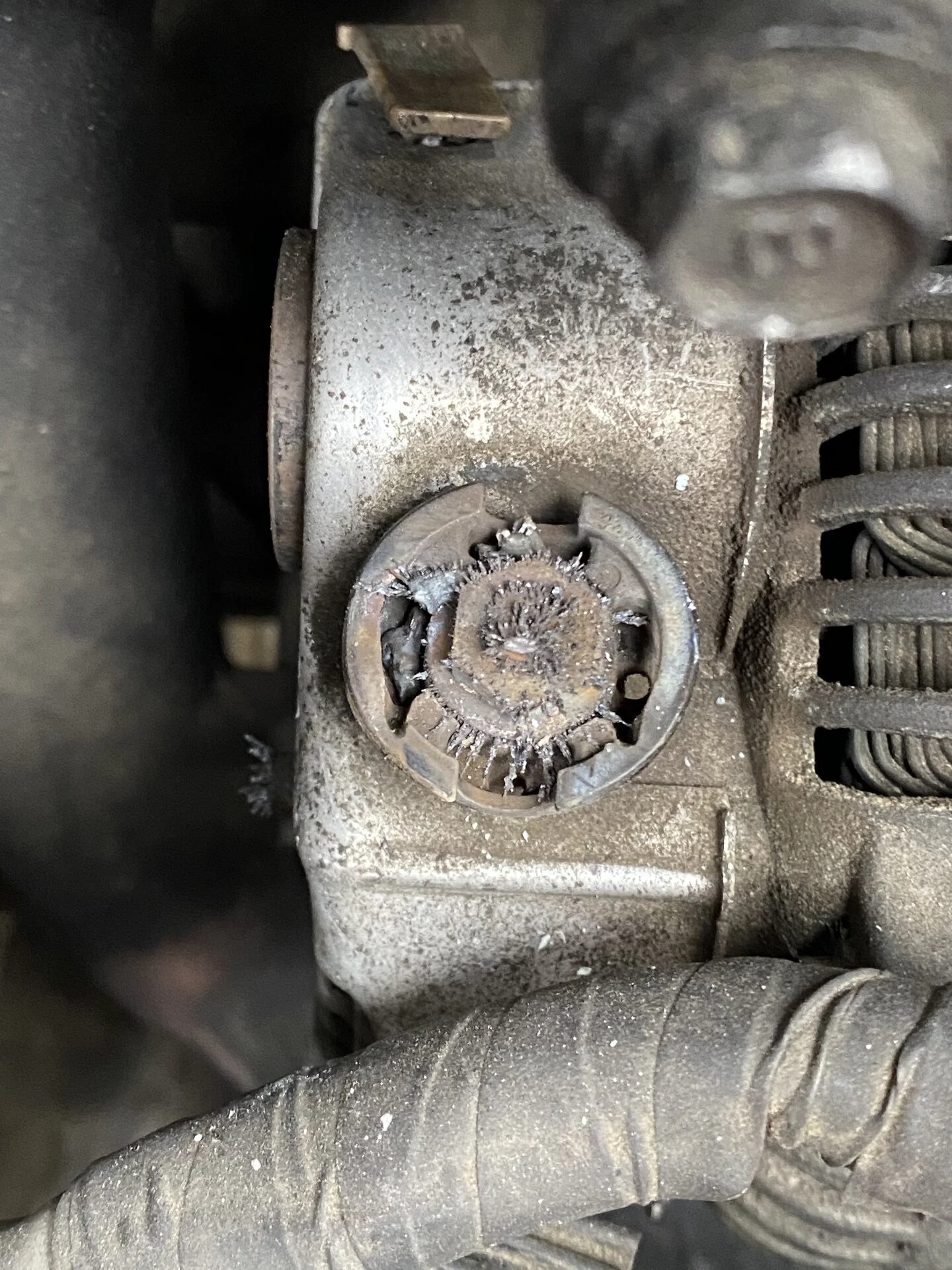

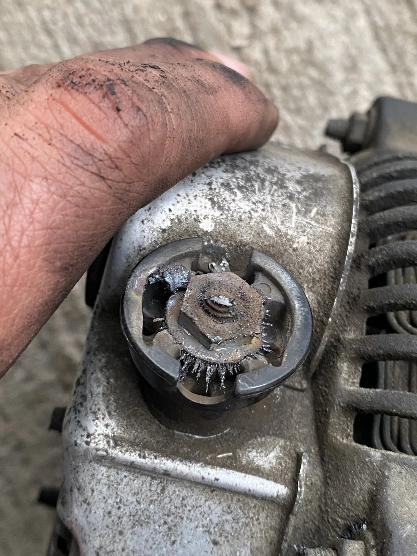

So y’all were right, alternator failed. Found this while removing it. What could have cause it to fry from the connection this way? Bad regulator? Dont want to install the new one and have this happen to it as well
