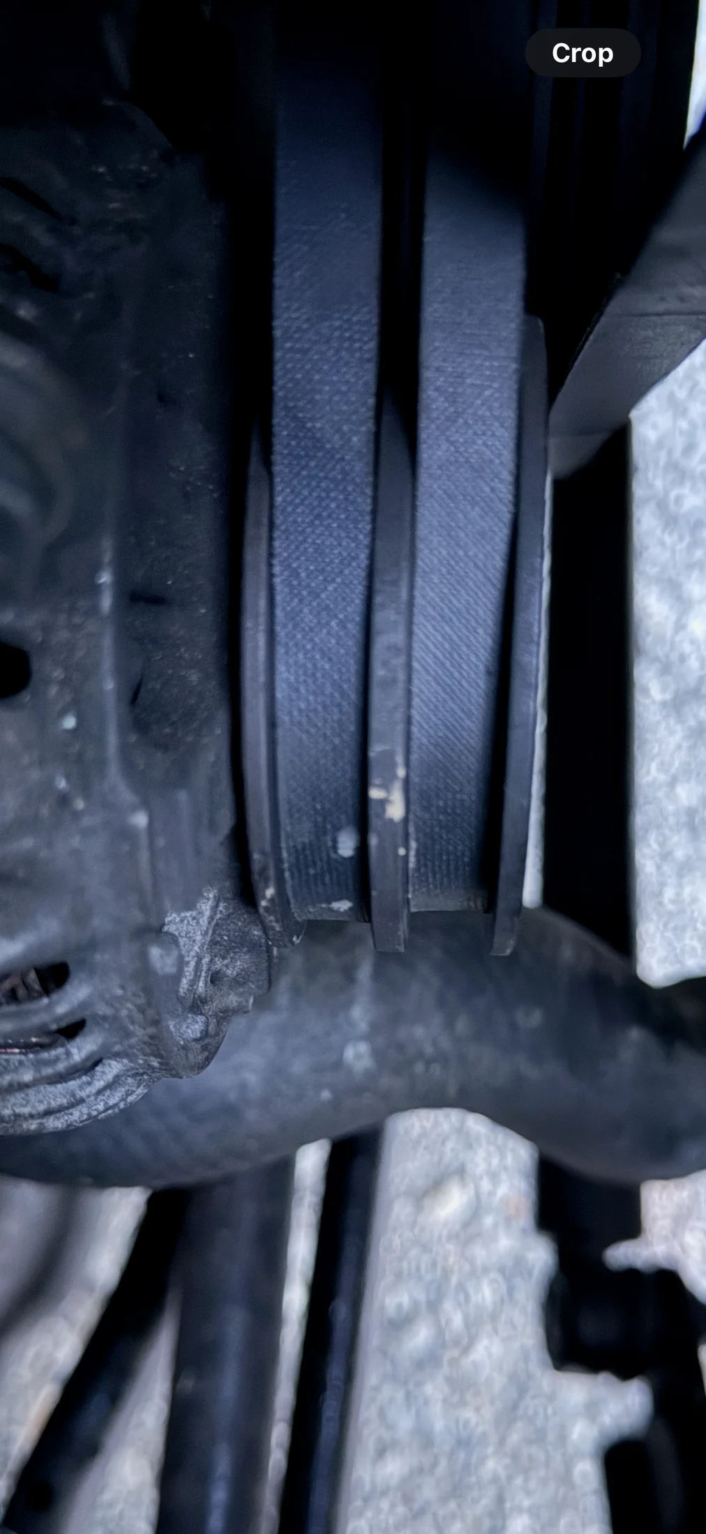

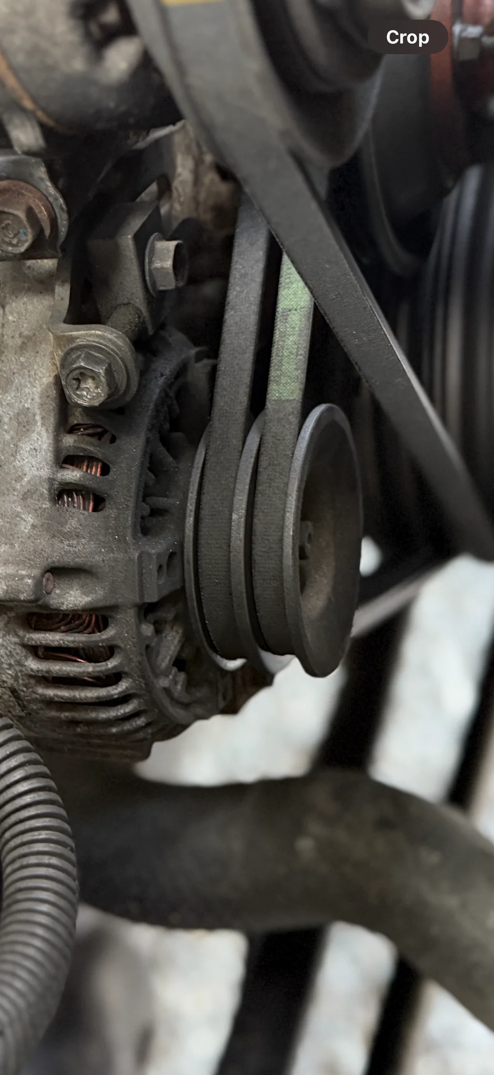

Hey gang,
I'm a new owner of 78 series troopy from 2011 with a 1HZ engine.
to have peace of mind, im doing the replacemnet of most of the components that have wear and tear and no service history from the previous owner.
I'm stationed in europe and have been recently replacing the drive belts (alternator and fan). Locally i got 10mm wide belts, and that is also what it was on previously. In EU these vehicles are unusuall and i expect most of suppliers are not most knowledgable.
However, when i took the old ones off, i saw a lot of wear on the teeth of the old ones. Which made me think if they are too narrow.
Looking online, I saw some with an 11mm width, probably could fit 12mm as well. In the the pics old and new ones.
Can anyone advise on what you are using or OEM size?
in case anyone finds this thread and has the same problem, I have found the solution.
For some reason there was a lot of wear on the alternator pulley, specially the outside groove.
Its a bit of work to get the alternator out and an impact gun is nice to have, but generally not too difficult of a job.
Here the pictures of the old and new pulley and how the belts sit on the new one:
