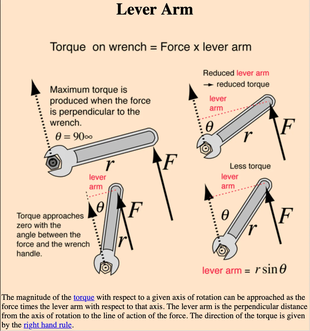

@Somebodyelse5 Do you disagree with this?
Don't make me break out my machine design book and work this out. Your image is correct, but you aren't considering the system level mechanics. Also, if we were talking super stiff street racing torsion bars, it'd be a different story. Our bars are designed to allow for some articulation.
The torsion bar doesn't care what it's starting orientation is, (flat with extended links, slightly inclined with factory links) it cares about the relative deflection side to side (how it counters body roll). Longer links, shorter links, makes no difference in the torsion bars behavior. Load in ~ load out. When they are doing their job, the link is not often perpendicular to the arm, so the loading on the link itself is higher (see your image)... but so is the load put on the other link.
Another thing to note, the typical lifts folks are installing don't drastically increase the full droop of the rear axle, so the maximum displacement (full bump one side, full droop other side) isn't going to be much different than factory limits (what it the torsion bar was designed to see). And even so, the links themselves aren't going to change this.
But for discussions sake... What are you claiming to improve with the longer links? are you arguing that the lower deflection on flat ground will make bushings last longer? That I'd agree with but :meh:
The reported gains of running the extended links are arguablly marginal at best, which supports my claim of marginal difference.
The reported gains of running the extended links are arguably marginal at best, which supports my claim of marginal difference.
Wrong. The math is still relevant. The relationship of vertical displacement of the arms for a given amount of suspension 'flex' is linear. The degrees of twist on the sway bar for a given amount of vertical displacement is a function of the initial position of the sway bar, which can be altered with link length.
Exactly. When the arms are perpendicular, the cross spring rate is lower than when they are not perpendicular. Bluntly, the sway bar spring rate is lowest when the arms are perpendicular to the suspension travel arc
