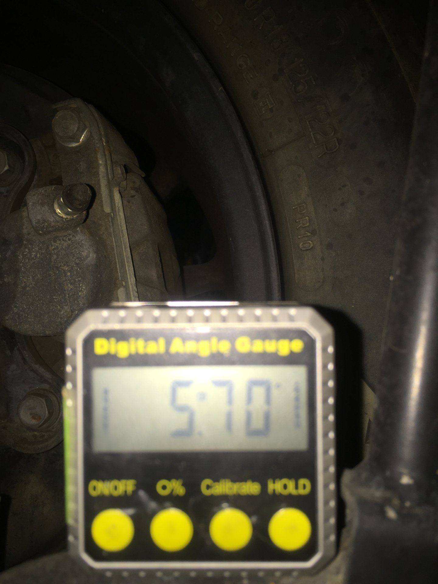

I need to think on this a bit. Are you saying that with a torsion bar starting perpendicular, you'll get more angular displacement in the bar for any given vertical displacement of the end link? More displacement = more load. I can concede there.
Now, in application, are we approaching that regime where we are losing enough angular deflection for any given vertical displacement, that it will make a difference? I'm still going to say no. I just put an angle finder on my rear arm, can someone with extended rear links, and someone with factory links and no lift, provide something similar? I'd like to see what the delta's look like.
Note, my rig has OME heavies, Slee rear bumper, and factory end links. Sitting level in my sideyard:
I realize this number is not a perfect measurement, it isn't perfectly in line with the pivot of the end link or the bushing centerline on the bar... but seeing the difference when measured similarly on other rigs, we can use it to see how much angular change the extend arms induce.
I have extended links on both ends, 2” lift with Ironman TOY13B springs (0-200kg). Not sure how this compares to OME spring- maybe medium.
