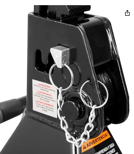

Regarding jack stands, after the Harbor Freight recall of all of their jack stands a couple of years ago I replaced all my jack stands with the kind that have a secondary bar for securing them at height. Like this:
The picture is from the Torin 6 Ton stands, which I use and like. I won't get under a car without that double security now. I think it's worth it, I own two sets of stands with that feature. YMMV, just my two cents. We weekend wrenchers gotta be careful.

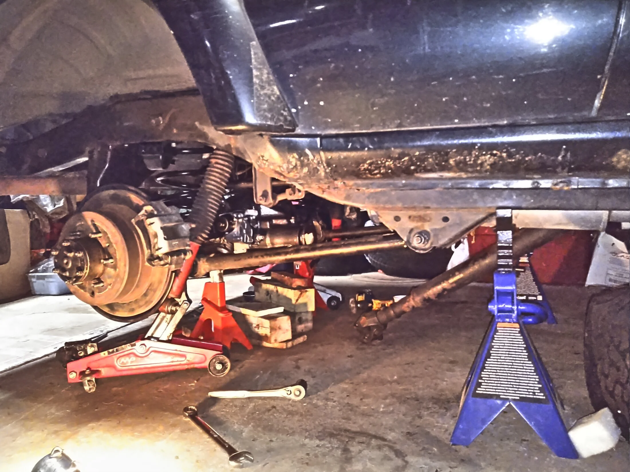

I have some old Walker jack stands but they were not tall enough so I added some cribbing underneath and set them to a lower level. The back wheels were chocked up tight (front and back side).
I didn't really spend any time fully underneath with this setup. It worked but I'm sure there's a better way.

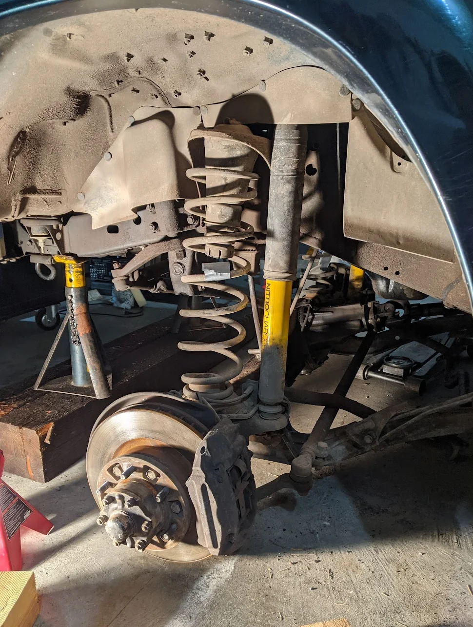

You would be amazed at the size of some of the things I've seen cribbed up on wood blocks in the industrial construction world. I wouldn't be scared of that setup at all. If you don't hear wood splintering as the load comes down on the block, it's fine. Seriously.
