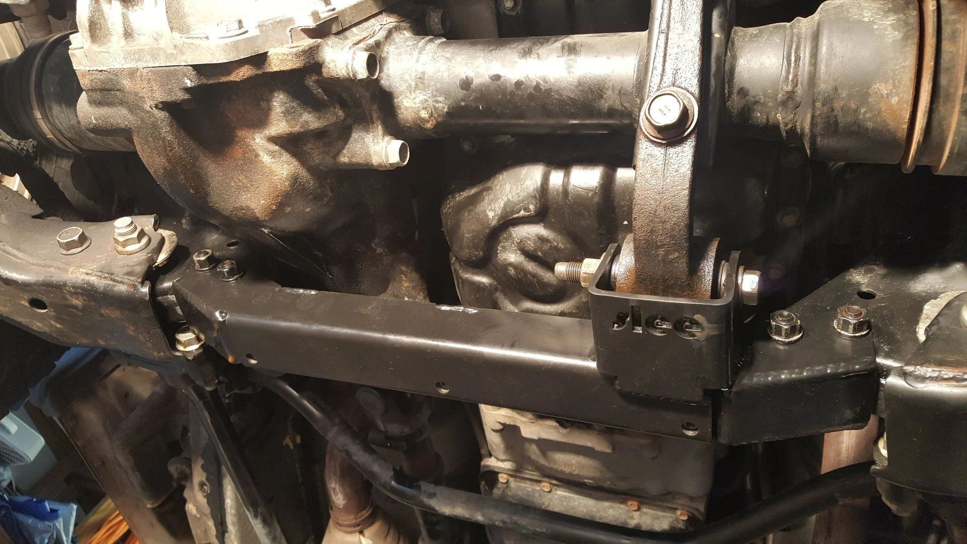

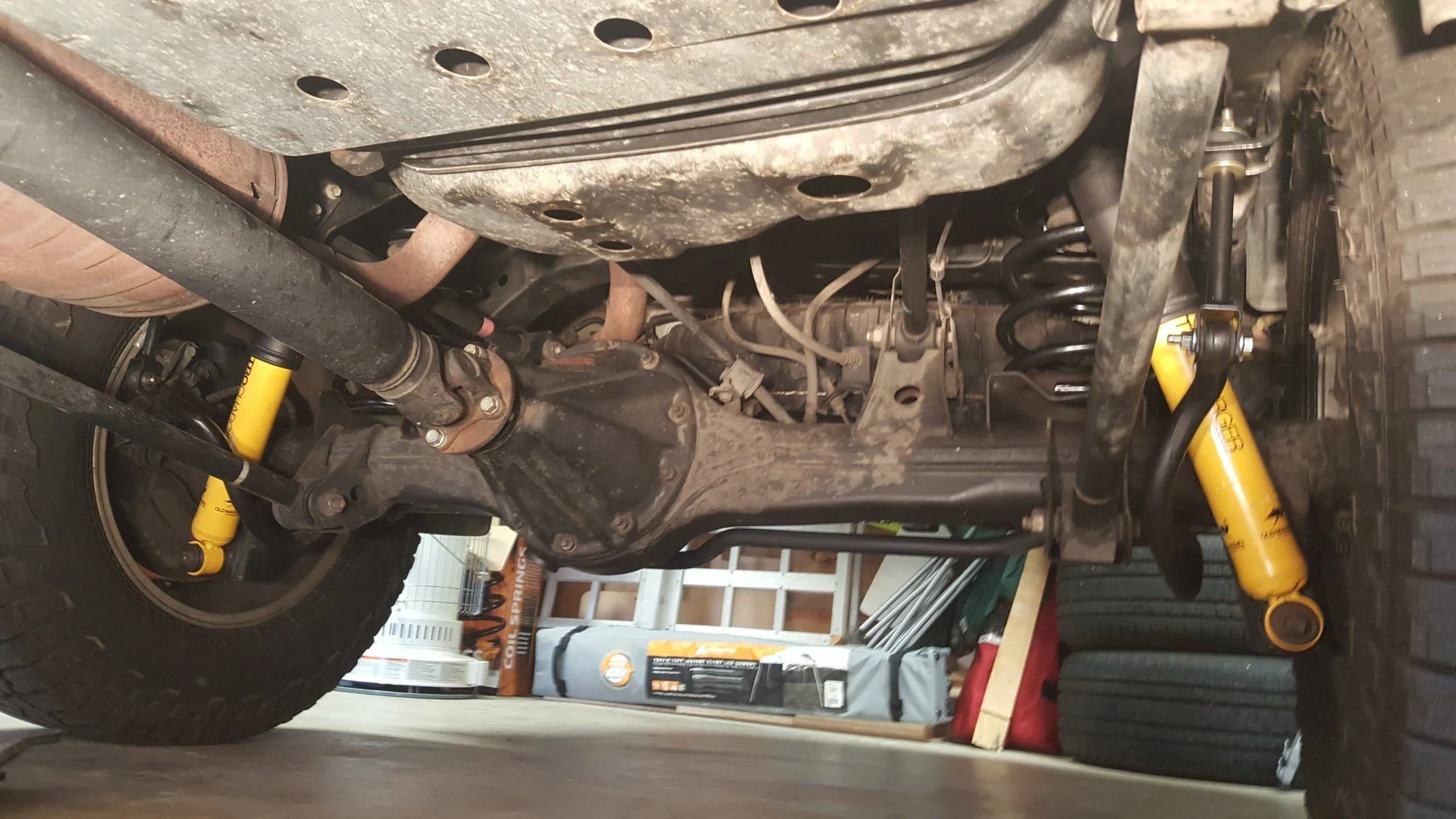

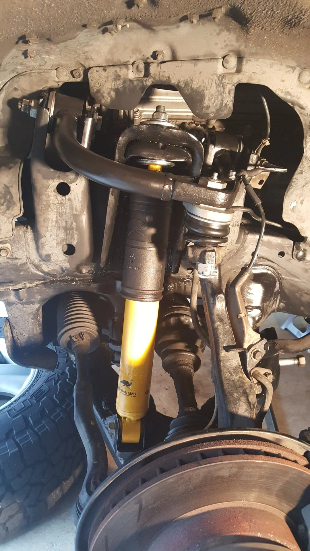

    Hey guys, thanks for all the help. Everything went great. Rear passenger shock top nut was the worst to get off and on, so little clearance and tough to initially break loose. I had one sway bar link bolt that was seized and needed replacing after I beat the crap out of it. I dropped a UCA metal bushing down in the frame more than once, lucky to get them out! Overall, all of this was as easy as everyone said and I am sure now that I have done it once I could do it again in half the time. I took video of everything too so keep an eye out for that if your interested.
    Thanks again!
    [​IMG]
    [​IMG]
    [​IMG]

    [/ATTACH] Let's try the pics again
