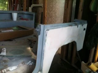

Have a little predicament. The painter and body man who was doing the work on my tub sides has not touched my truck in two months and stopped returning my calls.
While applying a skim filler coat and block sanding there were parts of the toprail and sides that were sanded back to bare metal. Now of course this has flash rusted due to out texas humidity.
Rust removal:
Do i sand with a DA and clean and prime?
Or should i use a chemical.
Priming:
I will have bare metal areas next to areas with evercoat rage. Once the metal has had the flash rust removed, can I spray 2k epoxy over everything and call it a day (move on to building primer and sanding for final paint). Do i need a different type of etching primer? I have heard not to spray etching primer over filler. Is this correct?
Thanks for your advice.
Here is the current state of the truck unfortunately. It was always supposed to be primed the same day that this body work was done, but it is what it is.
