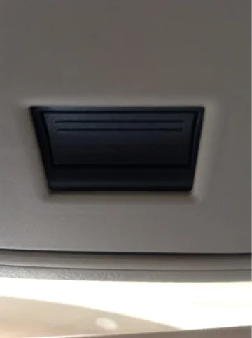

. On my 2000 LC it was just a spot to pull down and mount your normal garage door opener. In my 2004 LX it was the Sunglasses case and it sucks. Only deep enough for small glasses or aviators (good thing they are back in style). Anyway I just went in and put my garage door opener in there after removing the plug.
It had never been used before today

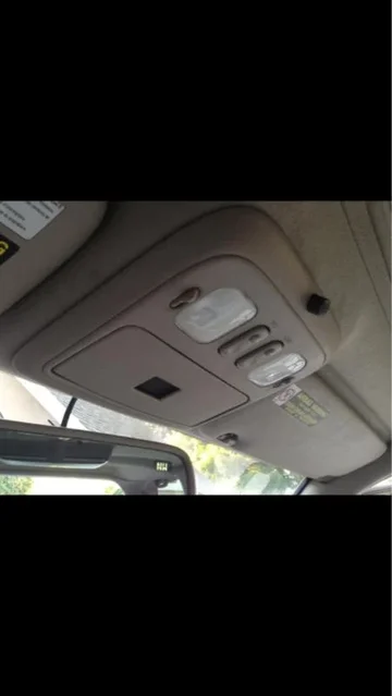

Unless you wanted a fancy trim kit, I don't think you necessarily need to custom fab anything to make this work. Just take the door off (requires pulling the larger assembly, then unscrewing the pocket from back side, then unscrew two hinge pins). Once you remove the door you can screw the pocket back on, and you've got a big hole you can fill with whatever.
I am considering putting my ScangaugeII up there, just need to get some more CAT5 for an extension cable. Here's a pic of the hole, and what it would look like if you put a Yaesu faceplate up there (FT-8800). to do this, all you'd need to do is screw your faceplate mount to that pocket, and there's plenty of room behind it for some screws to stick out.

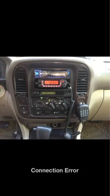

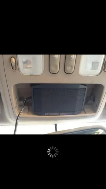

I put my ham under the stereo head unit and the external speaker in the garage remote pocket. Super easy to manage the radio controls.

What are you using the black knob for?

Spresso that "knob" is my Bluetooth microphone. Check my build thread for details on mounting the dual radios. Super simple. Used the stock dual din mounting brackets. Only had to drill two holes.
