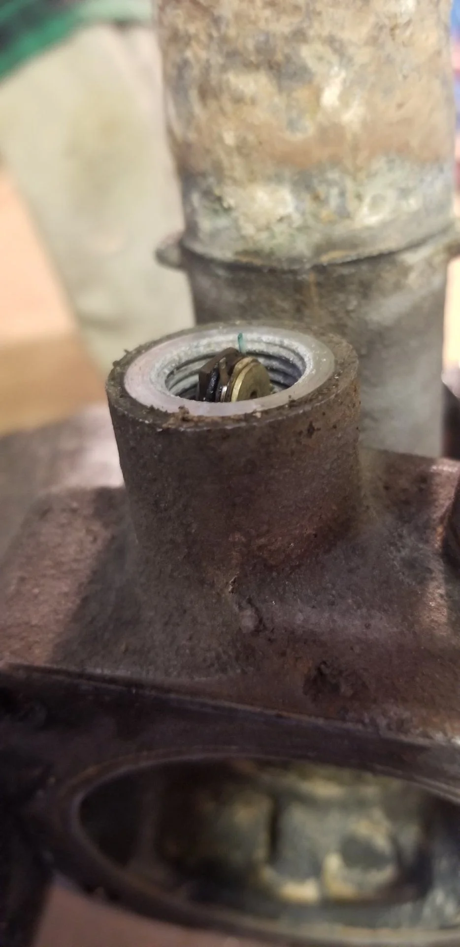

I was pulling all the sensors from my thermostat housing and the last one broke.
I believe the part is called a cold start timer switch or something, #182-66. How am I going to remove this sucker, or would it be more feasible to source a new housing? Also does anyone know if the part is still available? Thanks so much, I love this forum

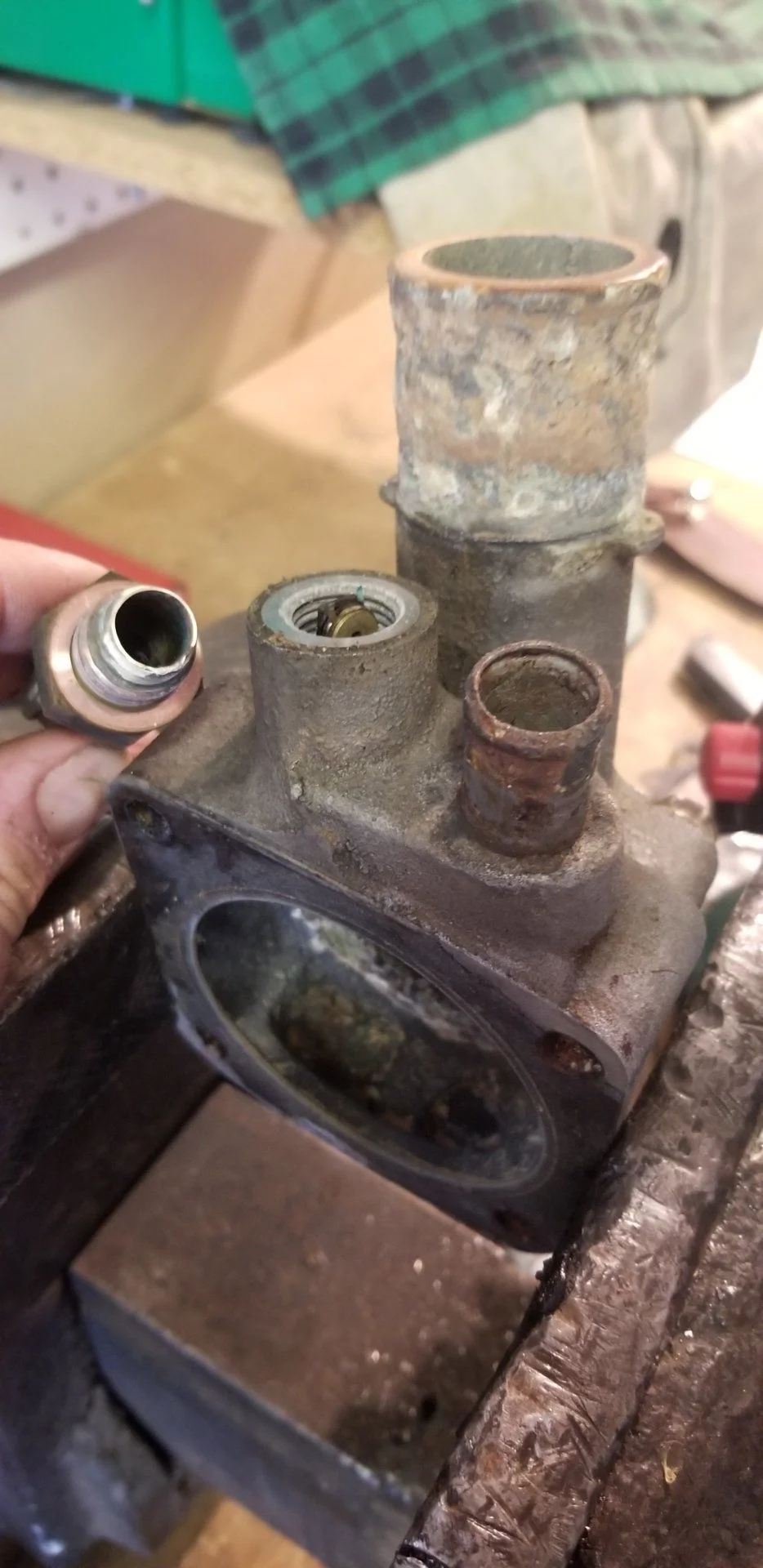

I kind of doubt it, here is the view from the bottom (inside the housing)
Well, it only goes in from the outside, so that's how it should come out.
I would agree lol, the only question now is how do I get it out? All I can think of is trying to carefully drill it out but I feel like there is probably a better method. There are so many types of extractors on the market I have no idea what type/style I would use for this application....
Looks like some form of scaling inside the housing that may have grabbed onto the sensor.
Use a pick around the sensor to remove some scale, then bang it out somehow.
Looks like all of the threaded housing came out. Just drive it out from the inside.
Some weak acid... like vinegar or off the shelf radiator flush might weaken up the grip of the corrosion on the remaining stub. don't use anything strong like muiatic. It will damage the aluminum
I can't believe I didn't realize this. For some reason I thought there was still threads inside the housing..... I just moved the housing from a penetrating fluid soak to some weak hydrochloric acid to soak for the night. Hopefully I can drive it out with a punch tomorrow.

I'd be inclined to throw it in the oven for an hour @ 400° F and see if the expansion would break the bond. That scaling and galvanic corrosion 'bond' can be difficult to remove. IF you can source a new/replacement sensor BEFORE proceeding, then looking at it might give you some idea if you are still dealing with a threaded portion or not.
With the amount of corrosion on the housing, just replace it.

I'd rip the electrical remains out, put a torch to the housing, then run a drill in there. The sensor housing is brass, easy to drill. The heat with luck would break the bond between the two, and in the process of drilling the remains would spin out of the housing. If not, you are going to have to drill it anyway.
IDEA ONLY- based on welding to broken bolts to remove- which Ive done a LOT. Braze a bole to the bottom of the brass cylinder- maybe with the heat having been applied can screw it out. IDK if threads are NPT tapered wont go further in.
This. Heat and a drill. Your main concern is damaging the threads on the housing. The sensor material should be much softer than the housing and a drill bit will make quick work of it.
