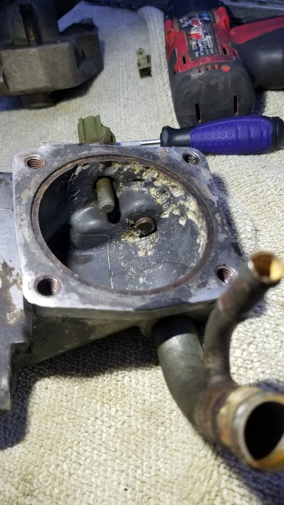

Suggestions please, removing busted sensor

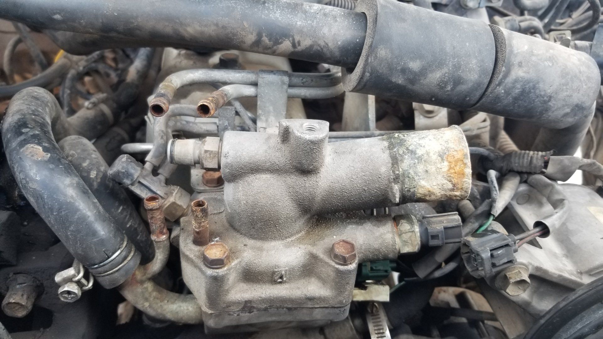

Didn't notice it was a 3FE housing at first. :rolleyes:
Ya, discontinued. I would get a second hand one, that one is really corroded.
Cheers
Thanks for all the suggestions. It has been a successful friday afternoon. I kept pulling the housing out of my acidic concoction every 4 or 5 hours and used some picks to keep scraping all the scale out from around the sensor. Then I would get it nice and hot with the torch and back into the soak to quench. I finally decided to try and knock it out with a punch this afternoon, and it popped right out with one smack and some heat.:bounce::bounce::cool:

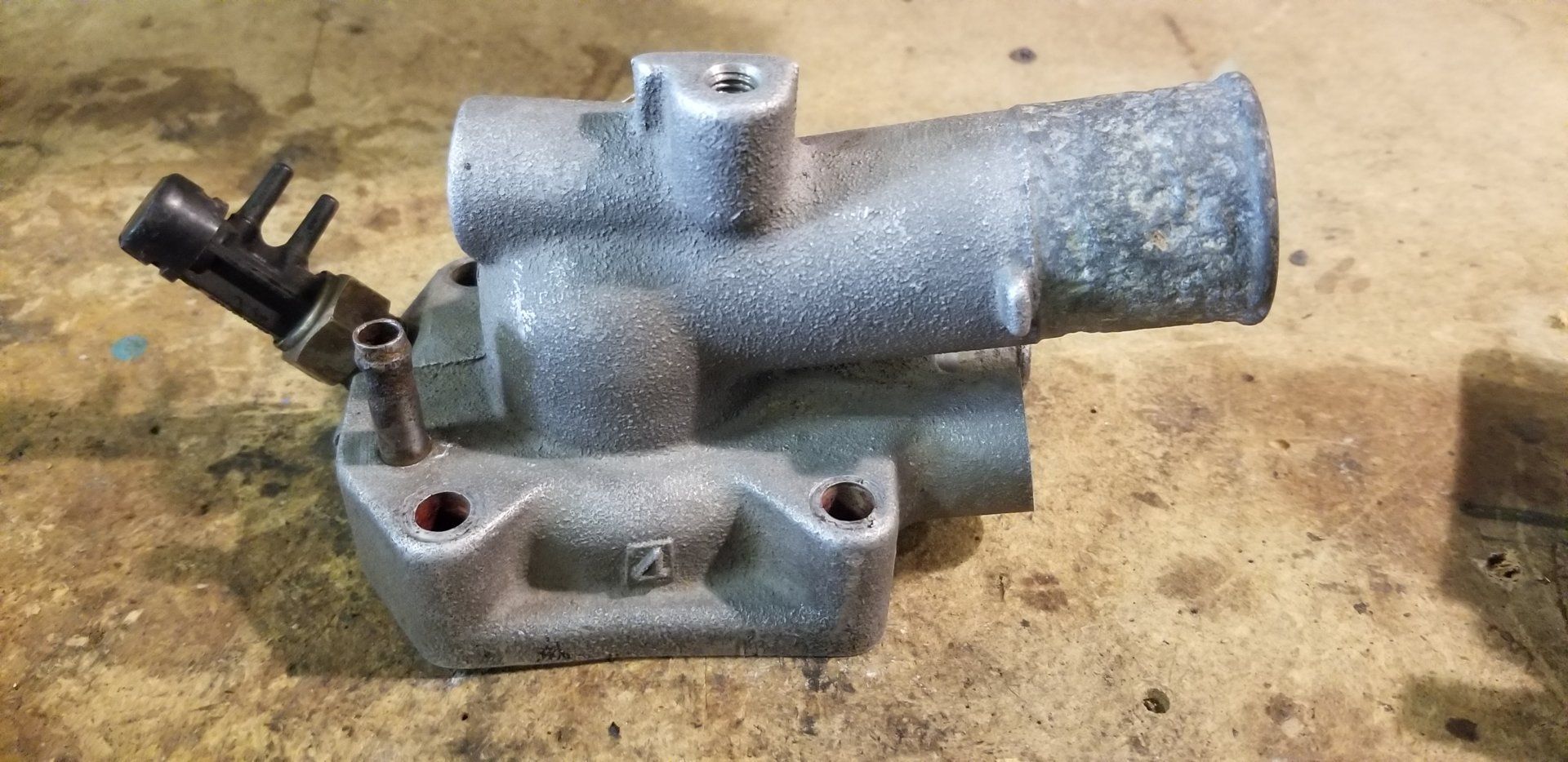

I know this housing is really corroded but it seemed to work fine and it did not leak before I removed it so I am going to re use it. I think it cleaned up pretty well, here is a before and after.

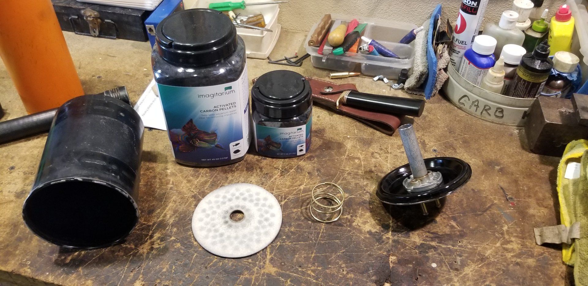

And then I decided to tackle the charcoal canister while I was "in there" I have been meaning to try this for a couple years now lol. I hope this solves the spewing gas from the filler tube at 10,000 ft elevation. It was really easy and worth doing. Before and after.
Reading about rebuilding the canister I saw a few concerns about explosions or fires but no one seemed to have an issue, so I just used a grinder to expose the seam and opened it like a paint can. It was quite easy and saved me some money. Athough out of curiosity I decided to do a flamibility test on the old charcoal.
It went up in flames so quick and easy. It was raining when I lit a tiny little pile and it burned for a good 15 or 20 minutes. o_O If I were going to do this again I would definitely refrain from the grinder and stick to a file or hacksaw or use the grinder outside. I dont think there is an explosion risk but definitely a fire risk to be aware of.
