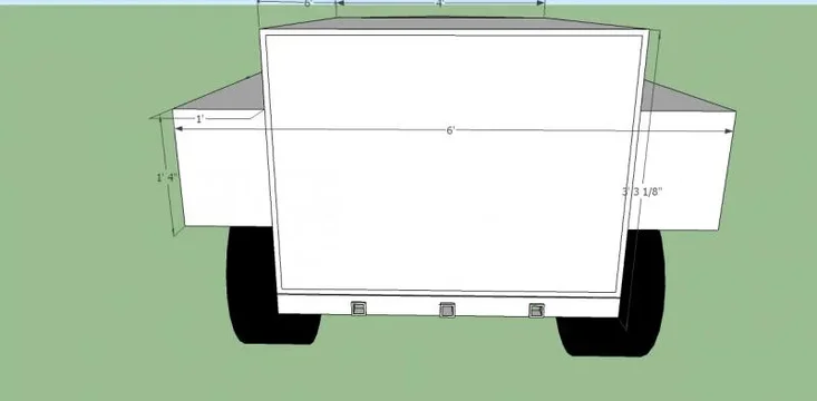

Here is what I have come up with so far...I have the Google Sketchup file if you want it.
The tongue of the trailer will be much longer than in the image. My idea is to have a long piece of receiver tube build into the frame that allows for an adjustable tongue.

looks like a good start , what about water?, a storage tank down low next to the axel? be nice to have a lilttle shower an sink. i have access to a large press brake . we could make a cool water tank:grinpimp:

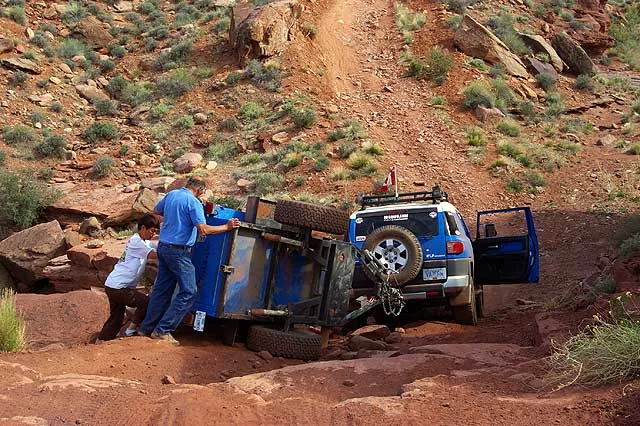

No it wont go down the Rubicon but after a 5 day trip with one of the "Off-Road" trailers I would not want to take one of them down either.
WOW, if i owned that trailer i would have wheels on top an bottom:hillbilly:
the funniest was that it was in two consecutive years - just about a mile apart :hillbilly:
it looks to me that all the weight is above the axel making it top heavy . need to put some wieght down low?
Regarding Adventure trailer--
I don't like the suspension of the AT. The angle of the shocks offer little, if any, dampening. That's why you see so many on their tops. When the air bag spring rebounds after compression, the lack of a controlled rebound creates a bouncing ball effect that puts the trailer on it's top. This is a scientific observation reported by Tools who followed one on the trail for two days. Speak up if I am misquoting you Kevin.
