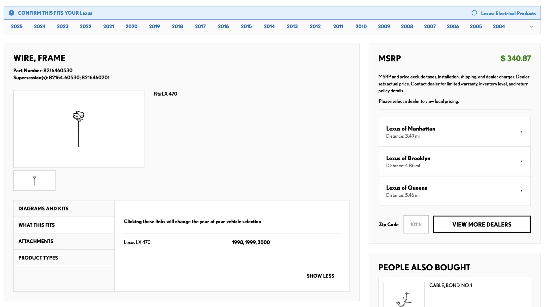

I then looked up the part from Lexus directly, and it seems like the part has been superseded by 82164-60530, which I might be able to order from a Toyota/Lexus dealer for around $340.

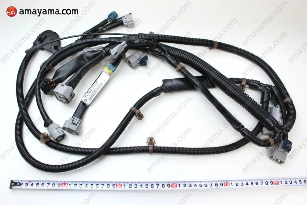

Some good pictures on Amayama - seems like this is exactly what I need? Toyota 82164-60530 (8216460530) WIRE - https://www.amayama.com/en/part/toyota/8216460530

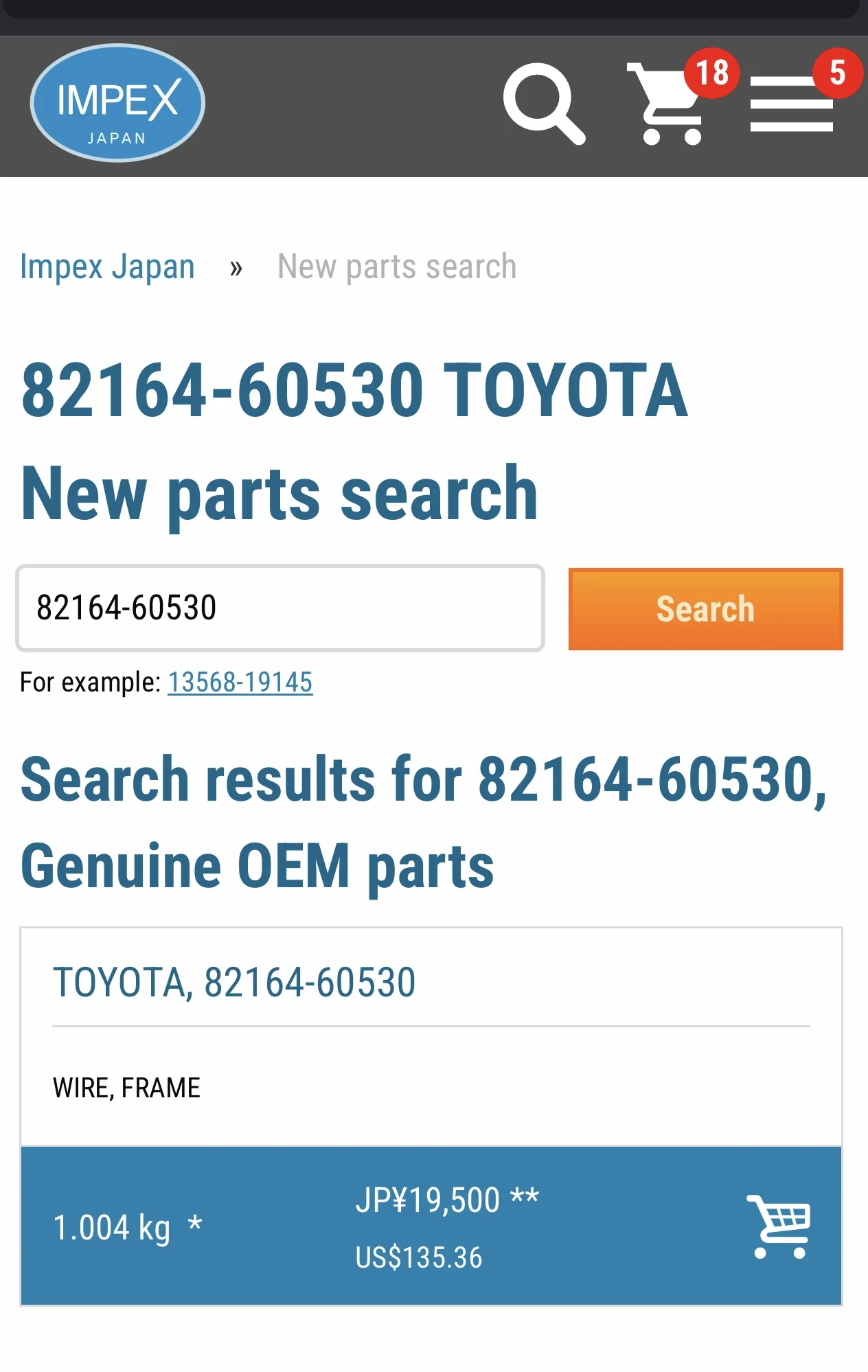

Impex doesn't have the part, so I think my best bet is to place an order with Amayama, gonna make a few more calls first though.

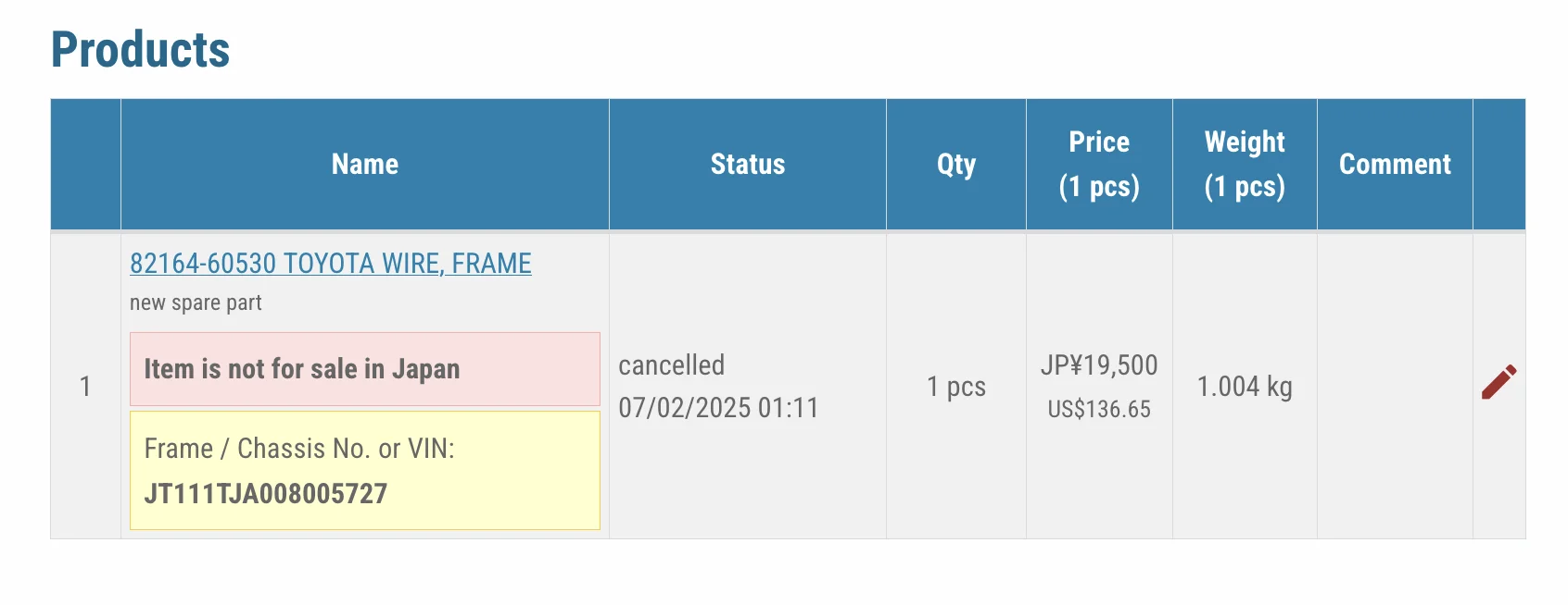

Amayama also canceled but gave me a more specific message. Just curious, any idea why they want a Japanese road registration cerificate for this specific part?
Guess my options now are to either figure out how to fabricate a harness myself or see if Cruiser Outfitters can still source it.

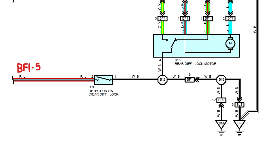

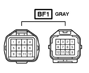

It doesn't help that the EWD has a typo and doesn't show BF1 on the connector locations, but shows BF2 twice. The next page lists them together in the same location.
It's just adding the difflock motor and detection switch. So 6 wires in total, BF1 pins 1-6. Wheel speed sensors (used for ABS) aren't touched.
Note that this picture is looking from the pin/socket side, not the wire side of the connector.
I think you need these terminals: Yazaki 7116-4026. They should be female 2.3II terminals, previously known as 090 (II).
