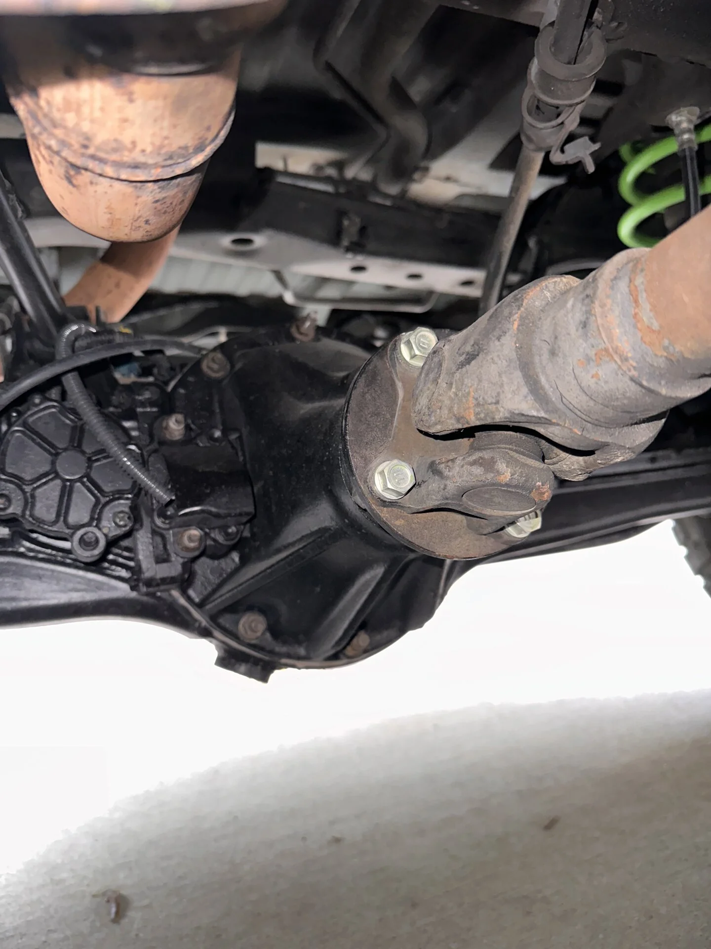

Went out and took a look at mine I have both since I did the swap. I’ll post pics, sorry they’re not that great. Looks like the stud locations are actually the same you’ll just need the longer ones for the actuator side. If you’re talking about the axle shaft differences I’m not sure on that. I know when looking up part numbers on partsouq it lists two different numbers for shafts on the short side, one being for a differential locker and the other for a standard axle. If I remember correctly the difference is the length of splines on the shaft.
