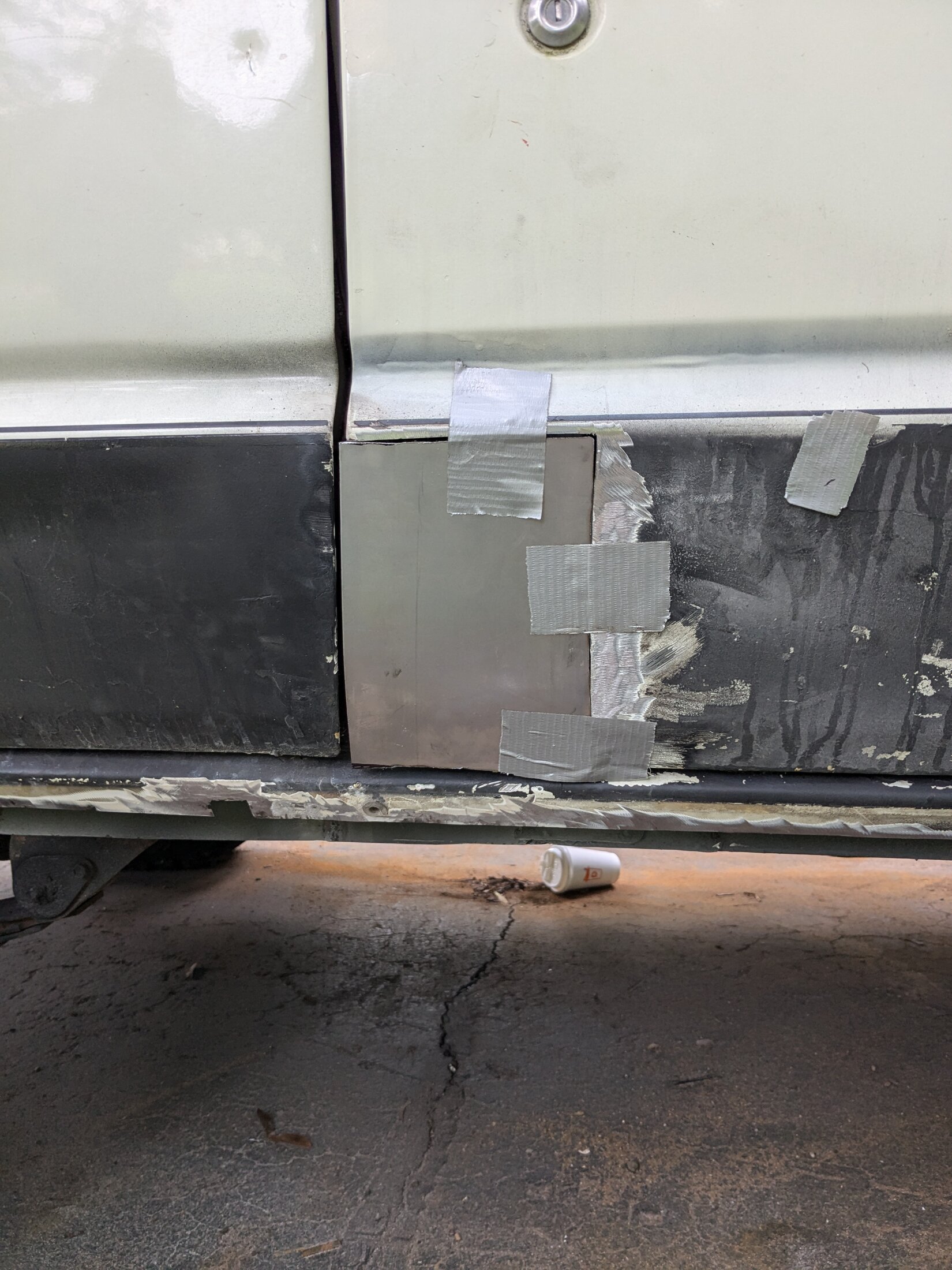

4. What is this thing hanging in picture 3? Could it be the odo cable? It's currently not working need a replacement cable.
5. Is Speedo ran by a mechanical cable as well? It isn't working either.

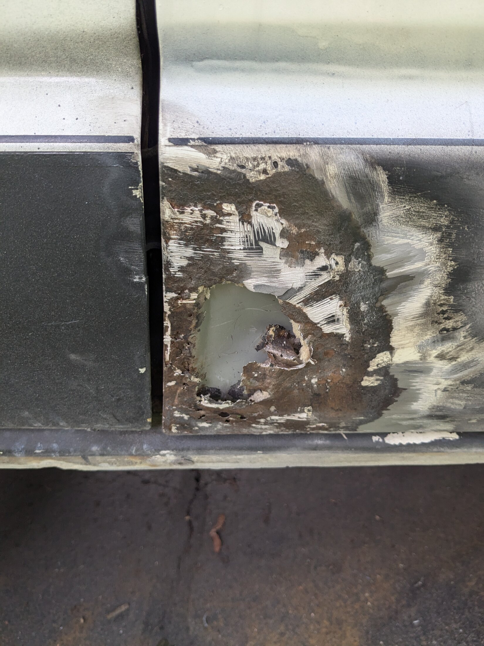

Is the rust (see picture 3) on a rocker panel? Is that correct?
It's the panel right below the doors
Trying to get a replacement to weld in.
Yes, that is the rocker panel.
For the external portion of the rocker, Wolf Steel makes pretty darn good panels. They are located in Quebec. I used them. Shipping wasn't too bad.
I believe that CruiserCorps makes them too.

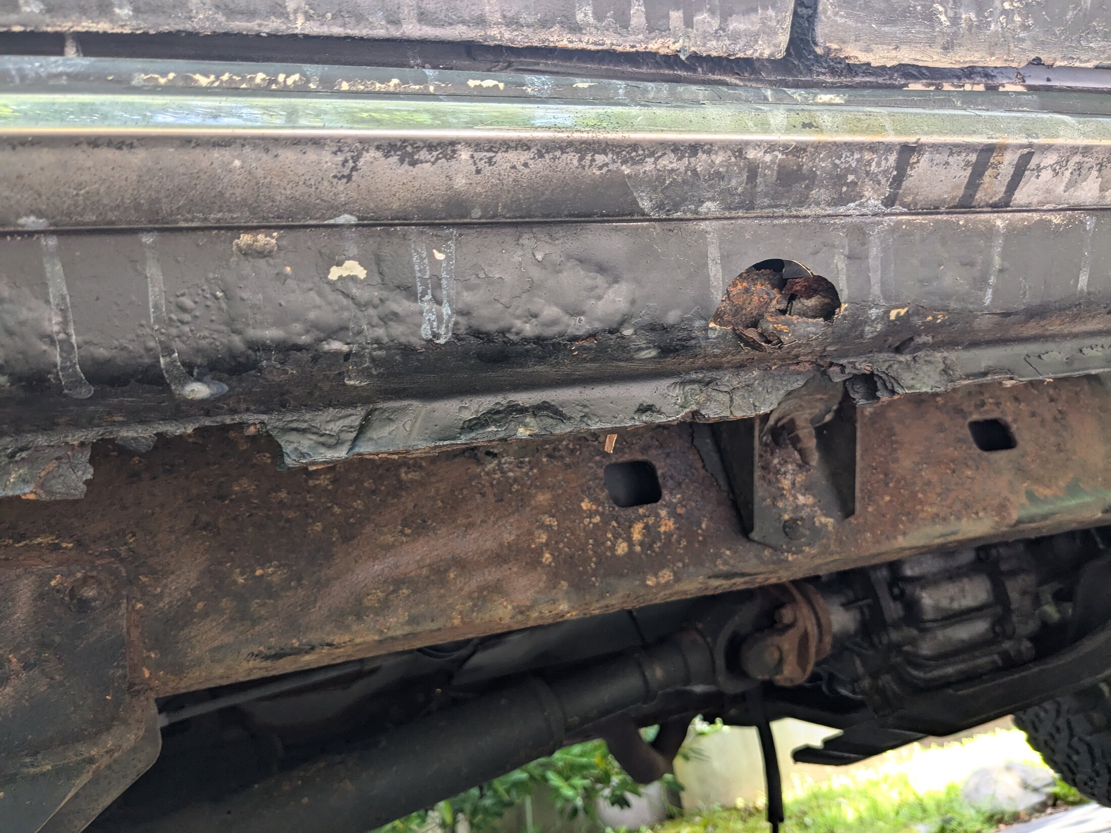

I got new exhaust hangars, and new hardware. Cut off the rotted parts of the inner and outer rockers. Will be patching them soon with 20 ga mild steel.

I recommend using 18ga cold-rolled instead of 20ga, firstly because it's much closer to the stock gauge, which will help with your fit-up; and secondly, it's easier and more forgiving to weld. The difference of 0.0119" may not seem like much, but 18 gauge is about 33% thicker than 20 gauge.
I will use that in the future for other body fixes. I bought 3 12 x 36 inch sheets for 20 ga, so ill probably use them to fab up inside / outside rocker panels, and repair the hole in the door.

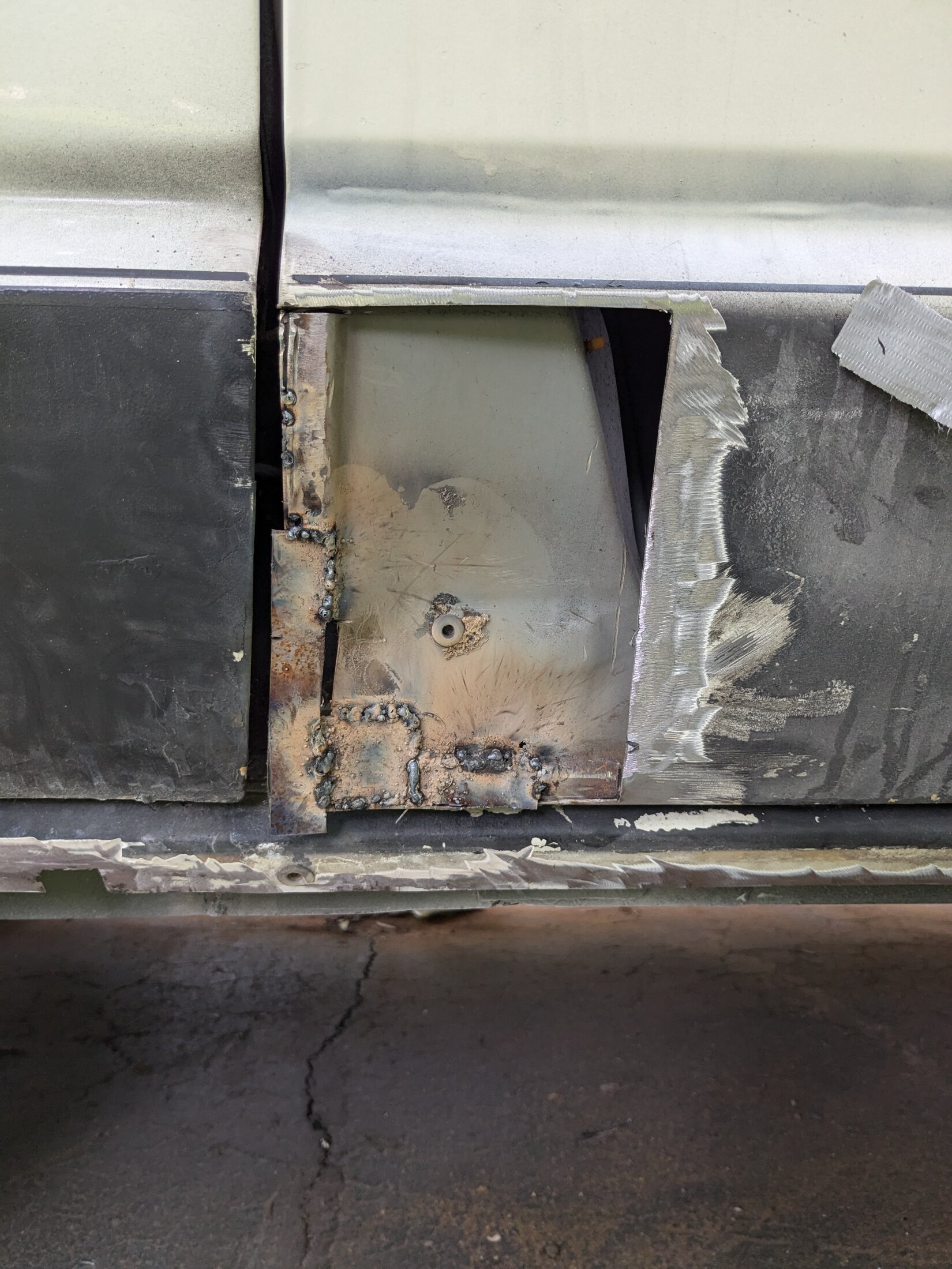

Today I will be tacking some pieces together for inner rocker on passenger side as that one literally disintegrated from rust. When stuff is welded Ill snap some pictures of progress.
I dont have a garage so sealing the truck before rainy/winter season is a must, so wind shield thing scared me a bit!
Trigger warning:
Bad welds!
Some work in progress, Im working pretty slow as I'm inexperienced.
I've pulled carpets and insulation as it was done terribly. I have some carpets ready to be installed as soon Im done with rust repair. I just found that the previous owner hid more rust with bondo by the windshield. I bought a new seal and will be pulling out next week with help of my brother in law. I'll try to get it repaired in the same day and put it back in with a new seal and sealant.
Inner rocker "repair". I'll run a flat piece from the inner rocker to the white panel. I still need to do a final cut to make it squared on both sides.

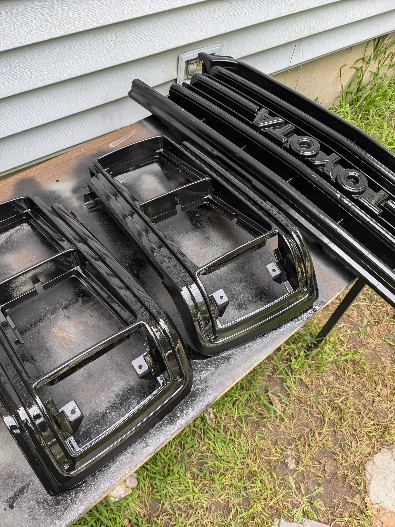

Primed and painted the grille elements. It's definitely a 5 foot kind of a job, but from a tired old grille it's gonna look fine.

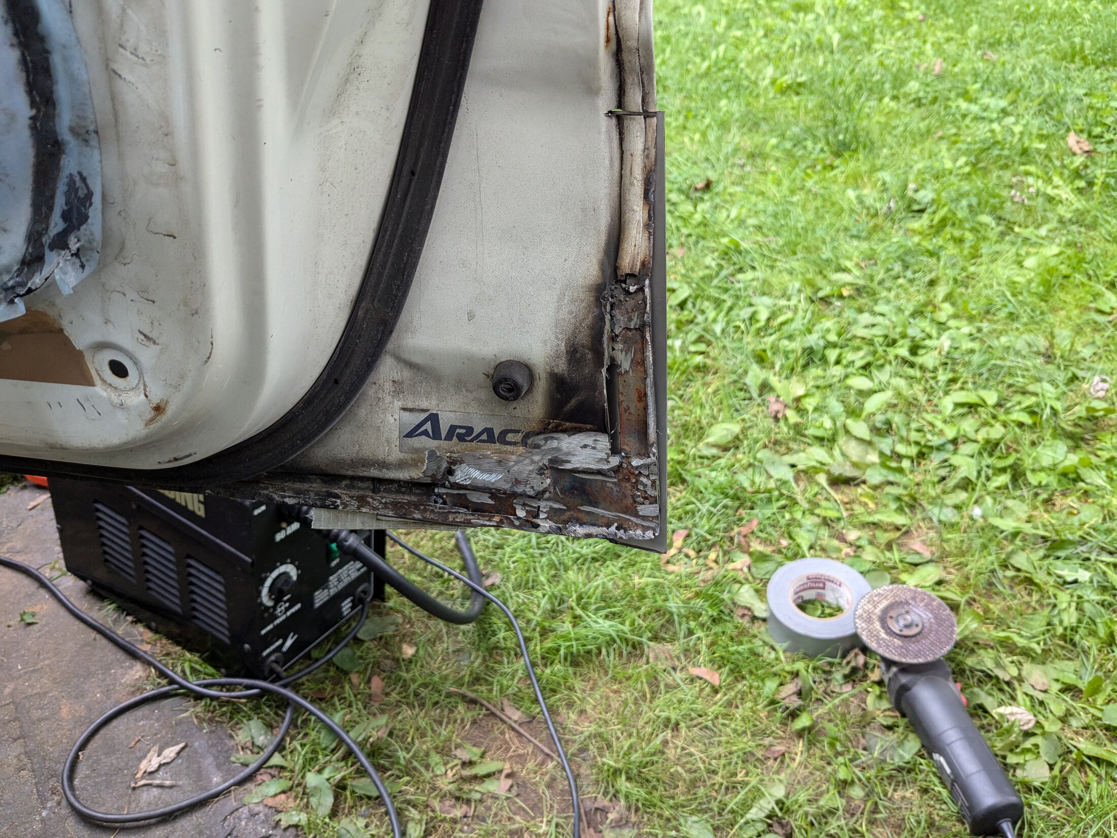

Got annoyed at the door rust and cut it / started patching.
I ended up cutting it all down to fit and grinded the ugly welds.
I proceeded to test fit the patch panel
The back:
Still got some more welding/fitting but getting there!

Primed and painted the grille elements. It's definitely a 5 foot kind of a job, but from a tired old grille it's gonna look fine. View attachment 3708526

Great work! Things are looking good.
The one thing that I would recommend; pick up some strong magnets to hold your patch panels in place (and flush so you don’t need to grind down any of your new metal). You can leave them on the patch as you tack it up; then pull them and backfill your welds.

Some more stuff. Still have a few cap pieces to manufacture, grind the welds and check for pin holes, repeat! I have to say laying underneath the truck welding the panels with splatter burning me wasn't fun.
Here's the front ( no blinkers yet)
