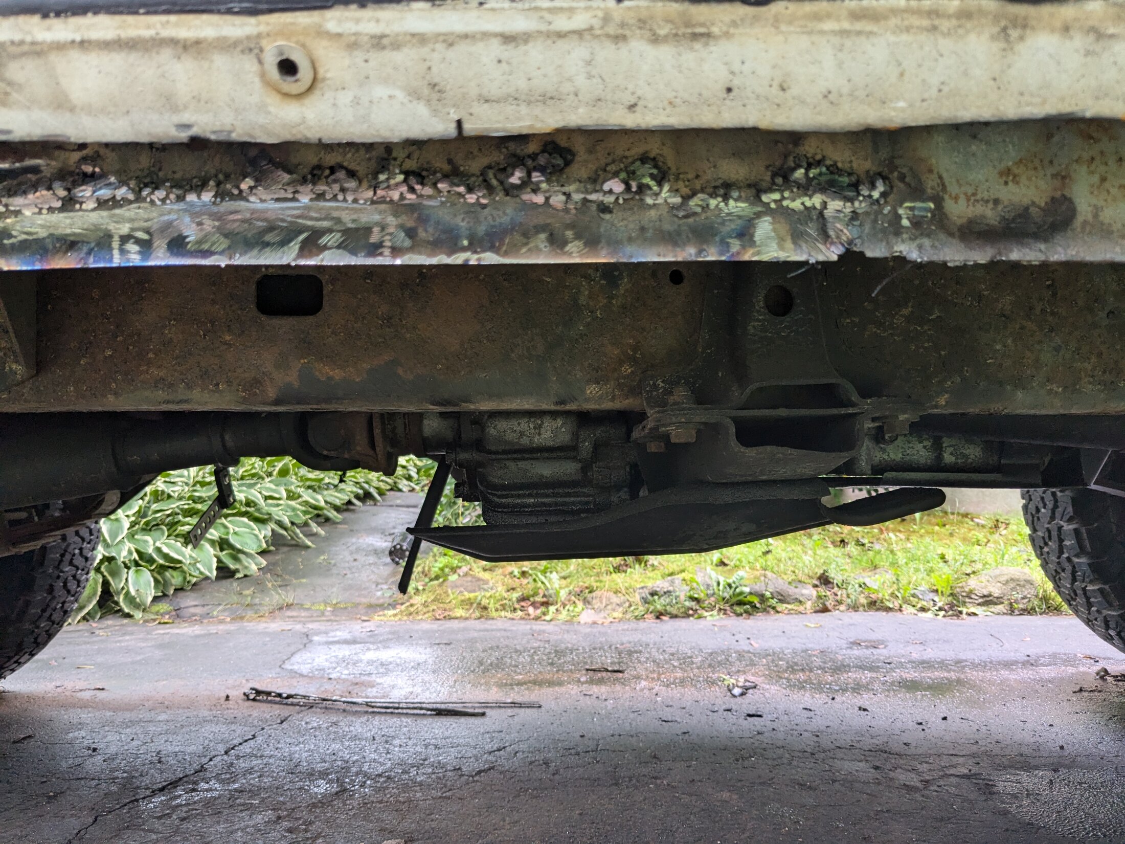

Finished welding the rockers in and grinding the welds! Took forever to refill the thing spots and regrind but should be more or less solid.
With a little bondo it'll profile nicely I think!

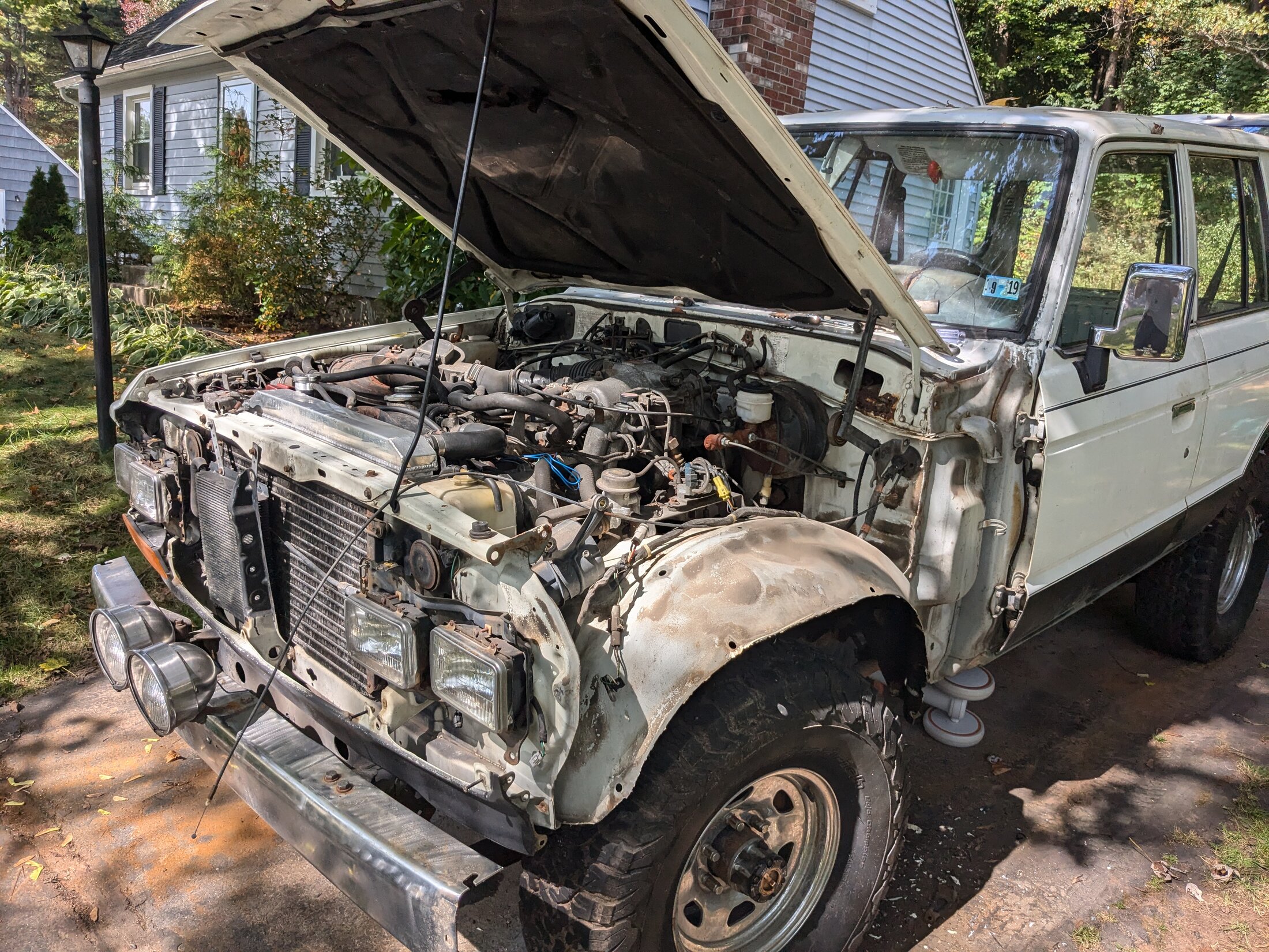

I fitted the new blinker lights
Can't wait till I figure out all the rust and get to sand blasting!

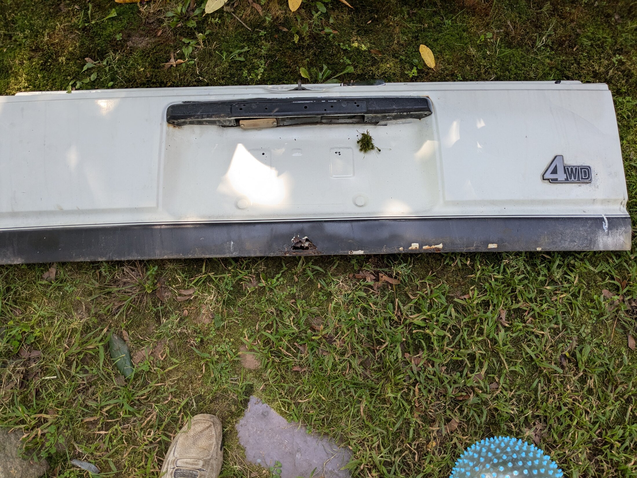

Also removed the rear tailgate for better access and to fix one spot.
Next is the tailgate as it's gotten a bit rusty at the bottom.

So another update. Rear hatch is finished. It was pretty rusty underneath and I was seeing some damage on the inside. Decide to tackles this and be done.
As always putting in the glass was awful. I think I left the edge a bit to sharp because it tore the outside of my seal a little bit on the inside. Hoping it won't cause any issues. Caulking in two days.

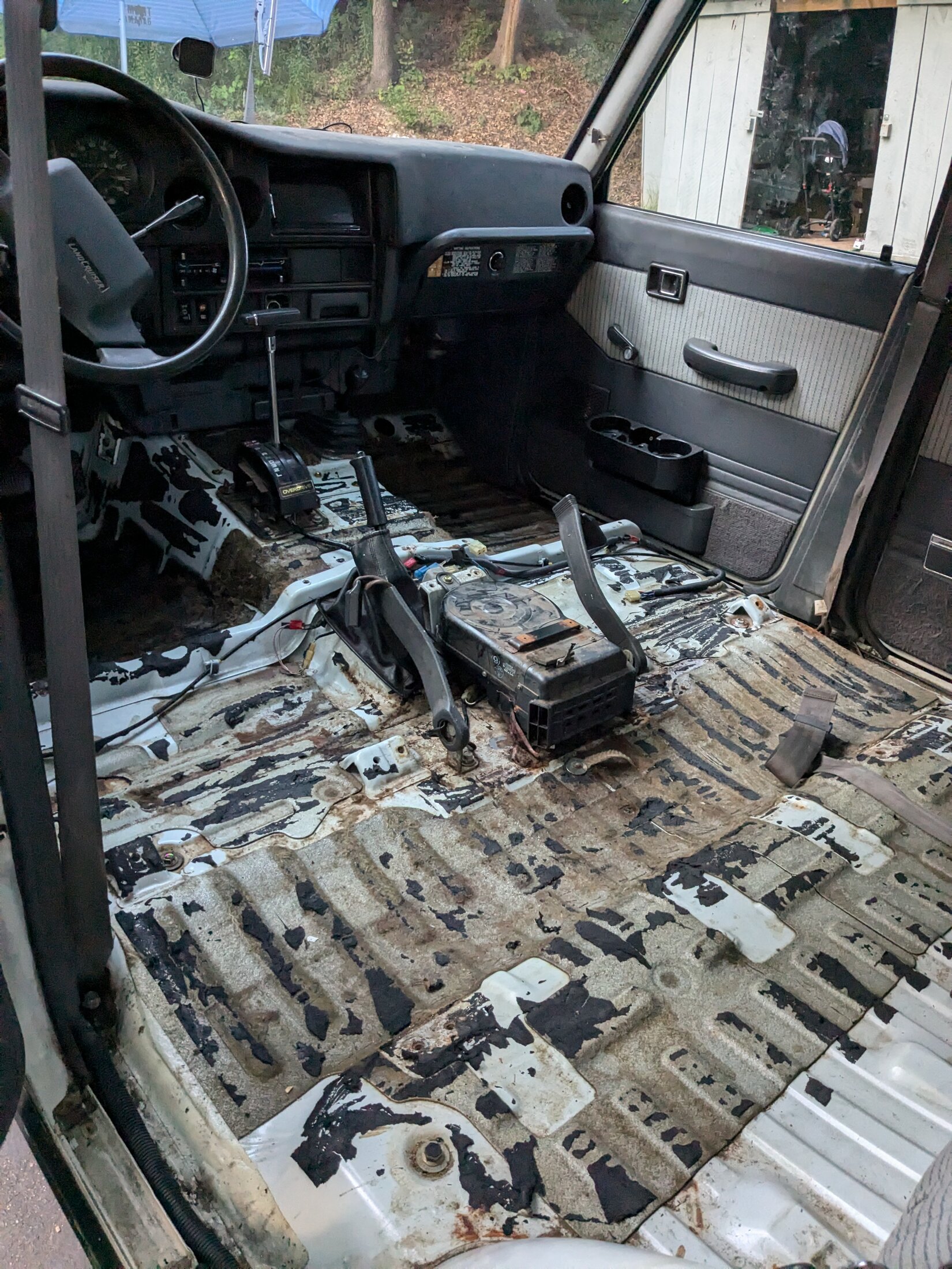

I've pulled carpets and insulation as it was done terribly. I have some carpets ready to be installed as soon Im done with rust repair. I just found that the previous owner hid more rust with bondo by the windshield. I bought a new seal and will be pulling out next week with help of my brother in law. I'll try to get it repaired in the same day and put it back in with a new seal and sealant.View attachment 3706388
Inner rocker "repair". I'll run a flat piece from the inner rocker to the white panel. I still need to do a final cut to make it squared on both sides.
