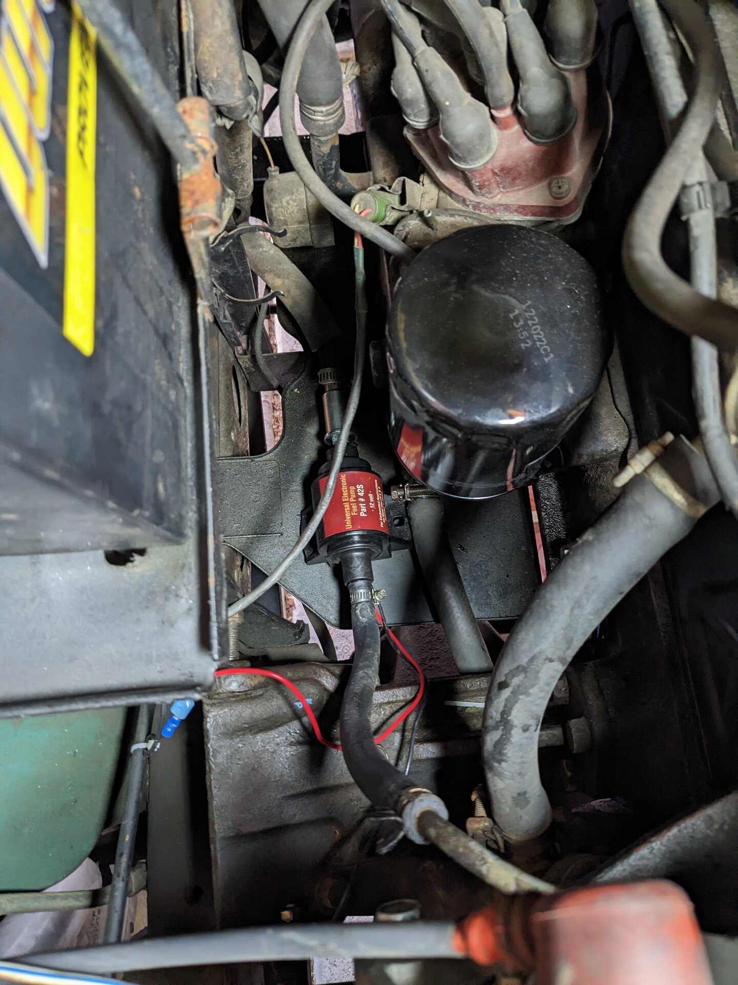

I've combed this forum and found a number of things that could be causing my issue, and I have a friend that has suggested I move my fuel pump as far back to the fuel tank as possible (better pusher than sucker is what I'm seeing a lot of). I had also wondered if it was overheating where it's situated (see attached pic) but it seems like there's plenty of open space and airflow where I have it located. It seems like it's going to be an enormous PITA to relocate it next to or near the tank....

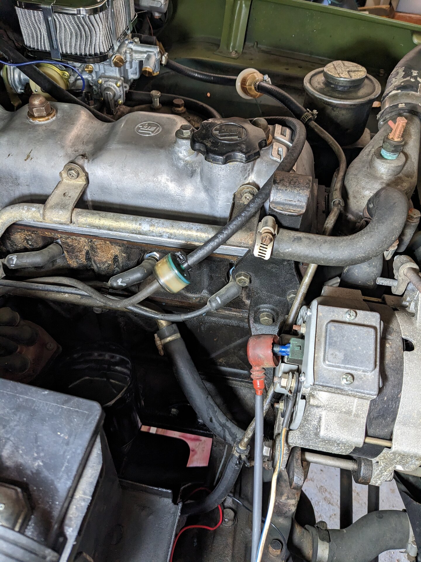

Also, the hose coming out of the fuel pump goes from a rubber fuel line to a hydro line, then back to a rubber hose before going to the carb. Is there anyway that could be causing thruput issues or is that some kind of hack job done to prevent vapor lock? I attached a picture so you can see what I'm referring to.
