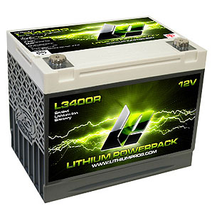

Y'all should man up to one of these:
Lithium Pros L3400R, Lithium Pros 12-Volt Lithium Batteries | Lithium Pros
mother of god... Why?
Because, it's light weight and the terminals won't corrode. :hillbilly: I'm surprised Joey doesn't have one, yet, he has been slackin lately, would be a perfect match for the jumper cables?
Yeah I see very little upside with this. I'd rather stick with the Zero Gravity micro start directly wired to the main :flipoff2:
But it's a bigger/better/more expensive version and with the mini one wouldn't need the gold plated jumpers?:hillbilly:
Holy Smokes! That's a lot of sugar for a dime Eddy! Shiny or not.
