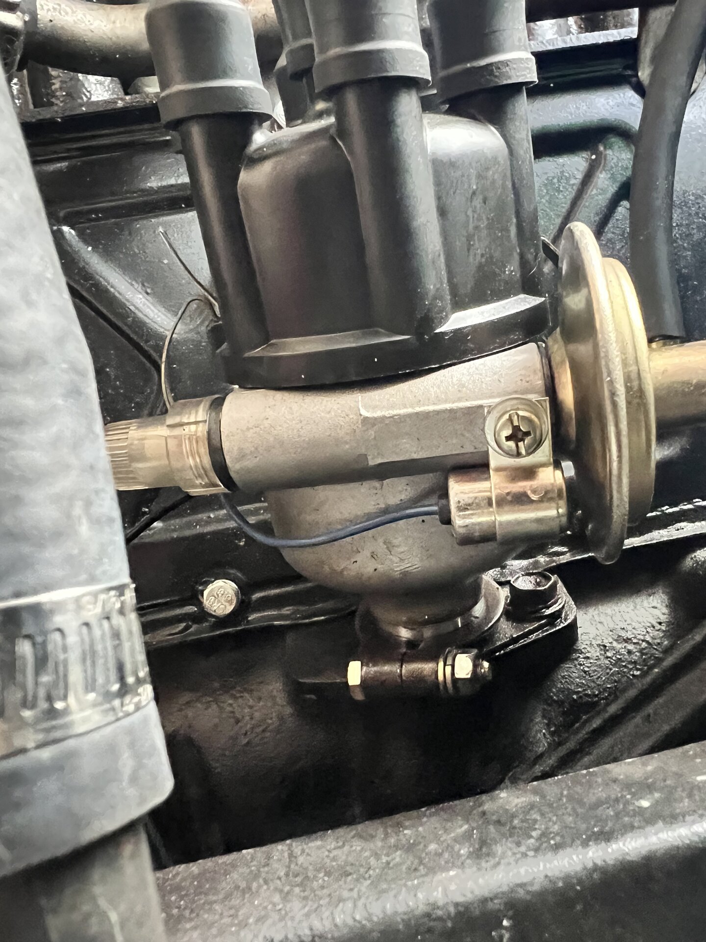

I’m not entirely sure as I don’t have much info on the restoration of the vehicle but I’d say it’s not original based on the overall condition. Pictures attached
is this an out of the country restoration?
that doesn't look like a stock US 1977 distributor
it also appears to be 180 degrees off

It was done in the US but I think they may have thrown an older dizzy on there, from what I can see it’s a 68-74 model. Purchased from someone who had done the refurb

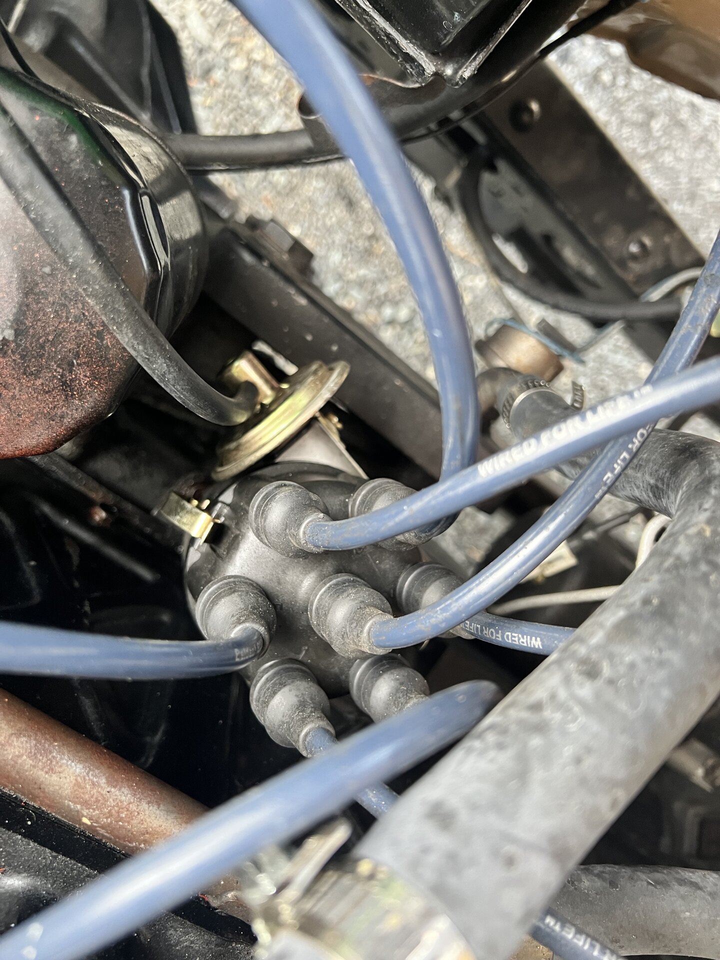

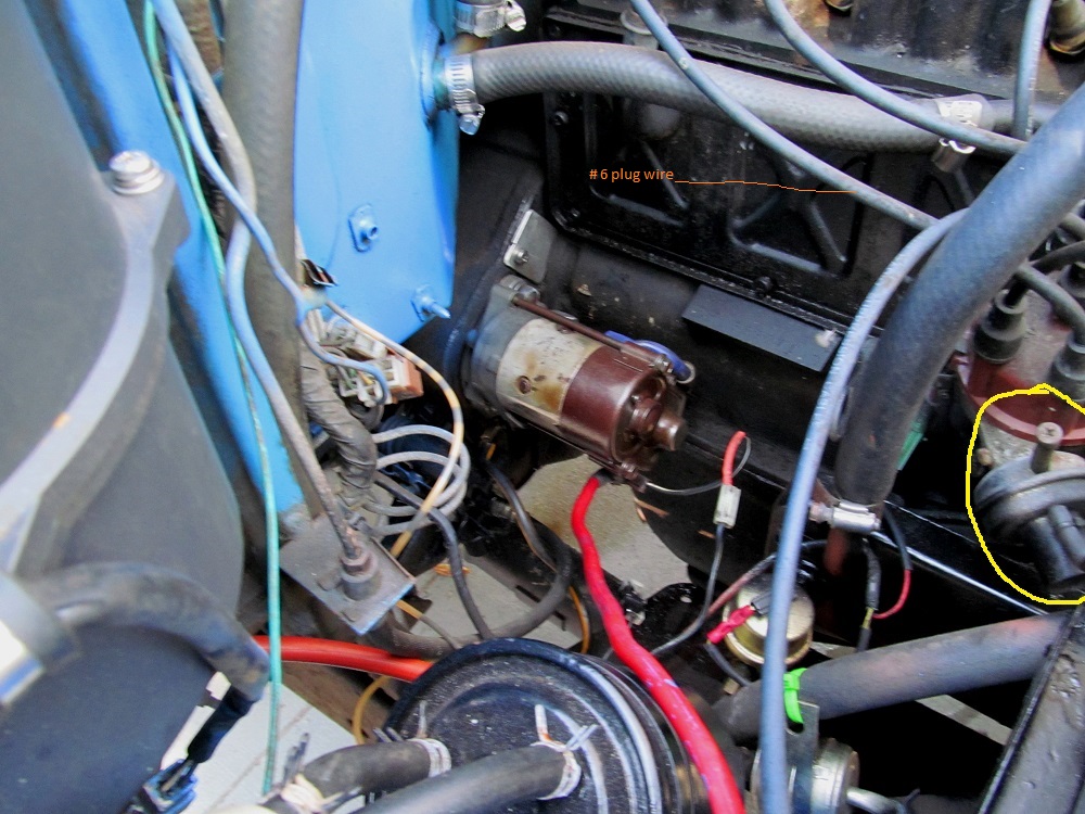

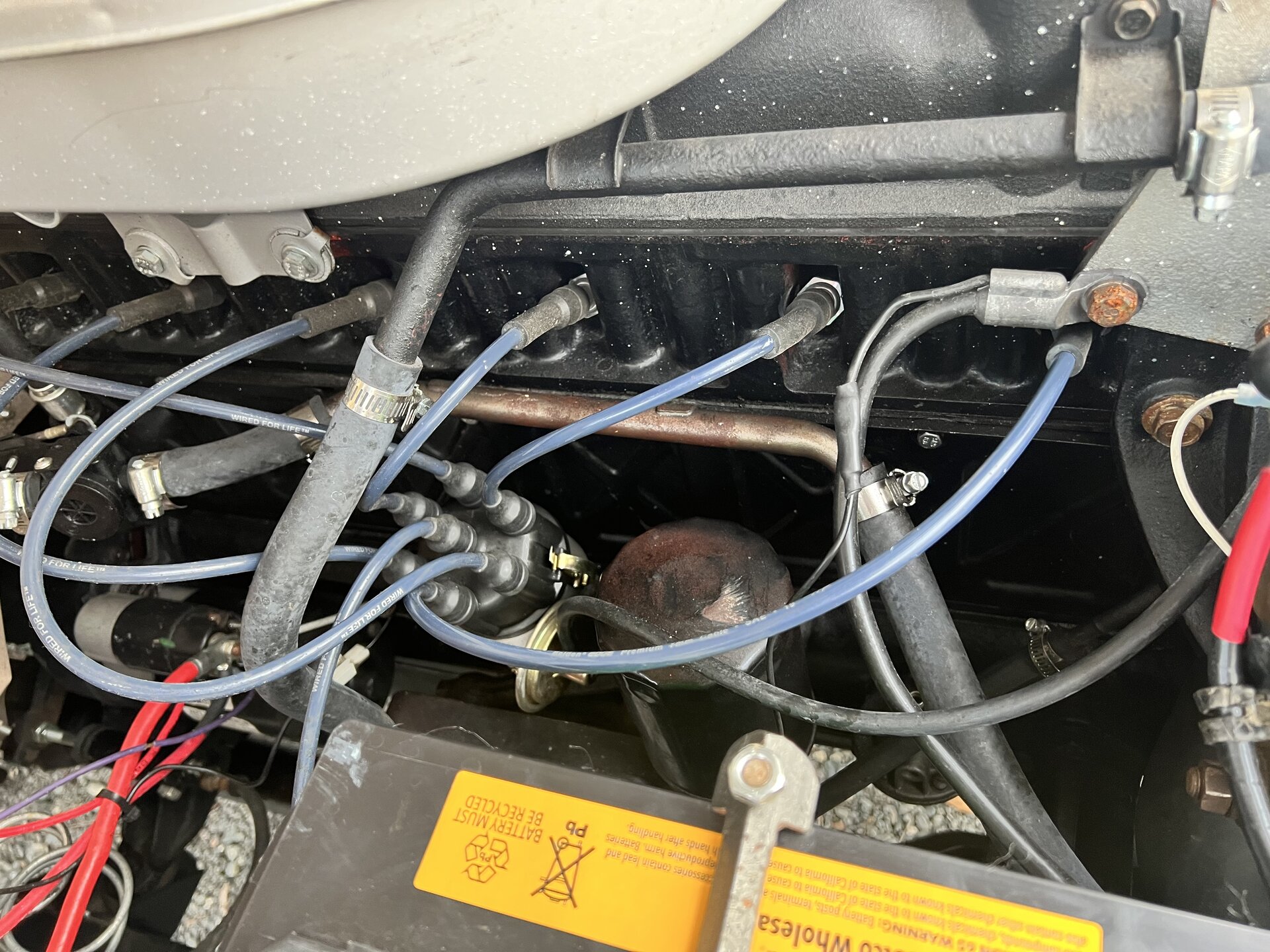

Looks like #1 plug wire is connected to #6 cap position--When the No. 1 cylinder is firing, the rotor should be pointed approx at the #4 plug(reference only)that cap location is the #1 cylinder connection on the dizzy cap

Not 180 out, if it was 180 out it wouldn't run at all. Orientation seems close
No. 1 spark plug wire is connected to the no. six cap position-and No. 6 plug wire is connected to the No. 1 cap position--I didn't confirm the other wires--if the cap indeed has the plug wires stamped on the cap, and the plug wires are connected to the proper stamped connections, then the cap is rotated in the wrong position. OEM caps can only fit one way-there is a notch in the cap that mates with a nub on the dizzy body
This last picture looks like the distributor isn't seated all the way down?

the distributor was stabbed/installed on top dead exhaust stroke, not the top dead compression stroke.
it is not an issue as the wires are now rotated 180 around the cap, as long as the OP knows this, it is alright, but if someone installs an OEM cap with the #'s on it they won't line up
I was making an observasion as to who ever installed it didn't take time to do it properly
I should have stated the distributor is 180 off and the wires are the same, thus compensating for the original mistake
I thought a 1977 would be semi electronic, and if it was gone thru, and a 1977 wasn't available, that a later fully electronic unit would have been installed, assuming what is installed is a points unit as the condensor is shown
X2 on it being seated properly

Thanks for that. Went thru over the weekend and fixed the 180 out debacle — now I’ve got the plugs ordered correctly and after fixing the points in the dizzy it seems to be firing up great now.
Read thru a bunch of threads about dizzy not being properly seated and I guess I’m having that issue. I can feel it engaging the oil pump when dropping it in but I still have that little gap at the top. Assuming this is not normal - any suggestions to get it drop that last 1/8 of an inch?
