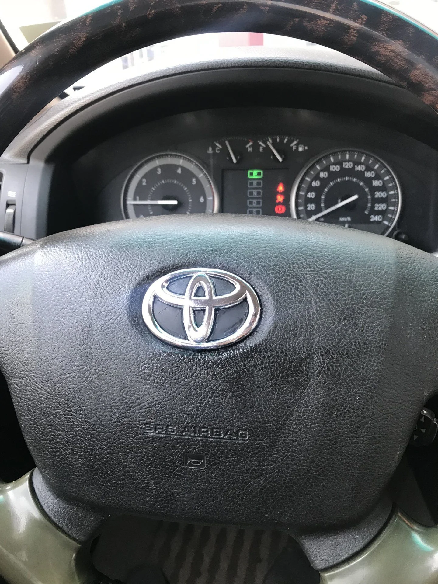

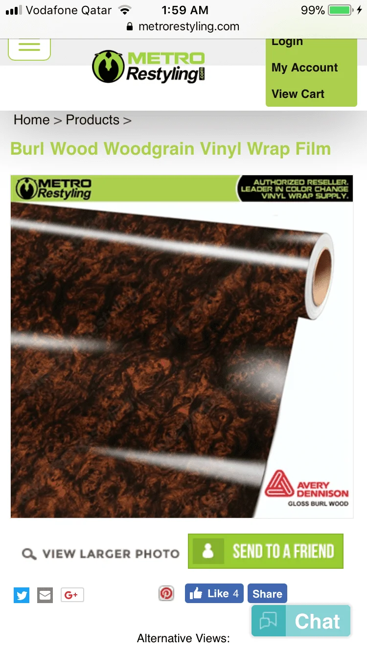

Ok, so basically my Lc 200’s ( 2010 ) steerings wooden paint has faded due to use and the ugly yellow wooden under the wooden paint has come up. I tried searching for the varnish to color it up and get with it but found it no where. Found the ‘barl wood grain wooden vinyl’ online but not sure if that will do any wonder to reduce my headche.
Can anyone suggest how to restore the wooden paint on the steering ? Or vinyl wrap it ? Advices please.
I have attached pictures of the vinyl I found online. And also a picture of my steering wheel but unfortunately it does not show the faded part in the picture but its that top part of the steering wheel where we hold to steer it usually.

Good find on the vinyl wrap. My first thought was doubt about how well it would conform to the curvature of the wheel. I've seen (on TV) people use hair dryer or heat gun on vinyl exterior wraps to help it conform and stretch to the curves. Might help.
My other thought is that you could try to paint it. Or rather, have someone paint it. A pro wood finisher/refinisher may be able to repicate the burl wood grain. Or a home interior painter, as they do faux finishes.
After the color, you'd want to give it several coats of clear polyurethane (I always hear to lightly sand between coats). When that's done, sand to get it to a smooth finish. To do that, sand up to a very high grit...at least 600, but auto stores have up to 2000 or 2500 grit for wet sanding.

Do us all a solid and try the vinyl film!

OP, I'd go with a leather re-wrap or a replacement wheel from ebay. You'll never get that vinyl to look good on the steering wheel. If you search on ebay there are plenty of "wood" styles to choose from.

You'll never get that vinyl to look good on the steering wheel. If you search on ebay there are plenty of "wood" styles to choose from - Rxavtly my only fear with vinyl but still would give it a try. If not steering, it can be used for any other purpose. No harm
What is going on with the Toyota emblem in the center of the steering wheel? It looks like someone repainted it...(?)
It doesn't matter because after the tacky plastic wrap no one will notice the emblem unless it has been bedazzled. Cheap plastic will look like cheap plastic and it will wear like --- butter-- or -- cotton candy== or == toilet paper.
And I think you are seeing reflections on the chrome.
