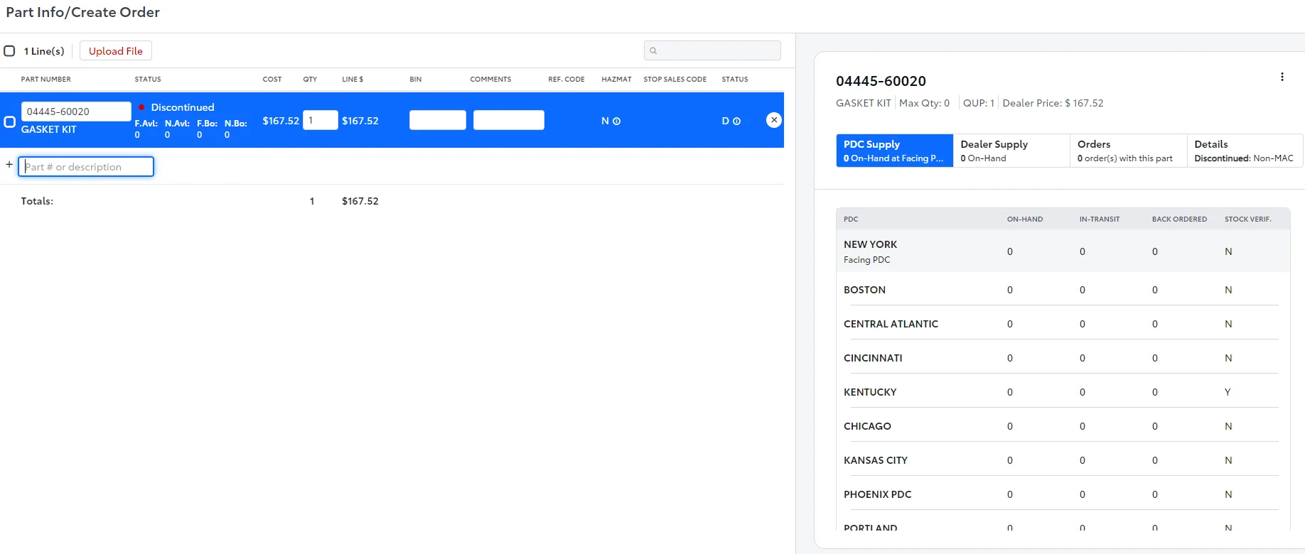

FYI: My local dealer has 04445-60020 as DISCONTINUED on their screen. Maybe @OGBeno or @cruiseroutfit can confirm.
Still some in stock from Japanese distributors and likely some US vendors but prices are jumping up from when I ordered a couple of them last week which isn't a good sign.
This is what my dealer told me too. I got one inbound from Amayama. Ordered two days ago and got a tracking number this morning. About $90 shipped, so kind of pricey.
