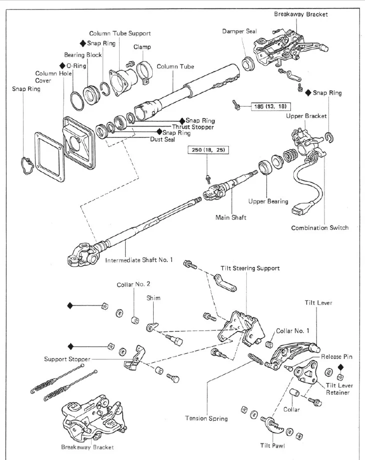

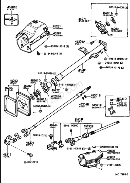

It appears from the diagram that there really isn't a crumple component to the column. I think I will take off the steering wheel, detach from the floor, see if I have the clamp shown in the diagram (I didn't initially see it), loosen the yoke inside the engine bay, and see if I can stretch it the 1/2" that it appears to be off. Definitely not thrilled about that. Thanks for the replies.
The diagram from the FSM for the tilt steering wheel is a little different from the one above, but still there doesn't look like much opportunity to stretch the shaft.

I don't think there is any telescoping in the column. I think that step you see in the cover is just to allow the column to collapse in an impact.
Thanks Seth, do you happen to know a measurement that I could compare to see if mine is crushed? Like from the floor plate to the upper tube?

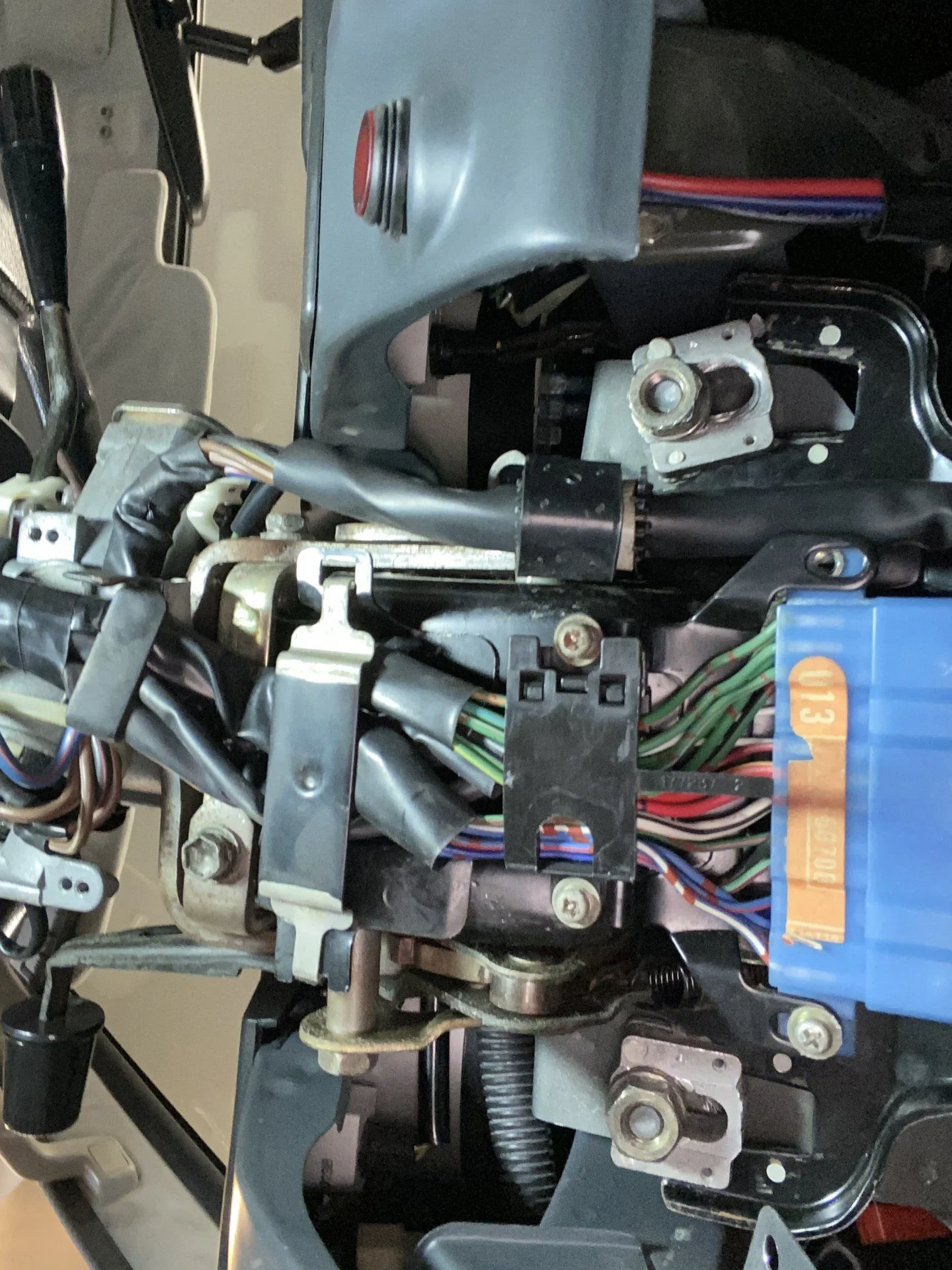

Not off hand as that was a photo I found on the Google. Can you post a picture of your column so we can see where the ignition switch is in relation to the dash?
I can, but the clamshell and steering wheel are off. I’ll take one when I get back up to the shop after lunch

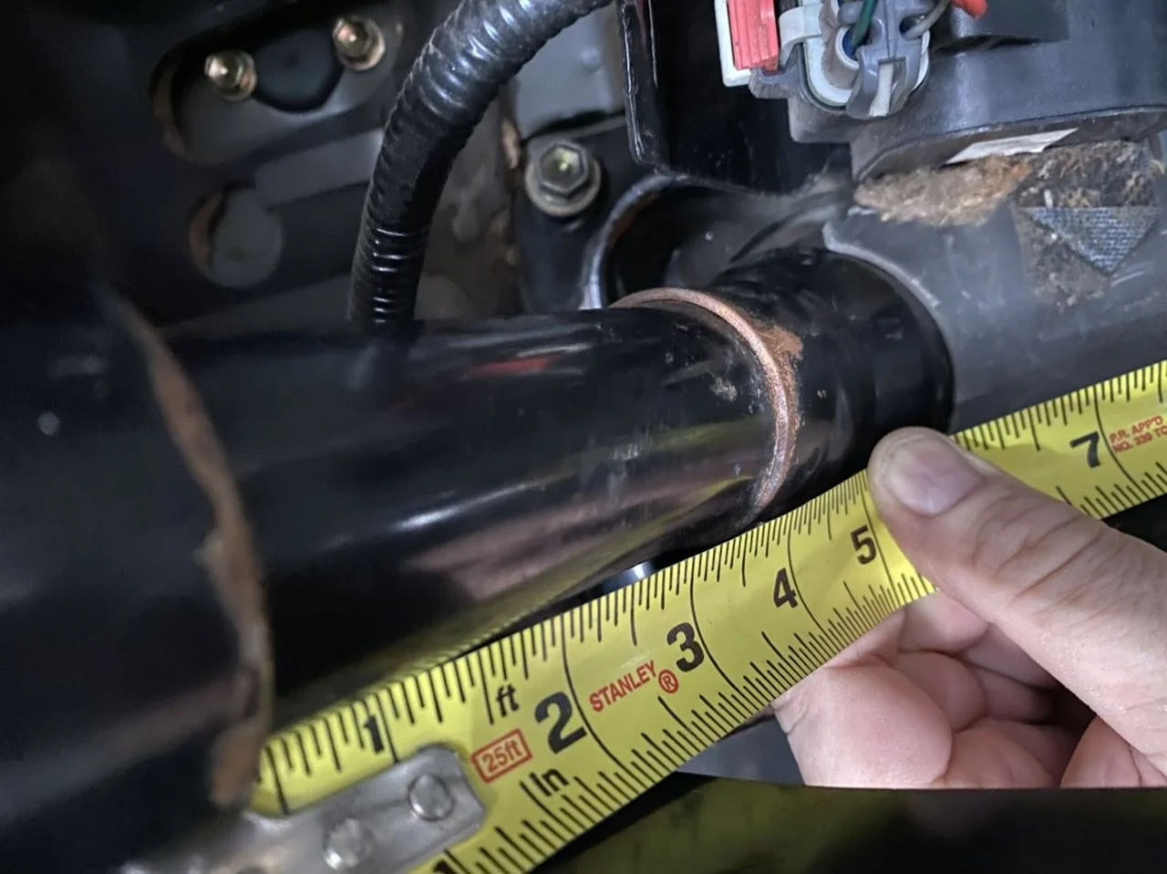

It looks like the distance between the two tubes is 3.75” approximately. Crumpled or No?
I think your worrying about nothing, it would take a very hard hit to crush the steering column, if there was an impact the slip yoke would take some of the impact and then the u joints, something under the hood would destroy itself before the actual column.
if the column actually compressed, you would see signs of it.

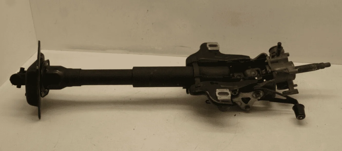

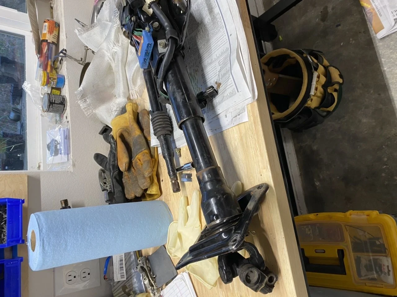

The column is out now, but it was within a 1/4” to 1/2”. Pretty tight. You would hit your hand every time you turned the key. Maybe should have lived with it.

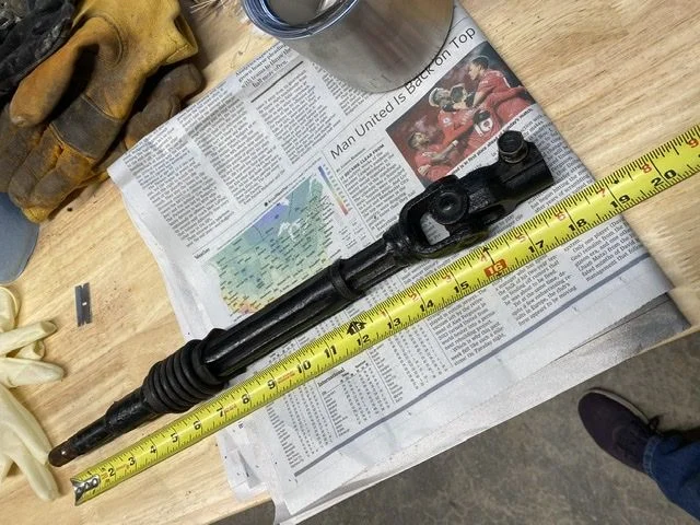

So, I’ve been working with some local cruiser guys and some interesting measurements. The distance from the column upper tube to the top of the bottom of the column where the bell is spot welders on is 3 3/4”. Others measured 5 1/8”. I can’t see anywhere you can adjust the tube. Also interested in getting a measurement of the intermediate steering shaft.
