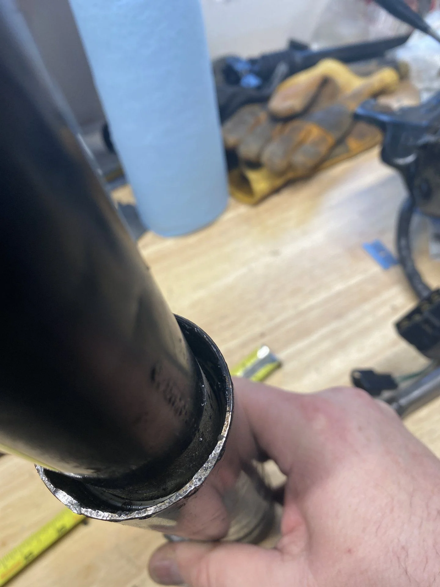

Hi, no, it doesn’t move in or out. Won’t separate. I’ll have to look at the U joints. It seams like the lower tube is jammed in the upper tube, but never having taken it apart, not sure what I am looking for.

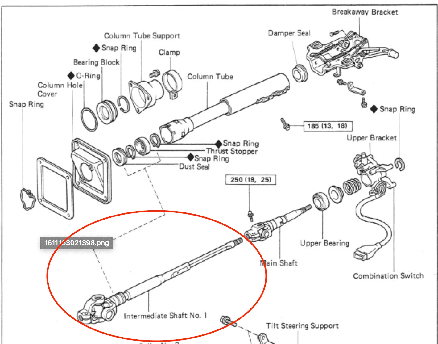

in the pic above the slip yoke is where the large left side will slide over the smaller right side

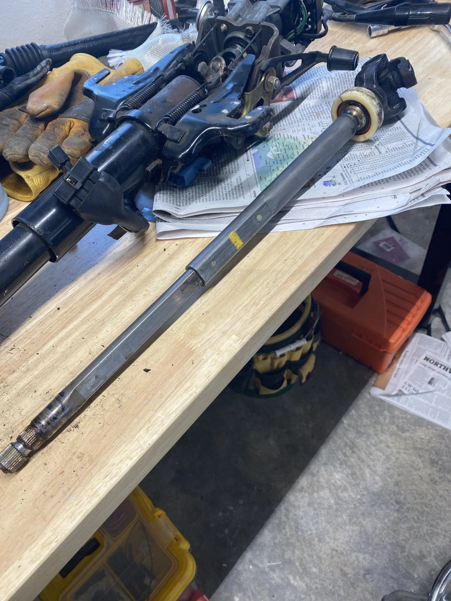

how about a pic of the shaft?
that looks like the shaft out of the steering column, it doesn't move
my mistake, I looked at the pic quickly this morning, I thought it was the shaft off the steering box
No, the silver one is from the column. It clearly looks like it’s supposed to move as does the column tube. Banged on the tube, still won’t move. Don’t know the length of the intermediate shaft in the column
I think that one is only supposed to move in a crash. It has no need to be a slip joint like the lower one at the steering box.

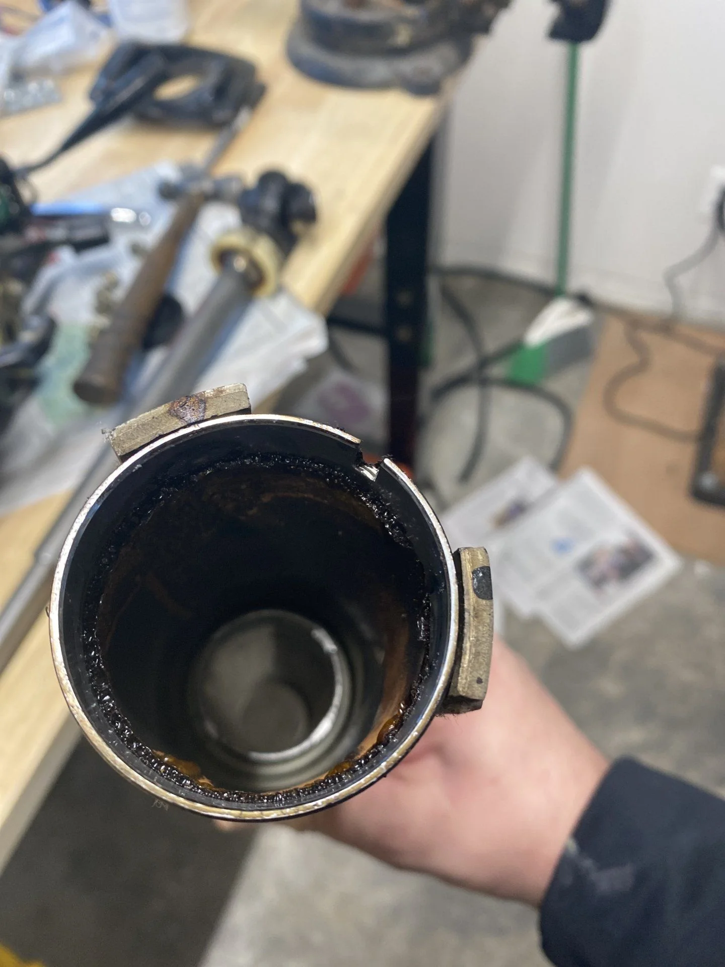

Unless the body impacted the column and they replaced the slip joint., which is my theory at this point. The lower tube does not move i n the upper tube, and I don't know the measurement of there intermediate tube, but everyone i have talked to has a different measurement than mine for the tube length. The shaft near the steering box seems to be right. But I do know that the intermediate shaft in the column is built to move.

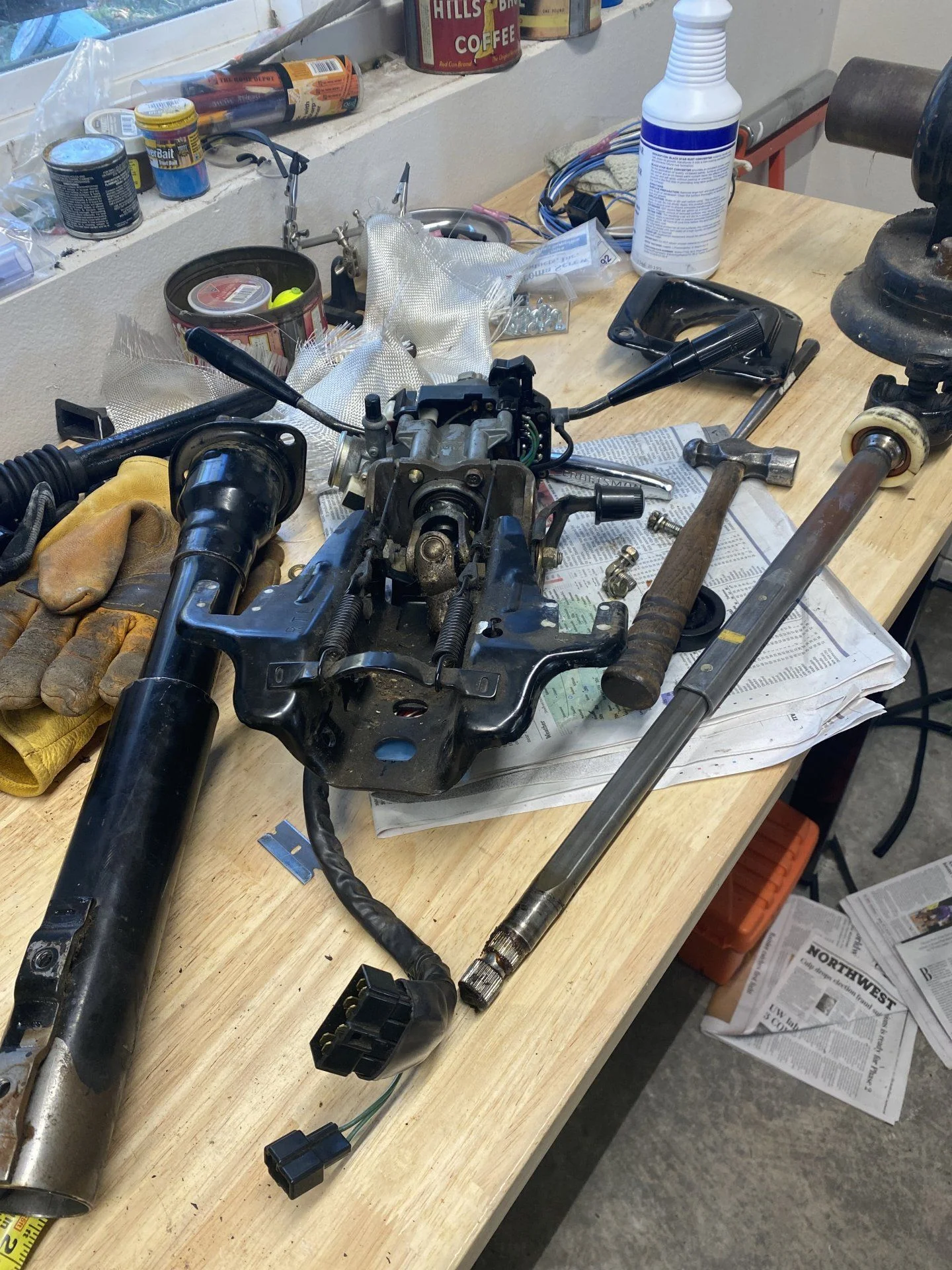

So, the column was compacted and was able to source the lower part of the column below the tilt joint. Trying to wrangle it in place but got tired. There must be a trick. Hoping to get it back in place tomorrow and the rest of the dash finished up. Going to put my BMW E92 seats back in because the E70's i bought on Ebay won't fit. I hope I can sell them before buying a new set.
Column in! Yay! there was a flat spot on the shaft that needed to be in special position. On to the shifter....
