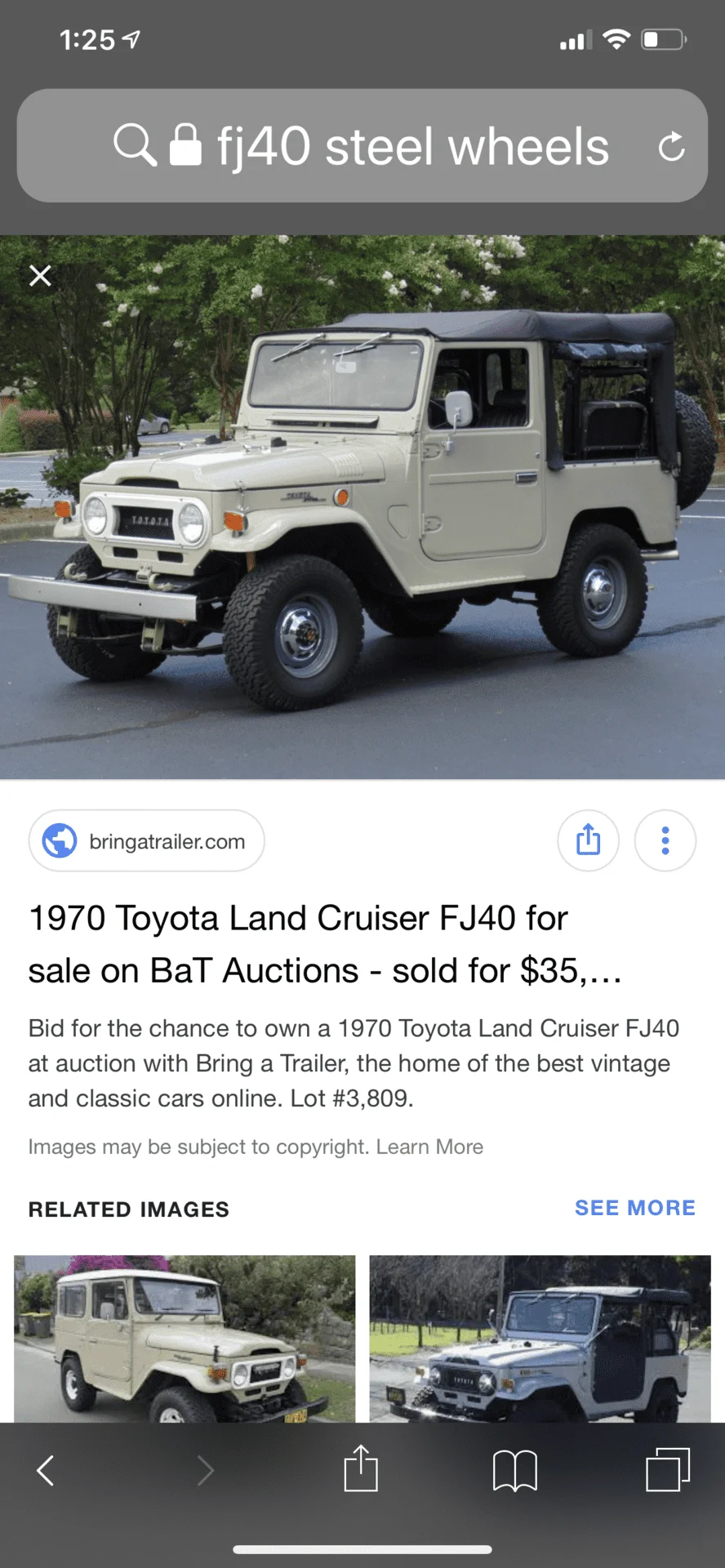

Does anyone know where to find a fj40 style steel with with hub caps for a 1994 land cruiser? I would just put the same hubcap from the rear wheels on all four wheels.

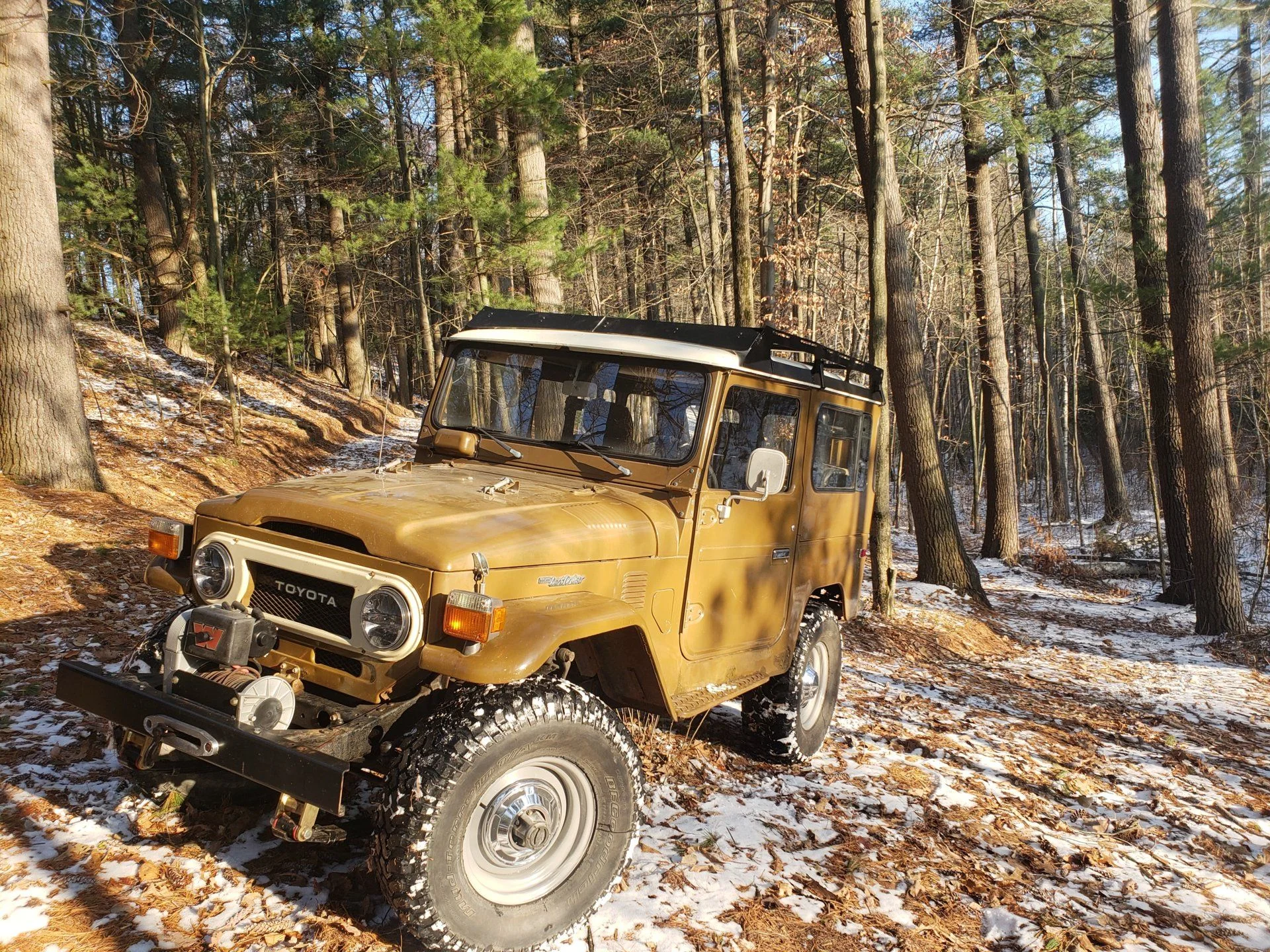

There is some fab work involved for the cap but you can buy Wheel Vintiques (get them from Summit for same price but free shipping) "smoothie" 12 series wheels in 16x8. I know they are a 4" backspace standard but can be had in custom backspacing. From there you need to modify a stock 40 series cap (still available less than $20 each) and a smoothie hubcap to fit on there. I have been messing with this for some time and have a set on my 40 (16x7 size) and they work pretty good. I have another set at home to build for another mud member but I just can't get the time to get it done. You have to cut the dome off of the smoothie cap and cut the inner part out of the 40 cap and have someone tig the two together (both are stainless steel) do it where the black area is and repaint after it is done. On an 80 with full float rear you would probably use 4 front 40 series caps.
Clear as mud right?
Here's the 16x8 on my 40
